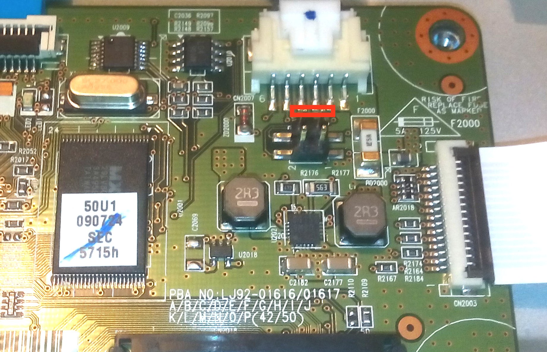

                    • Step 2 - Carefully short pins 3 & 4 of the quad connector on the
                    Logic PCB together. When the panel is powered on, the PDP will
                    automatically “play” the internal test patterns stored on the Logic
                    board that would normally be accessed only through the service
                    menu. This will force the logic board into a loop where the internal
                    test patterns will be displayed in sequence.

                        OK, getting a start on this...
                        First off, I am assuming that the Main PCB is the video board (#2 Board) and not the Main Power PCB (#1 Board).. That makes sense else how would I get power to the unit, eh? And the connector shown is the 24 pin connector that I short pins 1 and 5 on...
                        I have also uploaded a .3GP video that shows the Logic Board LED blinks. I think it's safe to say that it's 1 blink per second..
                        Finally, the picture of the Logic Board Quad Pin Connector with pins 3 & 4 marked for shorting...
                        I also confirmed GND and PS_ON via the silkscreen label on the connector.
                        Everything looks good to go???
                        EDIT: OK, looks like the video didn't make the cut. But it clearly shows that the blinks are every second without any kind of delay..
