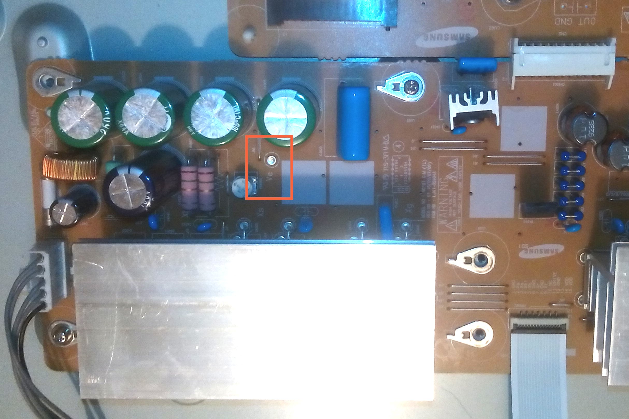

                    Re: Continuing Education Checking Voltages PN50B430P2DXZA Sound Nothing Else
                    OK I found Ve..
                    It's on the X-MAIN and it's a free-standing pad.. Nothing to wedge on to..
                        Originally posted by Michale32086
                        OK I found Ve..
                        Was just about to tell you, just probe it with respect to gnd. You are using a proper meter with insulated probes?
                          OK, I survived!!
                          I had the wife plug the unit in while I held the probe on Ve...
                          Checked out.. 88v solid and steady..
                          So, to sum up.. All the voltages on the X-Main and Y-Main are as they are displayed on the sticker...
                          Thanx for all the help to date.. It's a lot easier to gin up the courage to check voltages when I have smart people helping

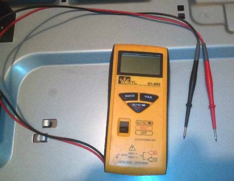

                            Here's what I have at home...
                            "It's what we got.."
                            -Benjamin Bratt, DEMOLITION MAN
