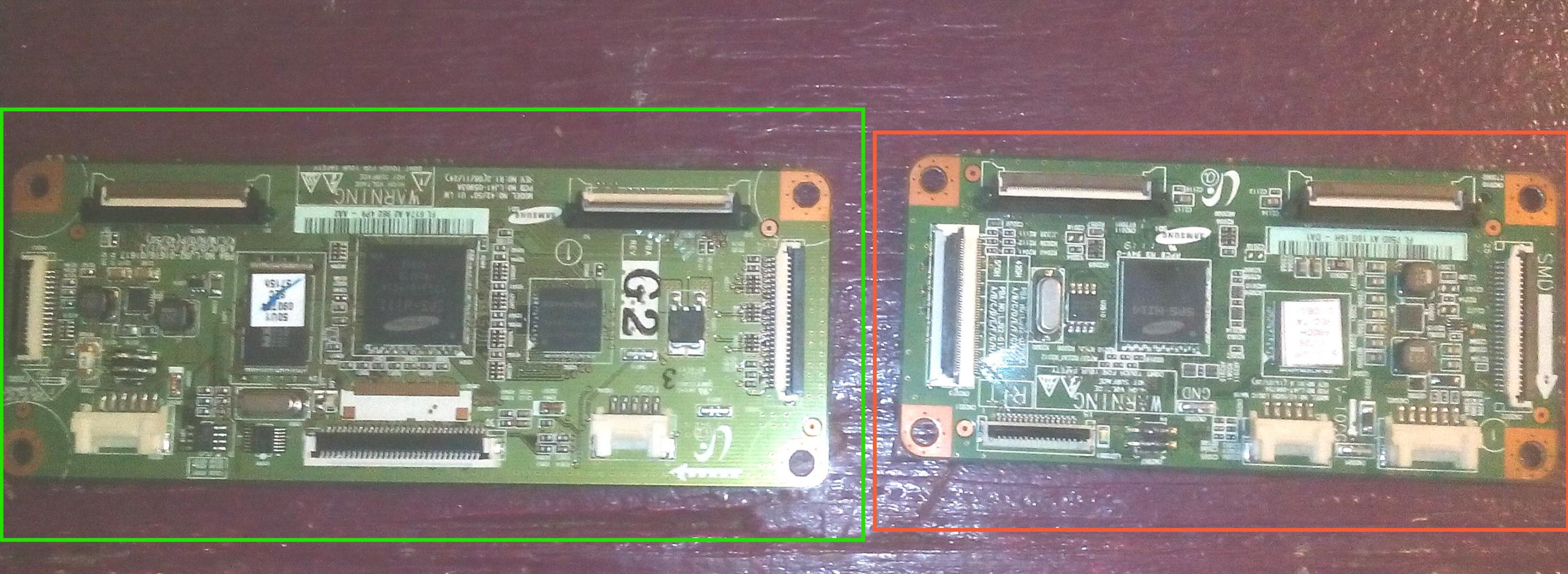

        OK, I don't have an exact part, but I do have a part that physically fits the connections.
        It came off of a PN42C Sammie..
        The green is the correct Logic Control Board. The red is the one off the PN42C

          Well, I found two Logic Boards that had the same physical connections. Each one put the TV into protection mode (Green LED 2 sec off 5 sec on)...
          I ordered a replacement Logic board identical to the one in there, but it won't likely be here til Mon or Tue...
          I'll follow up then...
          Thanx again to all for the great assistance..

            Can't use the 42" board in a 50" set.
            The 50" board is hard to get but you might be able to swap firmware chip from boards over, this will only work if the fault is not with that board of course.
              I have a Panasonic 50" Plasma that is working fine.. If it has a comparable Logic Board I could pull it out to test the Sammie...
              On the other hand, I hesitate to mess with a working set and I have already ordered a replacement Logic Board....

                  OK, got the replacement Logic Board in...
                  As Samuel L Jackson said in JURASSIC PARK....
                  "Hold onto yer butts.."

                    Re: Continuing Education Checking Voltages PN50B430P2DXZA Sound Nothing Else
                    No go..
                    Same result as before with a few minor changes..
                    First off the rapid click-click-click on the Y-MAIN board is back... And I get a hi-voltage hum from both the Y and X Main boards..
                    The Logic Board is not identical to the one I have. It has the exact same connections in the exact same place but the new board has a 2nd LED right next to the existing one.. With the new board, that new LED blinks 2 or 3 times and then the other LED goes into the 1 per sec blink...
                    That's the extent of what's happening... You can see it here
