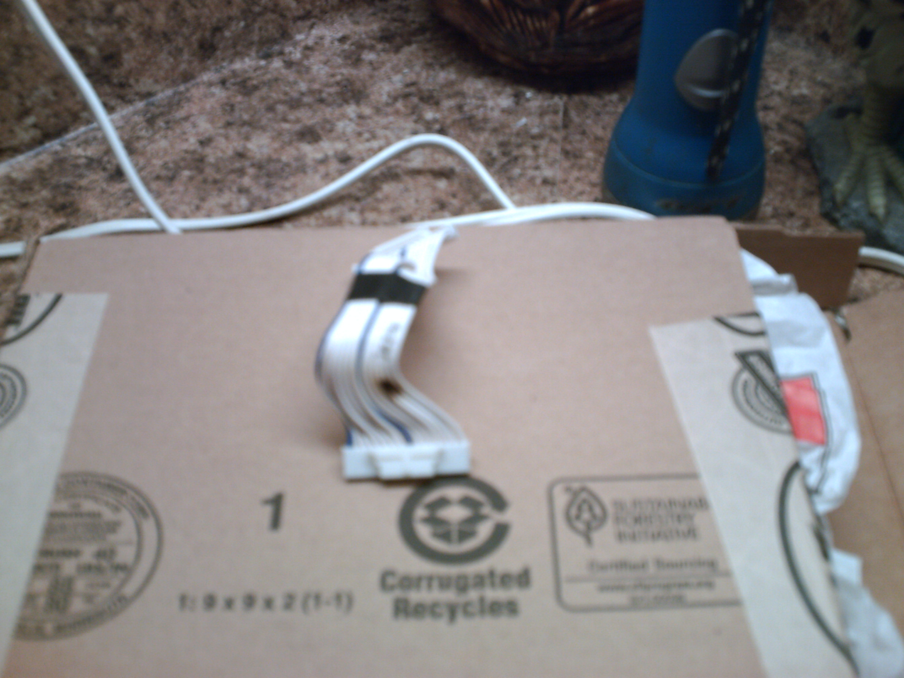

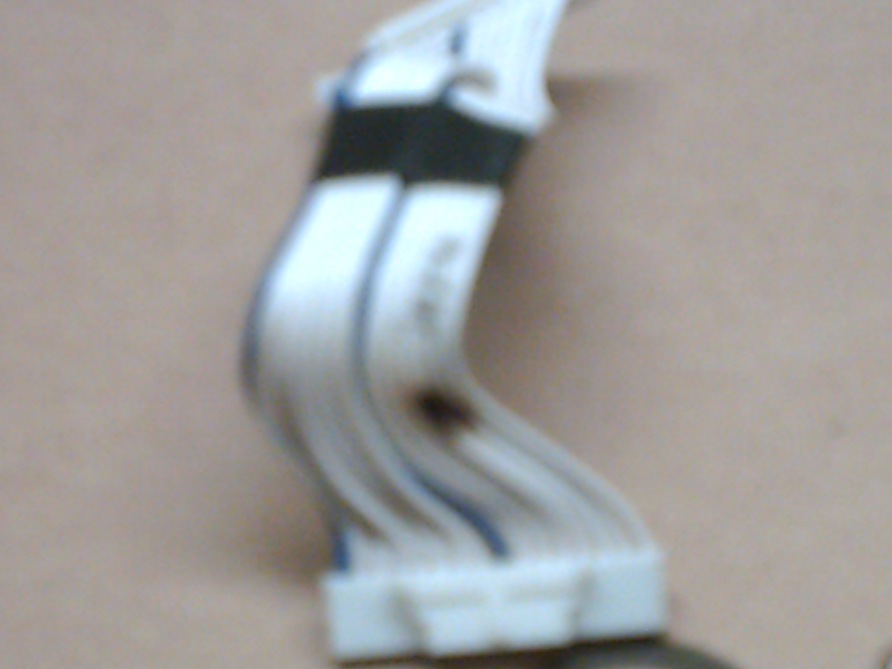

              #66
              Re: samsung LN-S4051D diagnal lines
              crap, was looking and found this burn mark on connector wires from a board to g board, wonder what caused this, thinking its bad.
                #67
                better pic.
                  #68
                  But are the conductors still show continuities between each end of the wires?
                    #69
                    inlets are tiny, multi meter probes wont fit.
                      #70
                      think I would need small needles or such to make connection.
                        #71
                        That is what I use, sewing needles, or small resistor/diode legs.
                          #72
                          thanks budm, used a bread tie, they're at 2.3, guess thats not the problem, thought I was onto something for a minute there.
                            #73
