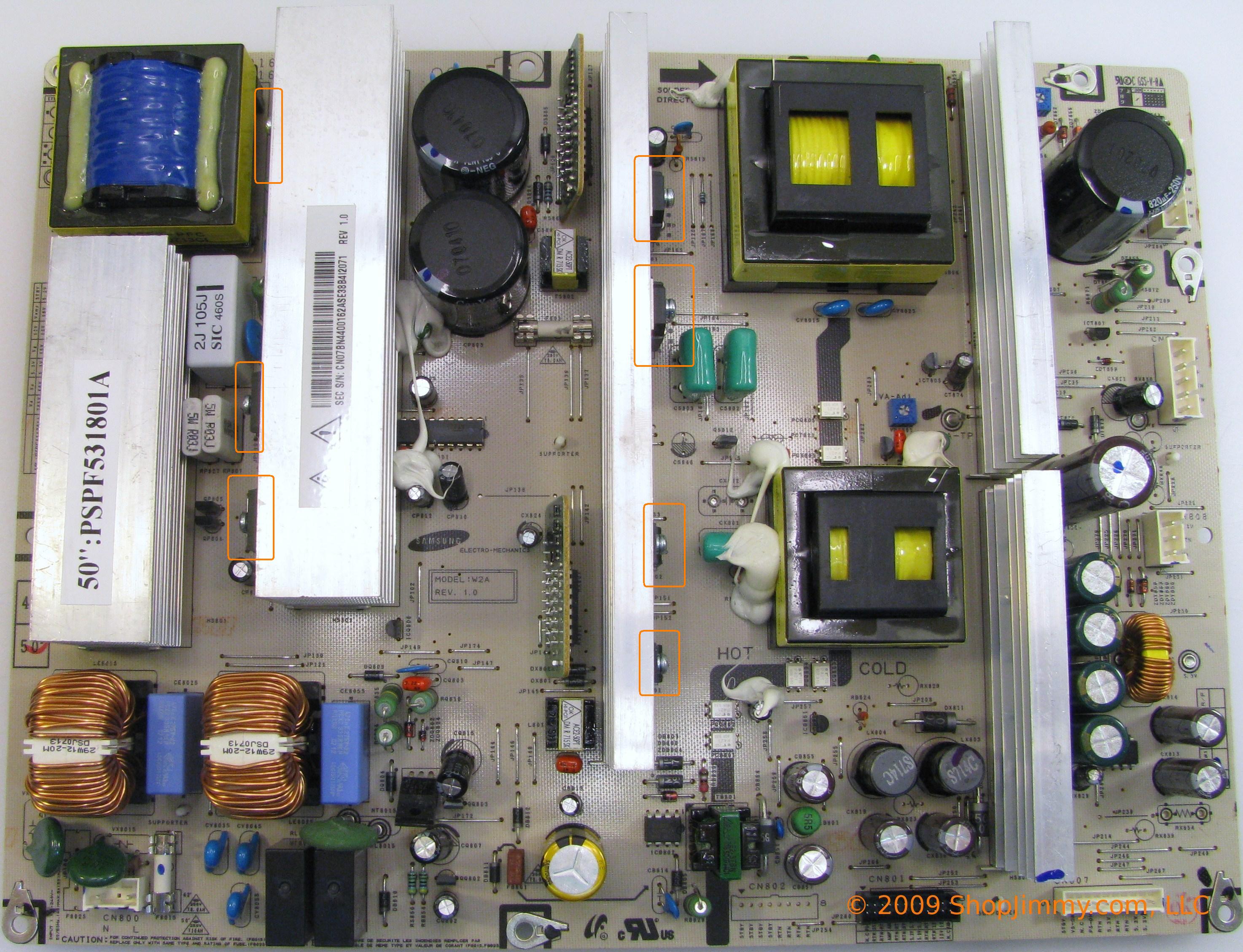

    I have the standard clicking on an off issue with this plasma. Initially it started cycling on and off, but would eventually start and play the melody. After a few weeks of this it will not turn on at all. It doesn't really try to start but just clicks. No melody is played either.
    Upon inpection of the PSU, I noticed that a few of teh caps were swollen. They weren't yet leaking but had bulging tops. I purchased a repair kit off ebay to replace these caps. Still no luck unfortunately.
    I have a DMM and would like to know if anyone can walk me through testing the power supply and various components to see what else needs to be fixed?

      If the FETs have not blown, could be as simple as cracked solder joints on the Heatsinked FETS, especially the centre heatsink.
      If that's the case i'd reflow them all.
      Hope I've got the correct locations
      QS801,QS802, QX801 and QX802
      you'll have to confirm if that's the correct PSU, also BN44-00159A fitted to this model. Picture is of 50" but same PSu with downgraded FETs

        i f I recall this particular model was plagued with poor solder connections on the power supply. Check connections on all transformers and MOSFET transistors
        You might need a magnifying glass but I guarantee you're going to find some

          Check all the fets on the aluminum rails as well as then soldier points for them too.

                    what about all the ones I've marked? If failed they go short normally, so set meter to buzzer or continuity / diode and probe across each combination of 2 legs of the FETs. the ones i listed are for Va and Vs voltages and are the ones that blow

                        I'll try to check those fets in the morning. There are 3 leads obviously. Do I test continuity on the outer leads?

                          often they'll short fully, just do 1-2, 1-3, 2-3
                          If they have shorted there's a lot of small smd stuff underside that fails with them too usually.
                          I've got one (50") that both the Va tract and Vs blew and it continually clicked. bit of a mess really as that and the ymain and upper buffer blew all at once.

                                    I tried testing the mosfets earlier with mixed results. I couldn't figure out the multimeter I borrowed from a friend. I think the leads are bad on it.
                                    I'm getting a fluke from another friend and I'll report back. I did check the welds for cold solder joints and any that looked suspect I reflowed. Still not working though.
