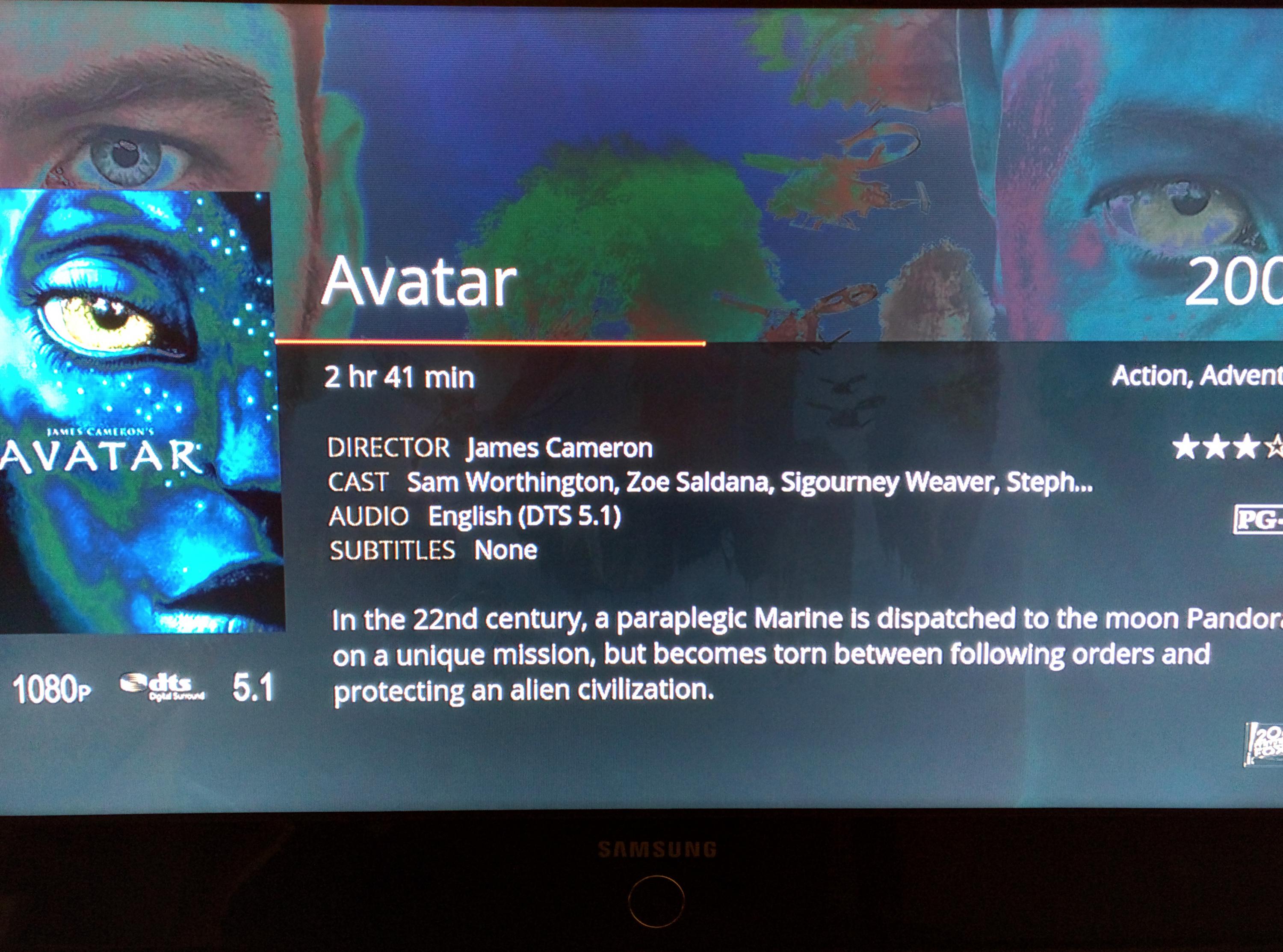

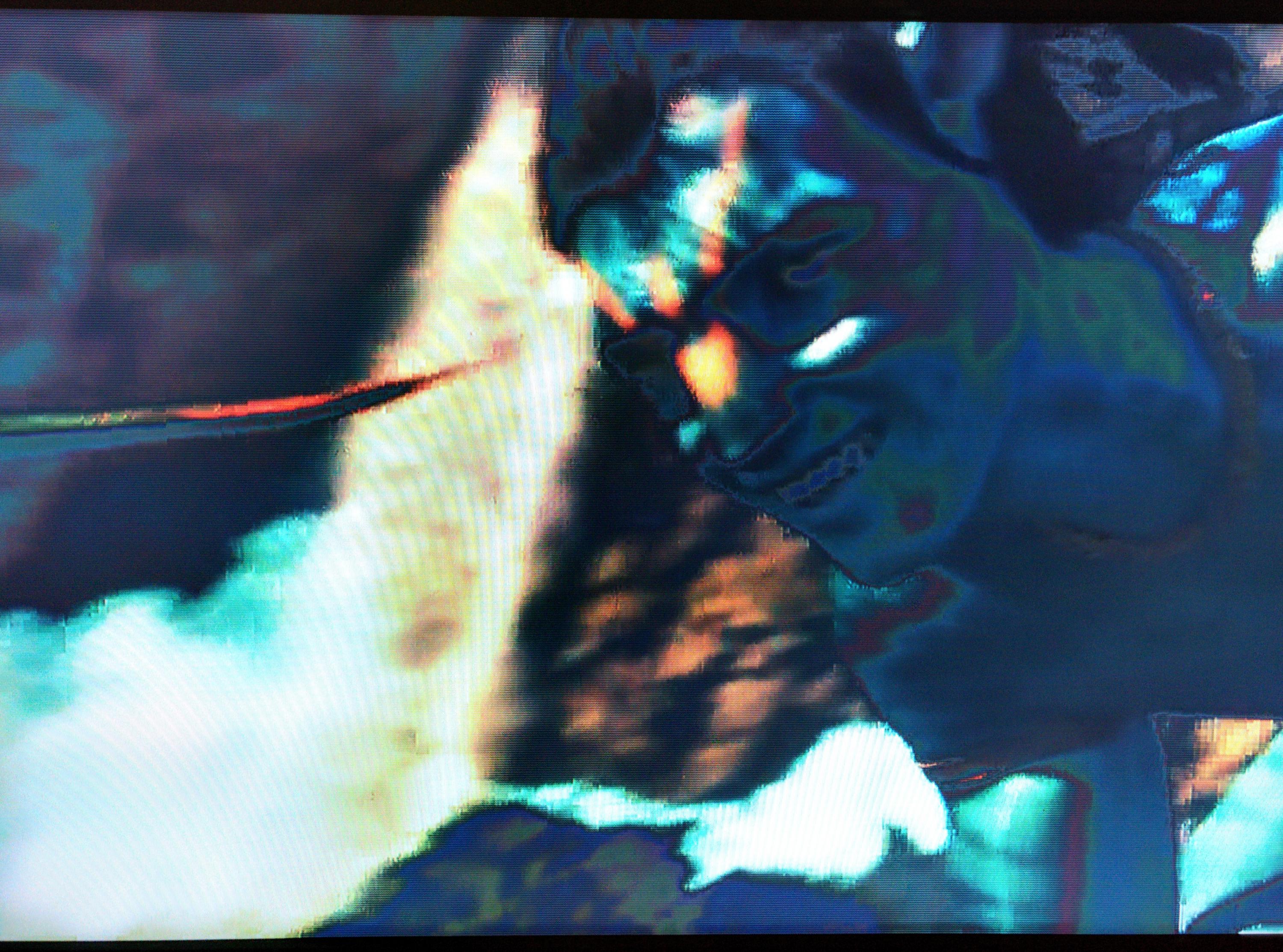

    I recently picked up a Samsung LN32A330, specifically LN32A330J1D, that was having issues with displaying the correct colors. At first it looked like everything had a red tint but I realized that all of the colors just look terrible in general.
    On the software side, I have:
    -Seen that all inputs are affected
    -Tried messing around with the color settings through the menu
    -Done a factory reset
    On the hardware side, I have:

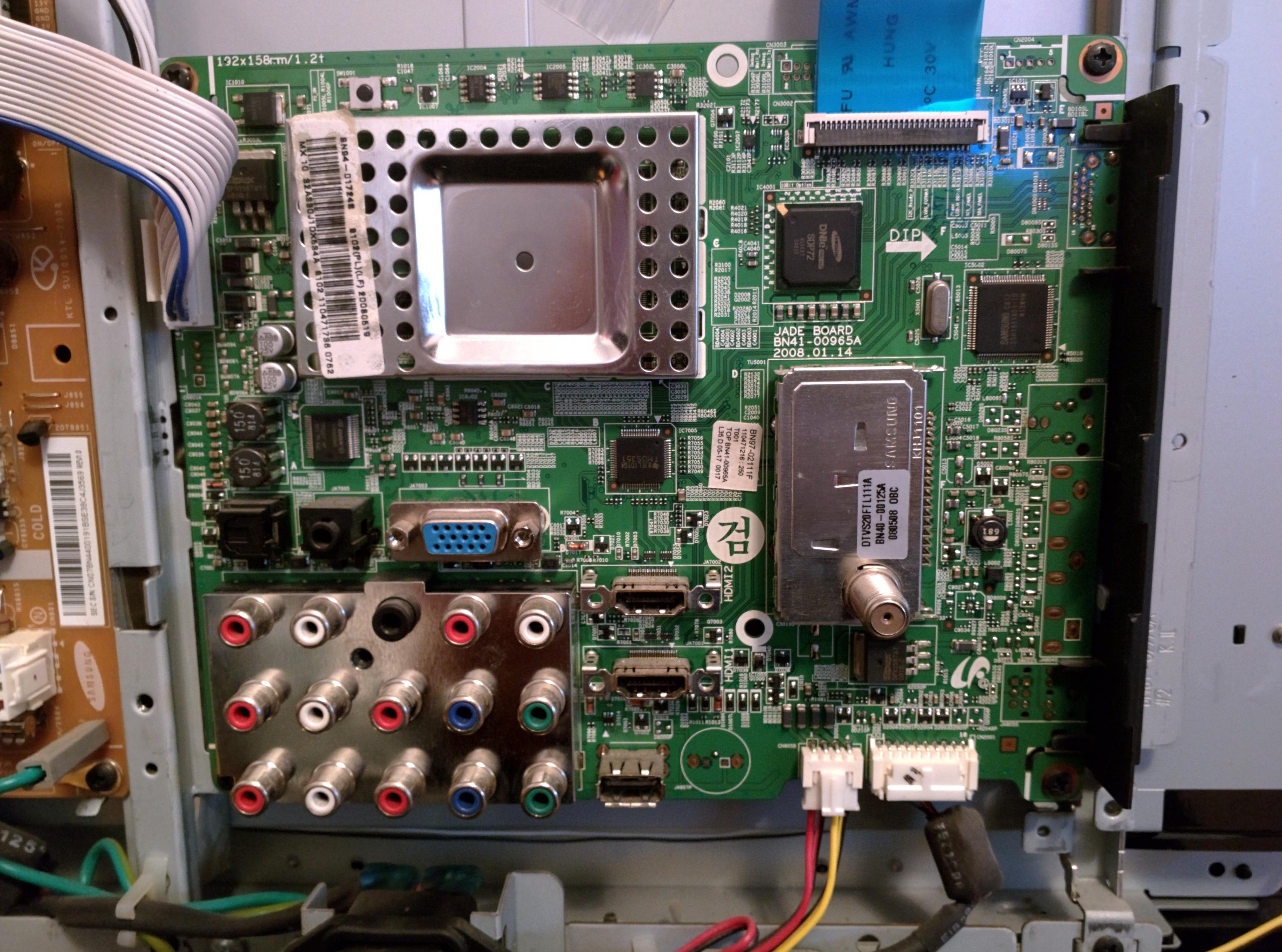

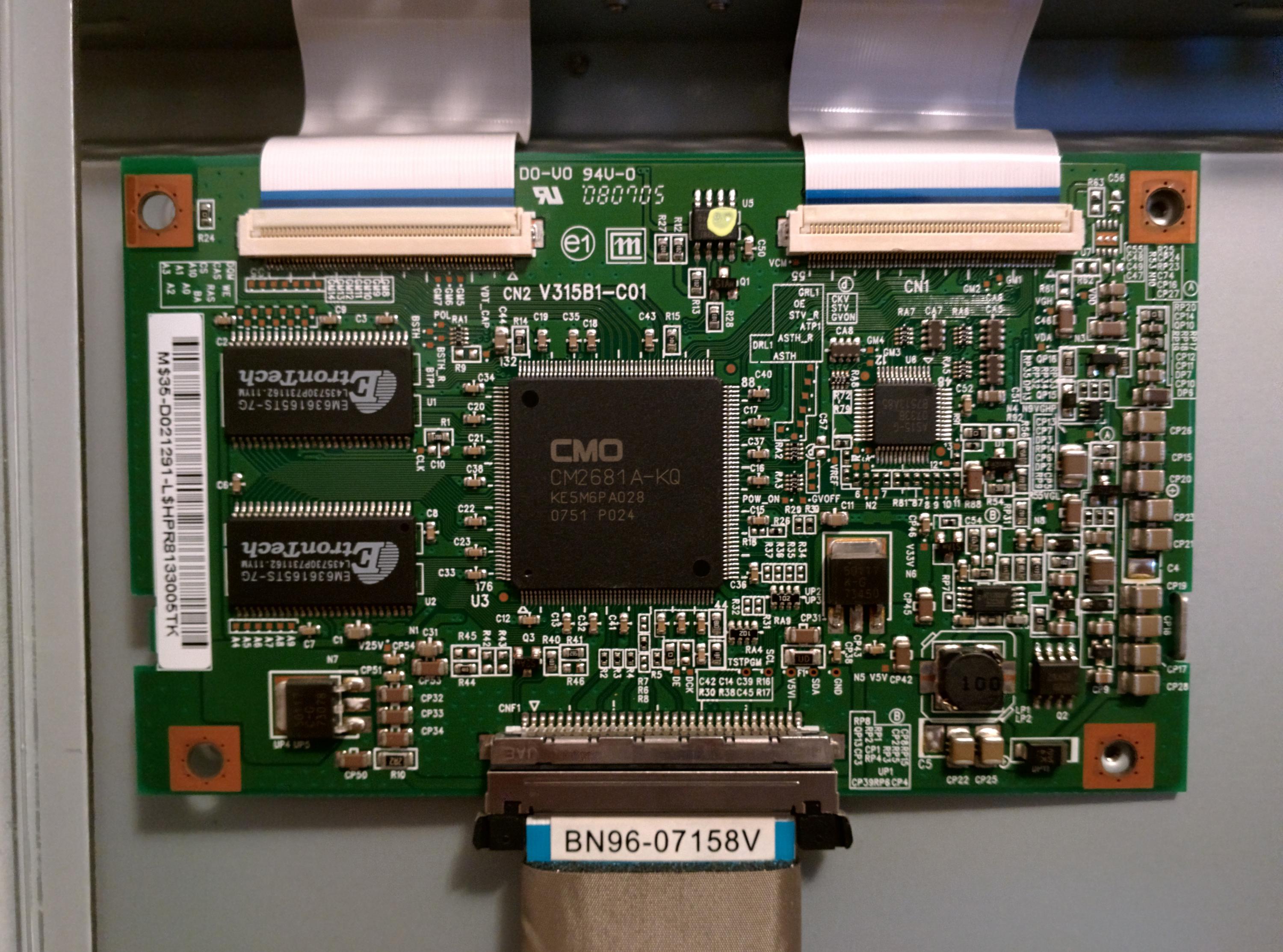

    -Re-seated the LVDS cable on both the main board side and the T-CON
    I am thinking at this point that the T-CON may need to be replaced but I figured I would post here to see if anyone had any other suggestions or tests to do before spending the money.
    I appreciate any help you all can give and will try to be as prompt as possible with getting any requested pictures or multimeter measurements.

    Bad Gamma Voltages, due to bad AS15 GAMMA Voltage ref. IC.
    PCBA (PCB ASSEMBLY) # 35-D021291

      Yes almost certainly bad gamma IC, it would be possible to test if you have a digital multimeter. Replacement is easy if you have done surface mount work before. Otherwise a new T-con or a repair to the T-con is necessary.

          Meter in DC V 20V scale or auto, TV turned on, black probe on the metal chassis, red probe on GM1~GM14 test pads on the T-CON board, write down each reading with the GM# next to the reading.

            Alright, the readings were:
            GM1: 13.08V
            GM2: 10.67V
            GM3: 9.90V
            GM4: 9.34V
            GM5: 8.86V
            GM6: 7.14V
            GM7: 6.82V
            GM8: 6.61V
            GM9: 6.20V
            GM10: 5.04V
            GM11: 4.96V
            GM12: 7.55V
            GM13: 3.30V
            GM14: 6.30V

              Your readings confirm the gamma IC is bad,.
