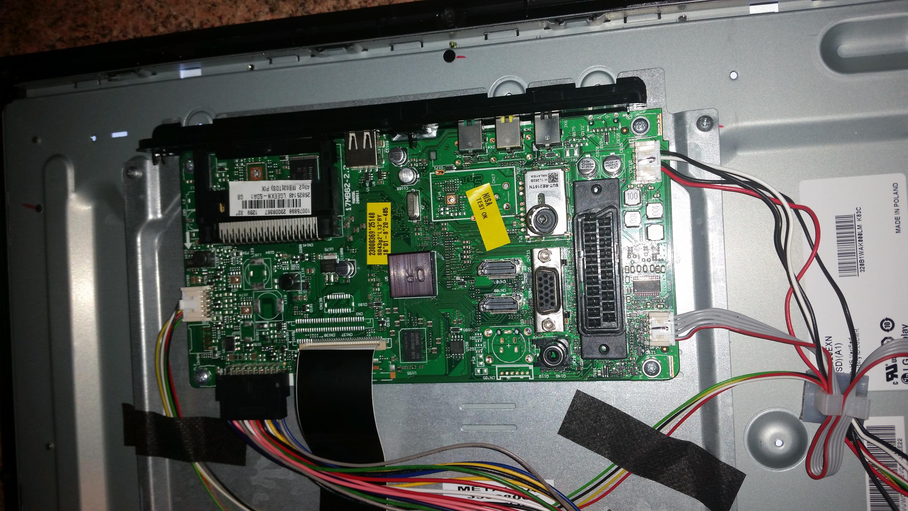

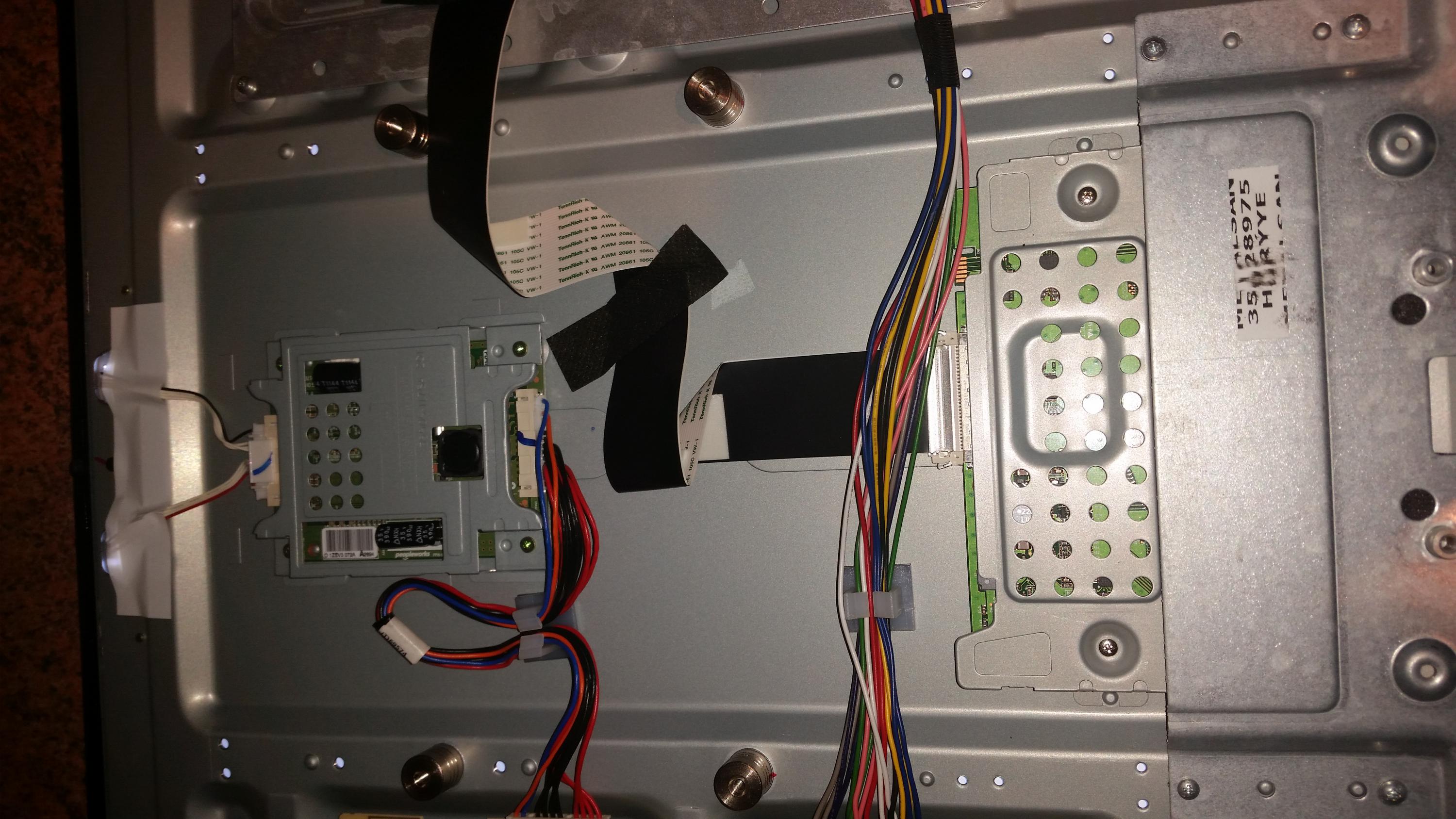

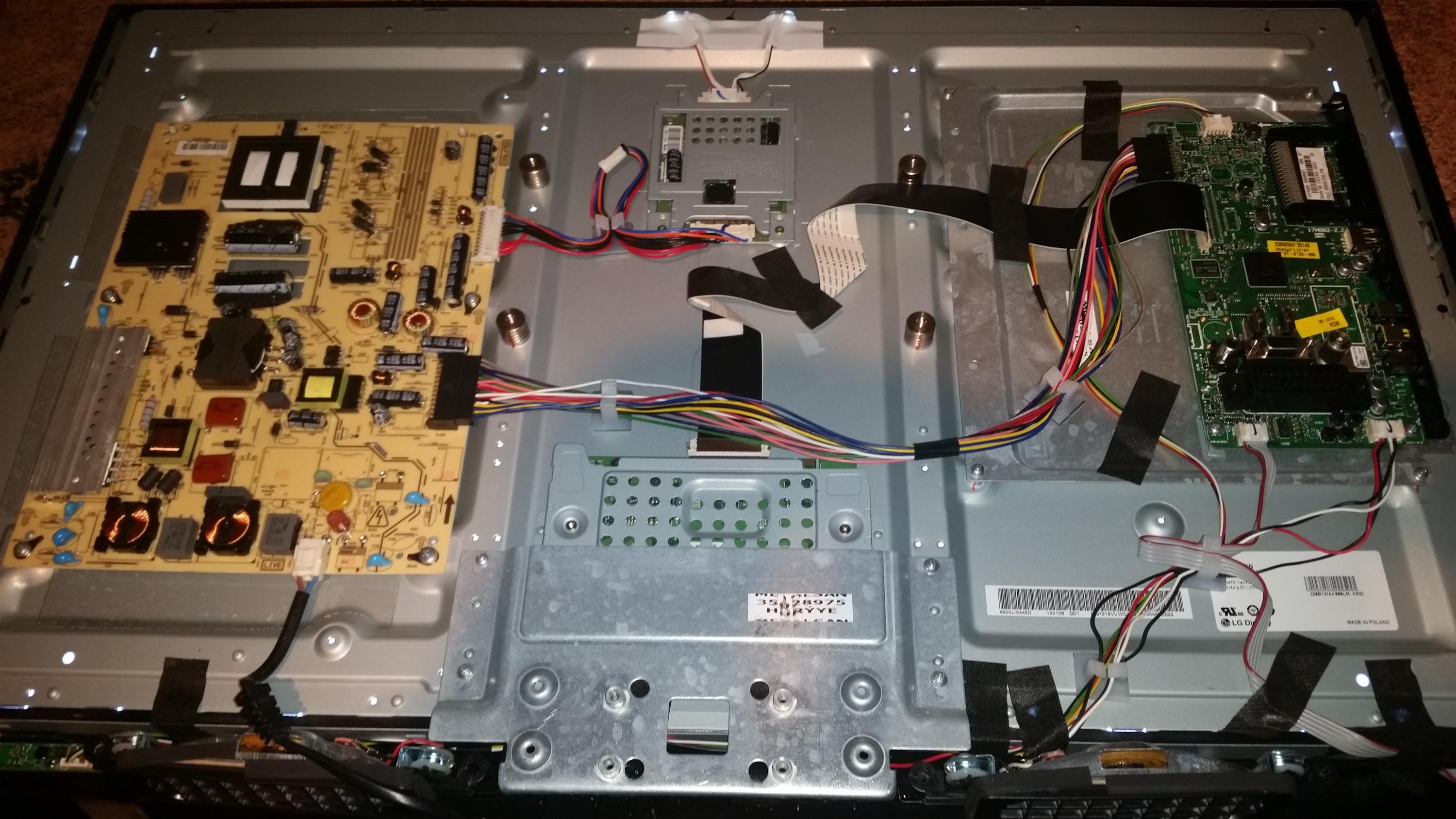

    hi guys
    ive uploaded a video to show the fault plus pictures anyone came across this fault before ?

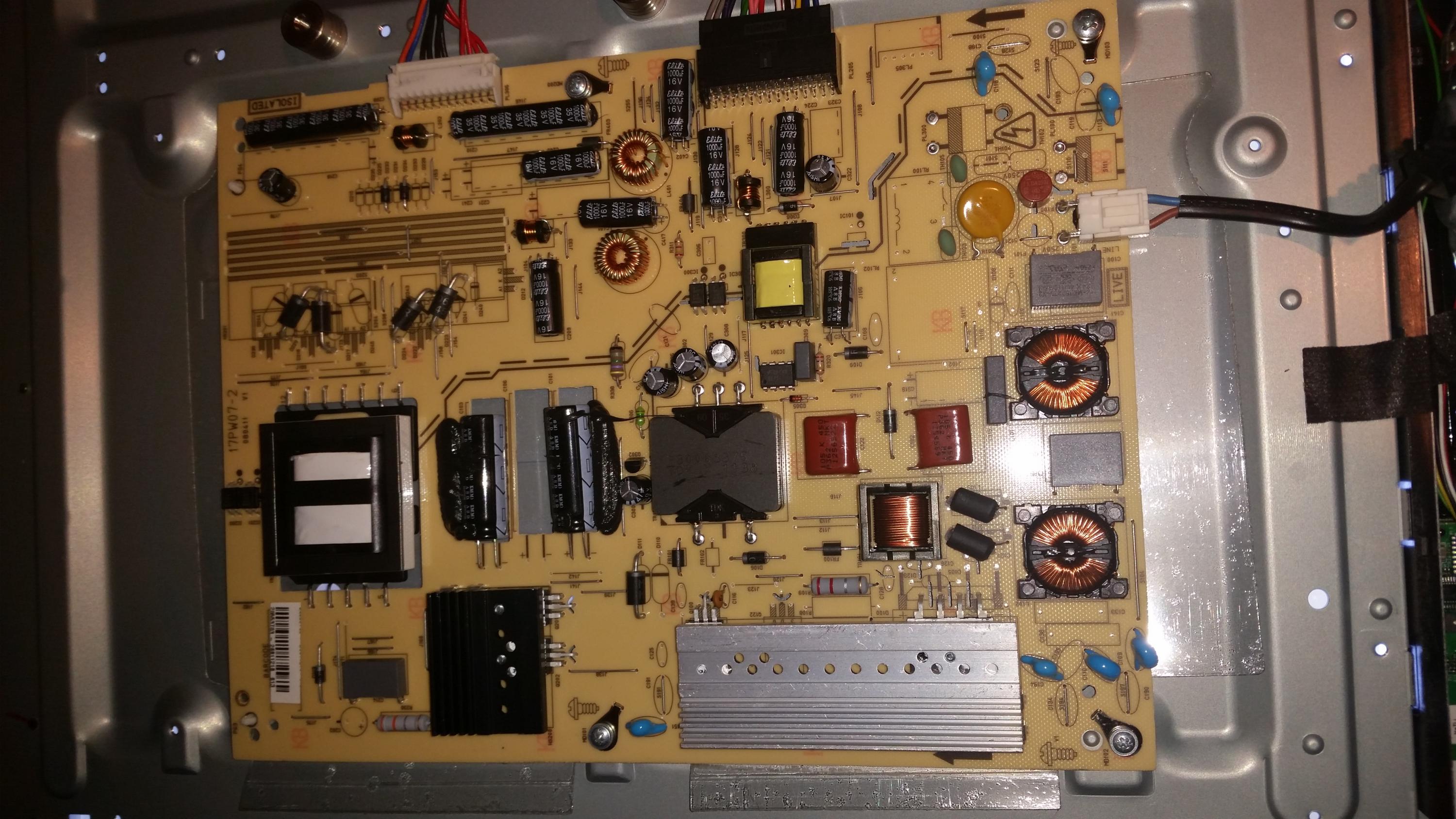

    update:
    i have checked all voltages all seem fine
    bad panel ?

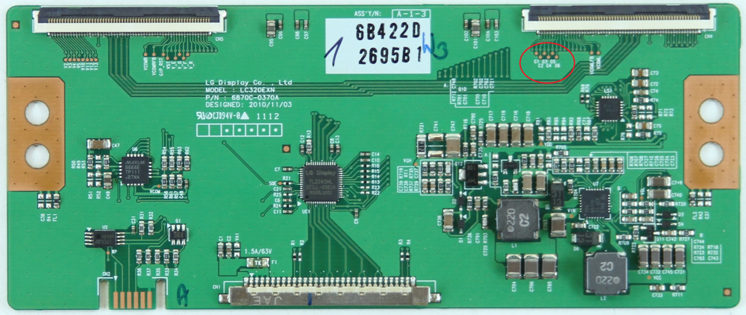

                I had a non-intermittent issue similar to yours caused by a failed diode on the T-con board. TV has worked for my sister for over a year after this repair:
                https://www.badcaps.net/forum/showthread.php?t=33134

                  ok ill try the freeze spray i have also noticed that on some test points on the tcon board the voltages are not stable but all others on psu,main are fine could this be tcon related then ?
                    Re: Toshiba 32L502B
                    Yes it's possible, ones to watch out for are VGH and VGL (maybe VONE and VOFFE on some boards)

                      Re: Toshiba 32L502B
                      VGH is staying steading at 26.5 volts
                      its the other test points i have shown in the uploaded picture that are not staying steady,when the picture distorts the voltages drop

                        i thought ill go back to the tv today but upon turning on the tv i now have nothing totally dead but the touchpad still beeps,i still have 24 volts to invertor and voltages going to the main board

                                  Try isolating T-con from main board. Whatever may be failing on T-con or panel may have shorted altogether. See if you get a backlight.

                                        ive also noticed today that U5 in the picture attached is getting really hot !
