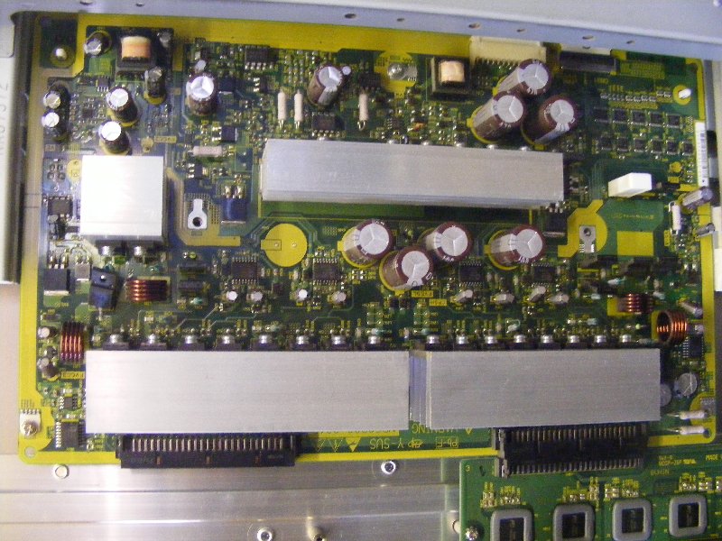

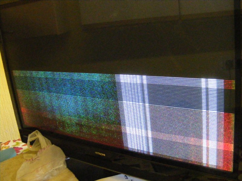

      Hya, thankyou for your help. Just what I needed. I put the boards back, and just the lower buffer which looks ok. Powered up and here are the pictures as requested.

        Looks like there's issues with either the Y-SUS and or the bottom buffer board too.....
        On the set I did, I had a half picture--that was perfect, but it was my bottom buffer that had failed
        Buffers for these sets are horrendously expensive--at least they were when I looked for one a little while back, I ended up re-chipping the one I had.....

                    Check 3 pin voltage regulators cx31 at top of board near heat sync and another one like it at the bottom there most likely shorted. Also there may be another smaller smd style transistor at the bottom near the regulator shorted as well. I'm almost guaranteed or shorted looking at the bottom buffer board in the output showing up on the screen. This particular model tv will still show a perfect bottom if the top buffer is not connected.

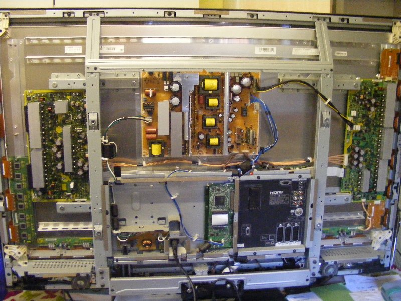

                        On a different subject not related to the YSUS and buffer problem -- Are the two large capacitors on the upper right of the power supply bulged or is it just the picture making them look that way? They look bad at a glance.
                        • Moggy
                          • Oct 2014
                          • 21
                          Re: Hitachi P50TP01U A Buffer board blown
                          They do look bulged, I removed and tested with a ESR meter and checked fine, but I thought the same.

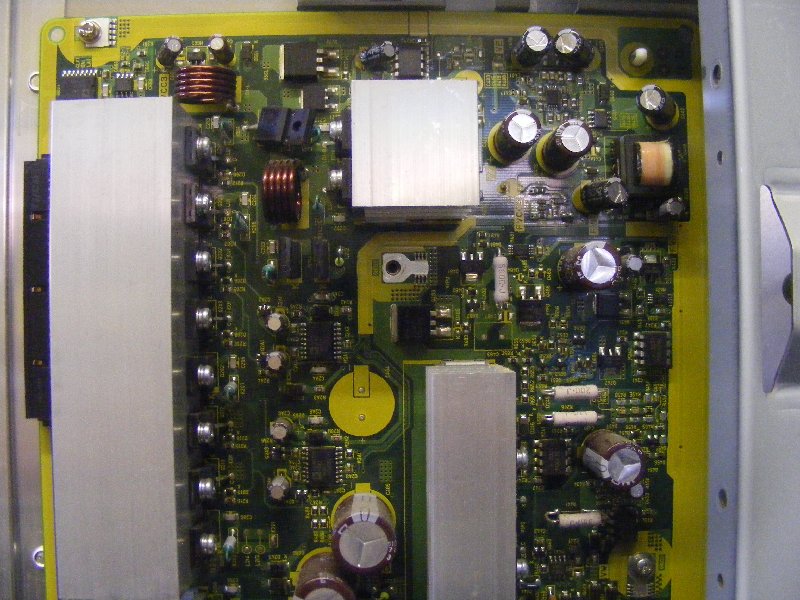

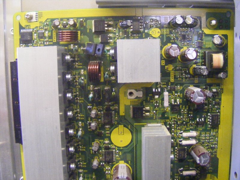

                            freakaftr8 thanks for the reply, have been off for a few days, which board are you referring to, I can't see these parts on the ysus board.
                            • freakaftr8
                              • Oct 2012
                              • 3743
                              Yes the ysus board. Right at the top and bottom of the connect for the buffers you will see 3 pin transistors on the board. One on the top and one on the bottom. Top is called cx31
                              Bottom cx-- something to the liking. See if they are shorted. They are very small.
