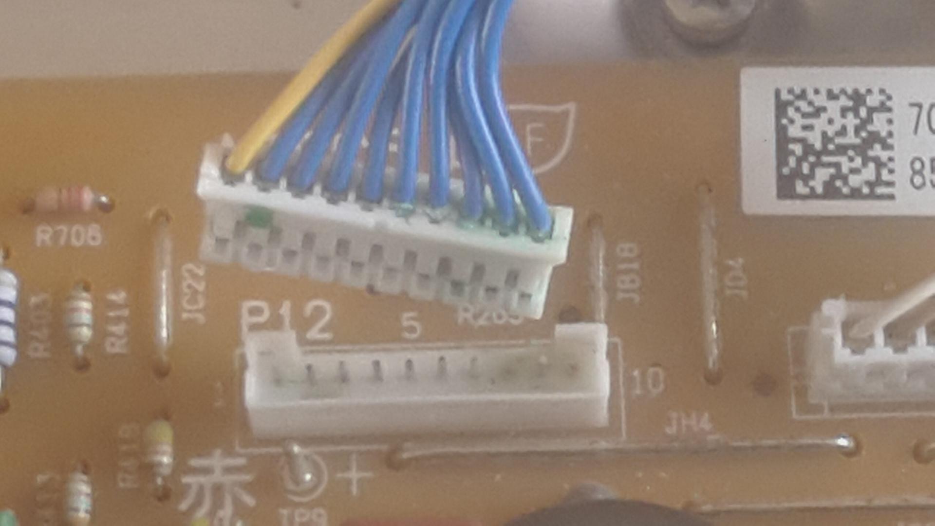

    Just reading this in AVS. Quite incredible the damage. No wonder 8 blink. P12,SS12, ss35 ,
    panel switch, 15v, Vda
    Notice the pins now gone completely.
    http://www.avsforum.com/forum/167-pl...l#post29218282

    Odd fault, maybe water leakage onto that board?

      What about bad earth?? have you heard of black wire or seen leads on rechargeable sockets fall off. many years ago when i did RC planes, common issue with guys losing Aircraft was the negative lead rotting from corrosion and I believe it was to do with recharging the battery packs through a socket and external charger.
      Maybe that TV is in a high humidity area.
        Re: TH50-PZ800u - 8 blink- electrolysis
        Could be humidity/water/chemical damage, corrosion on battery terminals is due to sublimation of chemical components or so I've been told, so it's unrelated.

          This is my TV. I live in the Eastern Caribbean and yes, it is VERY humid down here. I'm wondering if this TV is now a write off..
