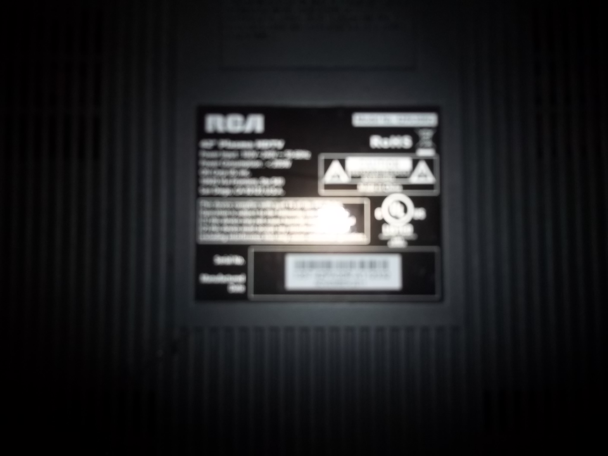

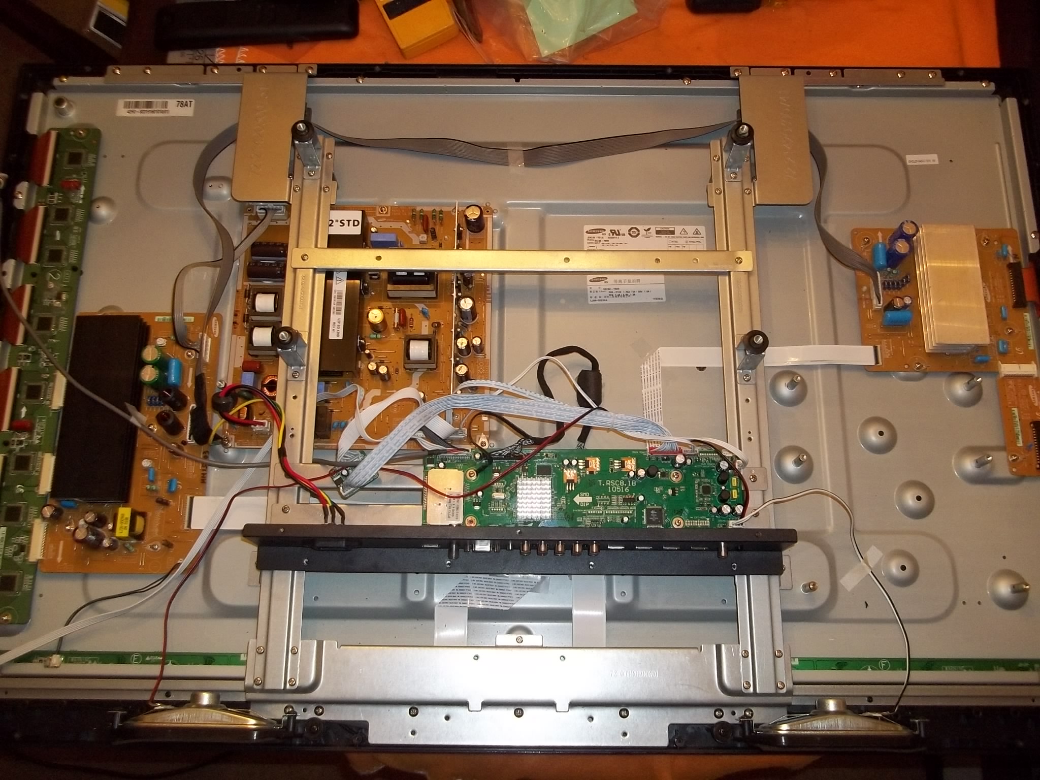

    I'm trying to troubleshoot this RCA 42PA30RQ. It clicks on then clicks off right away. I did the disconnect test and have narrowed it down to the T-Conn board (I think) When the T-Conn board is disconnected from Power Board it only clicks on. When connected on then off. Tried disconnecting all the other connections to the T-Conn but still click on click off...Bad T-Conn? Or? None of the other boards affect it connected or not.
    Serial Number: 1357-42PA30R-A112332 MFG DATE: NOV 2011

    Most likely, Y-main/X-main/Y-buffer fault.
    The controller / T-con will send the on/off signals, but just because these go away with it disconnected, does not mean it is bad.

          After replacing the ymain, xmain and y buffer it works like new...nice tv. It also has the tuner that will get the hd cable channels we have here on channels 1005-1011 without a cable box.
