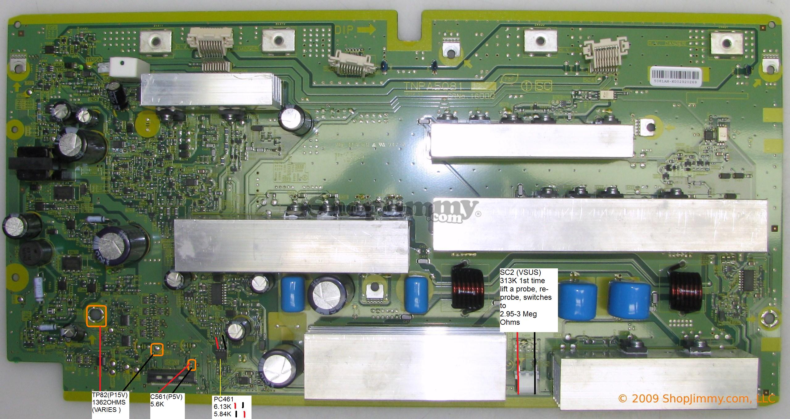

                                  Once you've decided you're going component level on this and not returning the board, then remove Q621 and 622, recheck associated diodes. you know these are common cathode A-K-A so outer legs will show short A-A.

                                      most definitely. I just need to feel confident you're on the ball, sounds like you are. Plenty brush through , jump in, fail and then go back to where I suggest only to find they've missed a shorted IGBT.
                                      So to keep things clear, I need to know whether in cct or not for those diodes as i find those ones survive and once the 30F125 are removed are ok but i will have to spend some time sifting through my other thread for results. I think I'll have to start collating in excel for quick ref. i have had a board with very little replaced, i think 7 parts in toatl. that's my lowest count so far, usually more.
                                      i'll get a photo of the 42' and circle the bits i know have failed. with Q661, these need to be checked and i'd suggest replacing regardless.
                                      IC773, Q701,702,818,
                                      check d702, check ic771, check PC461
                                      Have you got the schematic for the SC board?

                                        Re: Panasonic P42G20ES
                                        some resistance checks i had saved
