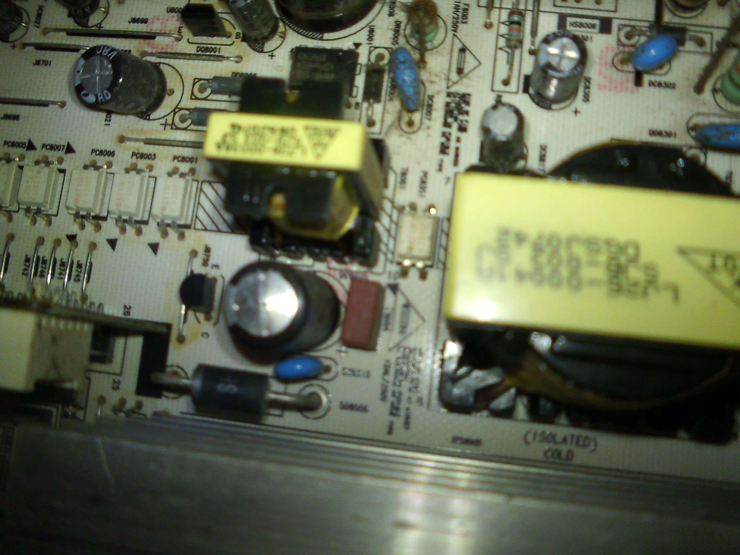

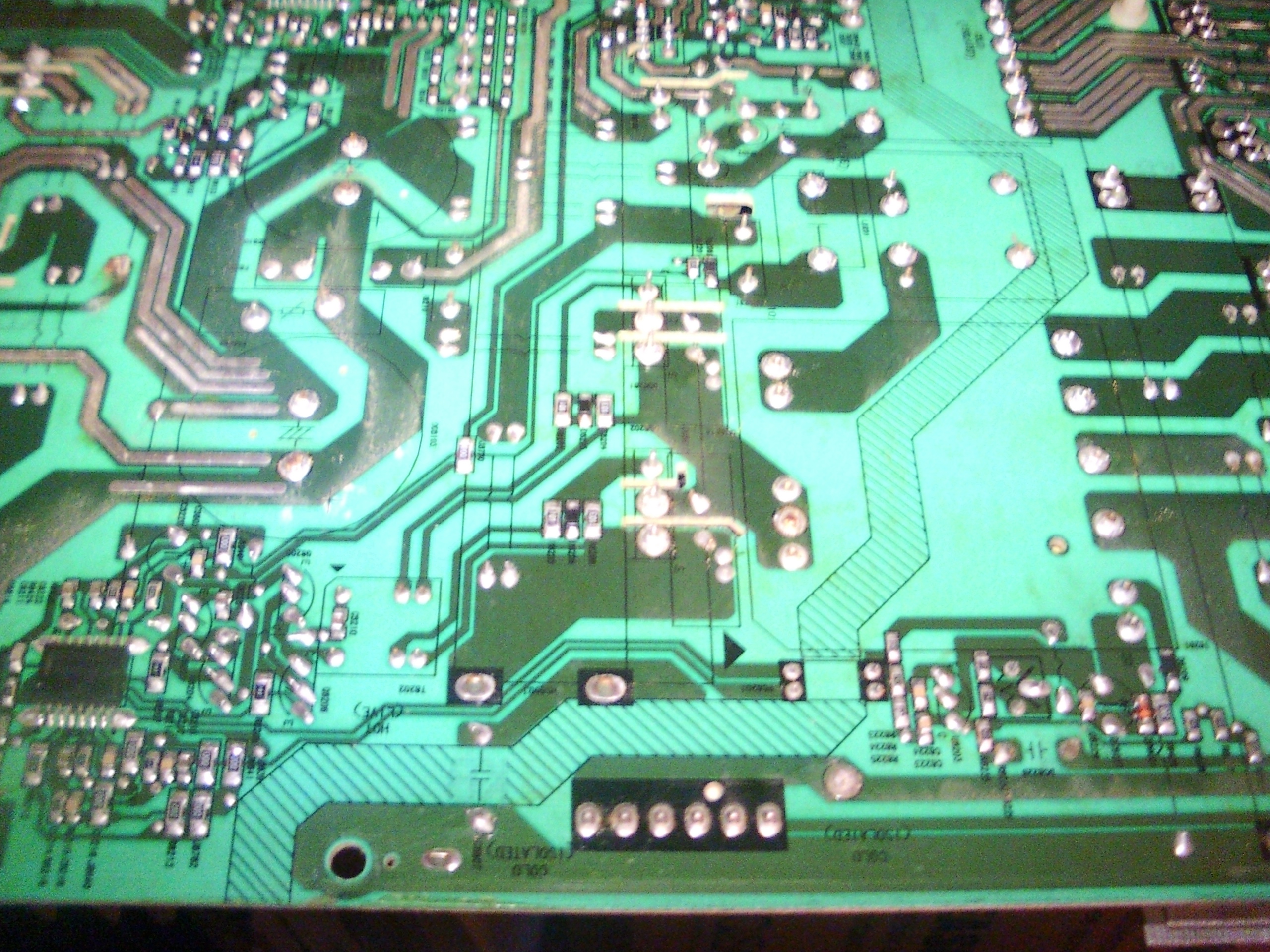

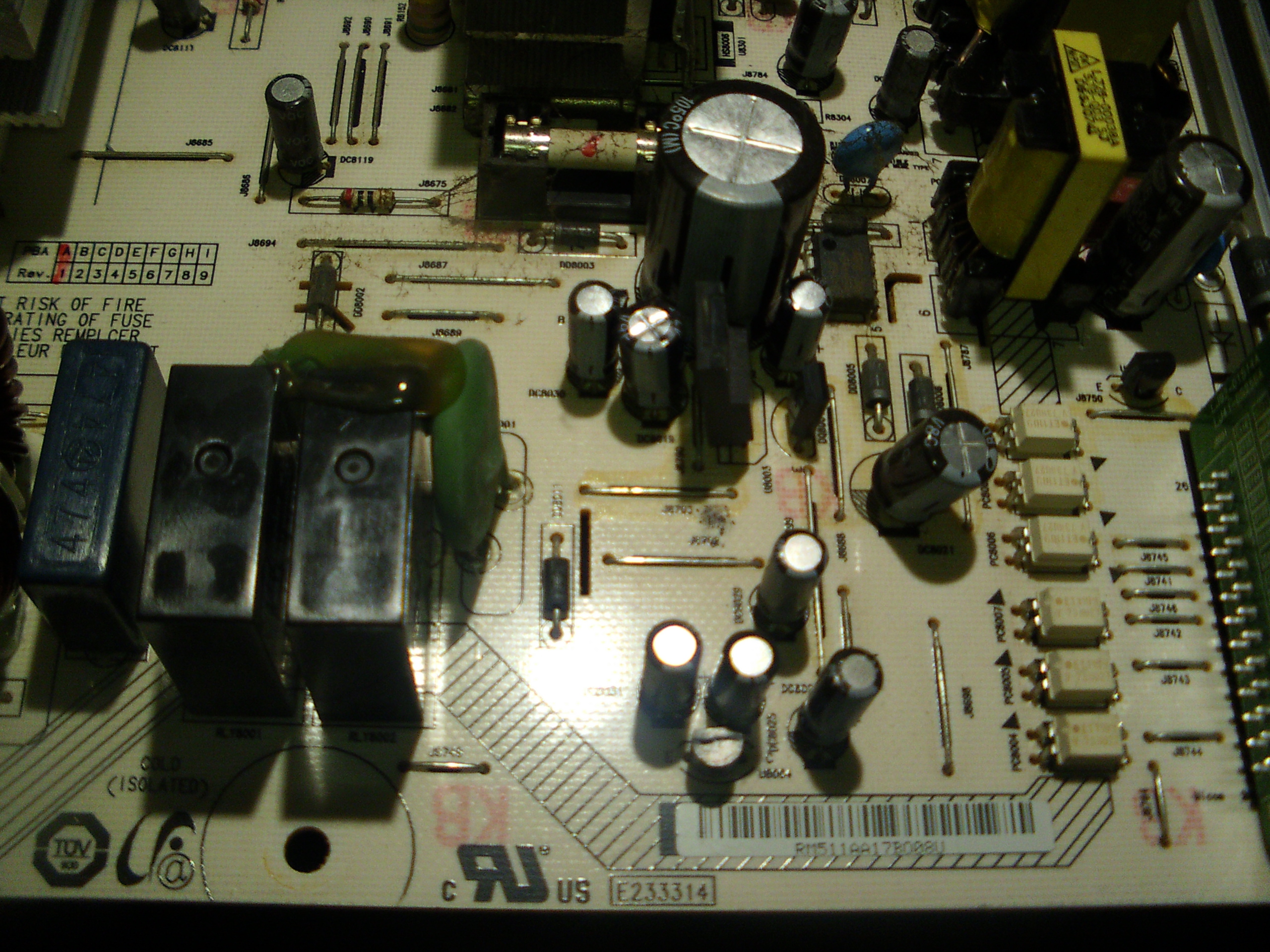

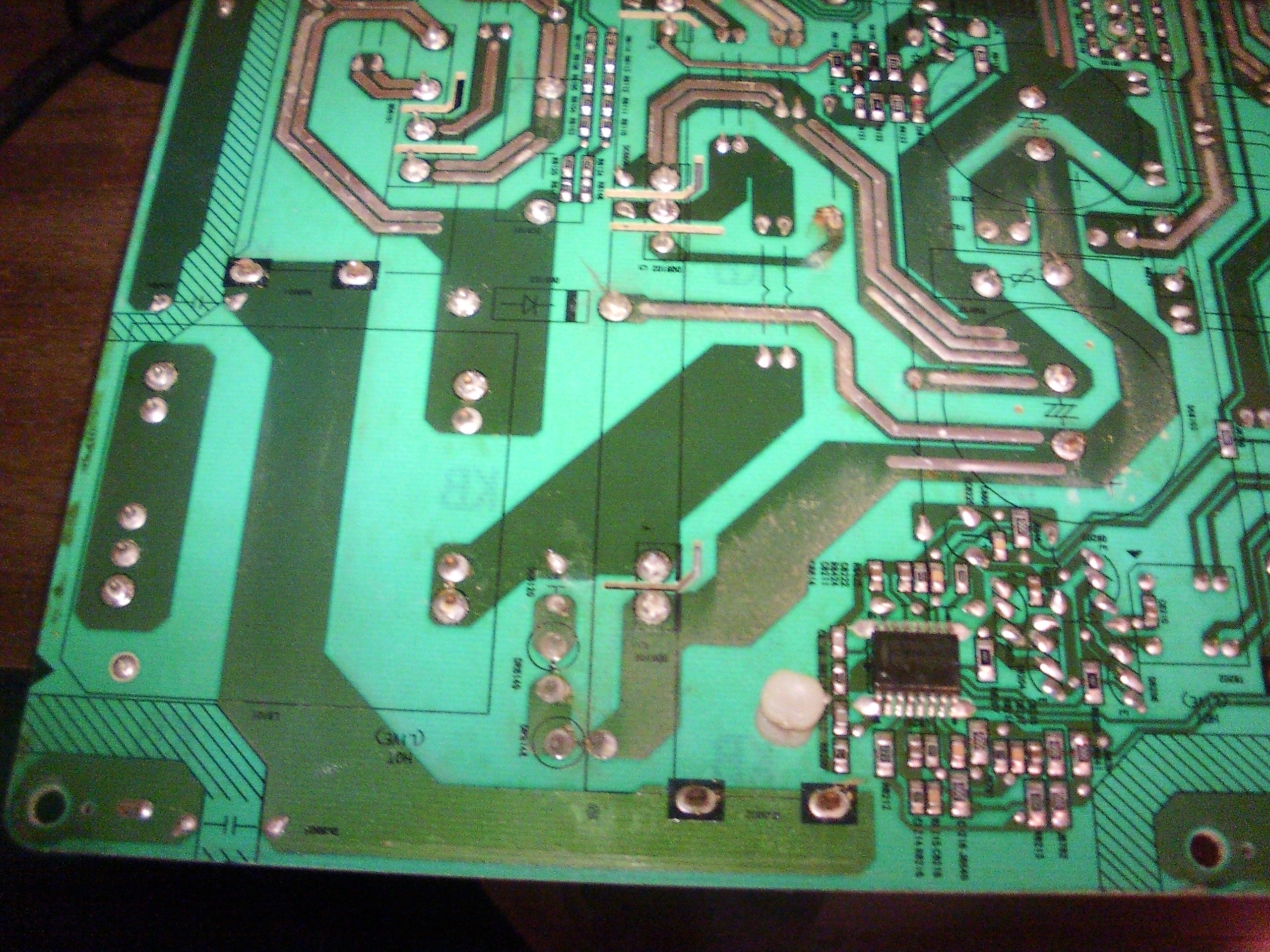

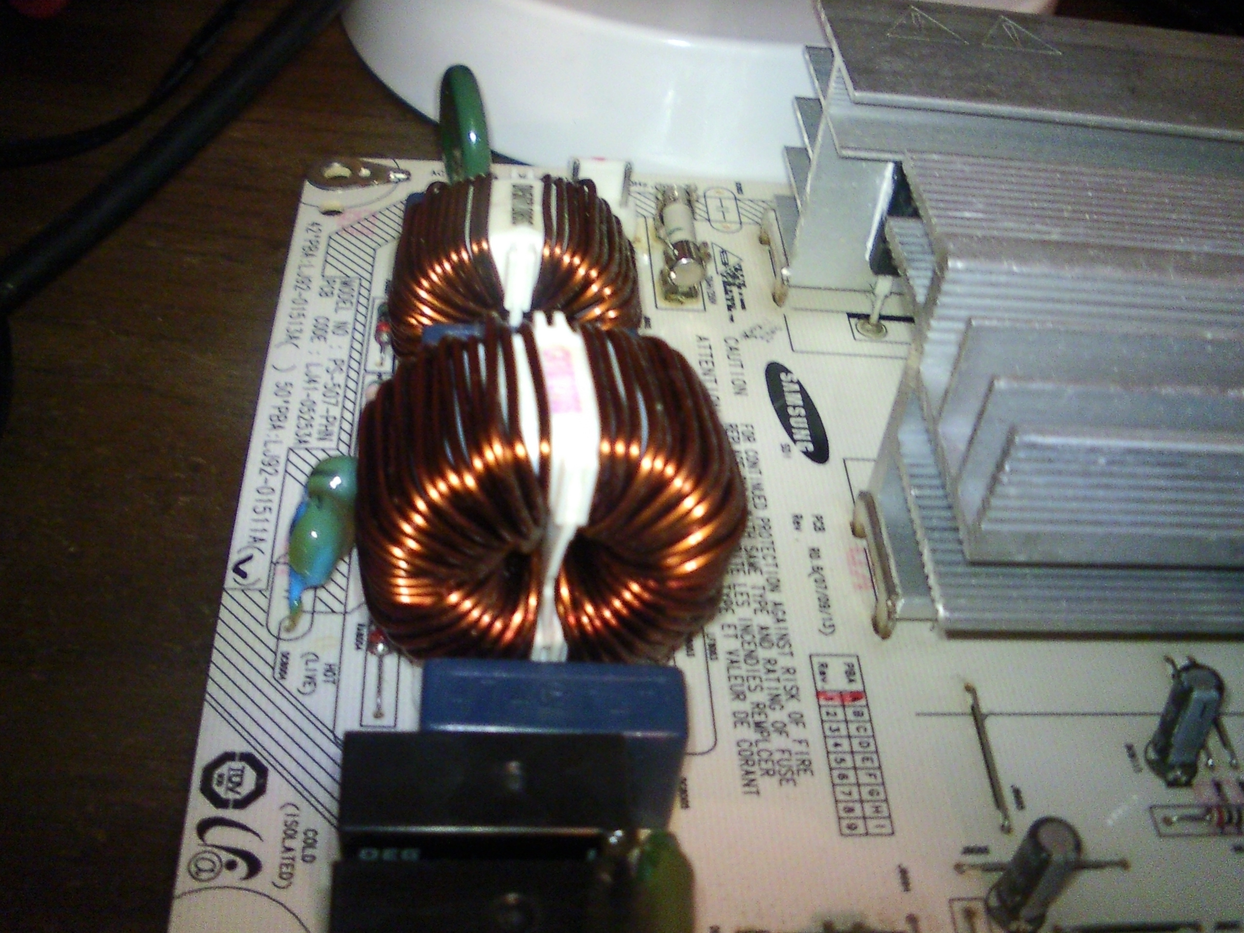

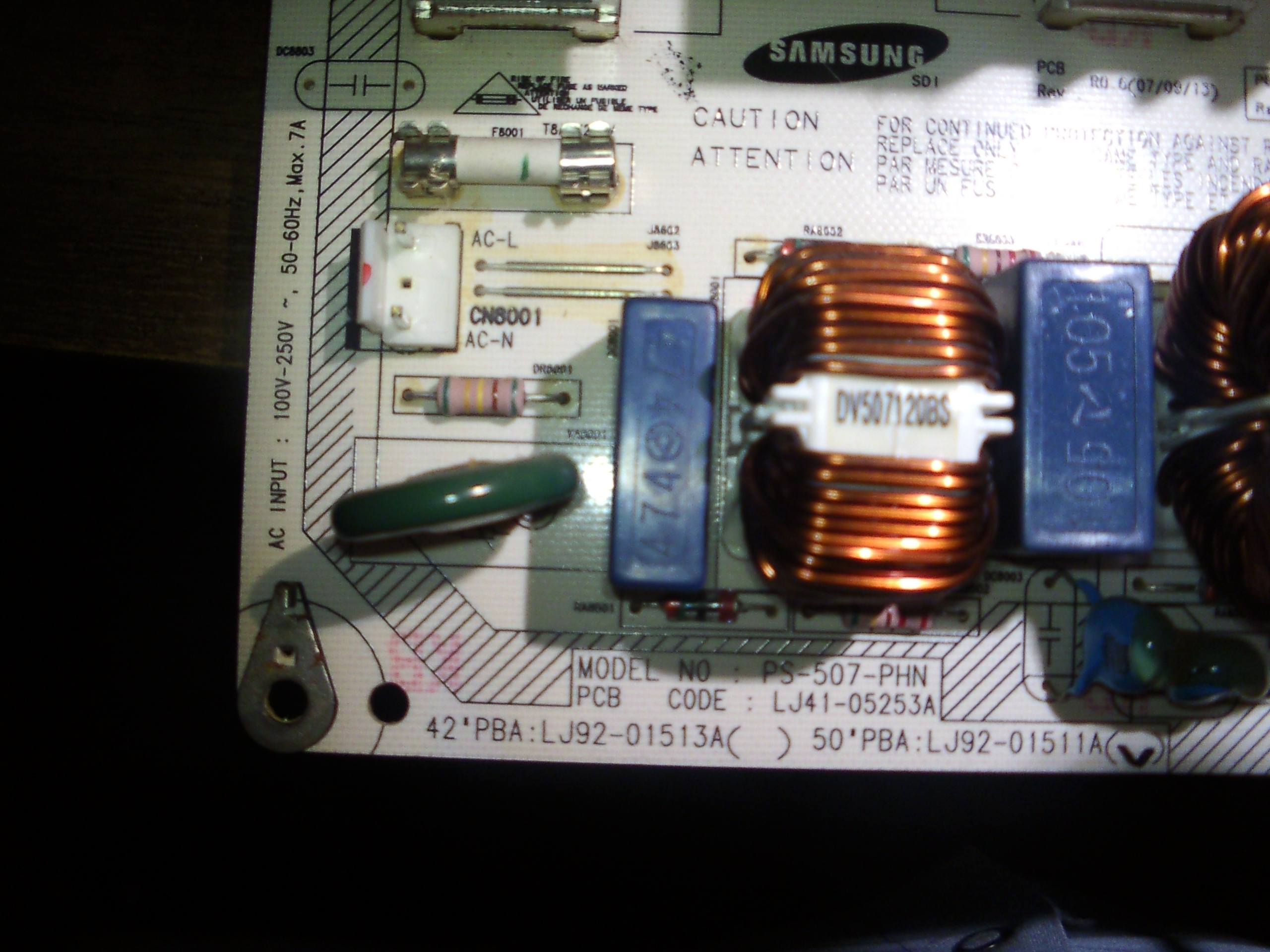

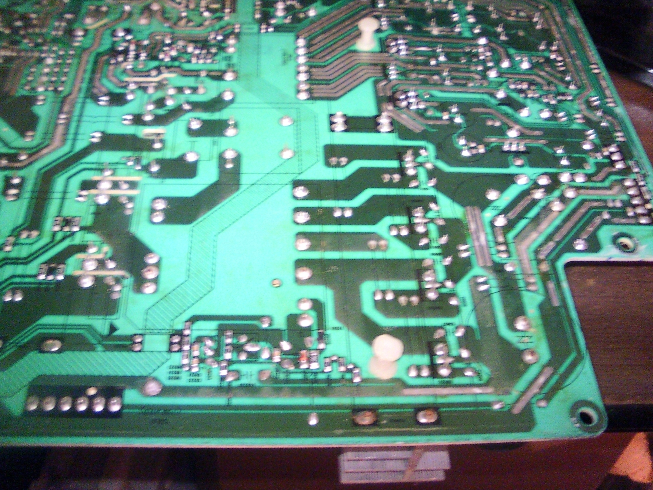

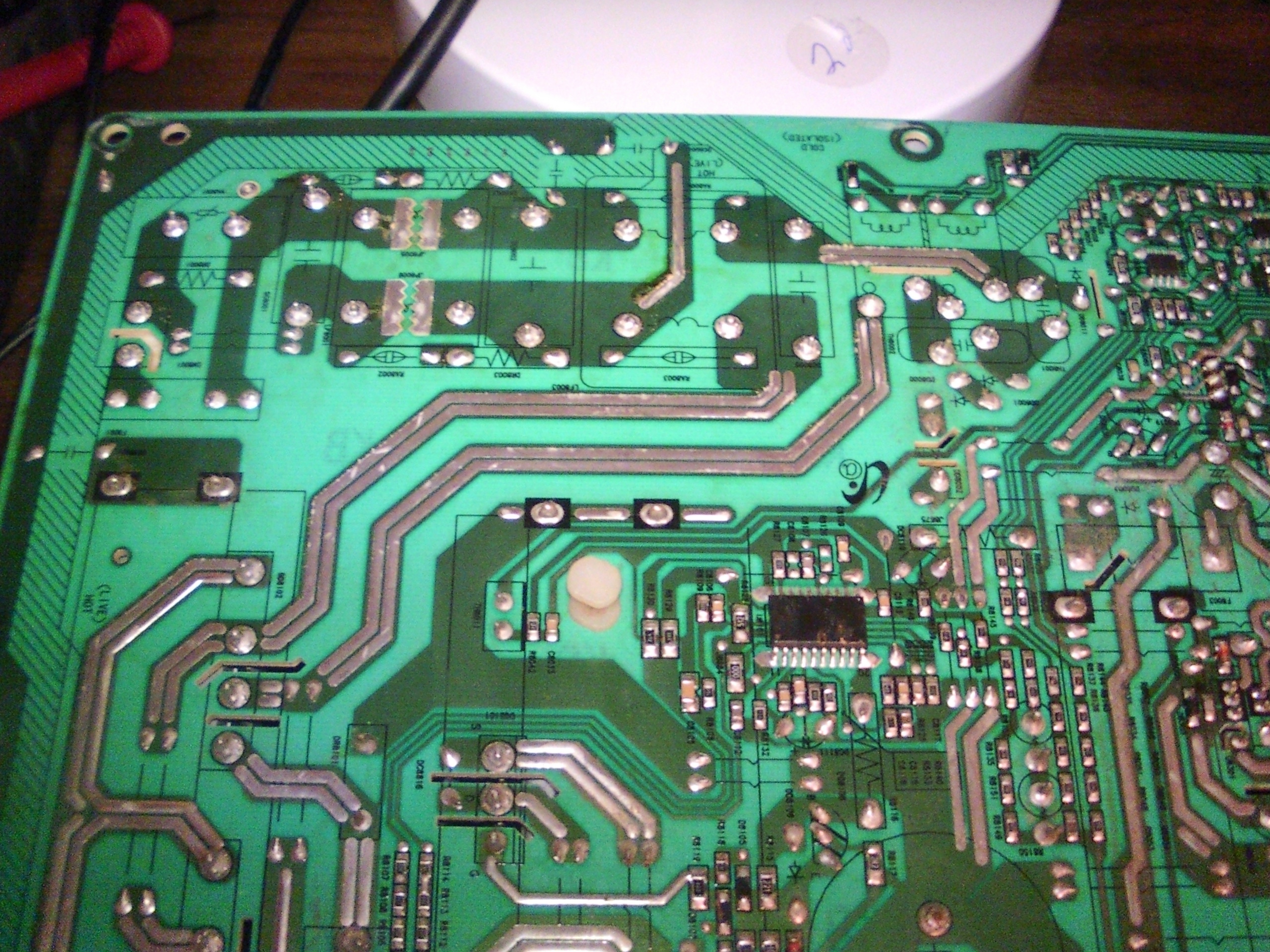

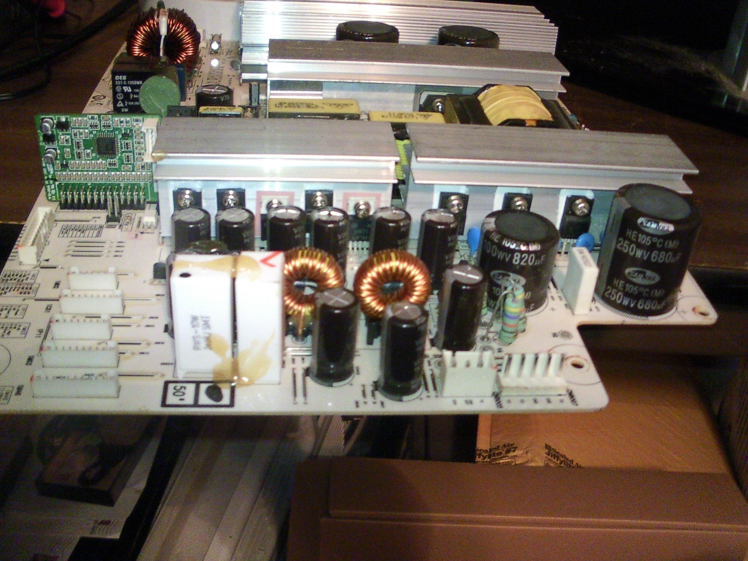

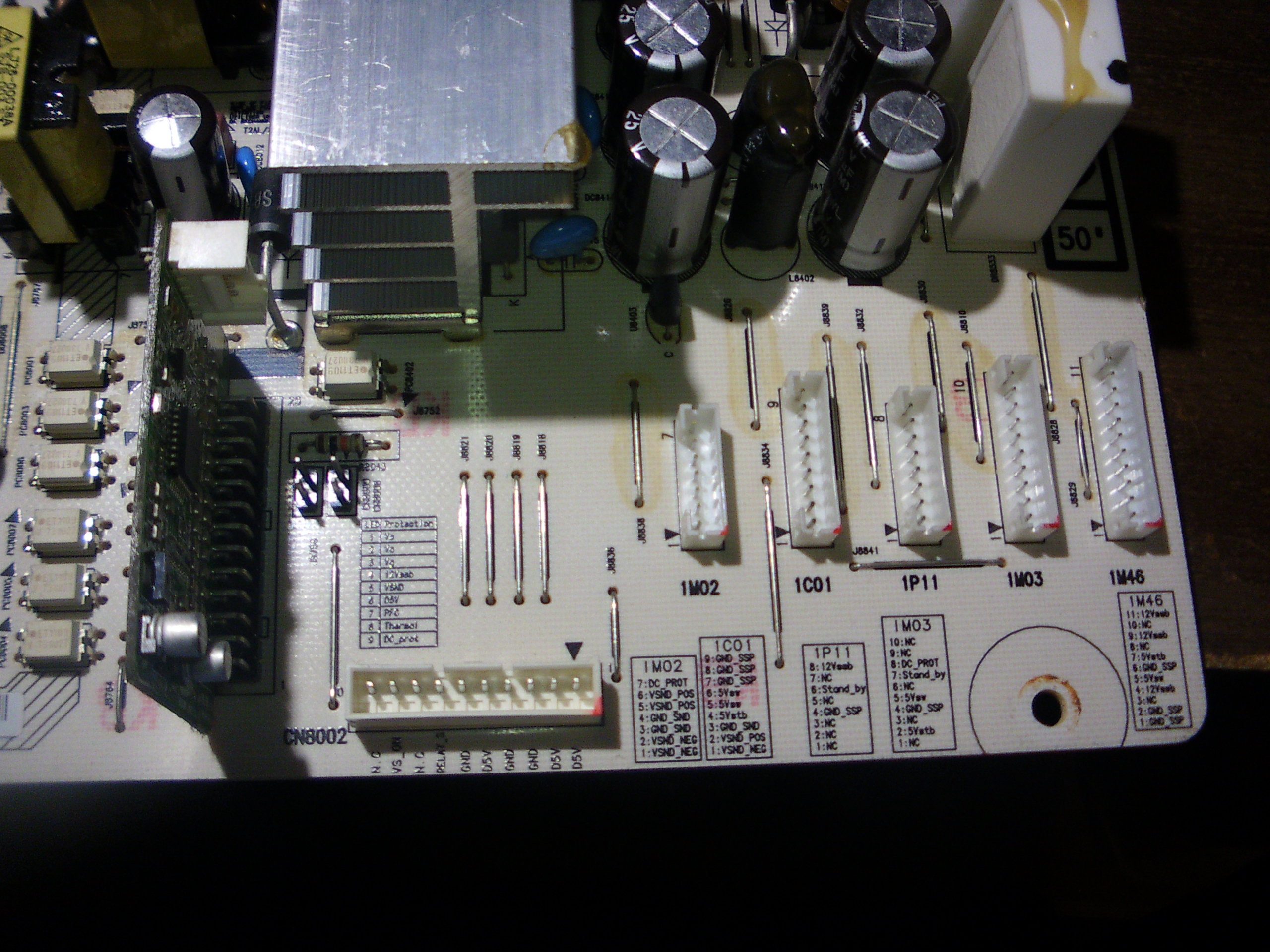

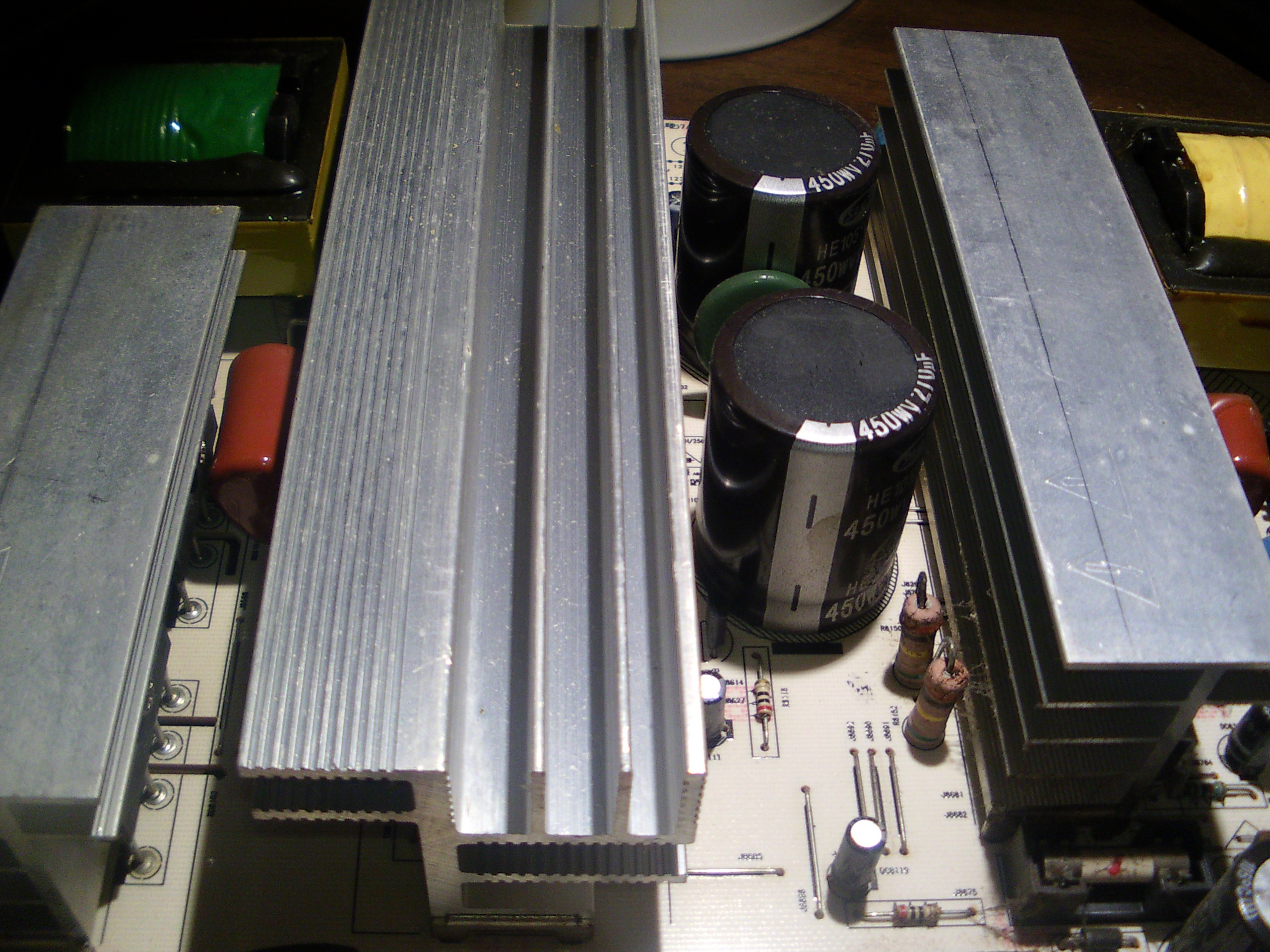

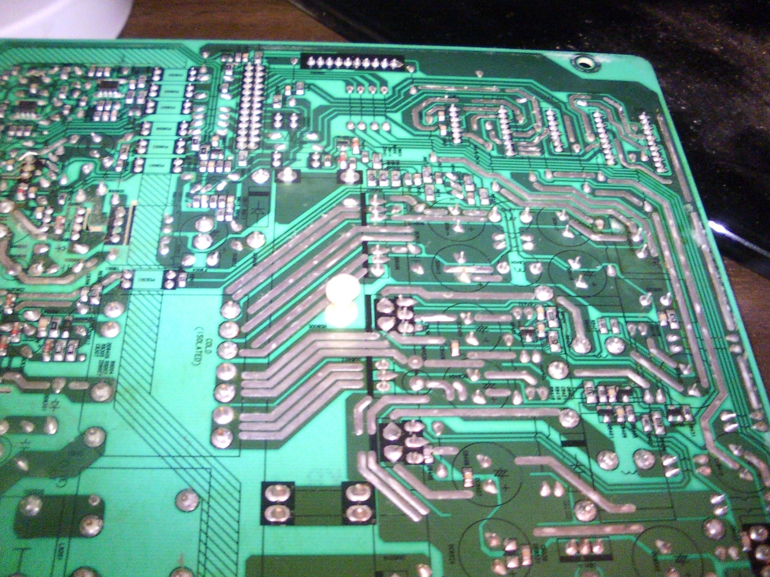

    At any rate. Picked up a Phillips 50" Plasma with the model number in the title. Guy stated it had a bad power supply board. Yeah, it's bad. It has several capacitors with domed tops and even some yucky leakage from one. The 5volt standby line has only 0.430 vdc on it. And the small board is flashing "7" (or 7 flashes in a row...pause....then 7 again)
    So yep, caps are in line to be replaced. Just wondering what other surprises I should expect from this set? First time working on a plasma, and am pretty excited to see it through.
    Pics are also included for your viewing pleasure.
    It's a lot of photos, but I wanted to ensure we have all the info needed.

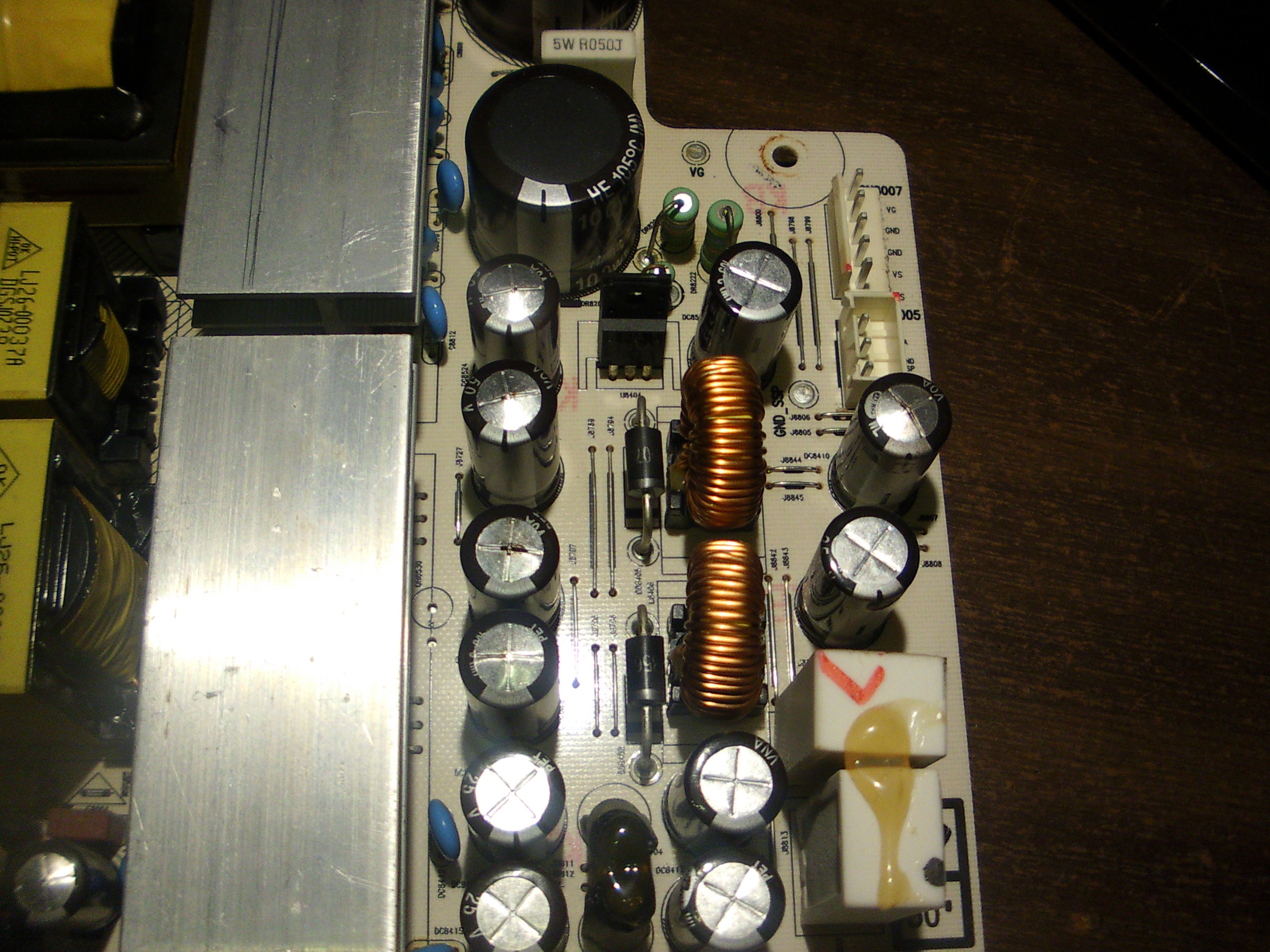

      Minor update. Played around with the power supply while waiting for the cap kit.
      We had 5 volts for a short while. The 12vdc is present on the pin, but buckles under load. With everything plugged in--The board would just go 'click click click click'.
      So when I unplugged the connector that sends the 12vdc to a smaller board that is kinda tucked away- The power supply board came to life. with no error codes on that mini board.
      Now it's to the point where with everything unplugged, except the A/C- The mini board is flashing a code for the 5 volts (6 flashes) and the board clicks 'on...and then clicks off a moment later. And it continues to flash the error 6.
      Anyone have any ideas here...or just throw the cap kit at it and see what happens. I'm a bit amazed that the P/S did start to function--and now has totally taken a crapola.

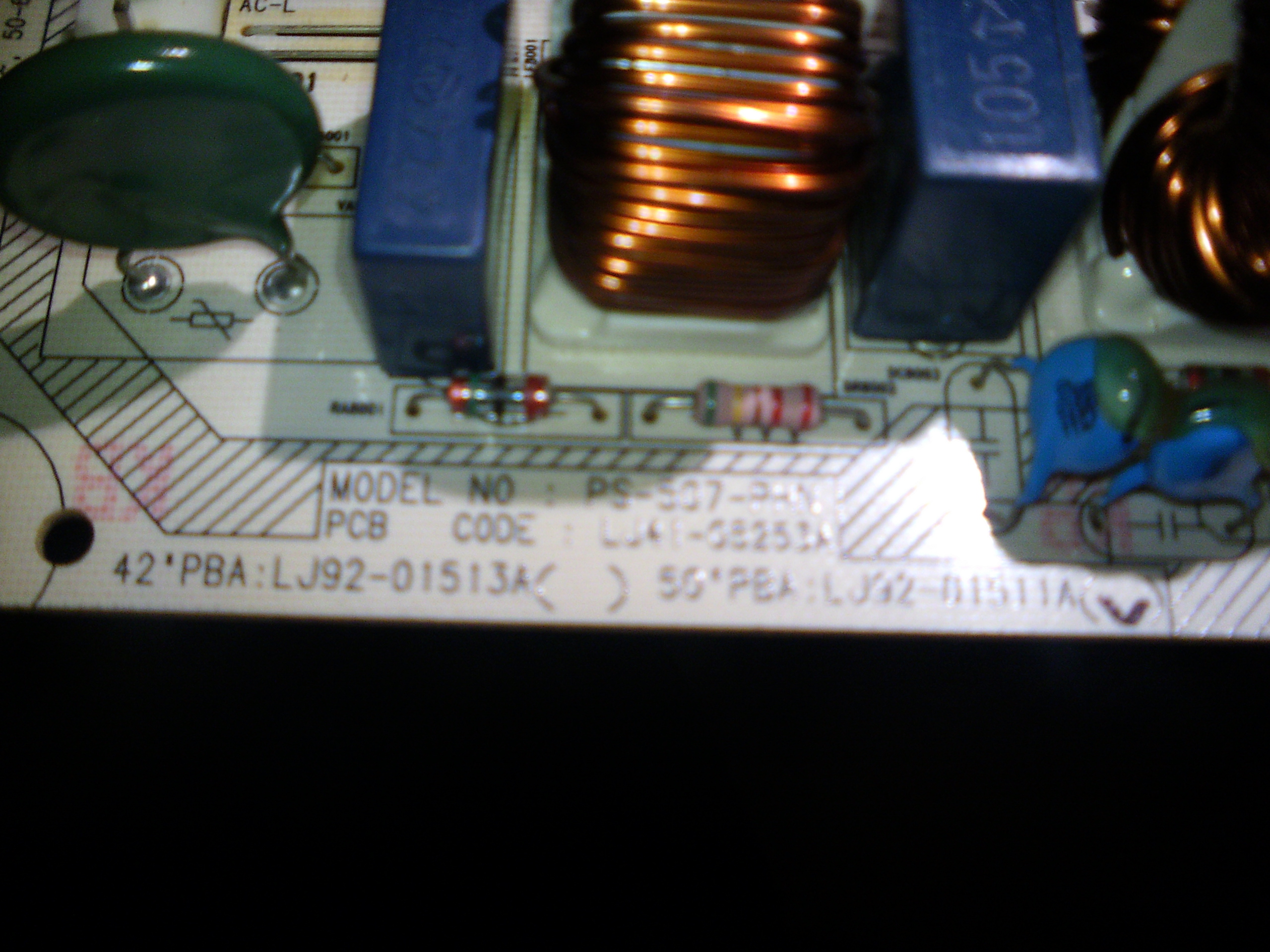

      I'm kinda getting the feeling I'm flying solo again. The board itself is coded: PS-507-PHN and I'm to understand it's a special order by Samsung that made it--for Phillips.

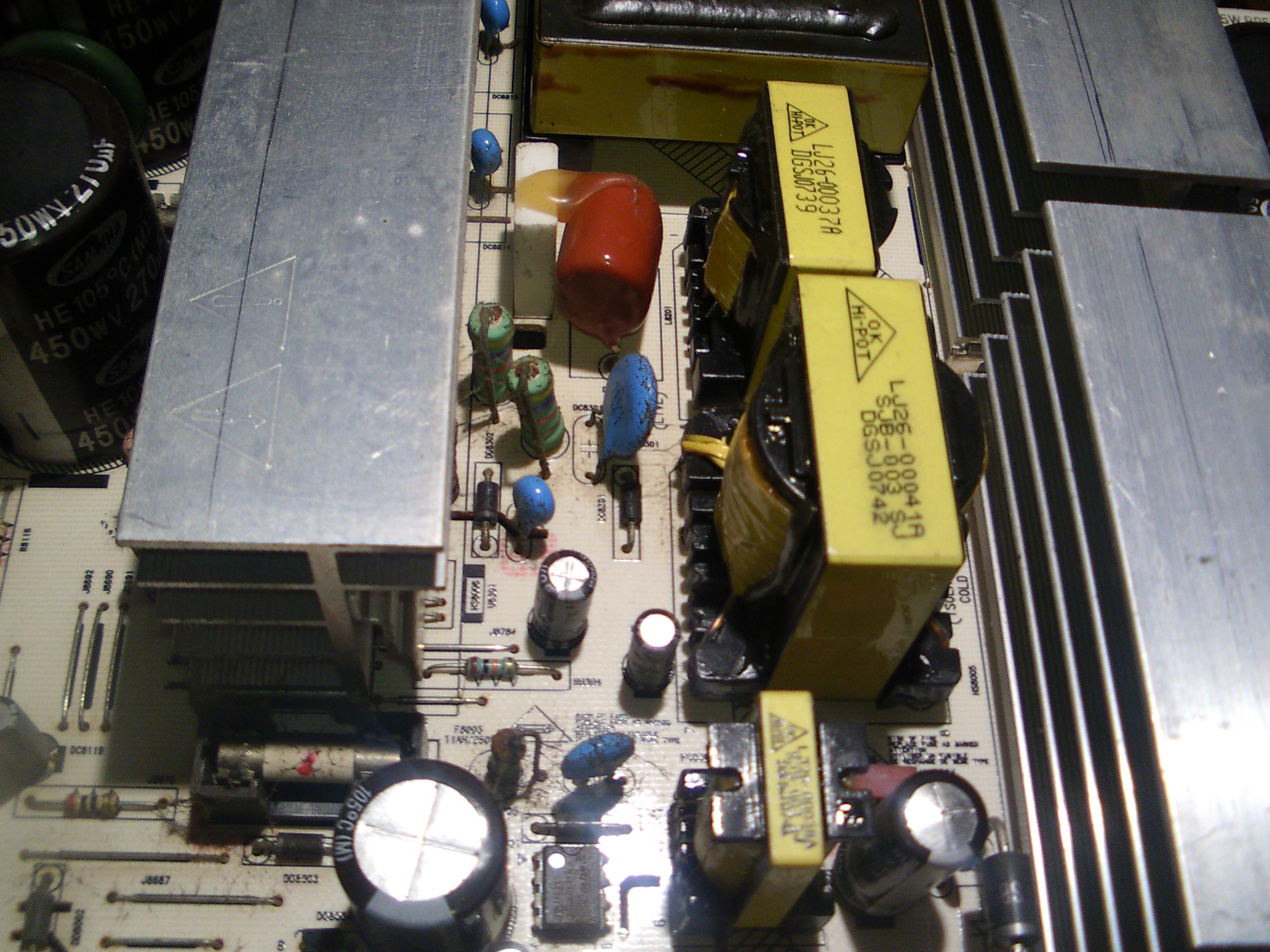

        I did the full recap of the power board. Surprised at how fast I'm getting at this.

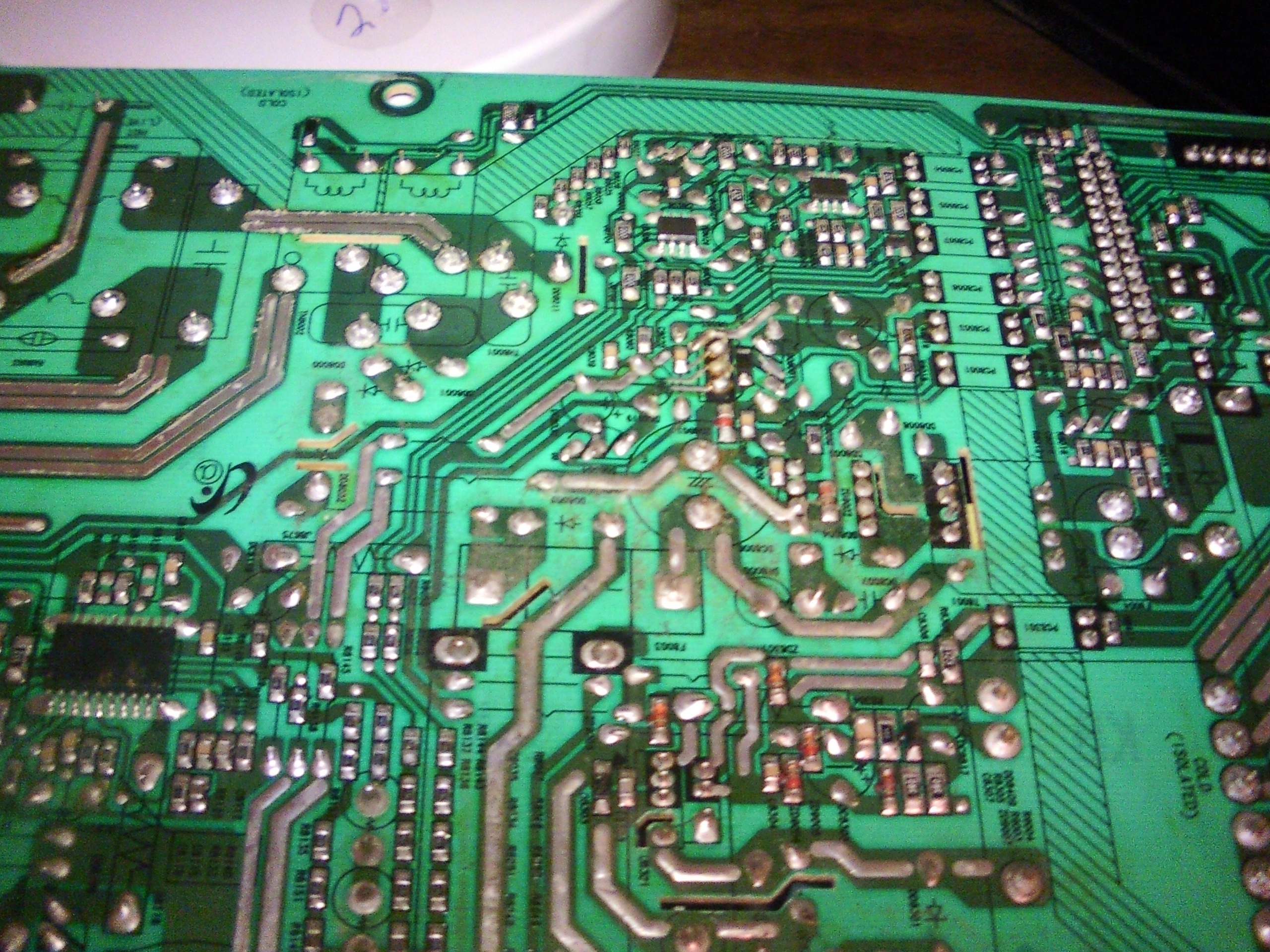

        Still the power supply board tanked with the flash code for no 5 volts. So I (without having a proper schematic) started to back trace the 5v switch line back all the way. And finally I bumped into the caps I just replaced (there's a shock) And then a nice little part with the number:
        33167T Seems this little gem is a very advanced setup for a 5volt switched regulator. And lucky me :-) There's a matching one a few spots down on the heat sink for some compare readings.
        The one in question is labeled on the board as a U8401
        I'm guessing one of the bloated capacitors may have done a number on it. Can't really tell. No serious schematic that I can find for just that power board.
        Anyrate. I poked around and started testing across the pins of that part. And comparing results to the sister one on the board. Found that when I read resistance across pins 2 and 4? I wind up with just about a dead short.
        Pins:
        1= Voltage Feedback Input
        2= Switch Output
        3= Ground
        4= Input Voltage Vcc
        5= Compensation/Standby
        So with the output shorted out for the Input Voltage? I think the overload protection/overvolt protection is being triggered on the safety board and it's flashing the 5v light code. (Where as before it was doing the power fault code (pfc))
        If I'm understanding how a very basic regulator works, it takes a slightly higher DC line (probably 12volts) and knocks it down to 5vdc. If the input and output are shorted out--then it would trigger the error.
        I checked things out by unsoldering the 2 and 4 pin on both semiconductors and making sure nothing was hitting a solder pad. I then did a basic diode check and the suspect one read 0.046 both directions. The one that I think is good? Read about .568+ Without having a schematic to work with, I'm flying blind. However the fact my meter on a continuity check beeped on the suspect one across pins 2&4. And did NOT beep on the sister chip? I think I just found my issue.
        Question is? Is that the only part that needs replacement. I'm going to order a pair of these buggers in and probably replace them both. One is clearly bad--So it might be worthwhile to replace 'em both and see what happens.

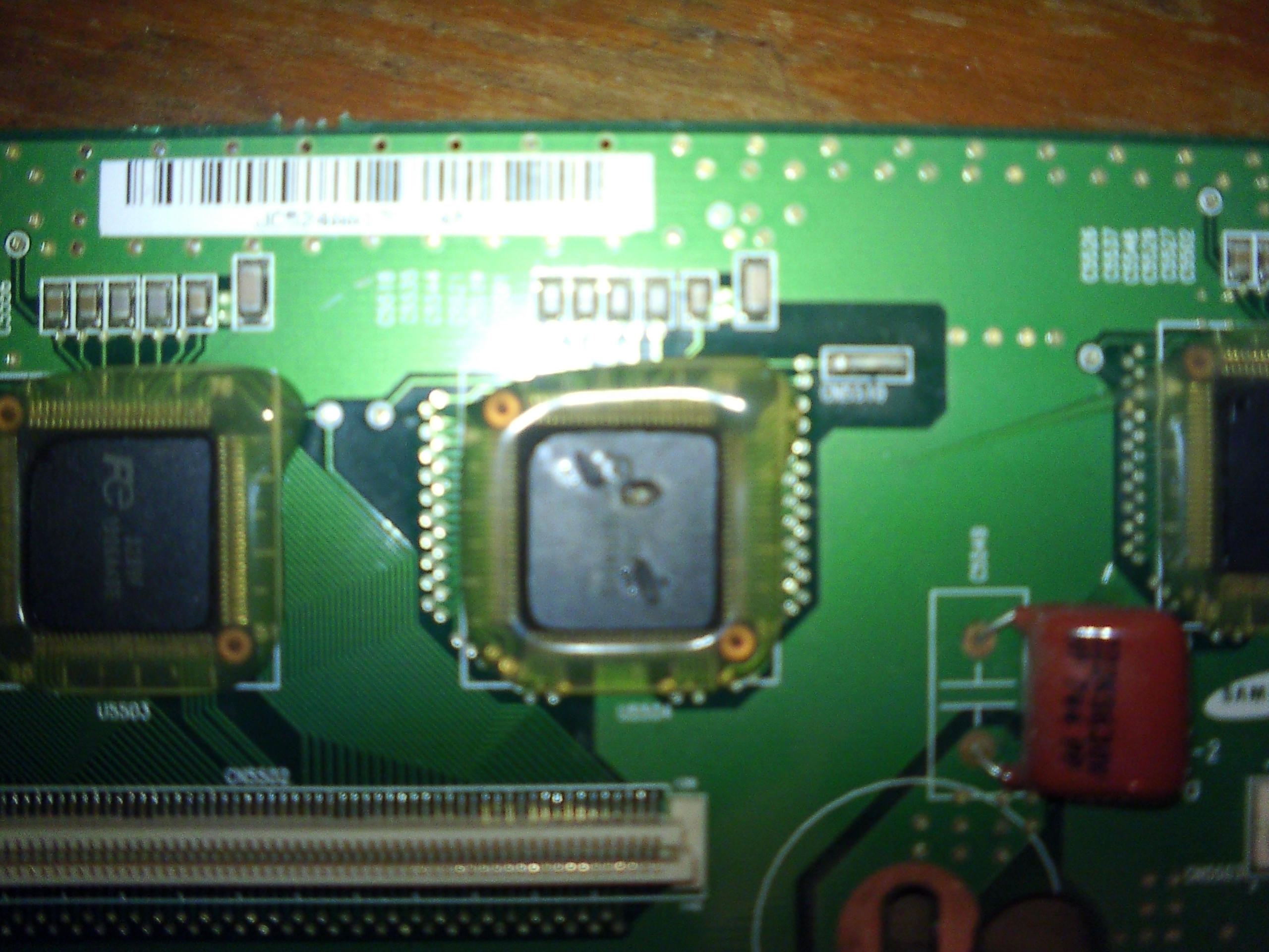

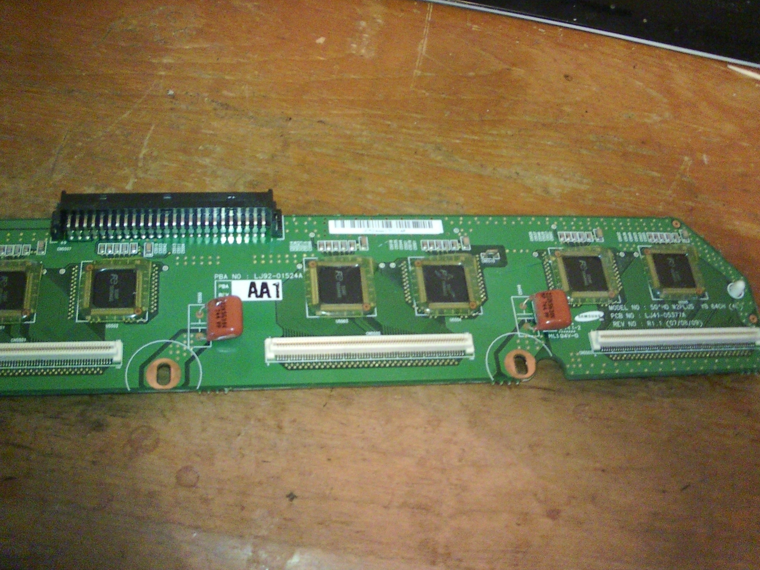

              Power board is all fixed and happy.
              And of course, it blew a chip out
              The board that had the critical fail? LJ41-05377A
              The chip that went "Poof"? 3289F
              buffer board IC 3289F
              So my clear question? What would cause that chip to go boom?
              And would I be better off parting out the boards and calling this one.
              Looking for help here guys. On the board it's labeled U5504
