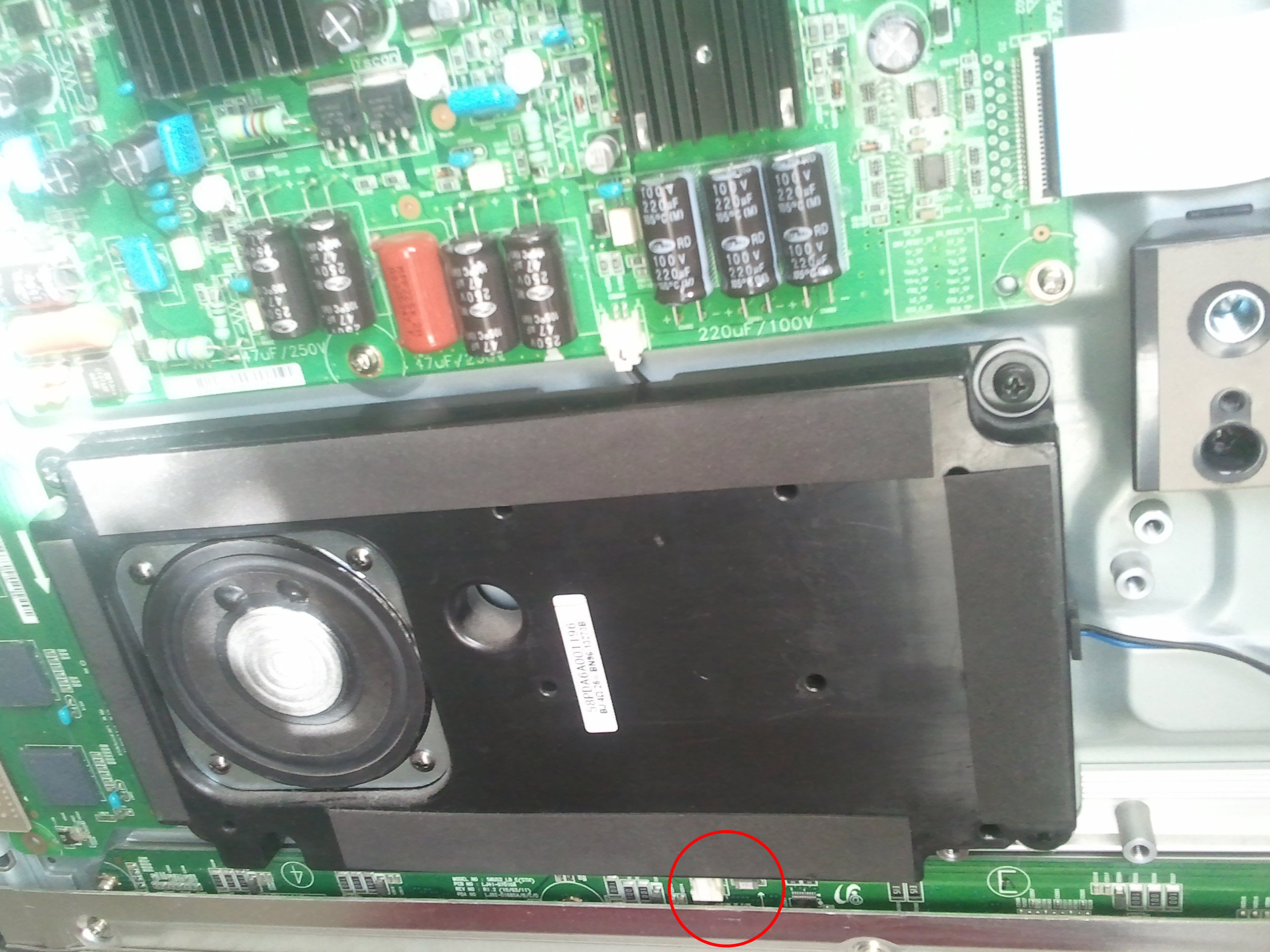

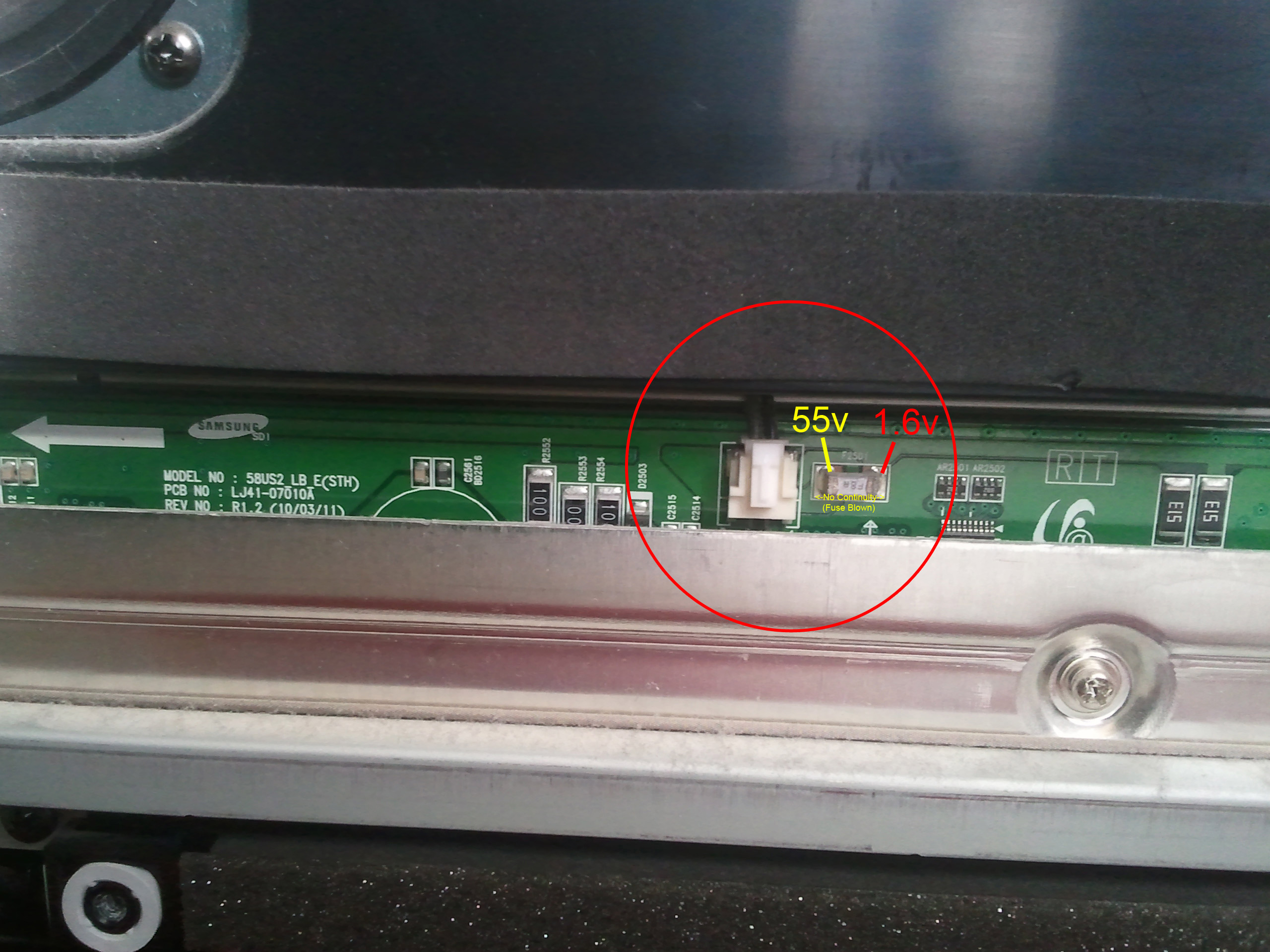

        Re: PS58C7000 sound but no picture
        On the trail now.. - See pics below.
        The tv is still on the stand, so can't access these boards yet. Next step will be to get it down off the stand and pull the boards and look for reasons why this might has happened.
        Fingers crossed.
          I don't like when address bus fuses blow. That worries me. It can be a bad panel. I hope it is not, sometimes it is not.
            Update: It's up and running!
            I removed everything in the way of the 3 lower boards(a real bugger to get at) disconnected them all from each other and poked around searching for shorts, half expecting to find a failed diode or cap- especially between the previously missing 55v Va rail and ground, but couldn't find anything unusual at all.
            So i hooked everything back up and salvaged an identical fuse from another parts tv I was lucky enough to have around, fired it up with fingers crossed figuring there was a very good chance that fuse would blow again instantly, but it didn't!
            I have it on in the background being tested playing an old Short Circuit dvd via bluray and it's been running almost 2 hours now without any fuse related issues at all. Fingers crossed it stays that way.
