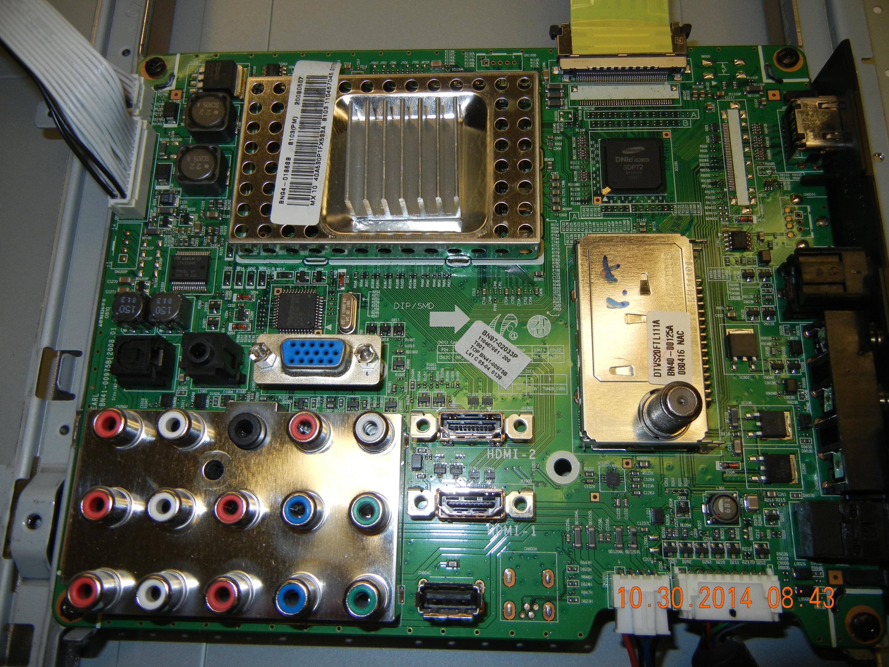

    It points out to the main board problem when buttons do not response.
    The power supply is getting the PS_ON signal to turn on the PFC Voltage booster otherwise you will not get the 385VDC on the main filter cap.
    As to where the problem on the main board is, I don't know.

        I have had a few of these mainboards fail, I did manage to get one limping again by doing a reflow as the CPU was not put on very well.

            I applied pressure to it and it came on perfectly.

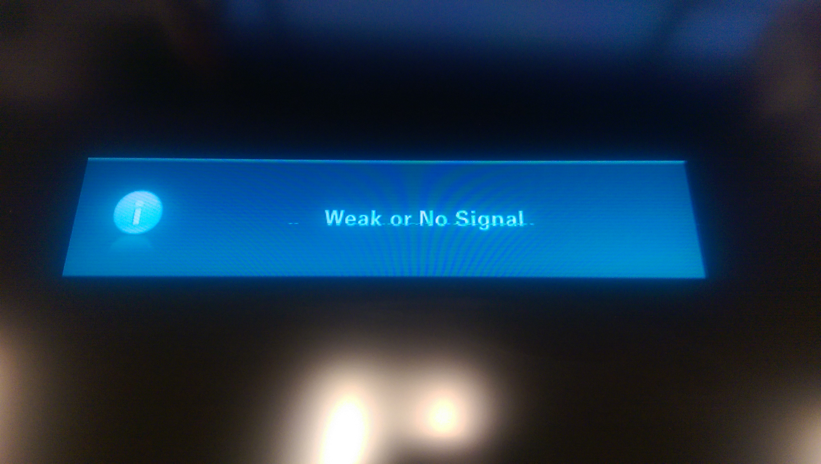

                  Oooo, thank you dominic! I may...I just started looking at this thing again. All I did was reseat all the cables on the mainboard, and it powered on normally. The picture was steady and almost normal for about 10 seconds:

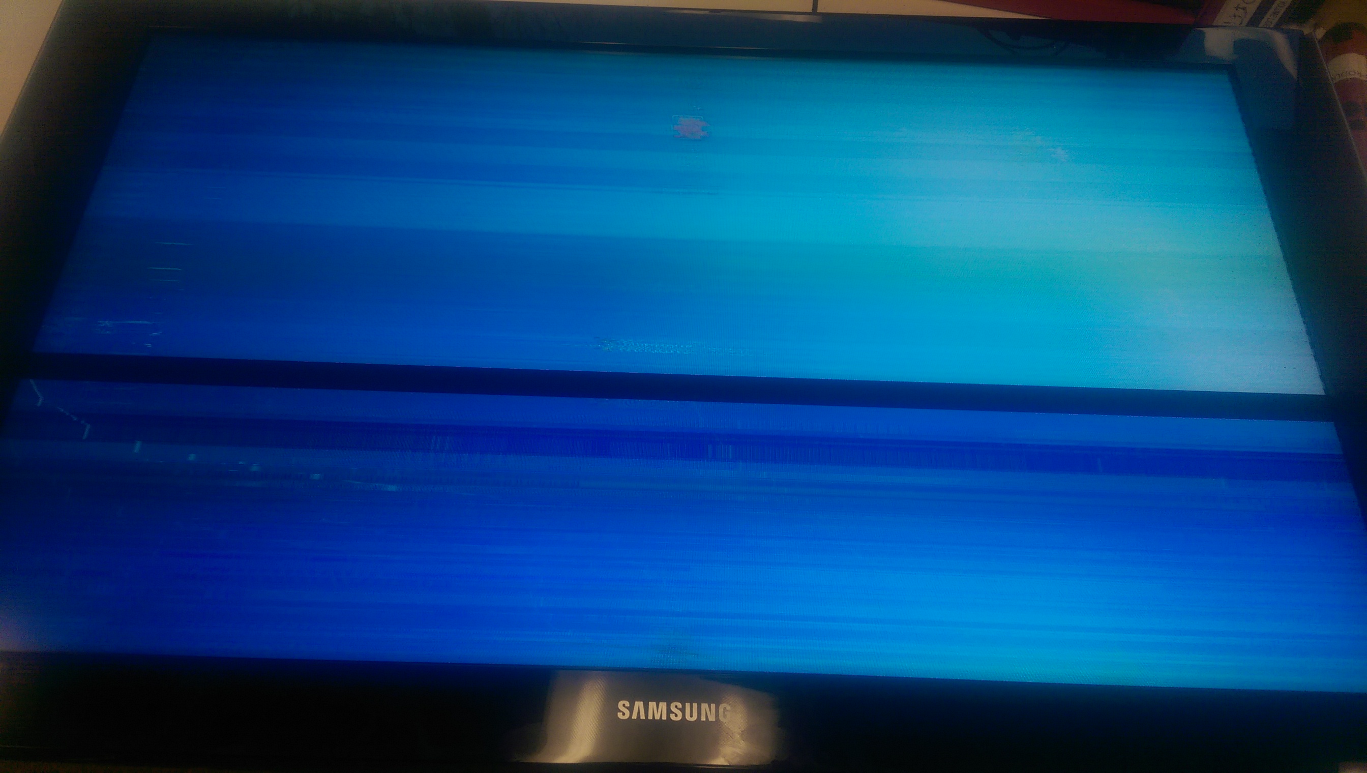

                  And then I plugged it in via VGA, and the picture was flashing and rolling up and down:

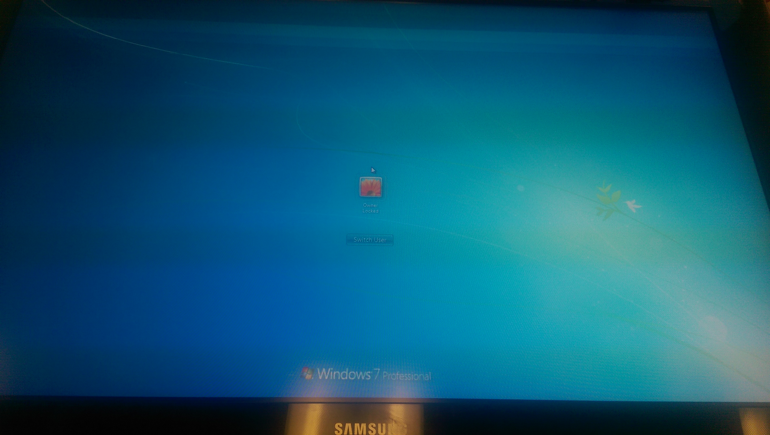

                  After about 30 seconds, the picture became readable, but was shaky:
                  Putting pressure on the mainboard CPU made no difference. The thing will run as long as I let it, and hitting the power turns it off now, it makes the noise it's supposed to, and goes into standby with a solid light like normal. Does this help narrow it down at all?

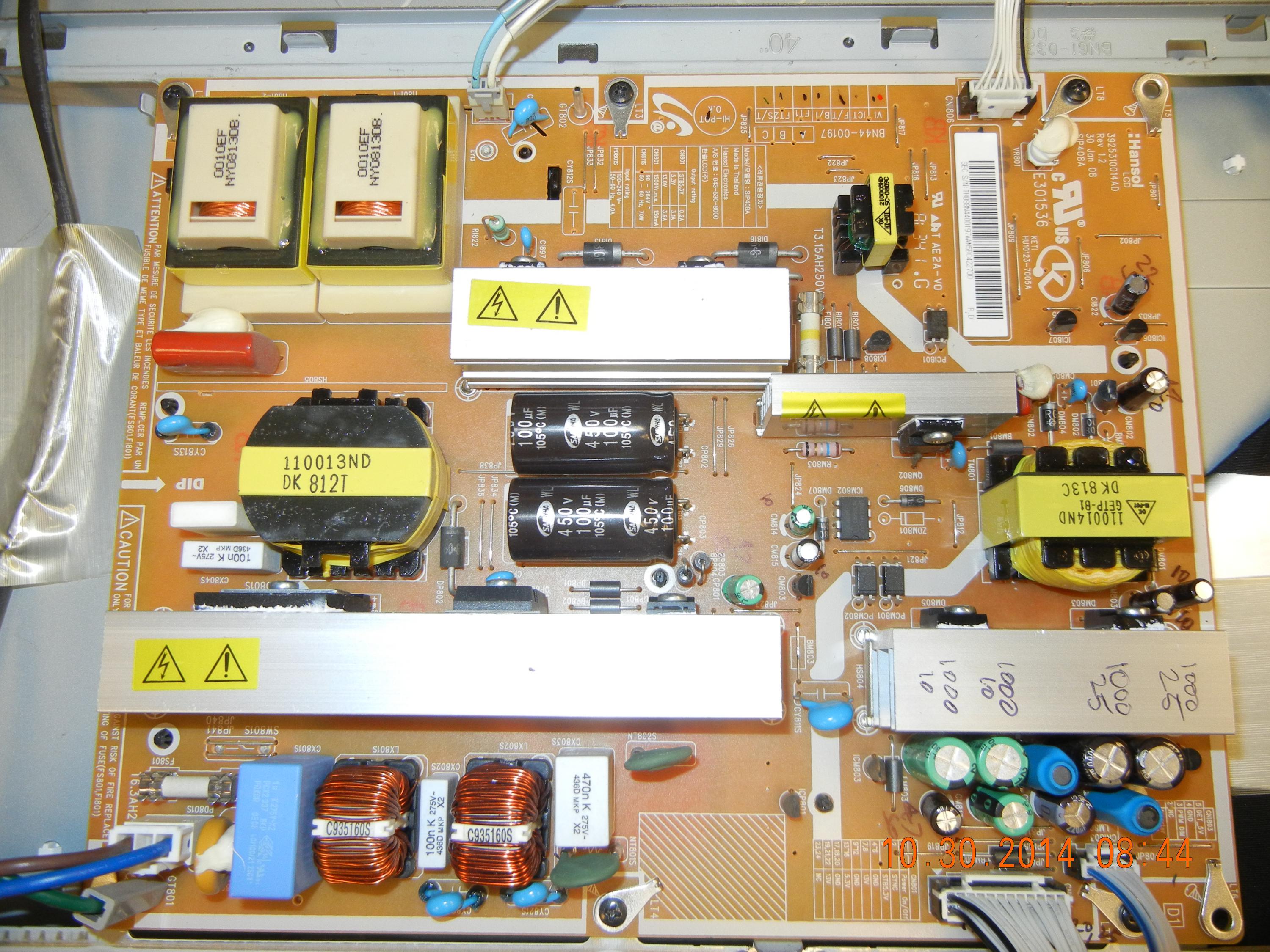

                    Okay so I got this thing working flawlessly now. I reflowed the CPU on the mainboard. This got it working well, but after 15 minutes would start having the previous symptoms. So I recapped the entire power board with much lower ESR caps, and put a good sized heatsink on that chip next to the mainboard CPU under the cable going to the Tcon board, now it isn't having any issues even after hours of being powered on playing 720p

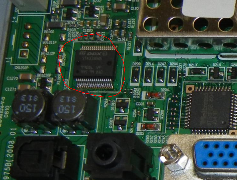

                        I believe it's the sound chip that is failing. That, or the CPU on the mainboard.
                        I think this is the culprit:

                          im thinking of removing it and see if the thing boots up....in the meantime, I put a toshiba board in the tv and got it working. Some kits are sold with that audio chip and the one underneat near the 2 capacitor I replaced. Need to order those and try

                                I have worked on many, many of these, and usually when you just get relay clicks every 20-25 secs it is something with the main CPU (I've been guessing bad solder) as reflow usually temporarily helps. It's not the audio IC. The voltages are usually all good as well when having this symptom.

                                  You are right, I have removed the audio chip with no difference in behavior.
                                  I am considering reflow of the cpu
                                  there is no relay clicking. the optical does a 25 sec cycle. Nothing click, red light flashes.
