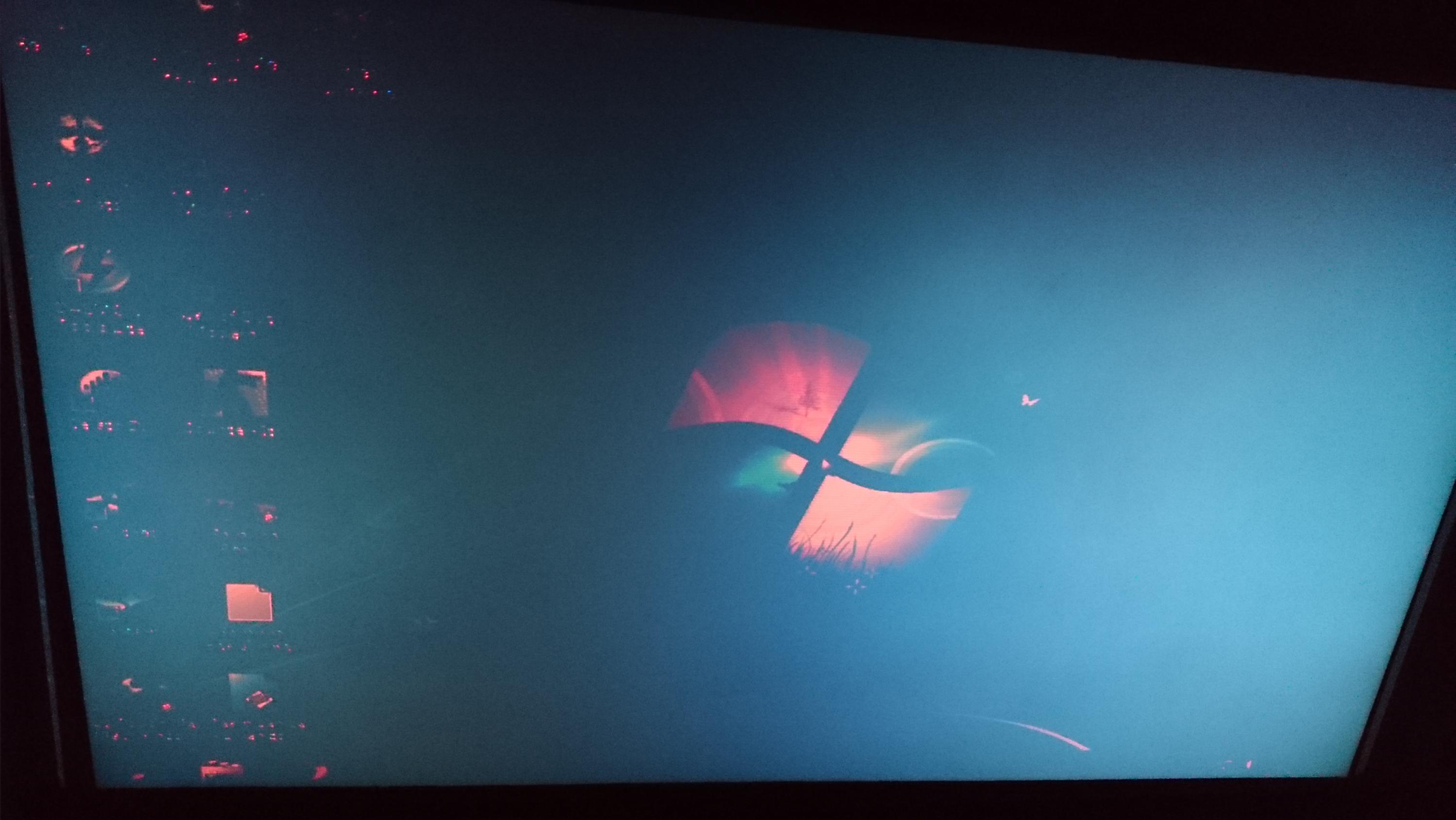

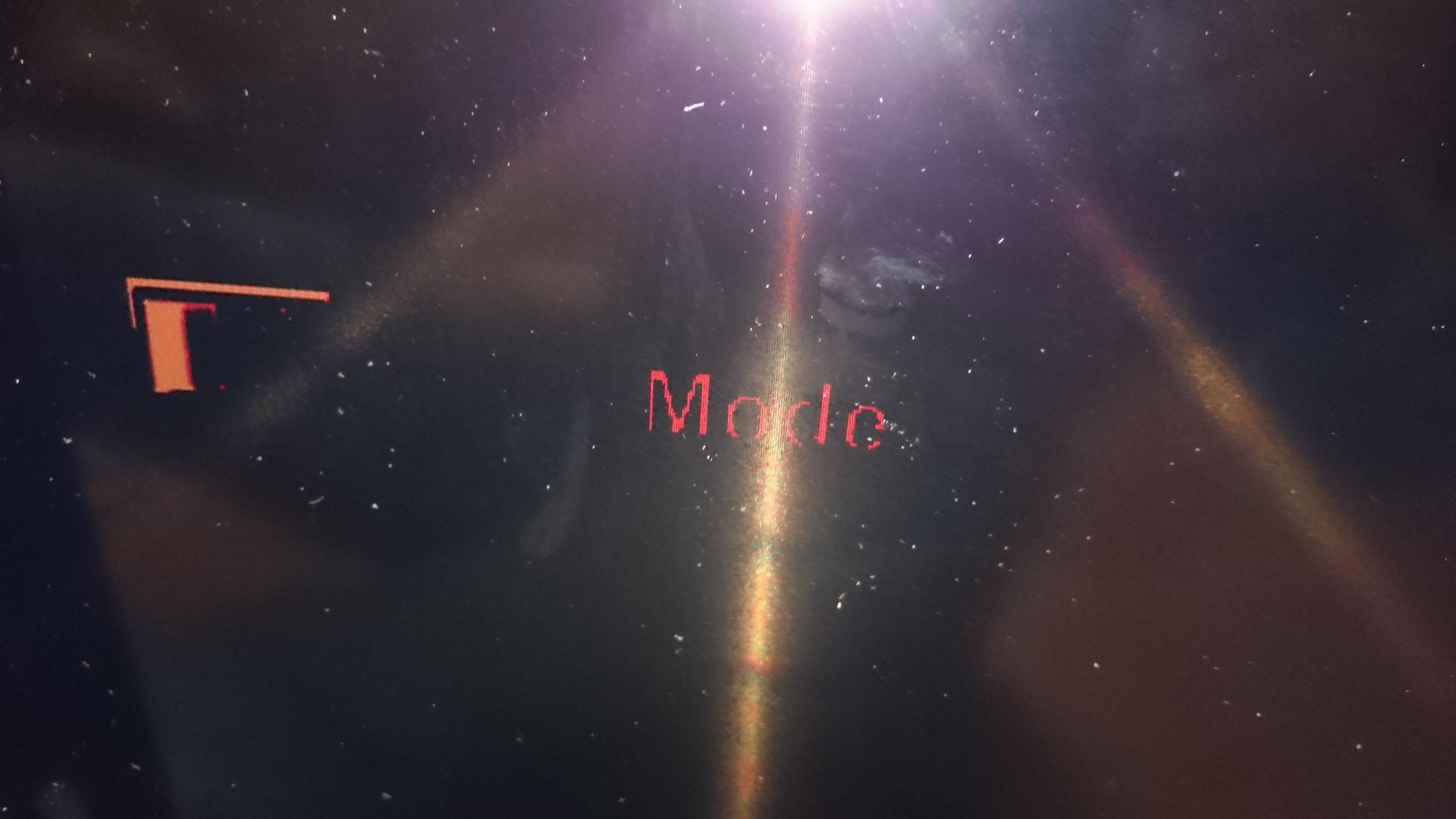

    I picked this 1 up together with the LG plasma and this 1 has a problem.

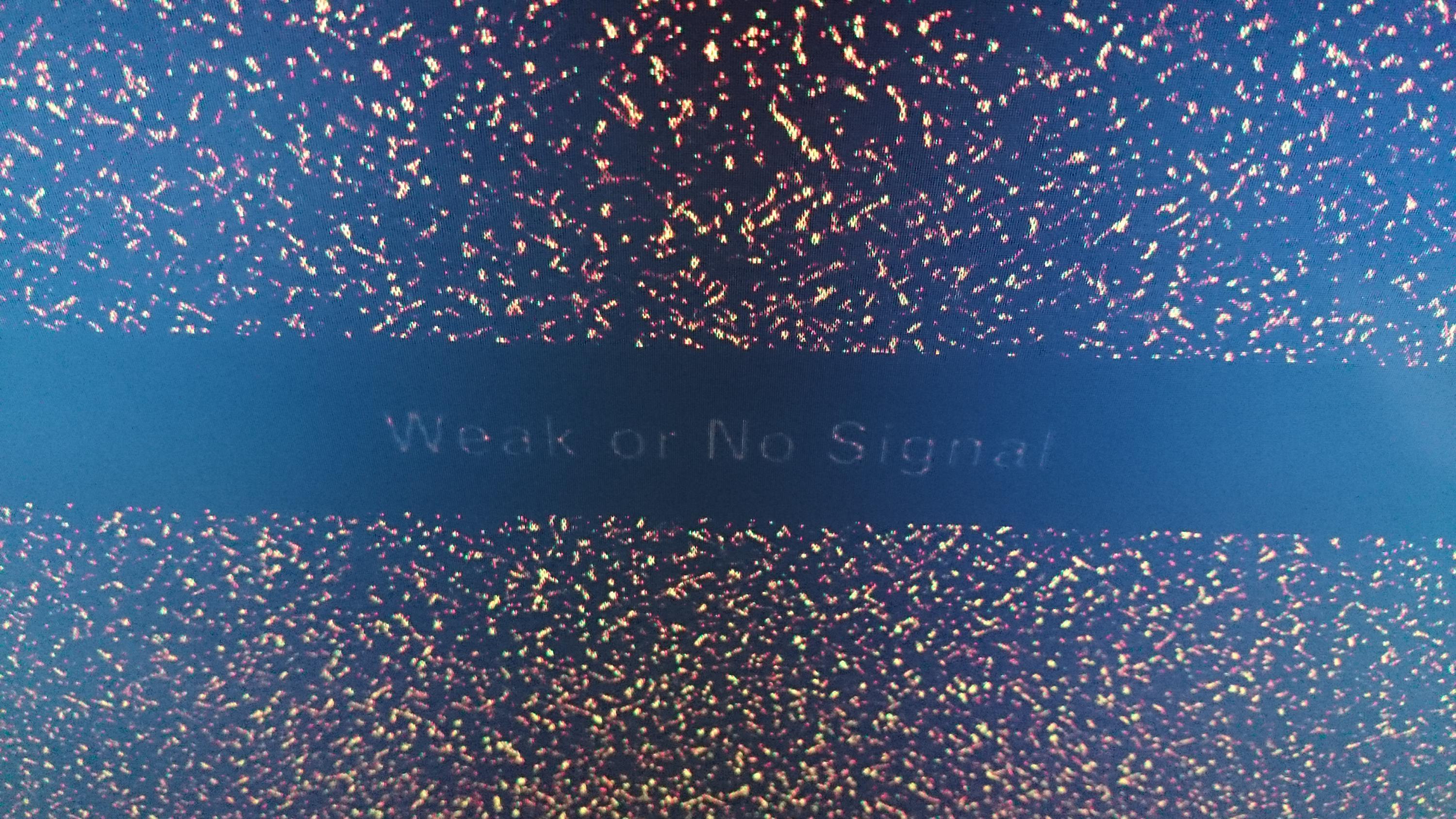

    When it starts up ( cold) the screen is fine for a few secs and then it changes to less bright and then it goes like the screen as you can see on the pictures.

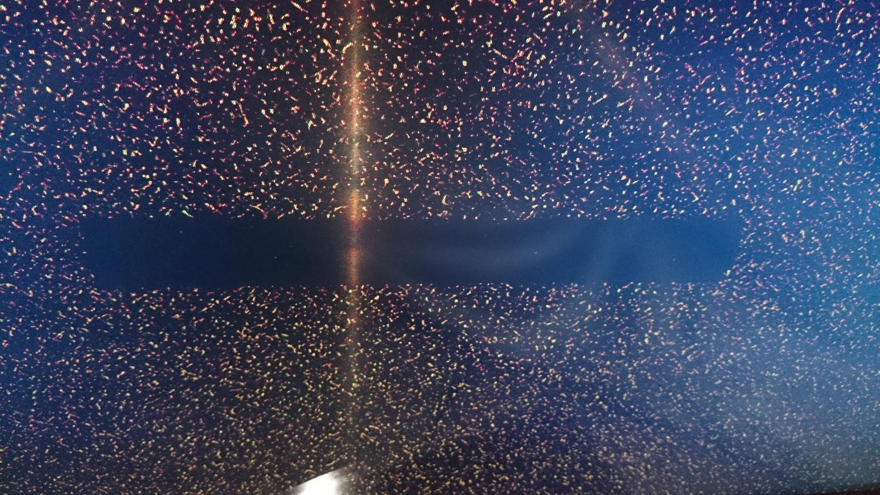

    The snow signal changes from black white to yellow/black.
    When i press menu or source the option menu is barely visible. It can show red + green. For example the words "HDMI 1 " is red colour.
    My guess is T-con or backlight?

    Re: Samsung LE37B554M2PXXN. Color problem.

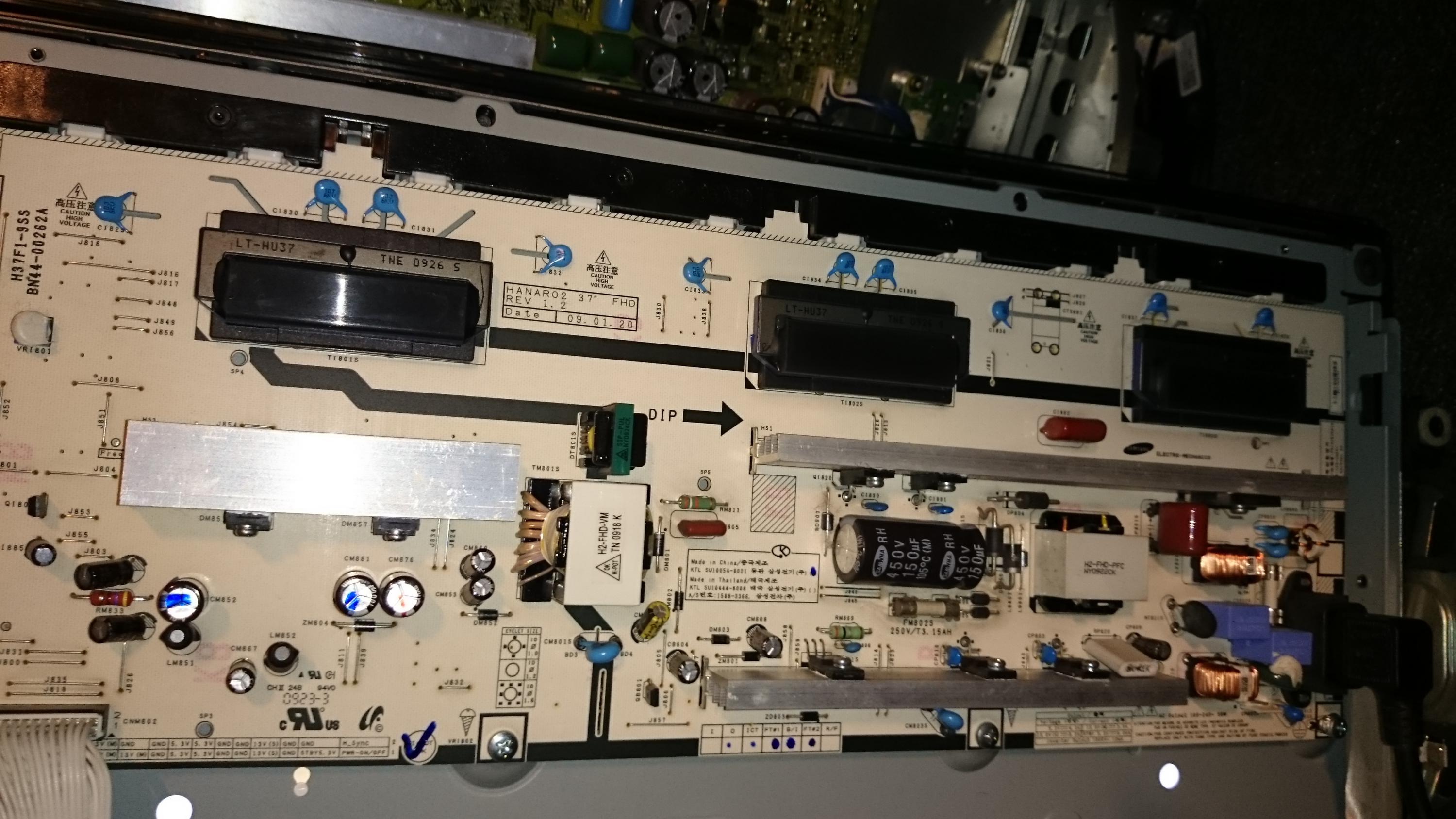

    the fact that it gets less bright MIGHT suggest this is a power board issue (Check caps) but also could be T-con / Panel as well...

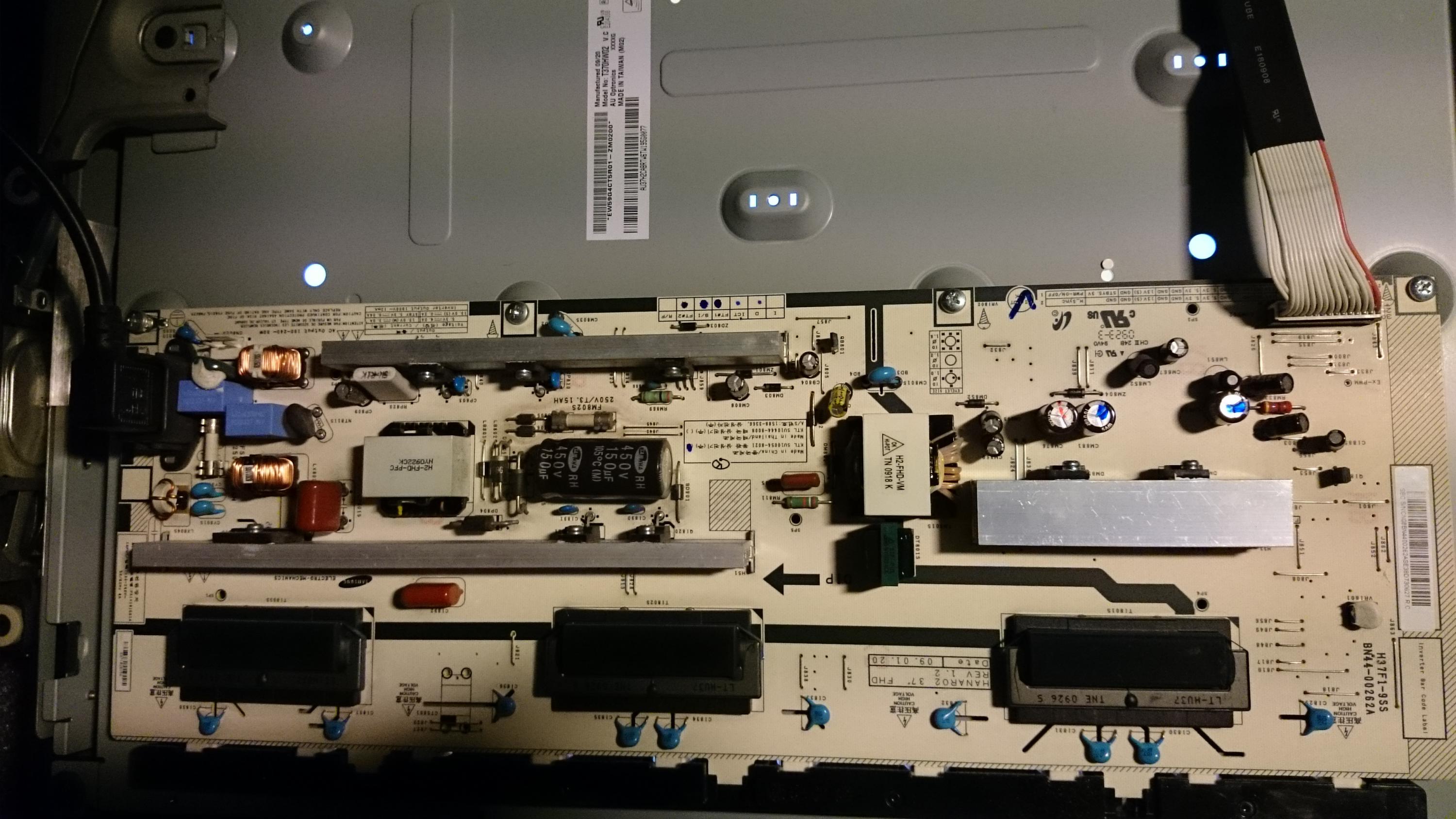

    Can you post a clear picture of the PSU as well please?
    Good luck,
    Demon
    • Moreno83
      • Jun 2014
      • 2008
      • The Netherlands
      Hi Demon ,
      Thx for the reply! The second picture is the power supply , all caps look good.
      Ill try to get a more clear picture.
      • Moreno83
        • Jun 2014
        • 2008
        • The Netherlands
        This is the power supply

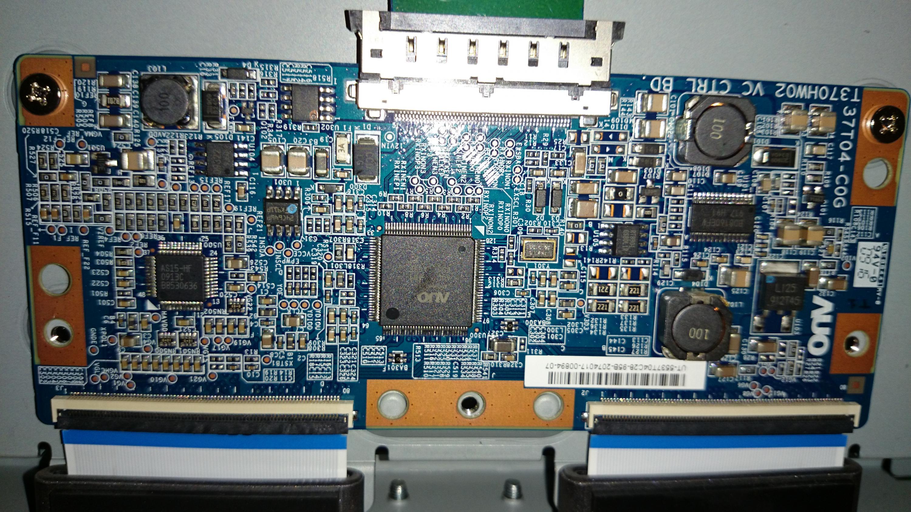

          T-con board, check gamma voltages.

              T-con boards , are they repairable? Or should i just replace the board?
              What about cleaning the cables with WD40? Sometimes the picture is also flickering.
                If you have a gamma chip fault, yes, they're repairable, it costs very little. Post a picture of your T-con board.

                    I wanted to measure gamma but i dont see the gamma chip? No words with gamma....

                        Test points marked VG1, VG2, ... up to VG22. Check each voltage and report back, not all will be available.

                          Test points for gamma voltage marked VG1<->VG22 they are a little scattered across the top of the board (black probe to T.Con fixing screw ,red to test point meter set to 20v DC) and list
                          VG1xx
                          VG2xx
                          VG3xx and so on Flocko

                            VG1 : 7.54
                            VG2 : 7.54/55
                            VG : 4 = 7.43
                            VG : 12 = 11.73
                            VG : 13 = 11.87
                            VG : 14 =
                            VG : 15 = 8.02
                            VG : 17 = 12.21
                            VG : 18 =
                            VG : 19 = 12.19
                            VG : 21 = 0.90
                            VG : 22 = 0.34
                            These were the first that i found on the board but i already noticed that its not good right?
                            Is this a cap problem or the chip?
                              The gamma chip is bad. (AS15 on T-con.) Common fault.

                                Ok thx, will order new tcon.
                                  AS15-F can be replaced with hot air gun.
                                  • Moreno83
                                    • Jun 2014
                                    • 2008
                                    • The Netherlands
                                    Hmm ok will try that first! What about reflow?
                                      IR reflow would work, but not global reflow. What do you mean? You will have to remove the chip and install a new one, the chip is about 3 euros.
                                        Very rare do those power supply/inverter boards have failed caps, they mostly fail due to bad inverter transformers for FYI.
                                        I have several of those on hand, each one of them has failed via transformer/s.
                                        As you have already uncovered your gamma is bad. Just watch out for these transformers, if you hear a Bzzzzzz or notice one is getting hotter then the other I would replace it ASAP before it burns up and possible burns a hole in the board ect.
                                        Just an FYI for future maintenance!
