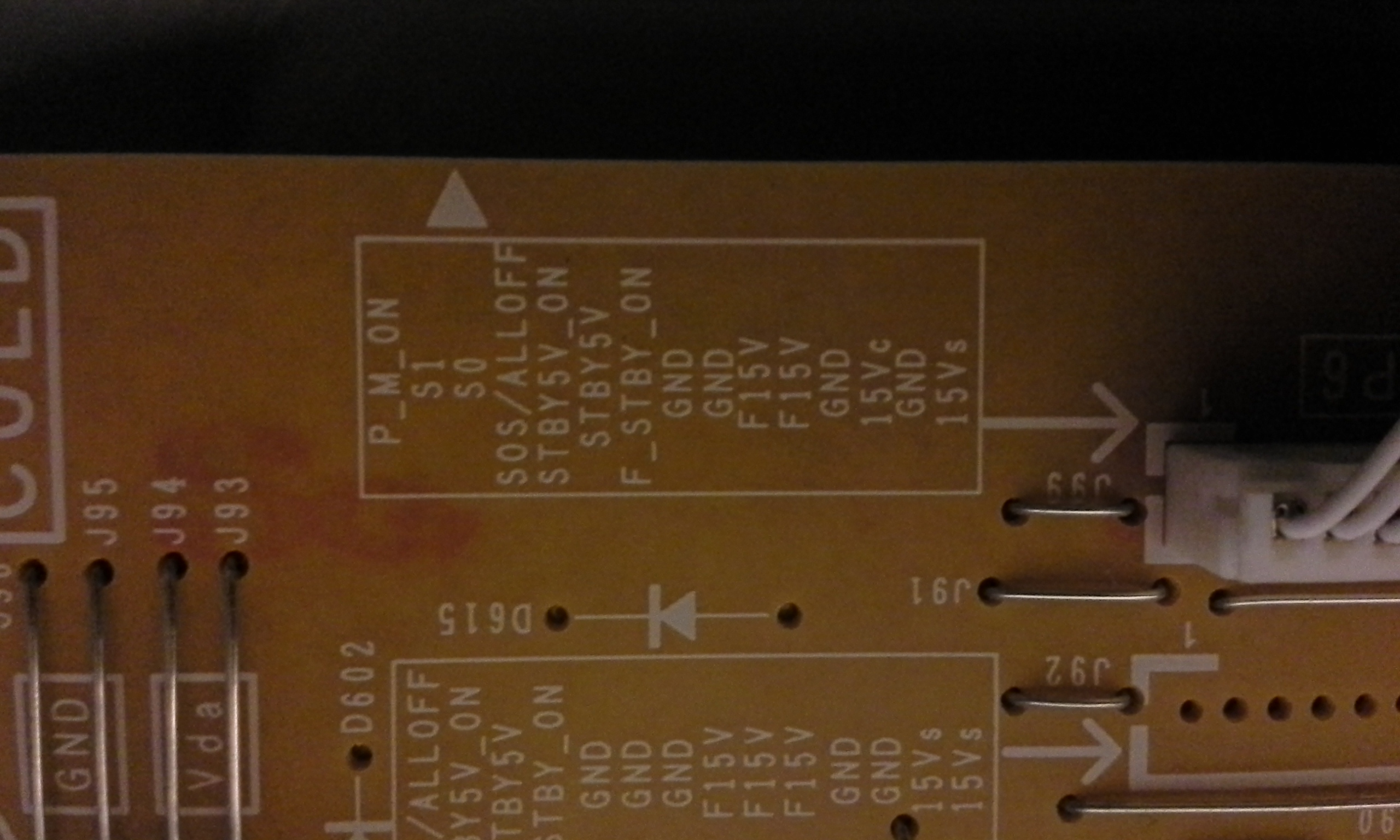

    Without too much back story; my tv experienced a power surge and no longer works.
    Immediately upon plugging in the TV I can hear a 'click' but there are no lights or any other obvious indication that the tv is working.
    I've taken the back off the tv and tested the two fuses right downstream of the power supply and the resistance reads '0 ohms' and there is no sign of damage that I can detect.
    This is the extent of my very limited trouble shooting skills, so any direction is greatly appreciated. I'm looking for someone to help me troubleshoot individual components on the psu in hopes that I can replace a few inexpensive components to get this guy back in working condition, as there is a small margin to just buying a new tv.

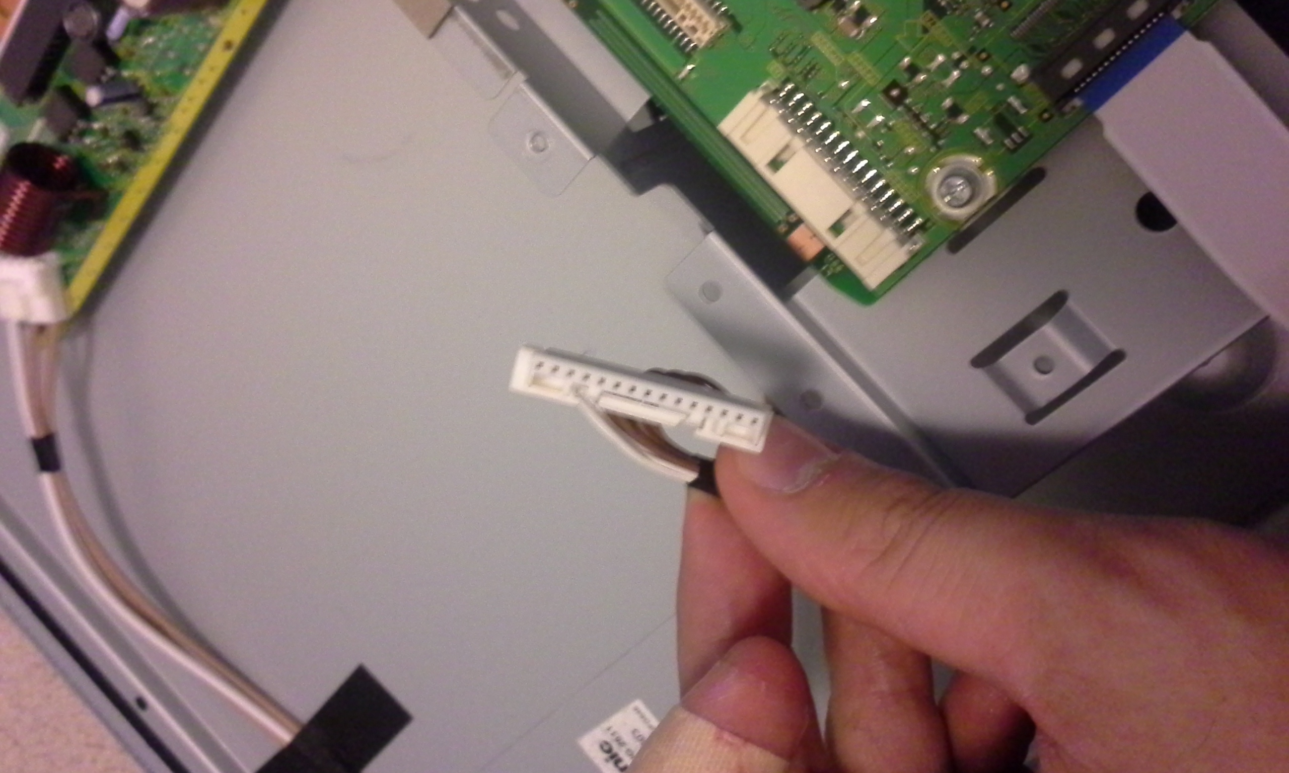

    Ok, on the power board there's a brown and white cable going to the main video input board (the one with the HDMI and other ports on it.)
    Can you get a picture of the connector end? There should be labels.
    Note: We prefer you to upload photos via the Manage Attachments feature here, as Tinypic photos could disappear at any time, making this thread less useful for future visitors.

      Re: Panasonic 42' Plasma TC-P42x3
      I'm not clear on what you want a pic of. Included is a pic of the labels on the psu side and the connector on the video input board.
        That is the picture I required.
        Do you have a digital multimeter/voltmeter available?
        Set your meter to DC volts, if it is manually ranging use the 20V scale. Red probe in volts/ohms, black in COM.
        Connect the black probe of the meter to the chassis of the TV (wall bracket, back of display panel, etc.)
        Touch the red probe on the pin corresponding to STBY5V. The connector must be inserted. A small metal crimp is exposed where the wire goes into meet this connector, you will be probing this point.
        What voltage do you measure?
                DC voltage reads .010 volts.
                  Ok, now please measure S1 and S0.
                        Haha, well this is embarrasing. I didn't notice that my multimeter auto reset to ac voltage....
                        So S1 and S0 read 1.1 millivolts and stby5v reads 5 volts.
                          Ok, if you press the power button on the side or front of the TV, do S0/S1 change?
