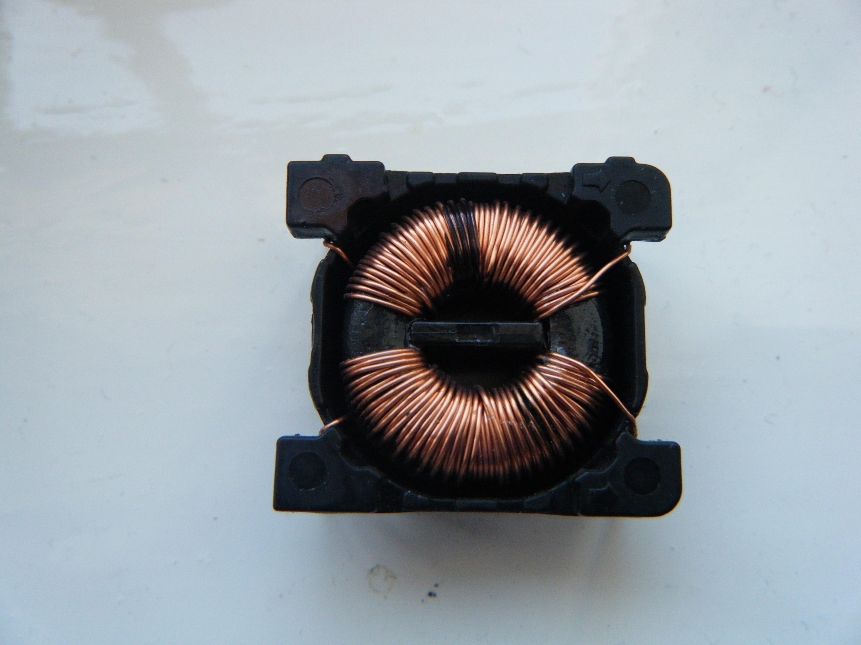

    OK, there are four red circle in the LF1 box I marked, what resistance do you get between the two top circles, and between the two bottom circles? Are you sure that the legs of the LF1 are making contact with the copper pads and no breaks in the solder pads? Hard to believe that both coils are open, you can see the coil symbol printed on the circuit board.

      Hi Budm,

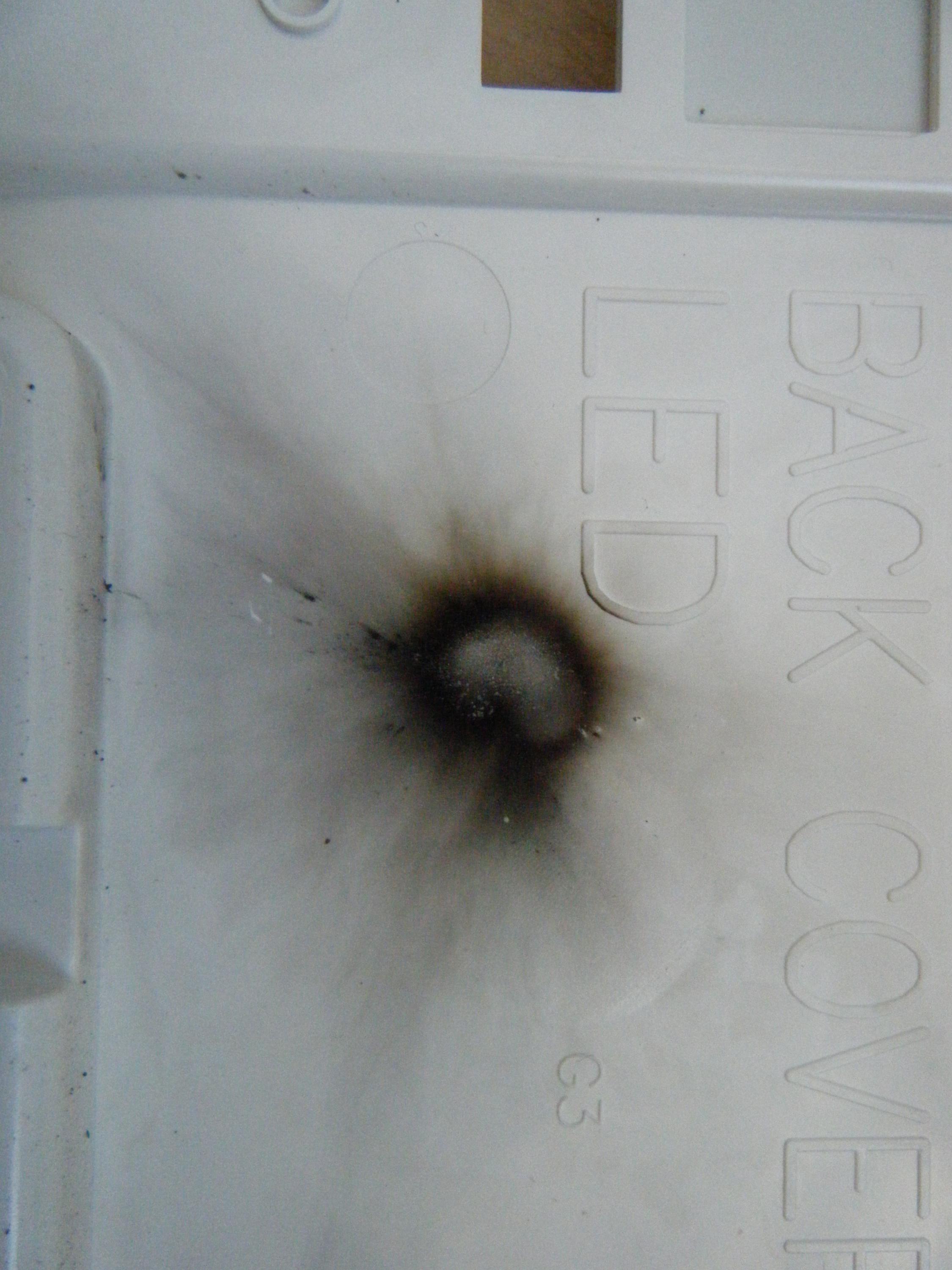

      I have just removed LF1 and double checked both coils are Open Circuit. On closer inspection you can see "blackening" under/inside the coil of the lower coils, look at the bottom corner around 5 oclock. I have tried to get pic as close as I can, the top coil looks OK.
      Ignore the defined black mark on the top coil that was so I put it back in the correct orientation.
      Something must have happened to the coil as per the other pic I have reattached showing inside the rear cover, looks like something went bang!

        So the mark is directly below it?
        You could rewind the coil but it's probably not worth it. You would need some magnet wire, a steady hand and good patience.

          Hi, The mark is directly behind LF1 on the inside of the rear cover. So looks to be it went bang! can you buy LF1?

              You can jump the choke for now to verify that the TV is still functioning, the choke is required for the compliance to pass the conductive noise test.

                    You have to search for TOROIDAL COMMON MODE CHOKE, you will need to find the inductance rating, the current rating is probably 2~3 A range. You may be able to go by the dimension. Do you have any access to electronics recycle places?
