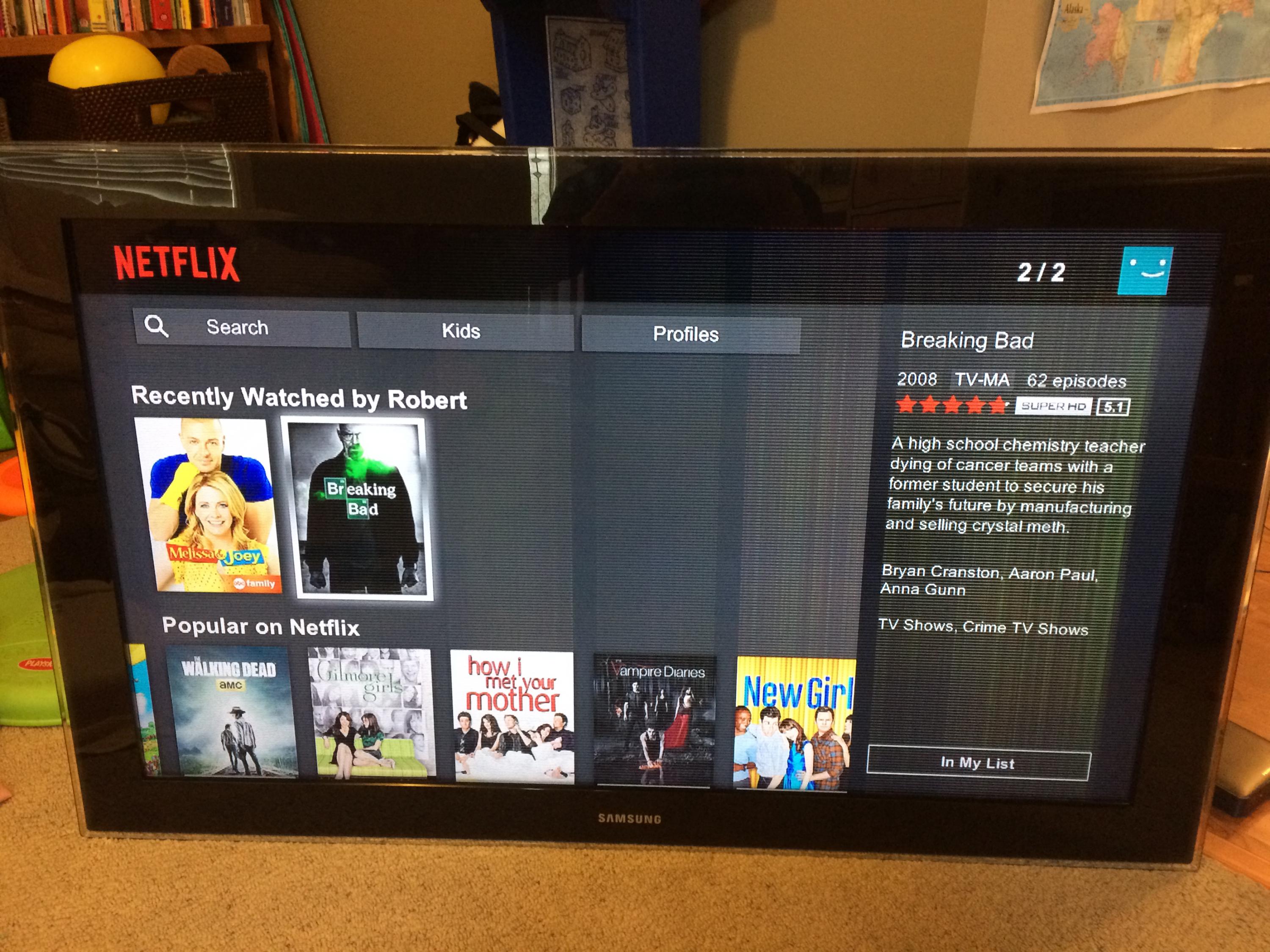

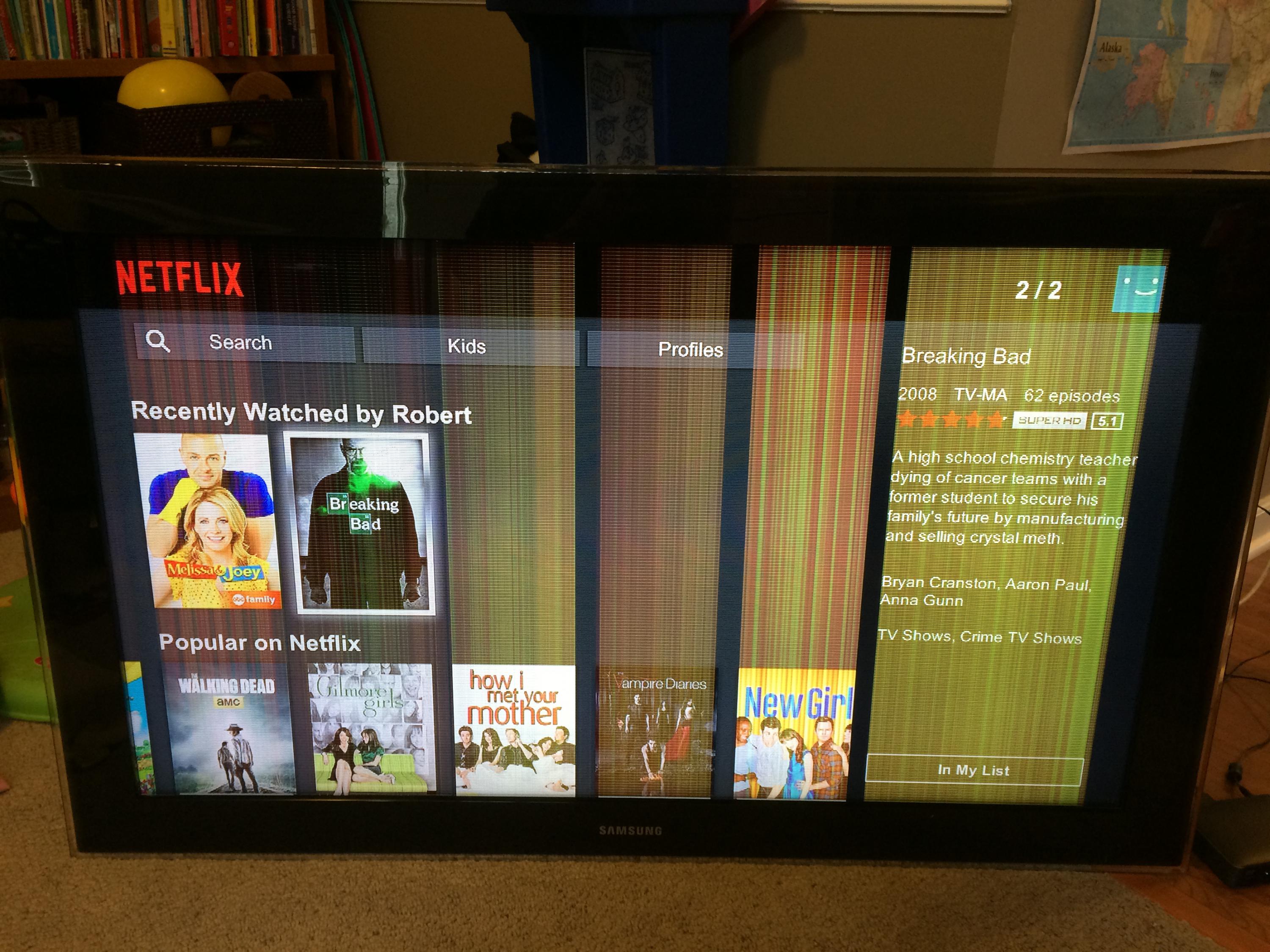

    I believe this set must have a bad panel.... just wanted to run it past some of the experts here. Due to the boards being readily available (and salable) on eBay, I tried changing them in the following order:
    T-CON
    Power board
    Logic board
    The symptoms persist. The picture becomes progressively worse as the set "warms up" See photos
