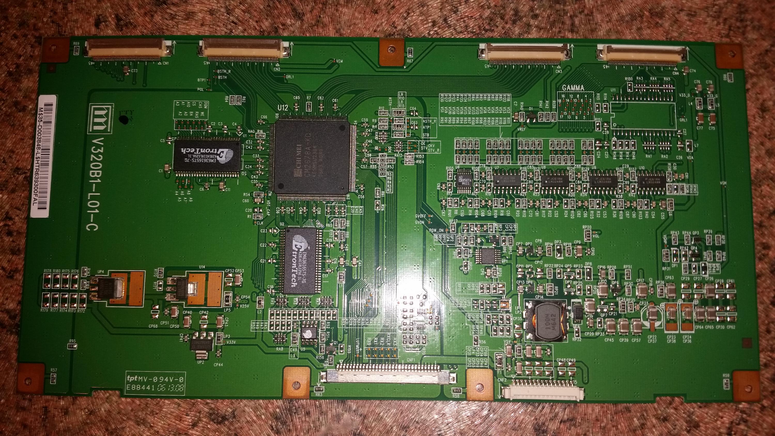

              OK, can you supply a picture of the T-con?
              5.3V is OK for this earlier model.

                Re: Samsung le32r73bd
                here you go
                  Try checking regulators UP2, UP4, and U14
                    U14 should be 2.5 volts
                      Up2 5.30 3.27 0.00
                      up4 5.35 3.50 2.25
                      u14 5.50 0.85 2.25
                        If kasfamily is right, (I have little reason to doubt) then it looks like U14/UP4 may be bad.
                        What is the part # printed on them?
                        (N.B. You should use a good soldering iron to remove and replace them IF they are determined them to be bad. You can also use a hot air gun.)
                          very difficult to read but ..
                          UP4 NIKOS L1117DG XA5B21A60
                          U14 MM06100B 25 F614
                          UP2 L1117L6-33
                            OK, looks like U14 is bad (UP4 is probably OK)
                            See here:
                            https://www.badcaps.net/forum/showthread.php?t=38665
                              A small error-U14 - MMC6100B-25 replacement AMS1117-2.5

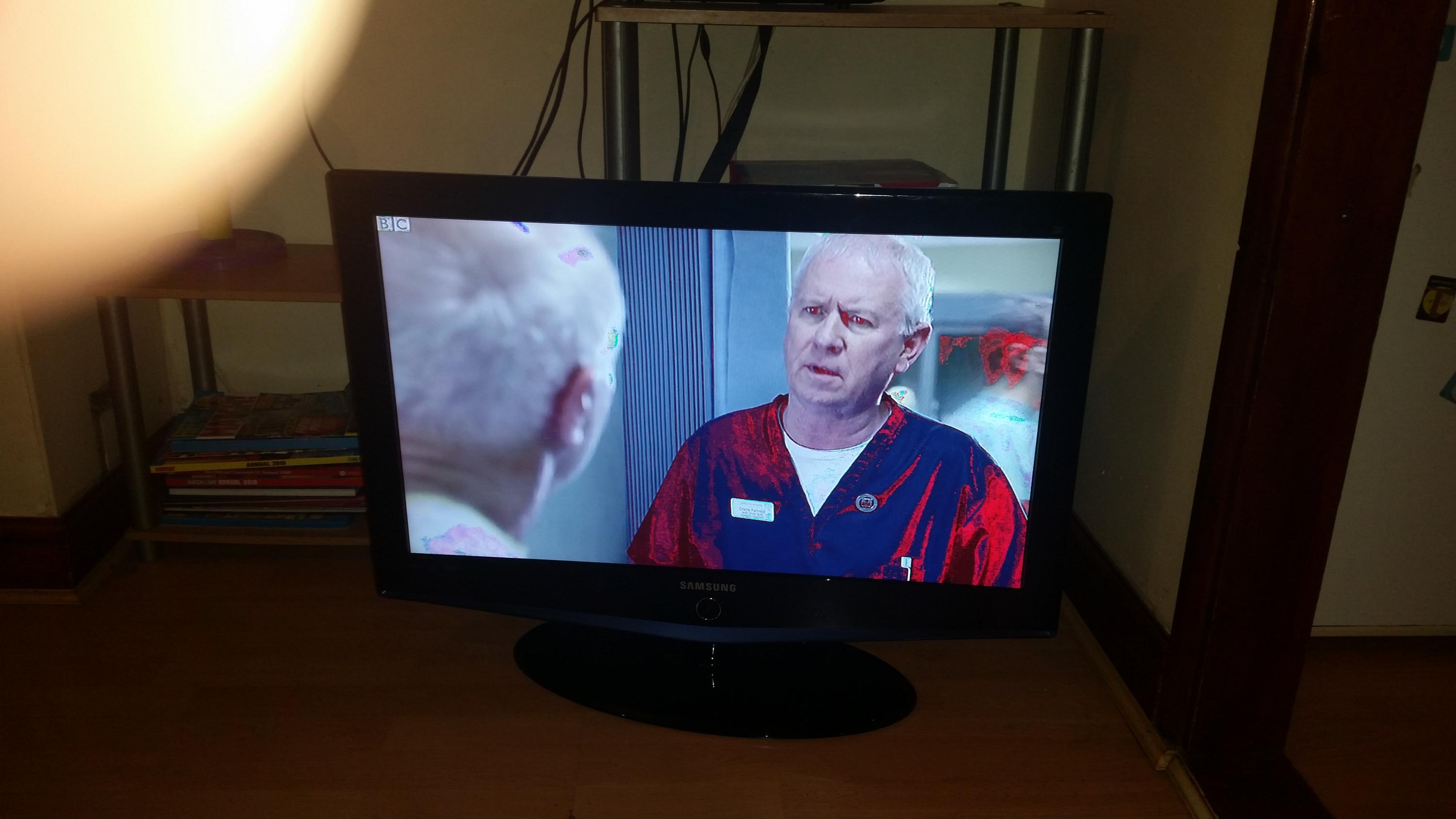

                                  Hi
                                  Replaced the regulator screen came back on but now im getting this picture so it looks like more things are wrong with the tcon board ?
                                  • Shinju
                                    • Mar 2014
                                    • 1239
                                    Gamma issue or you didn't reseat the LVDS cable right. Try reseating the T-con TFT cables (4) and the LVDS cable from main to T-con. Also clean the contacts too.
