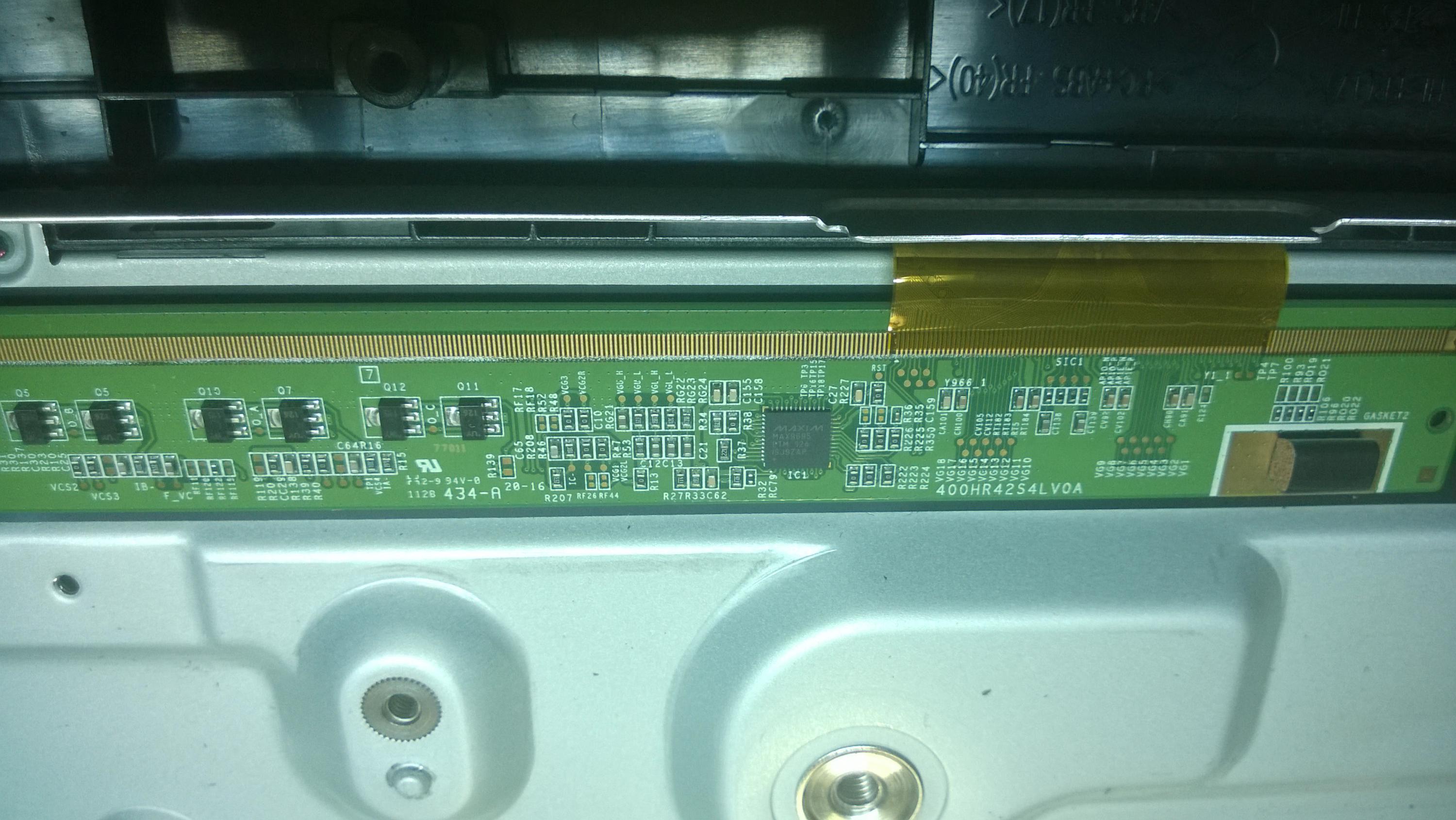

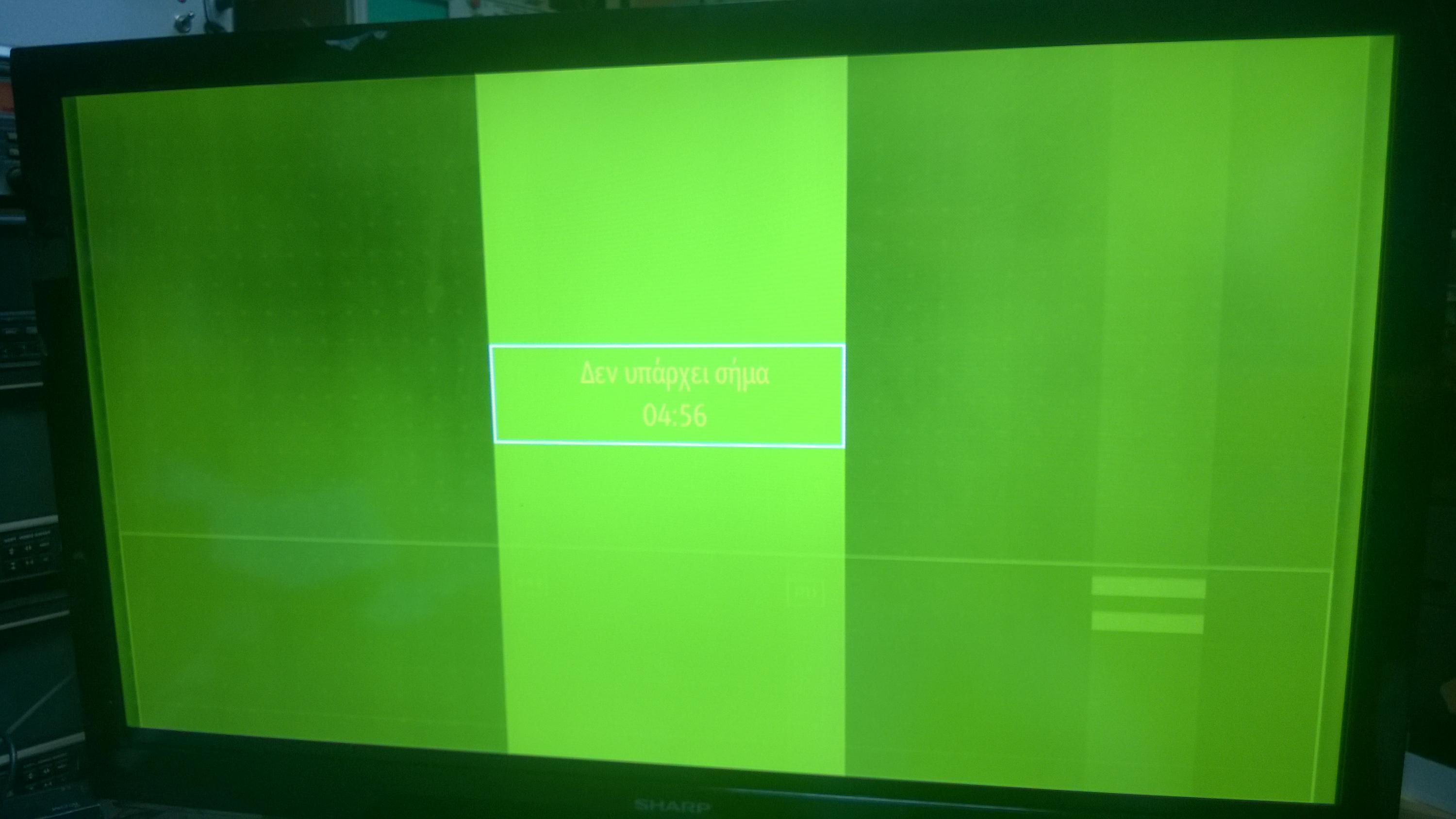

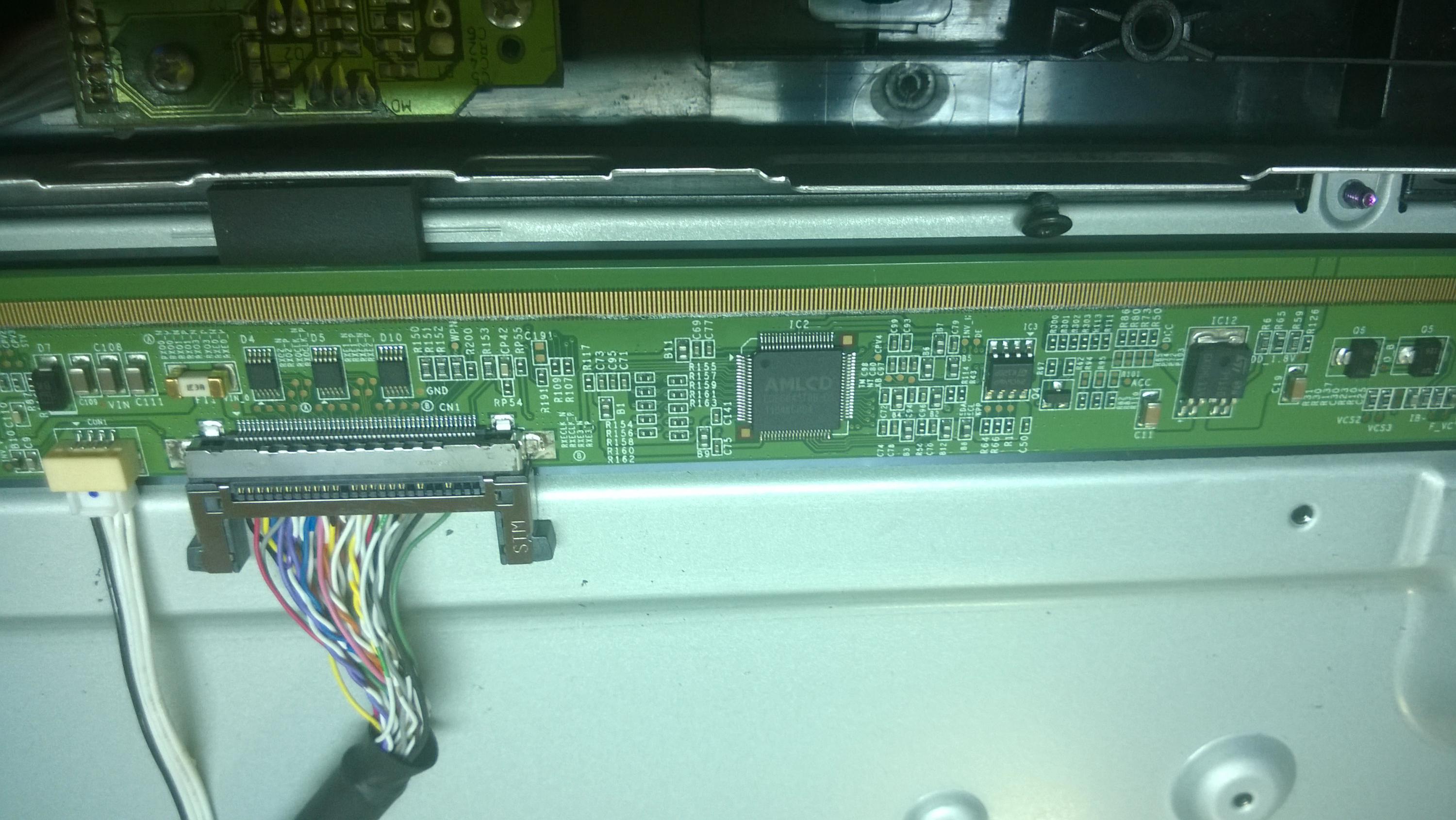

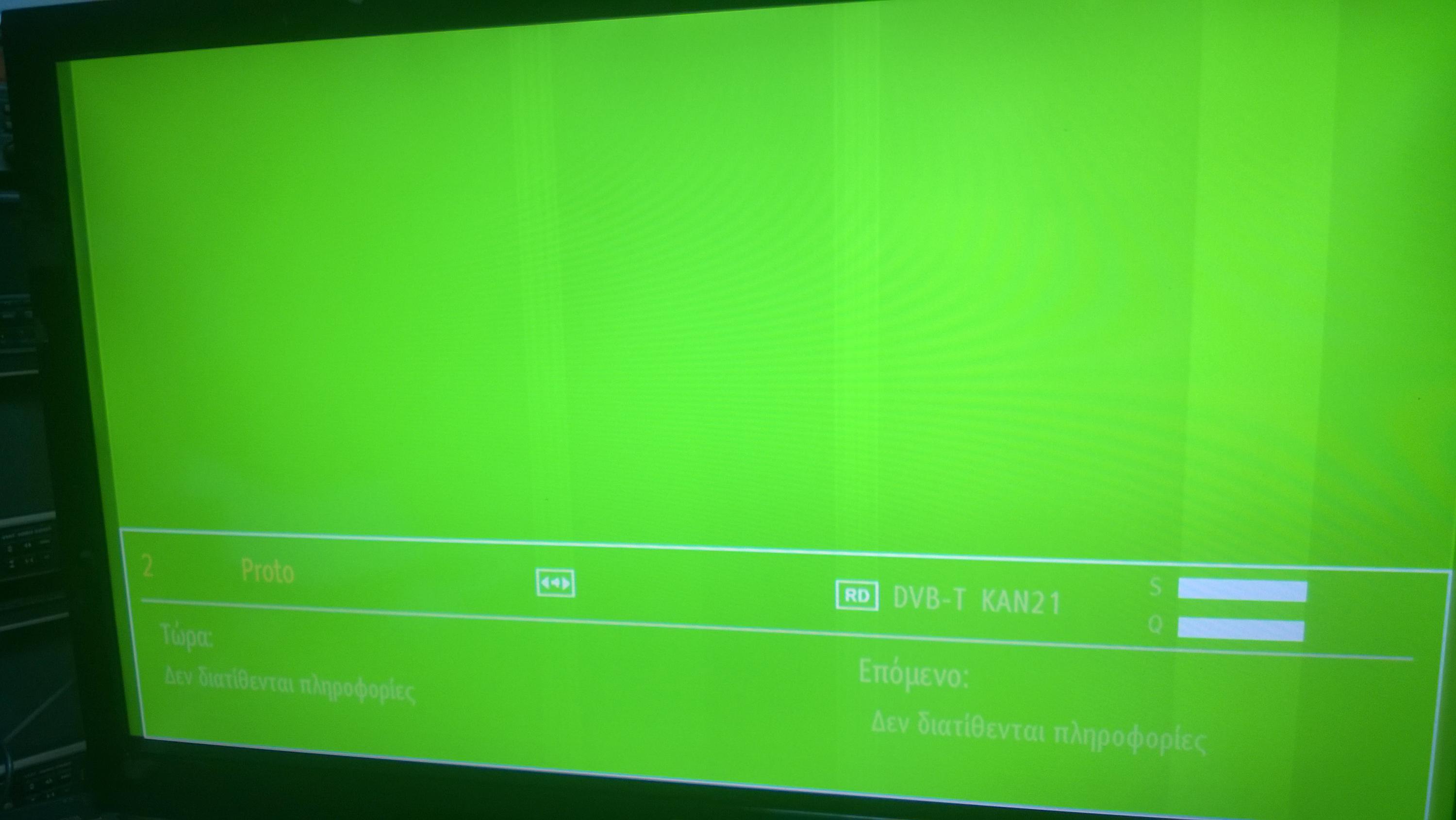

    Hello.

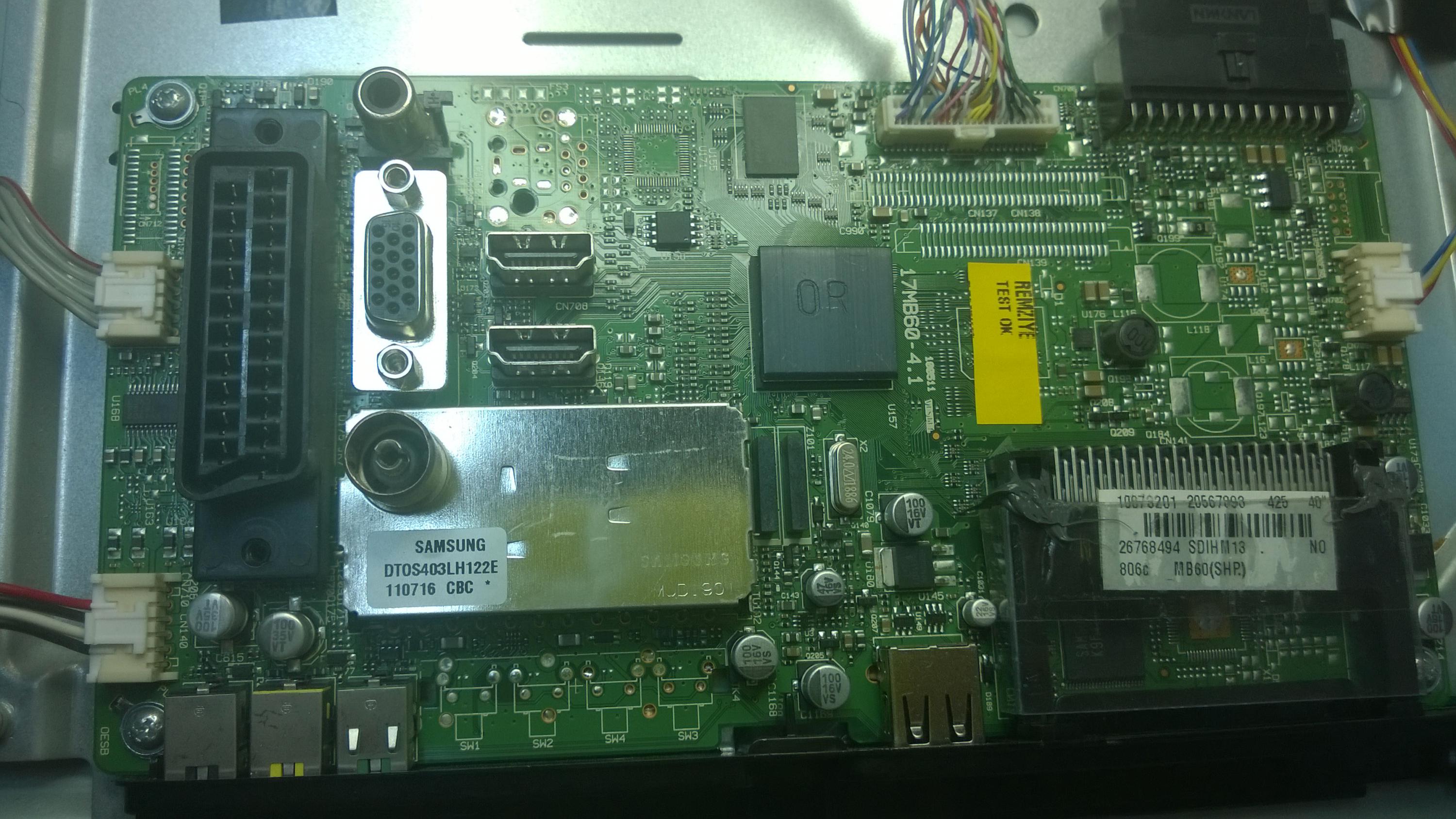

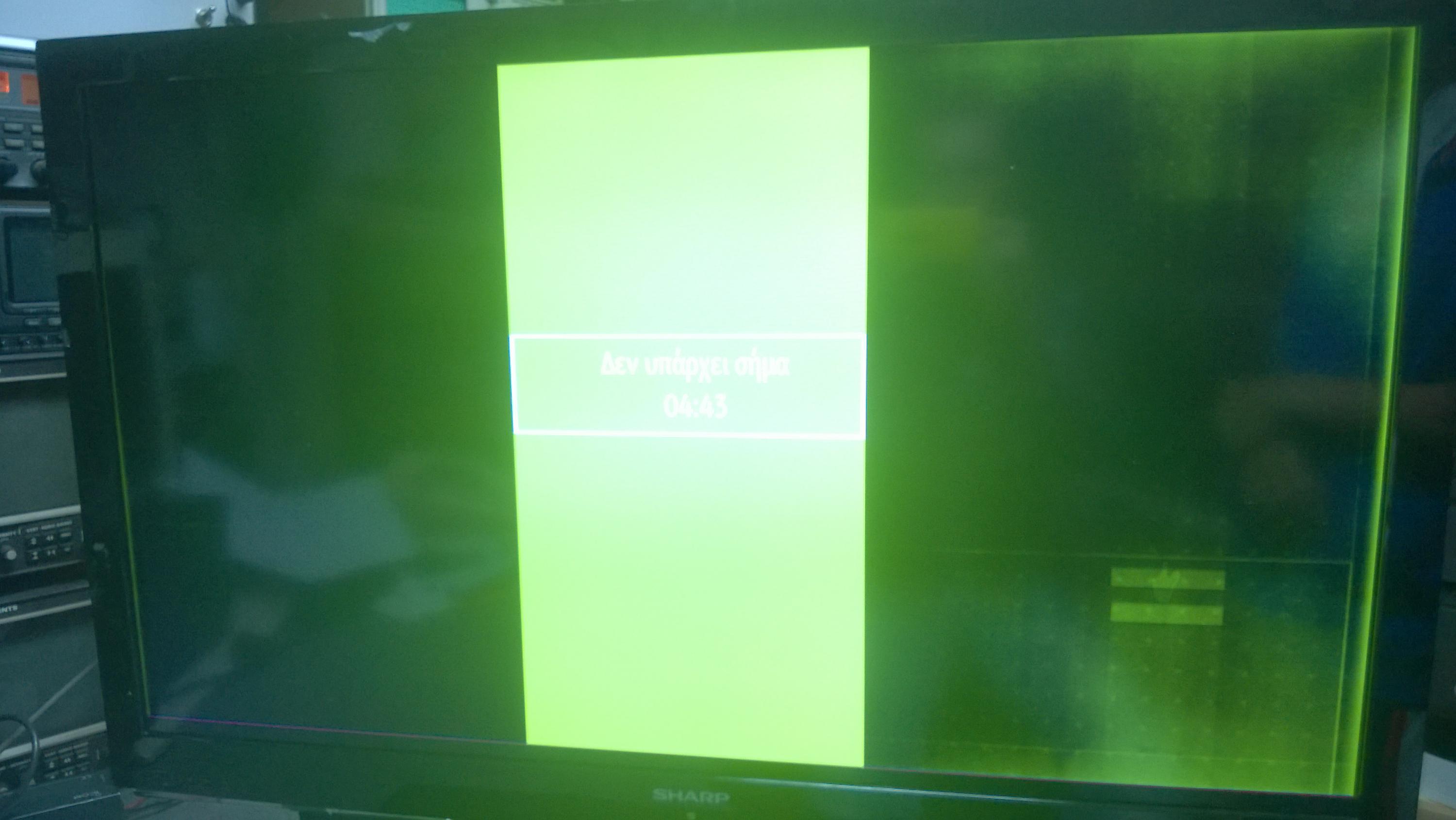

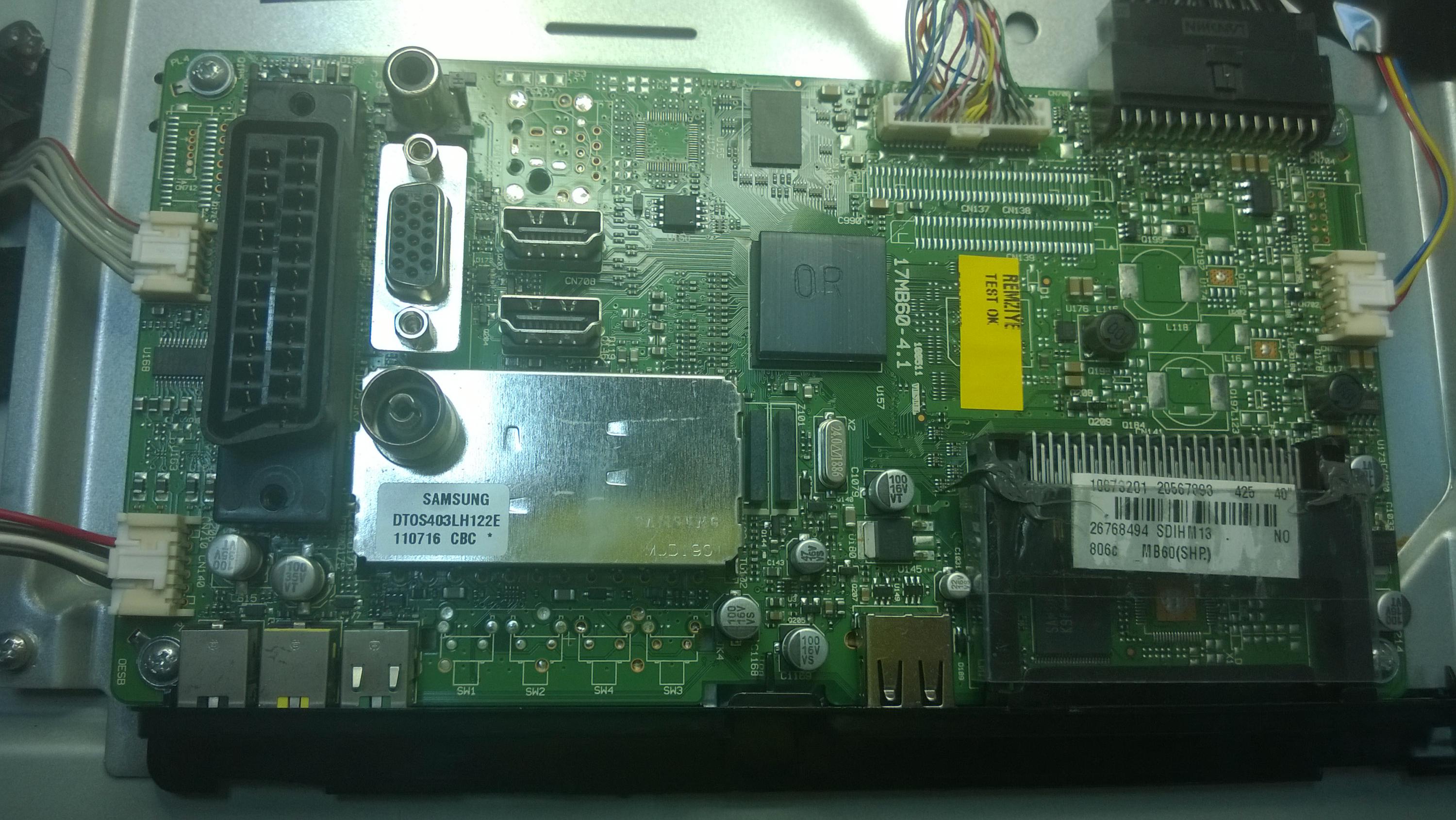

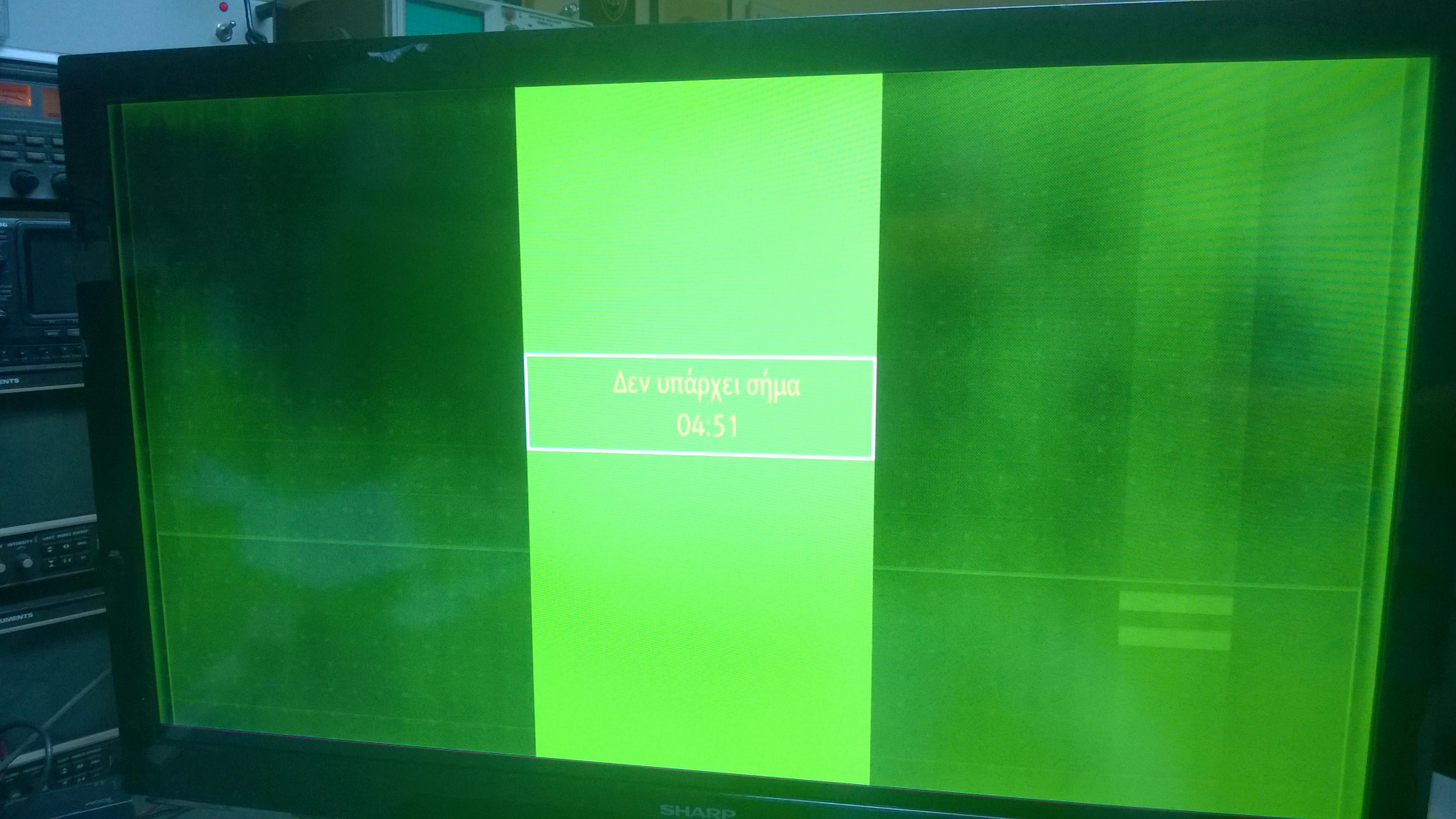

    I have a LC-40LE510E that displays only green color and if left on same channel for some seconds then it fades out until black, when i change channel it gets bright green then fades again and so on.

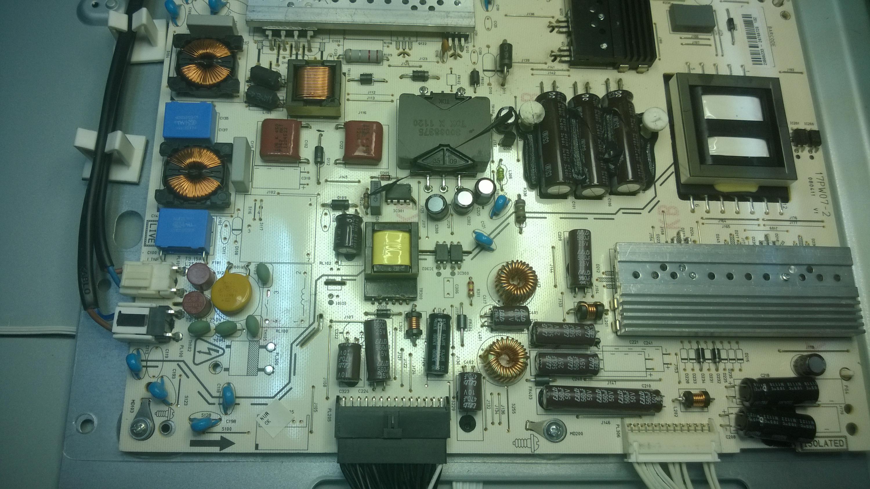

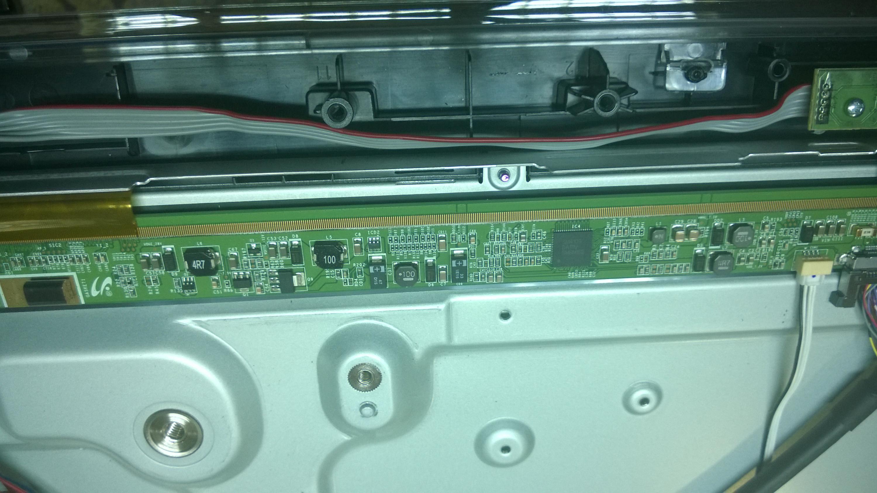

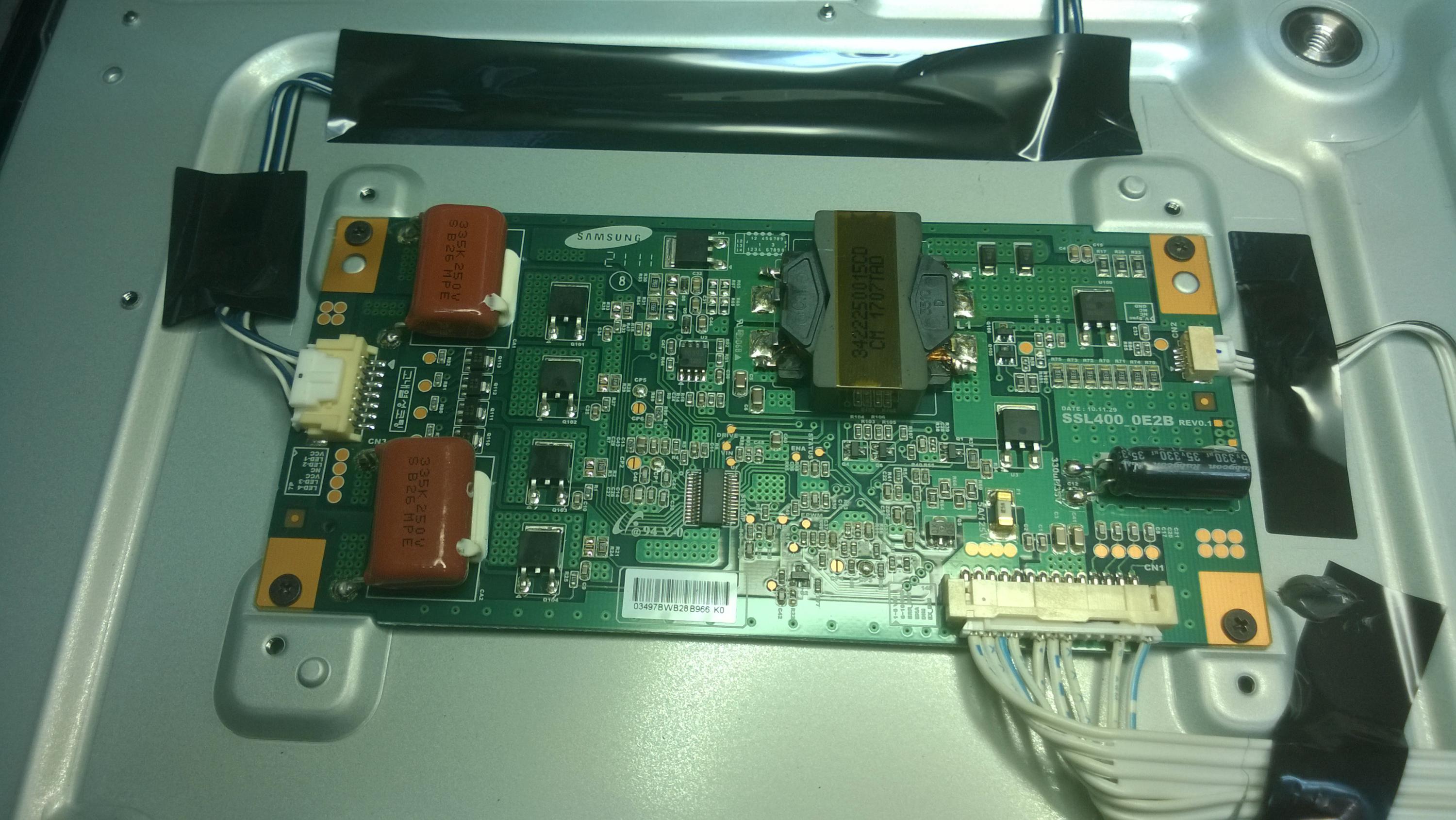

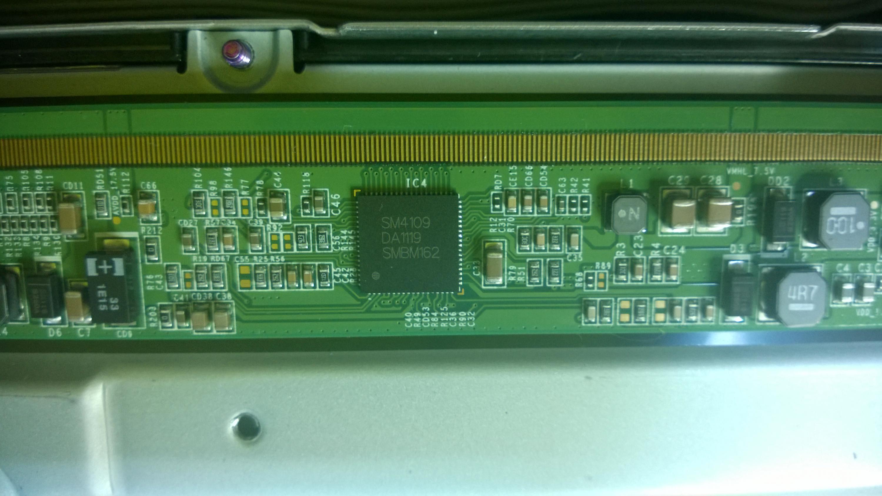

    I have taken photos of all boards and symptoms but since that seems mostly like a T-Con issue i taken lots photos of it.
    Unfortunately the service manual isn't available to public so i count on your experience

    Looks like a defective LCD panel.
    This TV is made by VESTEL not Sharp, it is just re-badged and is absolute junk.
    Maybe try checking panel voltages on T-con board, non replaceable part.

      Damn... Do you have any idea where should i measure and what voltages should i expect ?
        Re: Sharp LC-40LE510E Green color only
        VGH = about 20 to 30V
        VGL = about -5V to -10V
        AVDD/VDD = about 14V to 16V
        those are the key ones, all measured with chassis ground as negative.

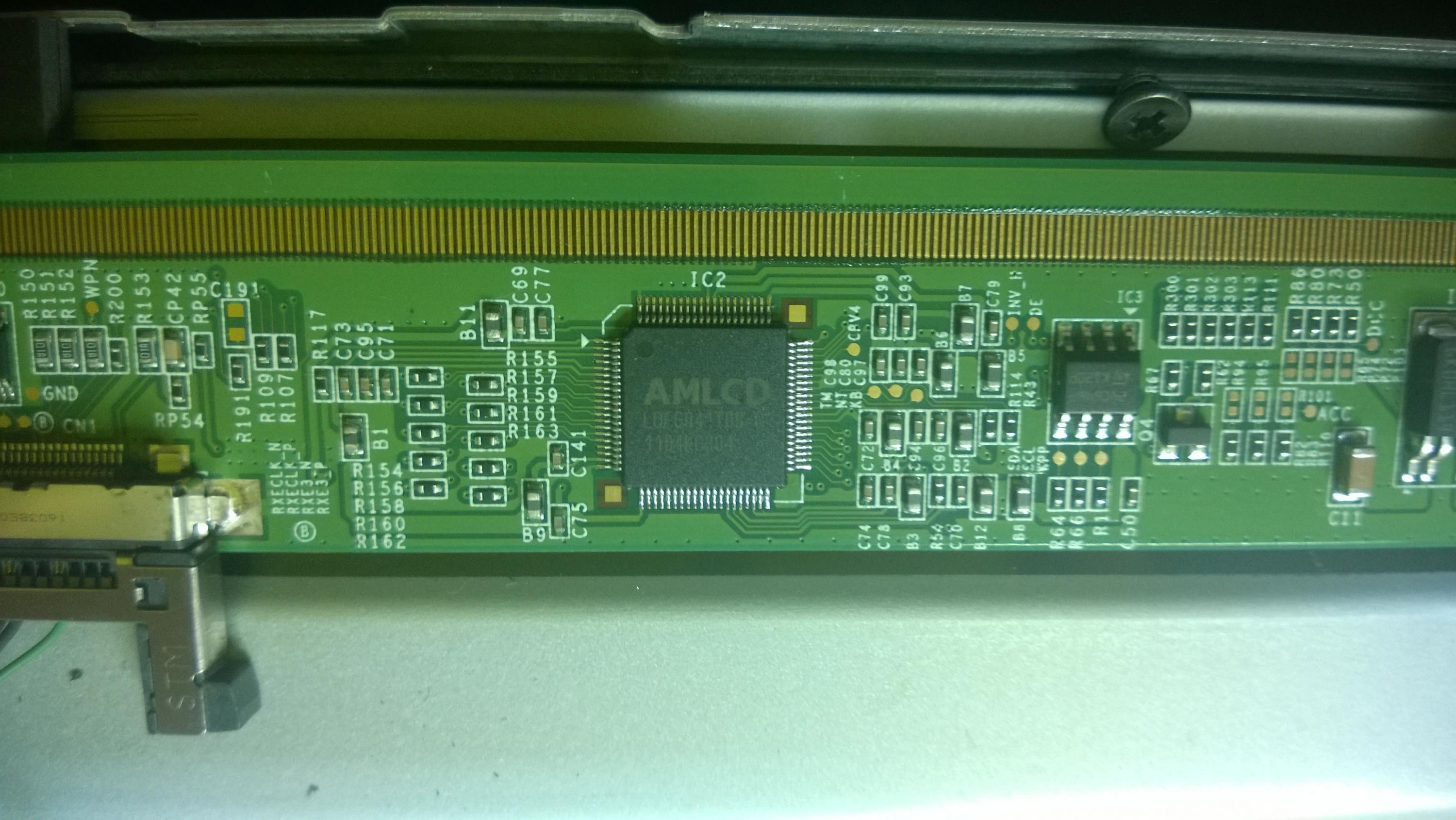

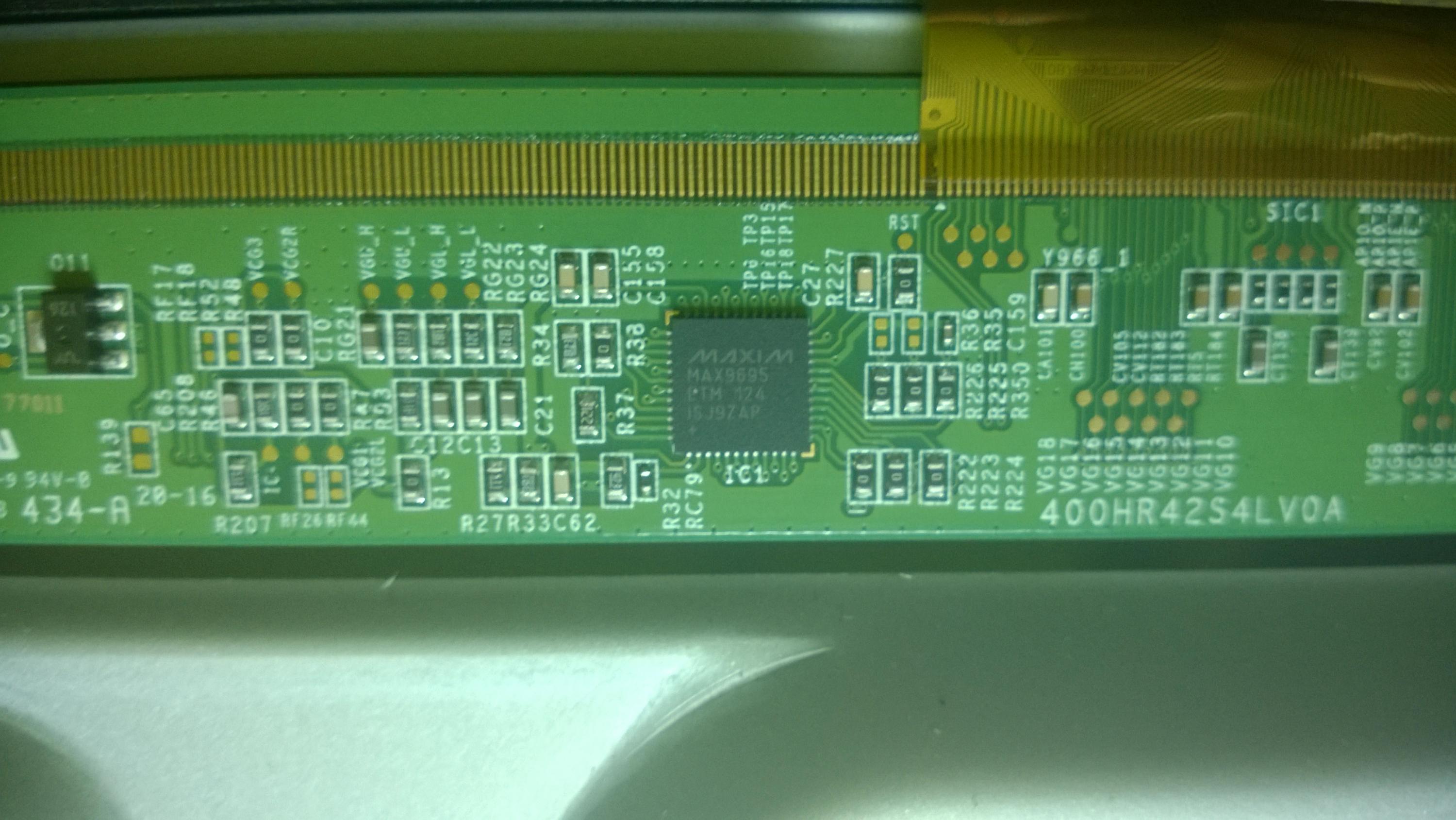

                        Ok i'm on the set now, i checked the t-con but i can't found any VGL or VGH , although i can found VGL_L and VGL_H, also no AVDD/VDD.
                        Can you please point me out?
                            Try VONE and VOFFE if you can find them, as well as VGL_L and VGL_H.
                                VGL_H = 7,81 and VGL_L = 0.5v (suspicious)
                                No VONE or VOFFE test points as i see.
                                  I can see at least one point marked VONE_28V and one marked VOFFE_7.5V or similar.
                                    Hello again.
                                    Sorry for the huge delay but i left this tv set on the side for a while to complete some more urgent work.
                                    Now i have plenty of free time and i catch it again, so the voltage on VONE_28V is 31v and on VOFF_-11V is -11v seems everything is fine on those 2 checkpoints.

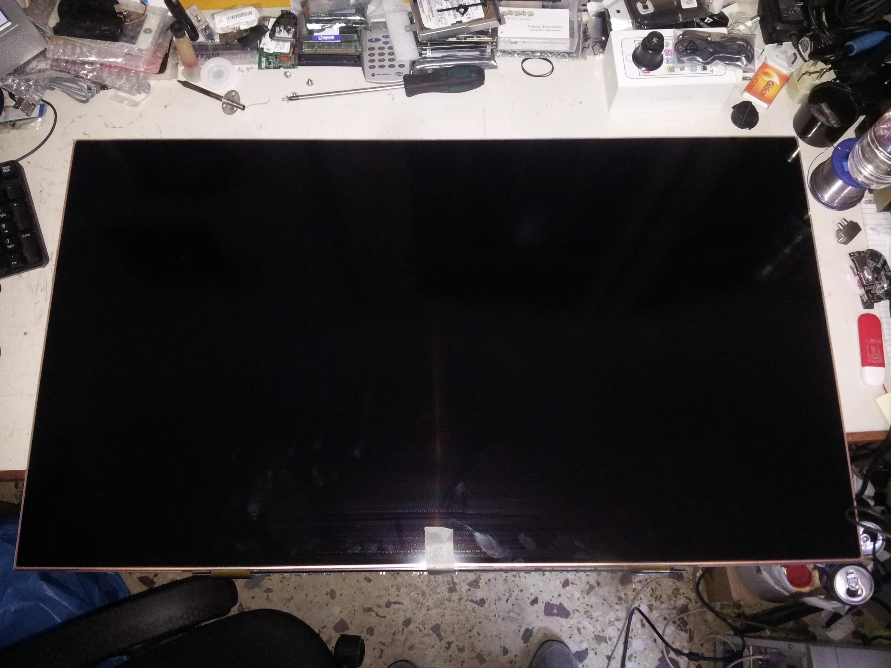

                                      Plus i got 2 great news, i completely disassembled the panel and found 2 very promising facts.
                                      1) The panel is not Vestel , it's Samsung.
                                      2) The panel it self doesn't have any components on it only the printed lines, so i think the panel cannot be defected. I attach a photo too.
                                      • mmartell
                                        • Oct 2013
                                        • 3189
                                        That WOULD be great news if Samsung did not have an abysmal panel failure rate too as evidenced by the empirical data in this forum.
