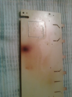

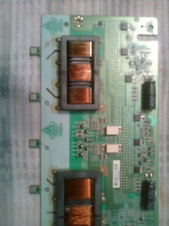

          Hello, just joined this site.
          I am in the process of trying to resurrect my toshiba 40e200u1. I also have the same problem.
          No picture, have sound. I have all necessary 24v and 5 volt BL-on and all grounds are good.
          I did try the so called flashlight test, can't anything at all.
          So, I am assuming the main board and power supply are not in fault as it powers up, stays on, has sound and back-light invertor is getting power, 5 volt signal and ground.
          Am I correct to assume this?
          I removed the invertor board and found this. See pictures below. Any advice as how to proceed would be greatly appreciated.
          I am an automotive technician, so I am very at ease with electrical checks and soldering. I am just not a TV technician, but I have fixed many power supply issues on projection tv's and pc monitors.
          First time trying to fix a back-light invertor. I'm pretty sure that burnt spot is my problem and probably need a new invertor board.
          But I thought I would some of you knowledgeable guy's if I should look at anything else while I am in there.
          I have another question, since I saw nada with the flashlight test, is there maybe something else wrong, like the T-con maybe?
          Thanx in advance.

              It looks like one of your inverter transformers has burnt up (brown mark on board).
              Can you measure and compare the resistance measured you have between the pins on each of the transformers, one against the other.

                Looks like ReeceyBurger123 post has highlighted your problem. Looking again at your pictures the burn marks are under the mosfets and not the transformer as I first thought.

                  Its not tarfo DB but the little driver mosfet for it. This is caused by heat as the mosfets run very hot because they are being pushed very hard. Read the thread I linked its a common issue.

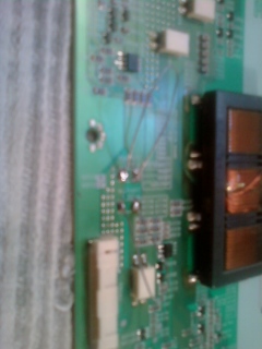

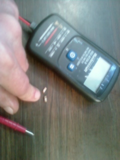

                    I checked out a few things on the invertor board and found the micro fuses F101 and F102 to be open.
                    125v 7a littelfuses I believe.
                    Now I don't know if this is a good Idea, so I will sound/bounce my idea off you all.
                    I included some fuzzy pictures, my cell phone is ancient. In one of the pictures, you will notice I quickly soldered in some wire to bridge the fuse gaps in the hope of that helping me trace the PCB.
                    Good or bad idea.
                    I have not installed the board without the fuses. I do know there is no way in hell that invertor board could function with those two fuses open like that.
                    My gut feeling tells me that even if I install new fuses, this board is far from be fixed. But I have to start somewhere, right?

                      just dont power it up, too blow both 7 amp fuses maybe a invetor tranformer/mosfet etc is short circuit is there any writing on top of the transformers ? also what is the invertor board part number.

                        Read post 6, you will probably need to replace the MOSFETs and the controller IC.

                            Oh, plz don't laugh at my soldering job or at my smart multimeter.
                            Although I do like that funky little multimeter. It great for around the house work like this.

                                  You should use the original type smd slow blow 7a but the one suggested will work but might not limit as much damage in future cases. Also the board pictured has two less bulb connectors so they are not interchangeable.
                                  Also the repair kit you should change all the transistors and the controller Ic as well as resoldering almost every smd resistor and part on the board as if they break lose they will blow the new fets. Also the transformer isnt burning the parts either !

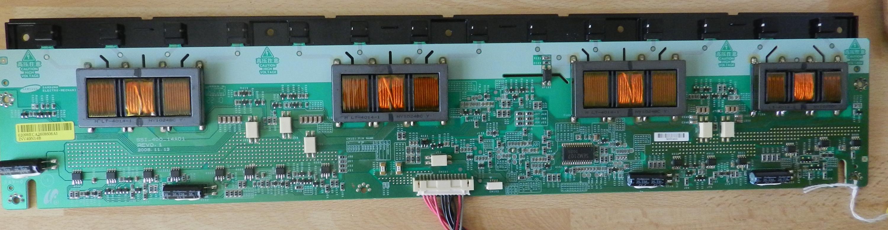

                                      It's really hard to tell from your picture because it's too small but the inverter board looks identical to one I've recently salvaged out of a Logik L40DIGB20.
                                      Board details:
                                      Samsung Electro - Mechanics
                                      SSI_400_14A01
                                      REV0.1
                                      2008.11.13
                                      Yellow label:
                                      02098ECA2608606A1
                                      INV40N14B
                                      It may be worth your while looking to see if they are identical boards and if they are if the Logik board is more easily available.

                                        Yes, that is indeed the exact same board. However, every link I hit is across the pond. UK. If push comes to shove, I will pay the extra for overseas shipping.
