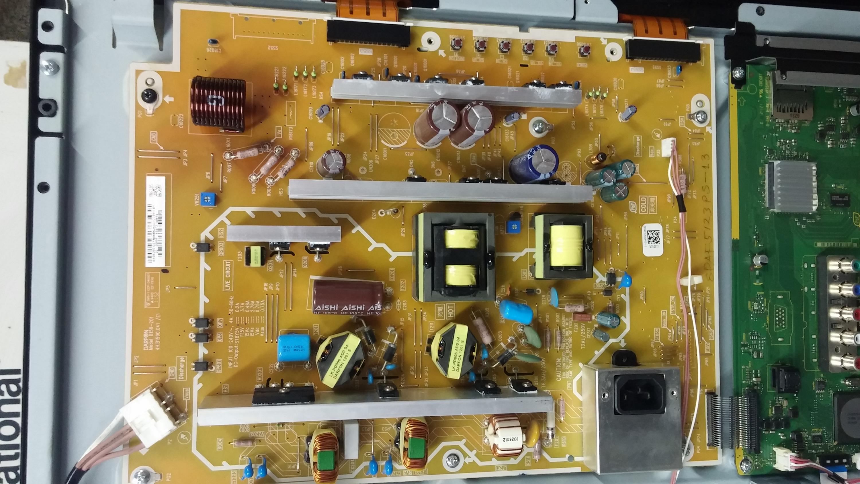

    I have a TC-P42X5 when I connect power and press the power button the red led on the front comes on but no blinking no relay clicking no picture and no sound. I have tried powering it on with everything unplugged from the board and no change. I do have steady standby power. Any suggestions where to go next?

                Re: panasonic TC-P42X5 red led no picture no sound
                Can you supply pictures of the power board in the set?
                • joef1812
                  • Sep 2014
                  • 16
                  • usa
                  If you need something else let me know
                    No relay. I'd suspect A board, maybe wait for tw2005 to chime in as he's got some experience with this model I think?
                              I'll order an A board and see what hppens
                                Make sure to get the 42" A board as the 50" one is not compatible.
