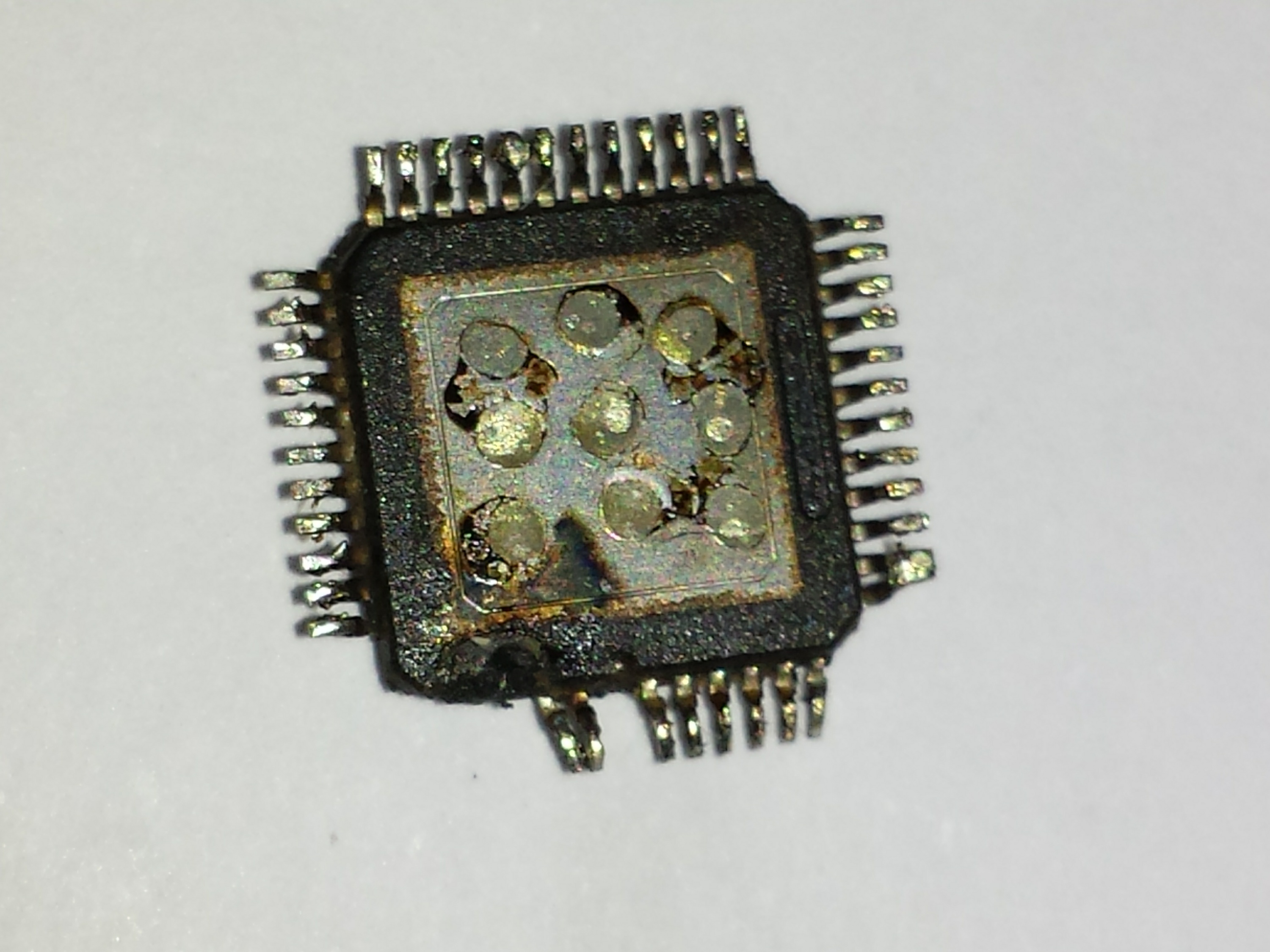

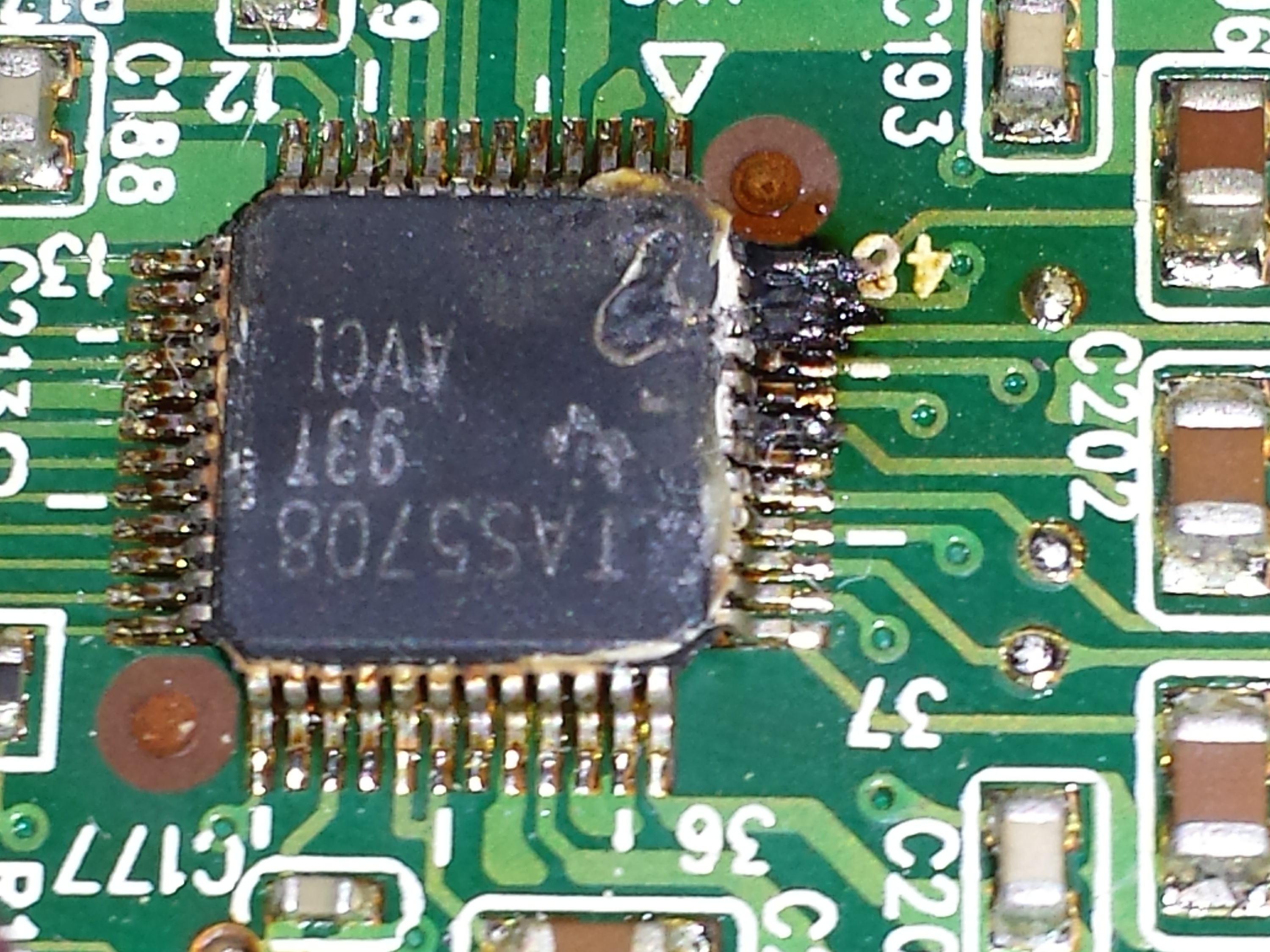

    Toshiba 32AV502R - No Sound, Burnt audio amp IC.
    Got this one on Sunday. Turns on, but has a bad panel. While testing, I discovered it has no sound. Upon further inspection I found the audio amp IC to be fried. I got it off the board, but 4 traces came up with it. They were fused to the pins. IC also has burn marks on the ground pad underneath. I can't find any shorts, so I think it's just the IC. I'm going to try to fix it. I think I can jump the traces with magnet wire.

    Re: Toshiba 32AV502R - No Sound, Burnt audio amp IC.
    I had a similar issue with another set once.
    I used a signal tracer and found the audio IN signal pins (X2 for stereo).
    Built 2 audio amps with LM 386 and connected to the speakers.
    I think it still works today and that was since last year some time.
