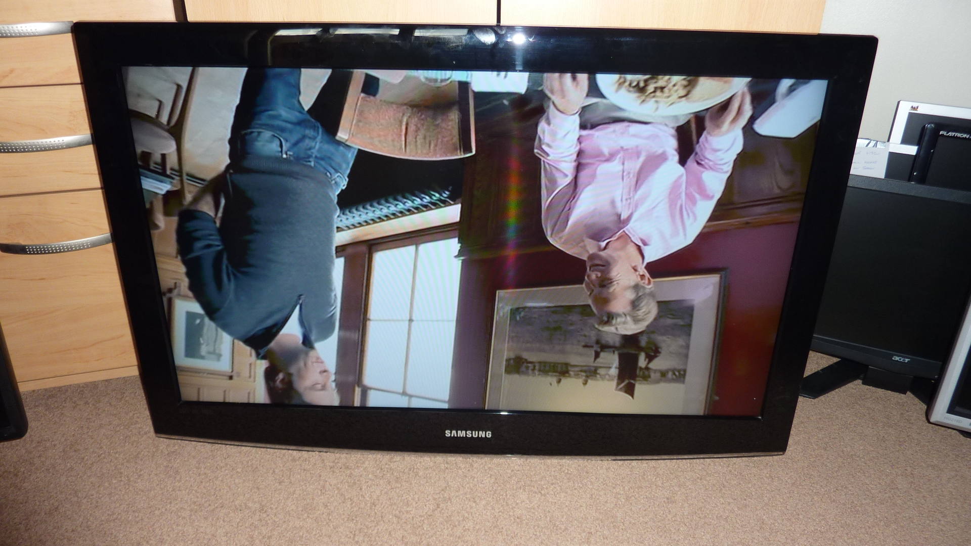

    I have a Samsung LE37A457 37" TV and the picture has flipped upside down. I have look in the service menu and can not see any way to chance it.
    Can any one please help.
    Terry

    Re: Samsung LE37A457
    Here is a picture of the problem
        Is the TV connected to a computer by chance?
        • zdsh07p9
          • Nov 2013
          • 155
          Also, is it like this on every input?
          • terry
            • Oct 2007
            • 91
            • Milton Keynes, Bucks
            No not connected to a computer and is the same on DVI, Scrat and standard arial
              it is necessary to update the firmware
                I have check if there is a firmware update and I have the latest one already installed.
                    Check Panel Inch, Panel Type and Model Option in Service Menu.
                      Did it happen by itself or someone had worked on it before?
                        I turned it on one day and the picture was upside down, I have done a factory reset but this did not help.
