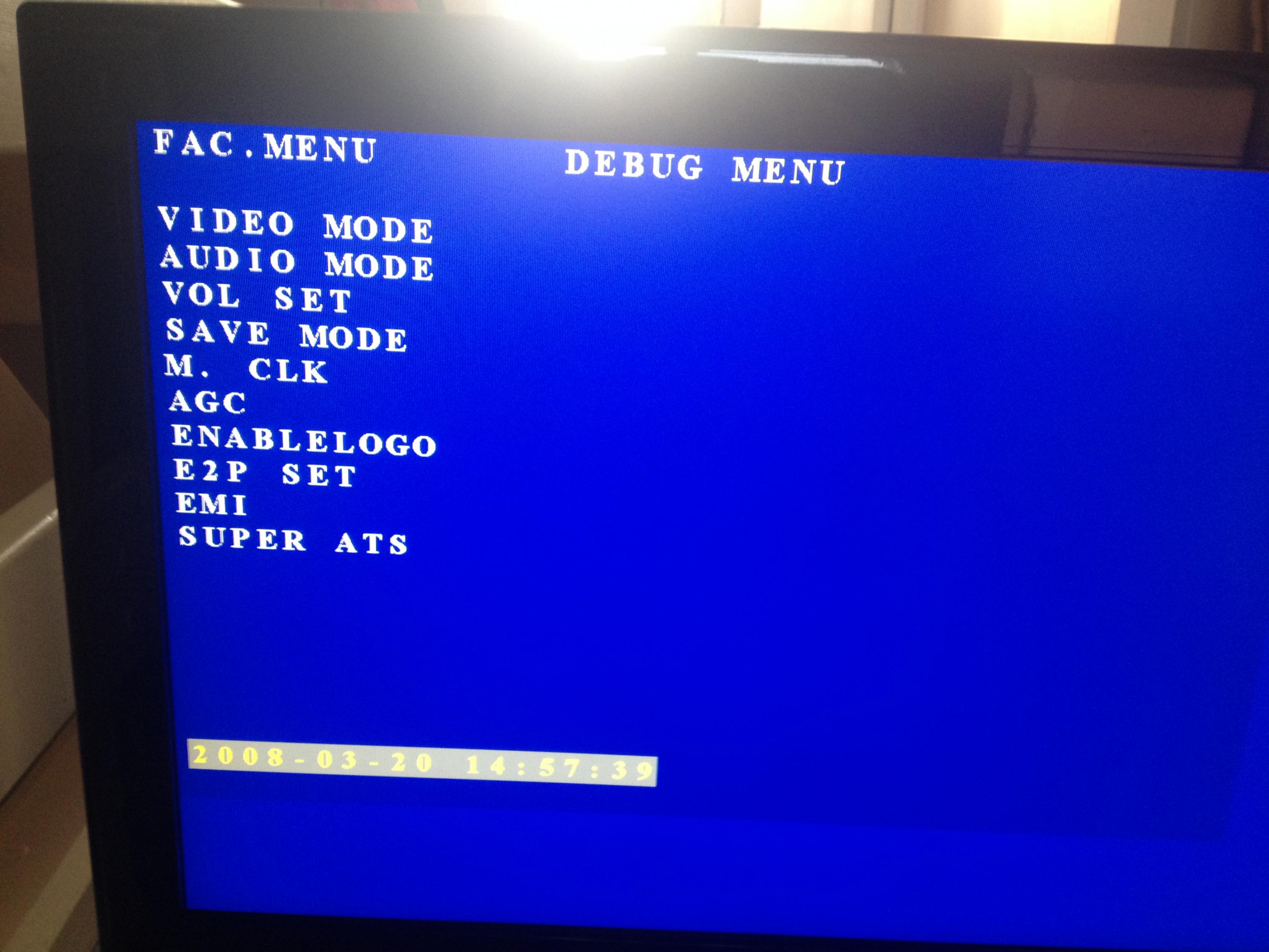

    does anyone on this fantastic site know how to reset to factory setting on this tv ?
    have had a search around the net, and tryed all the codes i could find, and nothing has worked,
    i must point out that i only have a universal remote that i can use 90% of the function on this tv, MENU, numbers,ect.
    thank you for any help that you may be able to give.

                • ReeceyBurger123

                  Re: Technika LCD32-M3
                  On technikas its usally " menu 4725" depending on the chassis.

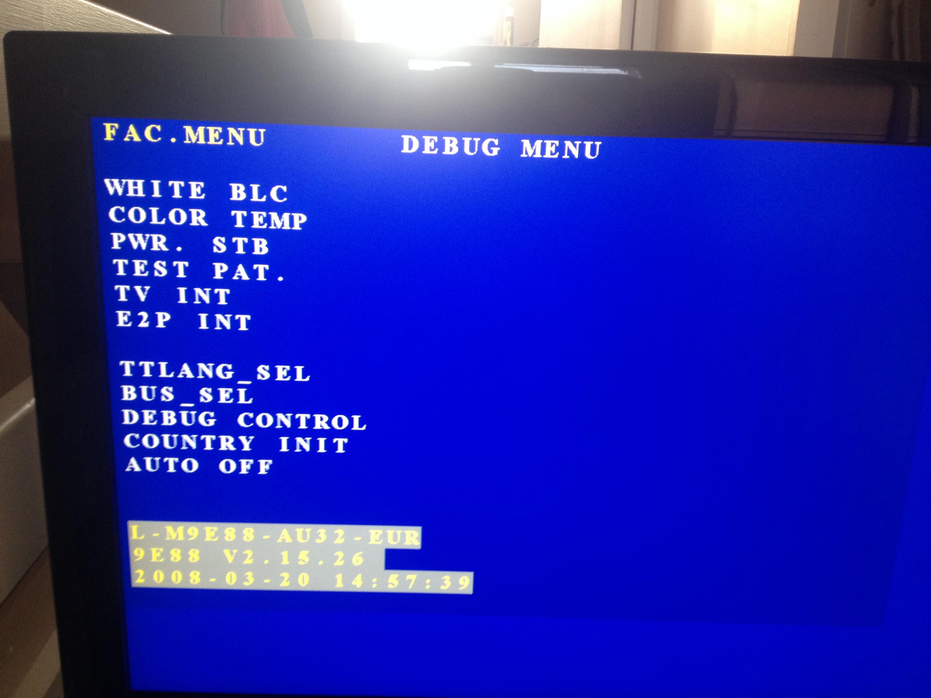

                    useing the haier code for service menu works, but can only access while in analoge tv mode,
                    i can access 2 menus, but don't see any factory reset.
                      The motherboard is actually a haier, pull up menu, hi-lite β€œaudio” then enter 8893 I believe this will bring up another menu with a factory install option could you try this ?
                        yep, that is what i used, and the pics are what i got
                          Hi you need to get the right remote (see my old post now been updated ) Flocko
