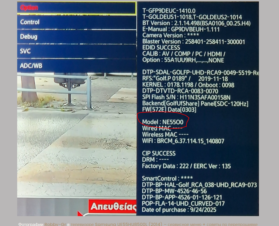

    I’m trying to recover a Samsung UE55HU8500L (curved UHD, 4K model from 2014) after replacing the panel. The new panel is a 55A1UU8EH, which produces excellent image quality — very close to the original.
    However, since the swap, the TV enters a boot loop (Samsung logo → restart) unless I enter the service menu and perform a reset.
    The service mode had been previously modified — possibly by a technician or during the panel swap — and I suspect some key settings are mismatched for the European (Greece) market.
    Additional issues:
    - The HDMI ports behave incorrectly: port order seems scrambled (e.g., HDMI 1 acts like HDMI 2)
    - No audio output over HDMI, even though video works
    Here’s what I’ve tried so far:
    - Adjusted Type, Local Set, Front Color, Panel Display Type, Model, Tuner, EDID Write, etc.
    - Compared values with other HU8500 units
    - Verified internal connections and performed factory resets
    Despite this, I haven’t found the correct configuration that allows the TV to boot normally and restore full HDMI functionality. The image looks fine after reset, but the boot loop returns after power off.
    📸 I can share screenshots of the current service menu settings if helpful.
    👉 I’m specifically looking for the correct service menu values for this 2014 4K model in Europe/Greece, especially after a panel replacement with 55A1UU8EH. If anyone has experience with HU8500 servicing or knows the right configuration for this region, I’d be grateful for your help.
    🛠️ As an alternative solution, I’m also exploring firmware engineering and reflashing. If I can reflash the firmware successfully, I may be able to reinstall the latest version (1410) cleanly and potentially resolve the boot/audio issues. If anyone has experience with reflashing on this series or knows whether this approach could help, I’d love to hear your thoughts.
    Thanks in advance!

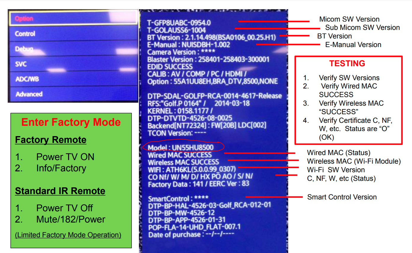

      I do not know why but the window with the panel type seems to lack some items, try to access the full menu by entering the service remote key, even by portable device + ir blaster + wav file (i have the files) , so you can unlock the panel type & front color write options..
      • Diah
        • Feb 2013
        • 6435
        go to samygo.tv and you will find complete entry service menu Photos to compare

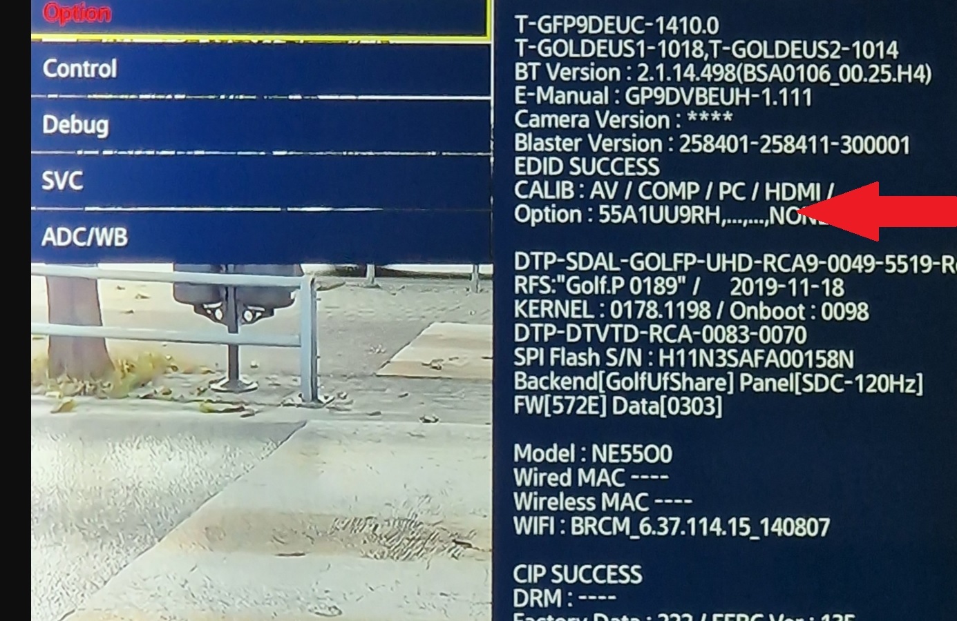

          Maybe the problem is the panel number, you write 55A1UU8EH but the data says 55A1UU9RH. The OCB sees a different panel than and maybe therefor the tv resets.

            Yes, you have some strange model in the menu, it should be like this.

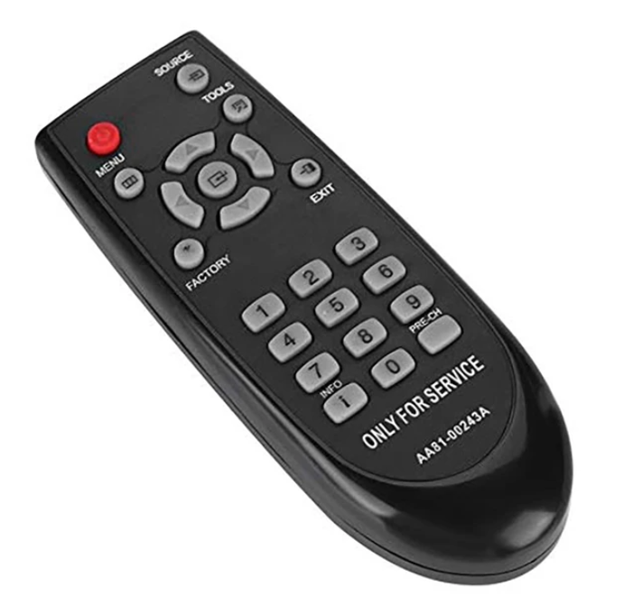

                  Why bother with such complications? There is a special remote control AA81-00243A, and it costs pennies.

                        You're right, William1967. You must have looked at the wrong panel in an internal menu;
                        that was from other tests. It's actually the first option, though of course, I don't know
                        if that one is correct either, but it's working well. Thank you very much for your help
                        with the issues I mentioned.

                        I will still be missing the correct values to input. Regarding the Service Remote Control,
                        I will look into how I can purchase one. Thank you again for all your help. Kostas
                        Hello Lotas, your note and the hint with the image you sent really woke me up, because
                        I was taking that panel for granted and wasn't paying attention to the model listed there!
                        Also, the image of the remote control was very helpful. Thank you again. Kostas

                                          the link i gave you are threat name Defult Service Menu Setting UE65HU8500 , at first post there are link for the photos of service menu.
                                            09-07-2024, 05:50 AM
