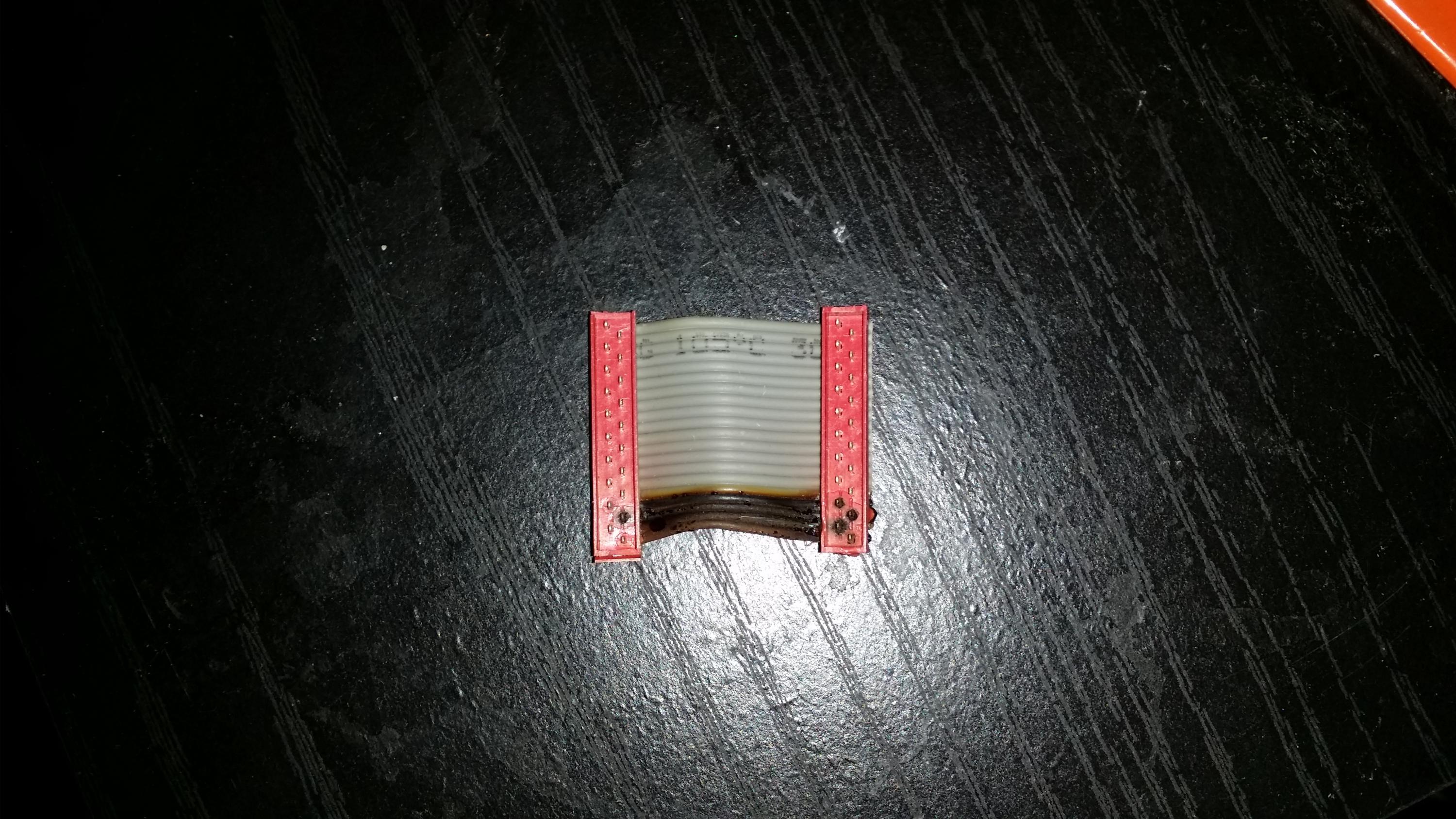

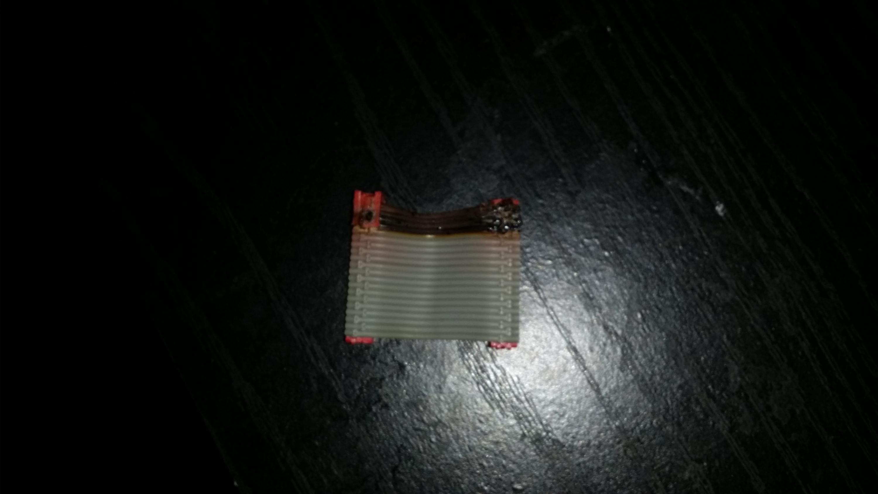

    Hey all.
    My tv went out on me a bit ago. I was able to find the problem that the connectors for the master and slave light boards had been fried. The boards seem intact with the only damage being on the connectors. I can't seem to get any specs on the actual connectors as what size or 'pitch' as I was asked by a tech at digikey. If anyone has info much appreciated
    light board part # VIT71879.00 & .01 Master .02 & .03 Slave
    I have attached (I think) pictures of the connector.
    Thanks in advance for any help
    Re: Samsung LN65B650X1F connector for light driver boards
    It looks like IDC 20-PIN, more likely to be 0.050" or 0.10" pitch? just have to measure it, similar to one used on IDE Hard drive connector.
    http://www.digikey.com/product-detai...223-ND/1106582
    http://www.digikey.com/product-searc...BLE%20ASSEMBLY
