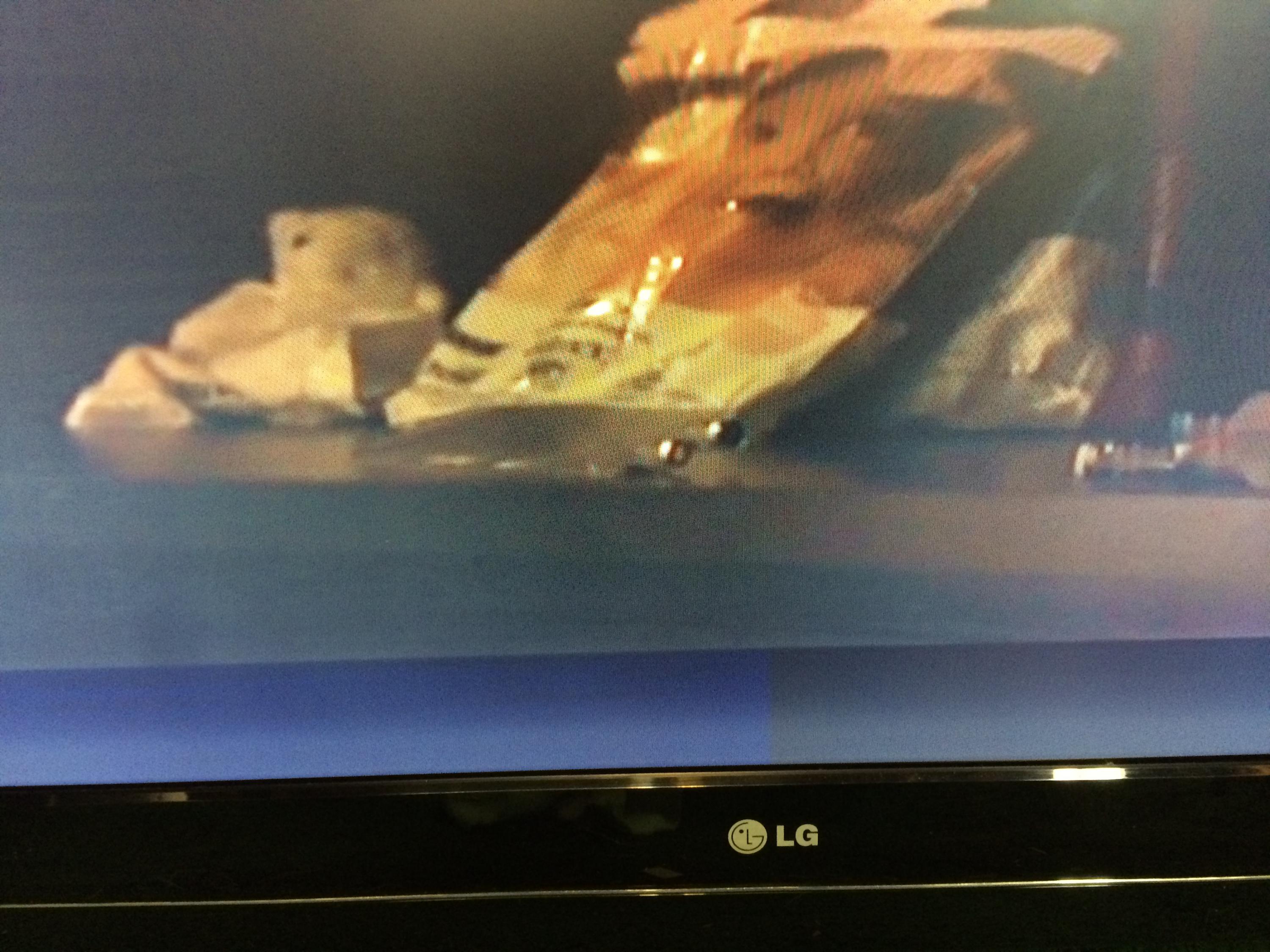

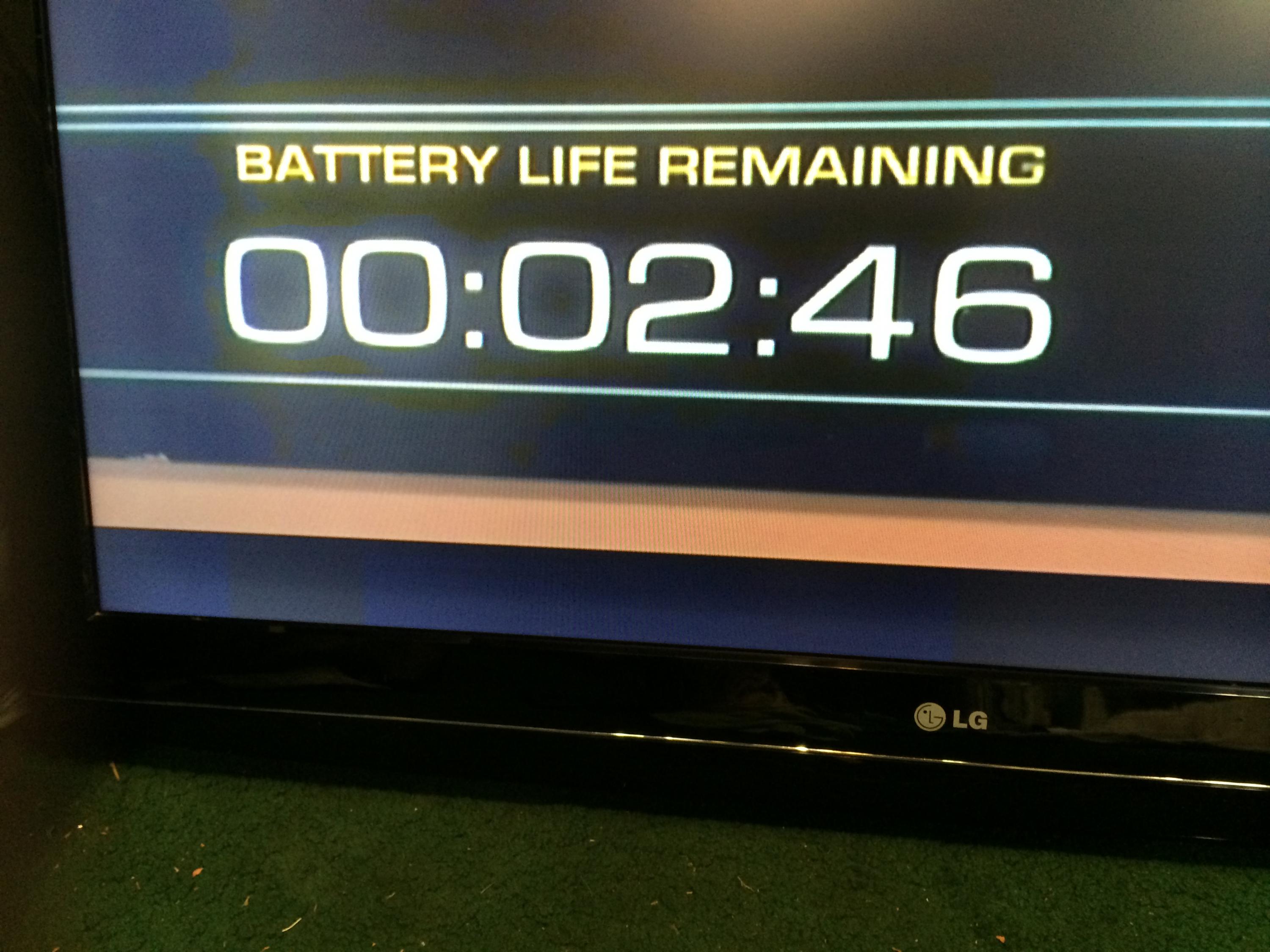

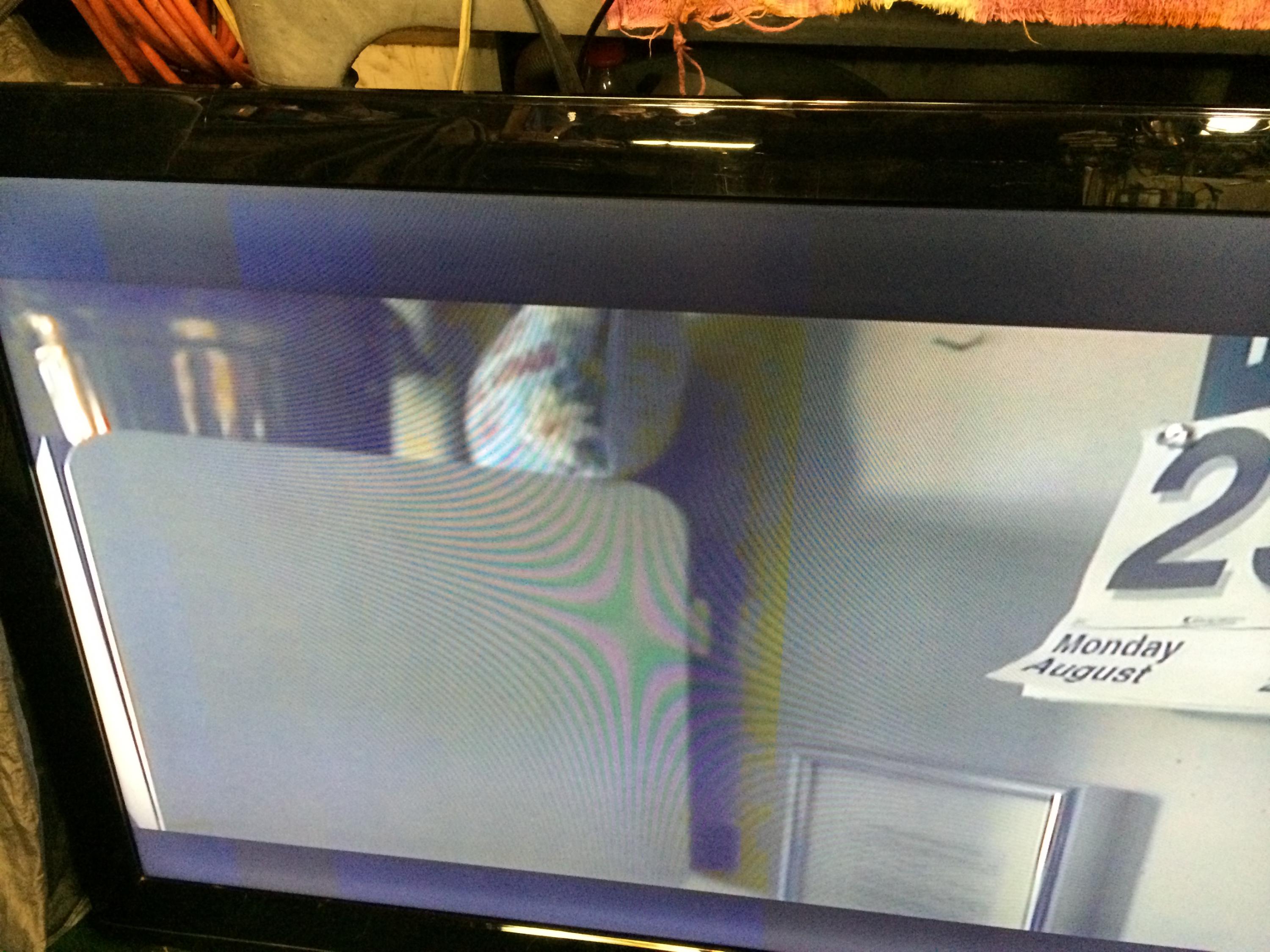

    I just thought that I had put this set to bed but another issue has reared its ugly head. I am getting yellow ghosting on the images of the left half of the screen and the border around any letterbox movie is dimly lit blue instead of blacked out.
    I am thinking of swapping the ribbon cables on the T-con to see if it swaps sides. If it does then that is a no-brainer. If not, I will try the tab bonds next. Lastly, it must be the T-con I just put on. Is there something else possibly to look at?
    Thanx,
    Bud
  • 69sixpackbee
    • Jul 2014
    • 39
    Re: Another Issue With LG 47LG50 Half Screen Distortion
    Fixed it!
    Reseated cables.
