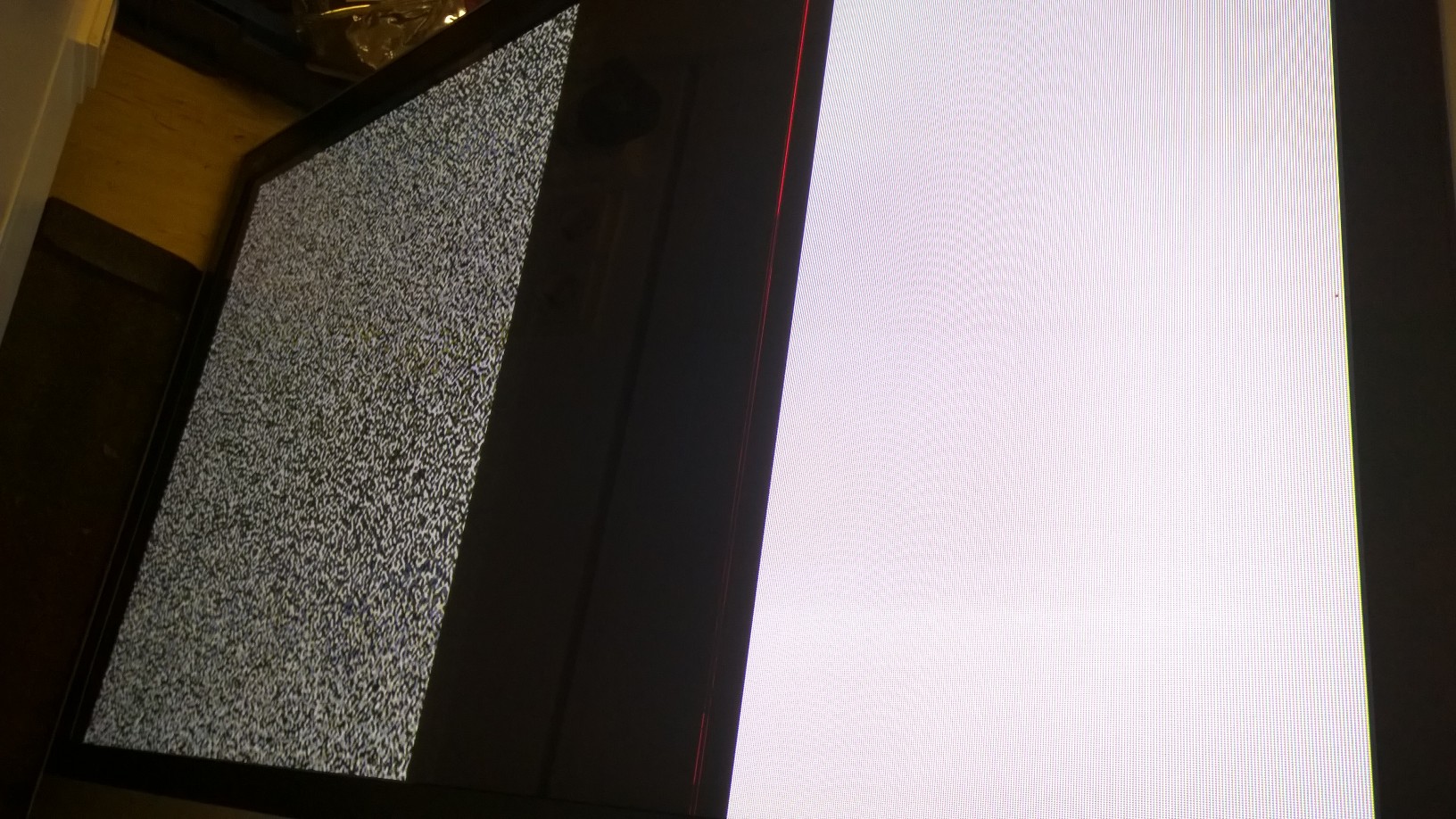

    Hello
    Got this Panasonic plasma TH-42PV60E. Half of the screen was OK, so replaced both X-buffer boards. (TNPA3812 / TNPA3813)
    No difference.
    Could this be a logic failure?
    Or panel?
    Attached picture is from the TV standing on the side.
    Re: Panasonic TH-42PV60E
    Bad panel, single pixel vertical line gives it away.
    • PowerAmpFreak
      • 977
      • Sweden
      Shit, bad news then.
