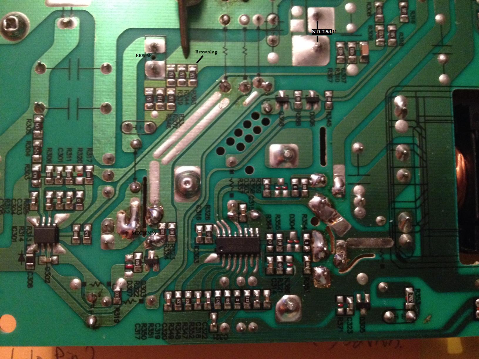

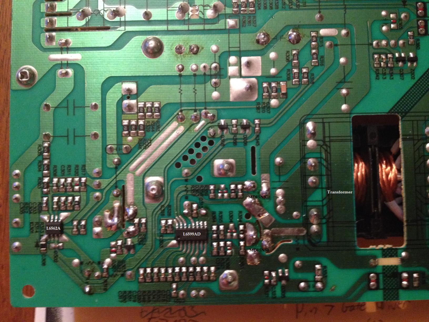

                                  budm, I traced the L6562a back to L6599AD which operates at a self-adjusted voltage between 8-16 vdc. When the outputs drop out this IC vss also drops to zero volts. While the PS_ON is still measuring 5vdc.
                                  Also, there is some browning of the area around ER806F (see pic). The brown area traces lead towards the Mosfet driven by the L6562a. The NTC 2.5d.11 is a thermistor connected which should have 2 ohms when measured and does. This is connected near the browned traces on the board.

                                    Re: Westinghouse 46" Model VR-4625-Need Help
                                    L6599 for the 12V/24V SMPS uses the same voltage generated by the standby power supply AUX winding fed by more likely the same switched transistor for the PFC IC VCC PIN.
                                      One more pciture
                                        budm, I get what your saying but i for the life of me can not see which one it is...can it be seen in my pictures?
                                          Example of typical setup for the switched transistor for supplying the voltage to PFC and the 12v/24V SMPS.
                                          QB802 is the switched transistor in this example.
