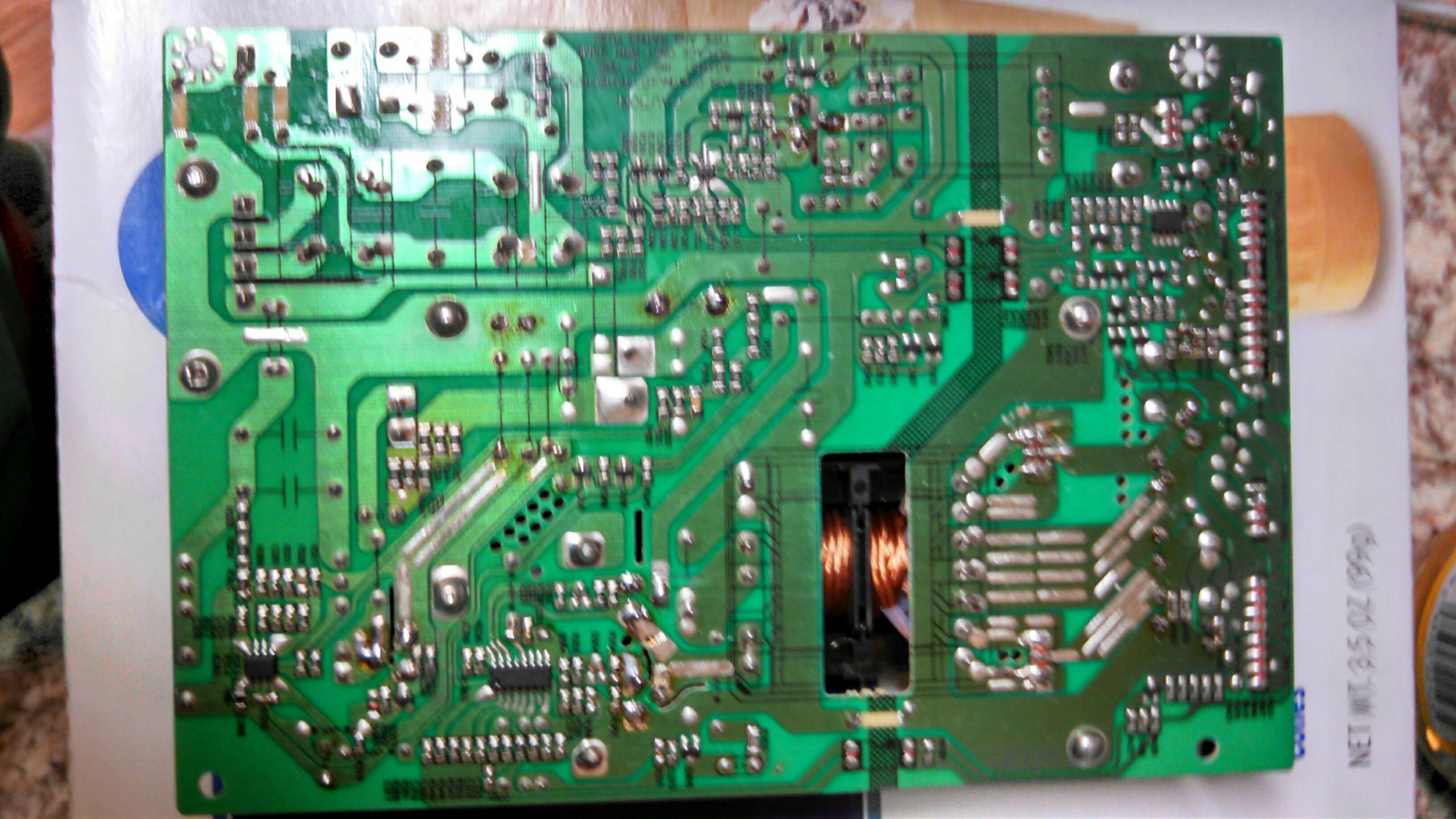

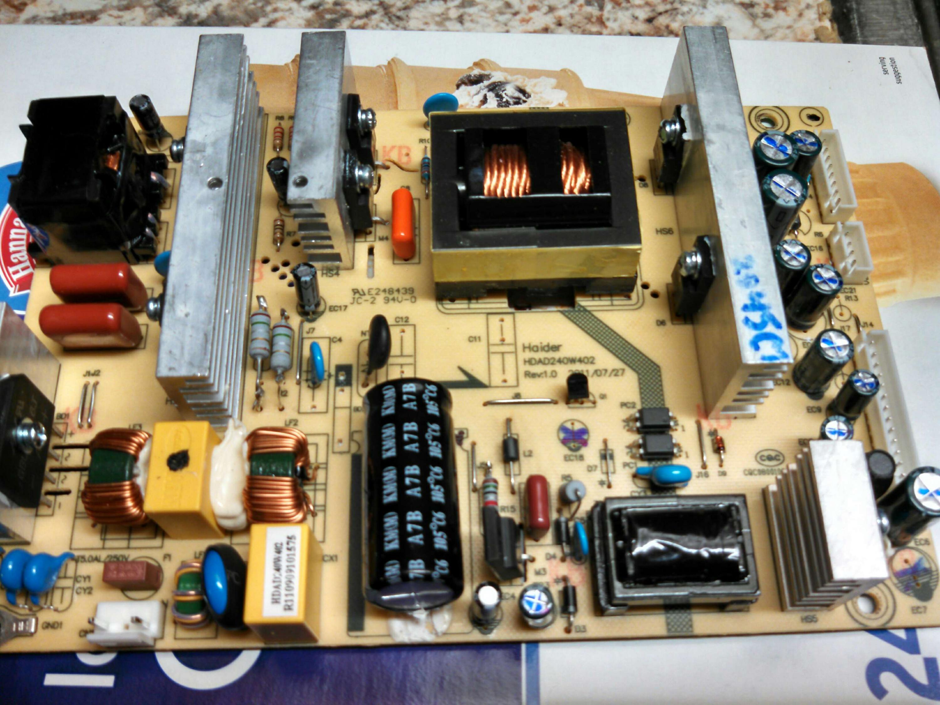

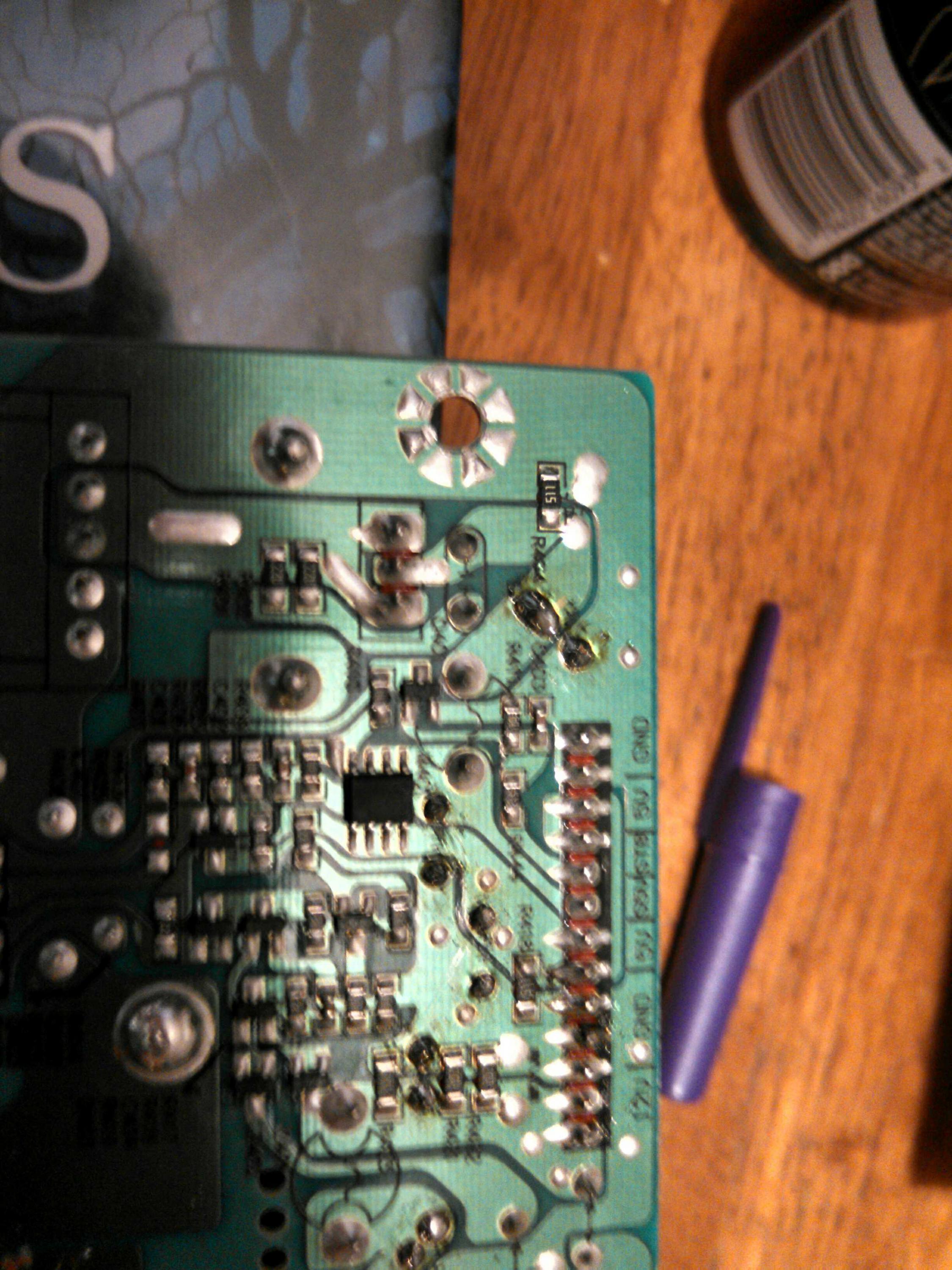

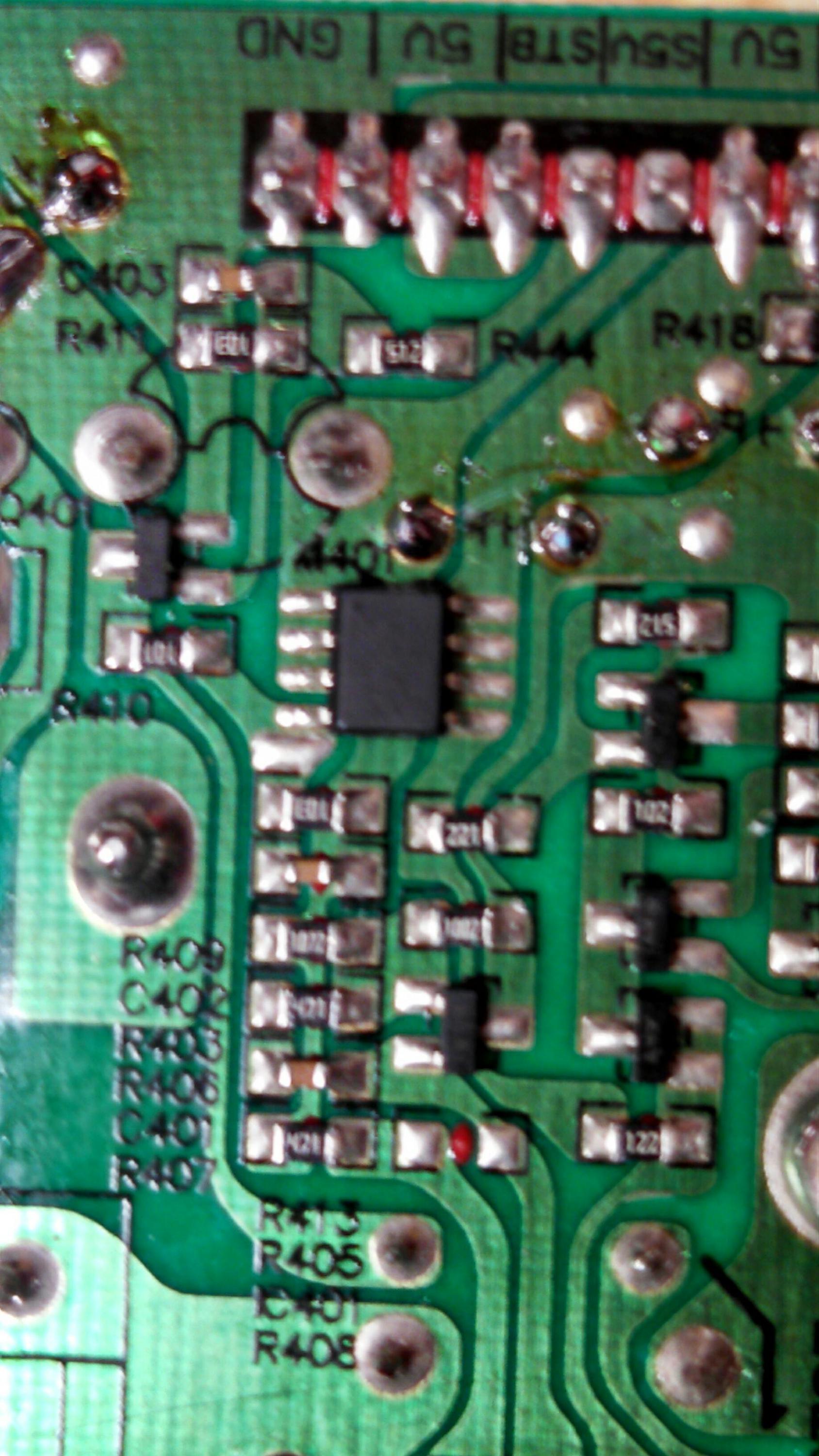

    I have a westinghouse 46" TV model VR-4625. The power supply is giving me problems. I have replaced all the caps, tested the Mosfets, tested the diodes tested the recitifer tested the filter cap, ...etc. All is good. But the supply shuts the outputs down, not all only the 12v and 24v get shutdown after 15 mintues of use. I have tested the supply alone with dummy loads above the min. specs and still the supply shuts down.
    I need some information about an IC. I have a Haider HDAD240W402 power supply. The IC marked M401 (near the outputs, low side) looks chared and I am unable to read or see any information on the chip. If you have this power supply can you please post the IC markings.

      Here is a picture of the chip i need identified, and the top of the supply.

        Re: Westinghouse 46" Model VR-4625-Need Help
        Maybe these are clearer...
          That looks to be a Power MOSFET for switched 5V, you can see 4 of the legs in one side all tied together, another 3 on the other side are tied together and connected to the + output of the pi fiter inductor, the single pin (pin4 ??) is the GATE pin.
            Thanks if that's the 5v MOSFETi assume that it won't be the reasonthe 12/24v puputs are shutting down. Do you know how I can test or trace the problem with the two outputs that are shutting down?
