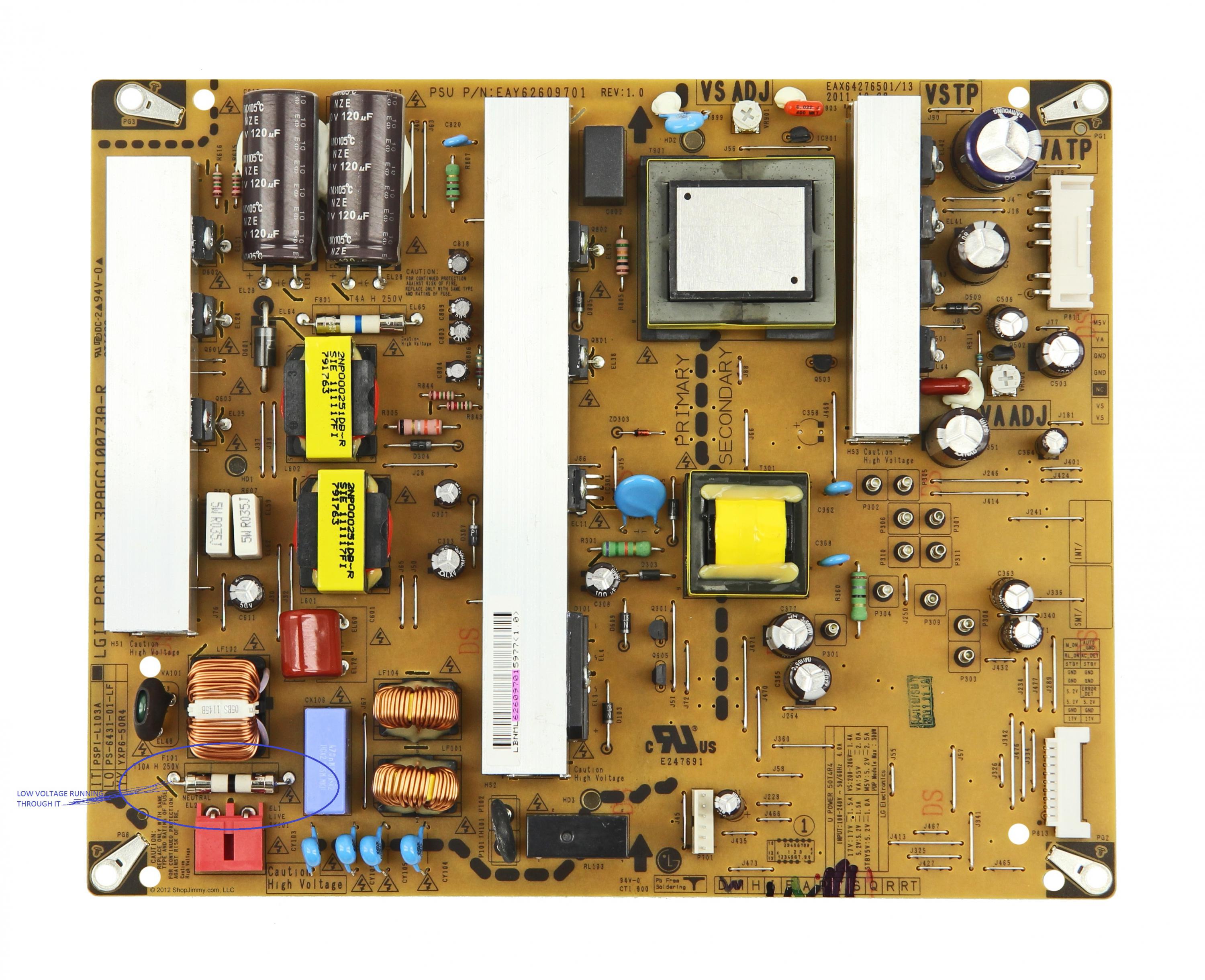

    • Inspected Top PSU FUSE F801 Not Blown, Constant Voltage of 280 (V-500)
    • Inspected the Lower PSU Fuse F101 Not Blown, but Extermely low Voltage of 0.03 jumping to 0.13 with the Multimeter Set at (V-20)
    Tools i have avalible are a Decent desolder/solder station and a Multi-meter
    With the last Two Items on the list, Im thinking that the Bottom Fuse F101 Near the AC Plug, is fine but something that its connecting to is playing up but im unsure what.
    EAX64276501 is the PSU thats in this system
    Anyone have a suggestion of what i could test to see whats giving me low voltage to the F101 Fuse

    [*]VA and VS both spot on with readings, VA-55 VS-205
    Then the power supply is working and the fuse has not blown otherwise there would be no voltage for the z and y sus boards
    Dont forget the voltage on the fuse is 240 AC

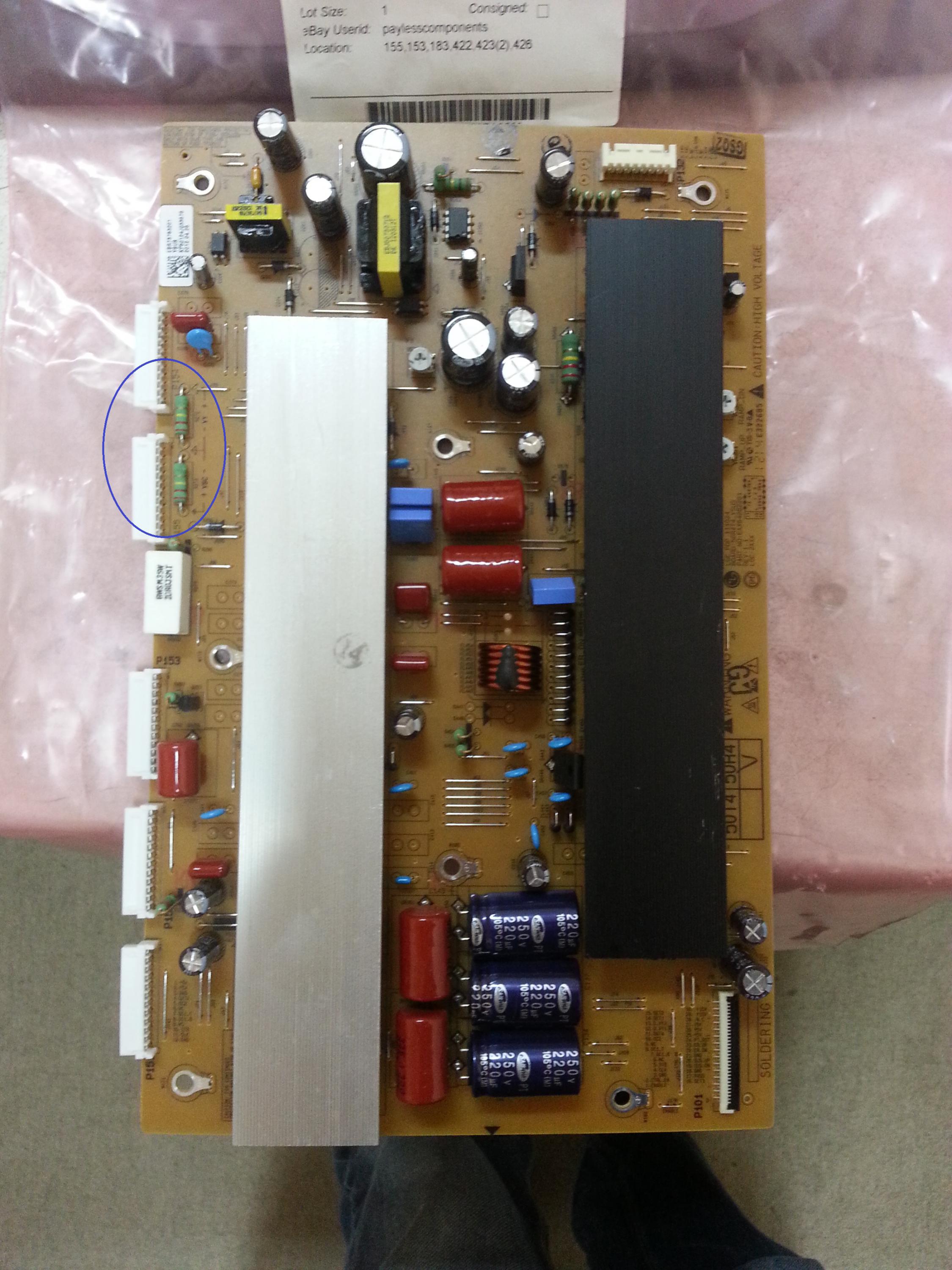

      Check the Vsc and -Vy voltages on the Y-sustain board....
      I hope it's not another bad LG plasma panel killing the buffer board.

        Re: LG50PA6500 No Display, Suspected PSU
        I have found VSC and -VY Resistors on the ysus, is that what you are refering to?
        Am i able to measure it with my Multimeter?
        I own the following one
          Yes, measure across them on the 200V DC range.
            "VSC" Is giving me a constant Variable Reading of between 03.3 to 00.0
            "-VY" Is Giving me a Reading that is constantly switching With Value similar to the following 14.x - 22.x - 34.x(Highest seen)

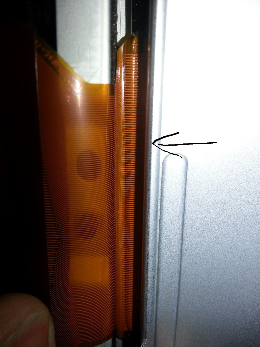

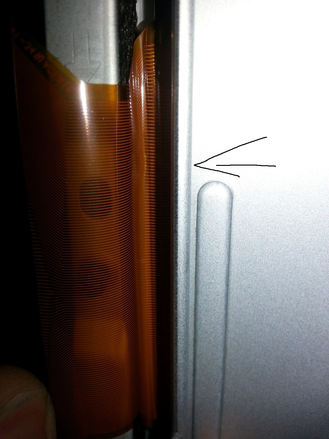

                    Your panel is bad. 99% guarantee it. Sorry.
                    The tear is VERY hard to see. You have to take the TV frame off to be sure.
                    Same TV, UK spec model (50PA650T) ended up scrapping it due to bad panel.
                    That tiny dimple on the right of the ribbon? That's where they tear. That seems to kill the top buffer boards.
                      Upon a Closer inspection, i think i have found a Crease on the ribbon cable nearest to the top of the Plasma, it looks to almost be at a right angle compared to the rest of the smooth flowing cable
                      I take it them its not worth procedding with trying to fix this unit, replacing the upper buffer would just result in the new one being shorted out by the Panel (wasting $70+)
                      Thanks alot for you time & Input Helping me with this Tom!
