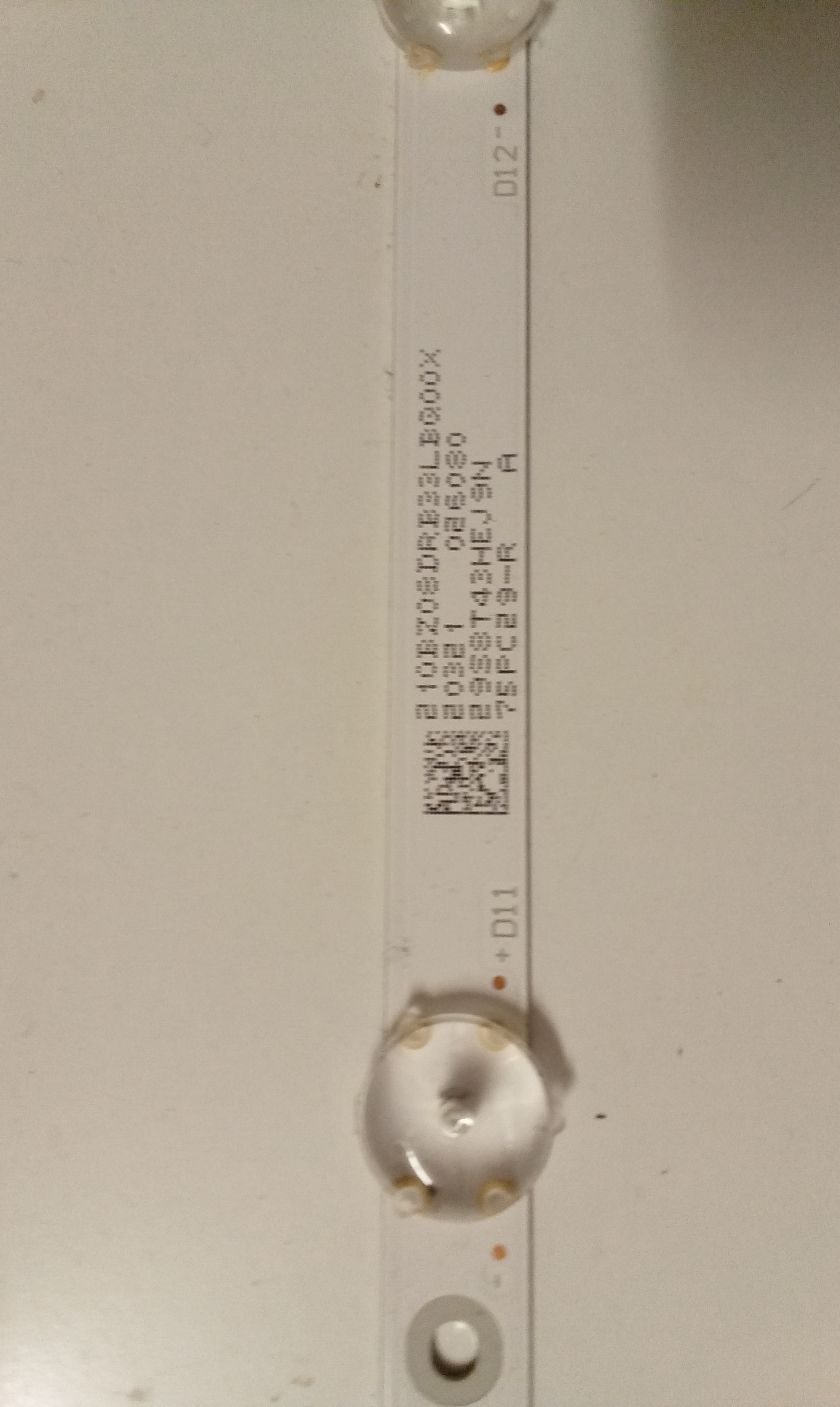

PHILIPS 75PUS7805/12 BLACK SCREEN
  • bohaboha
    • Nov 2012
    • 1019
    • sweden

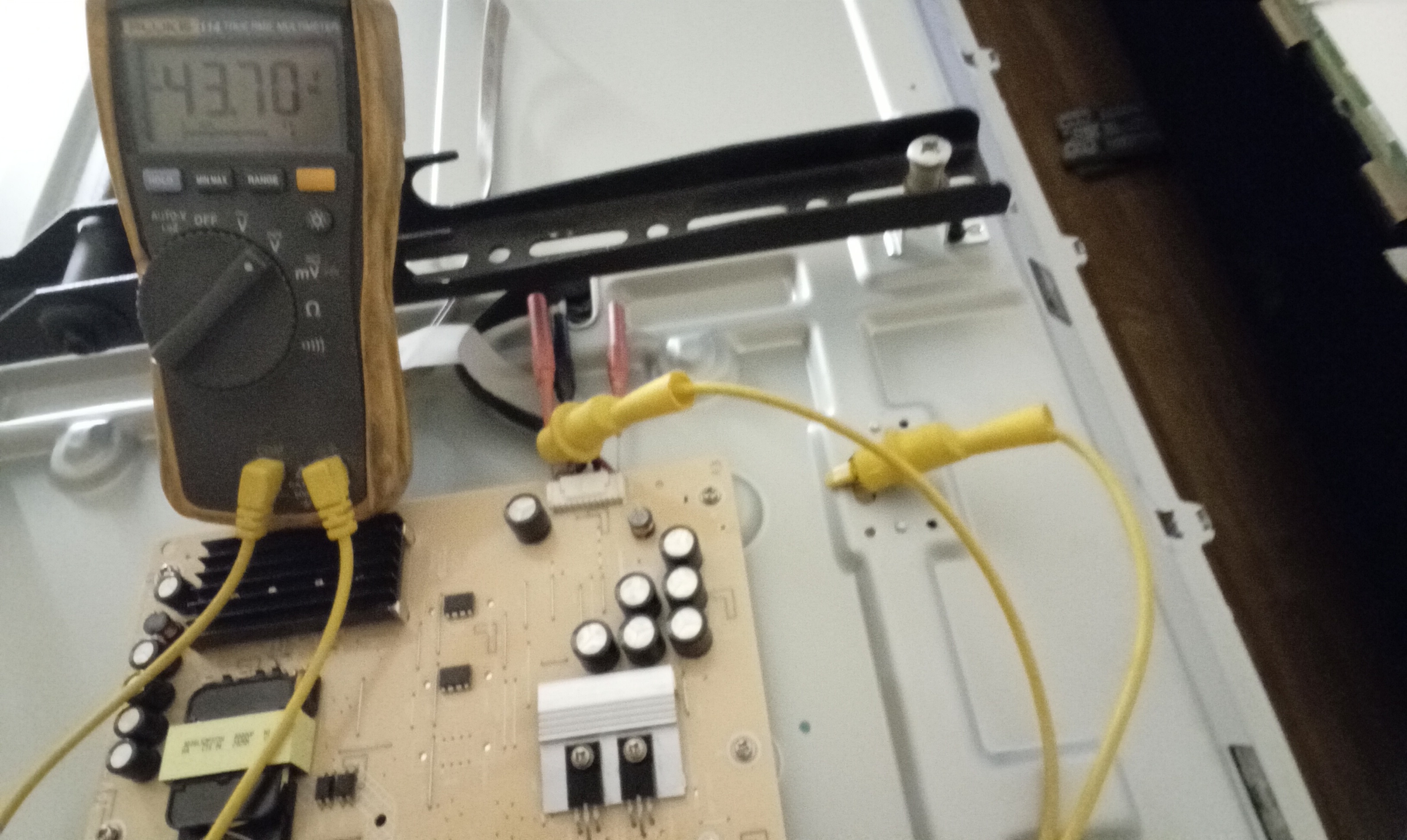

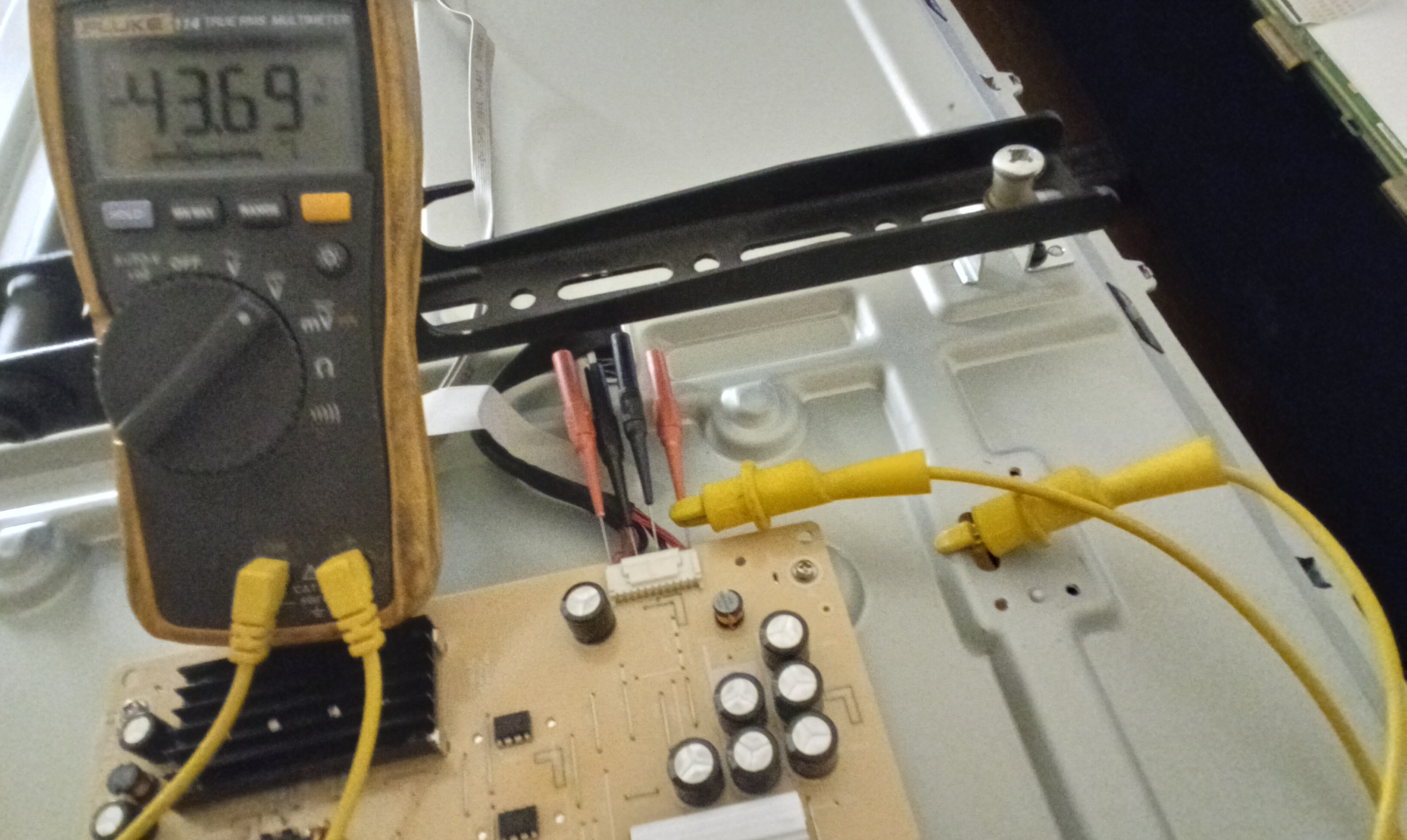

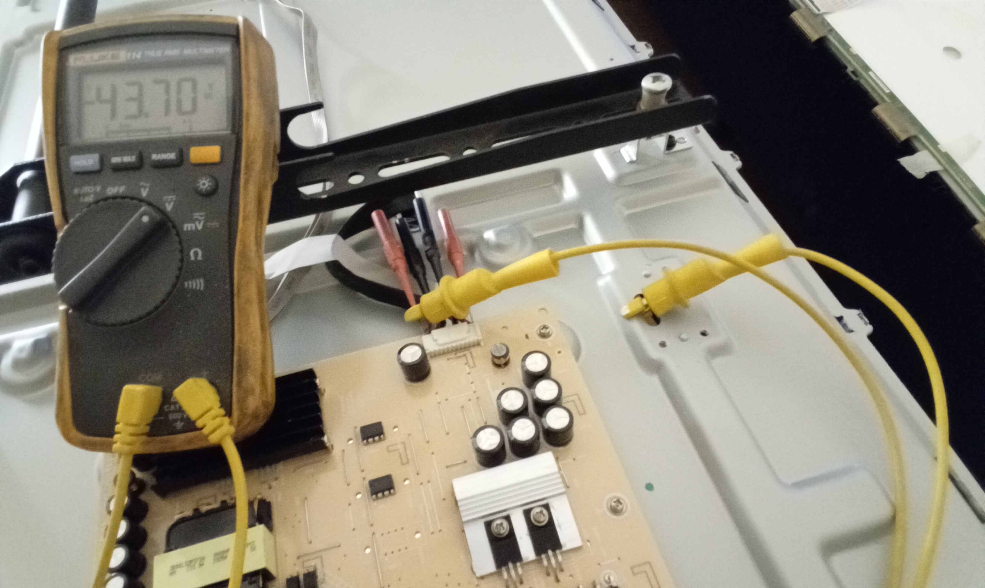

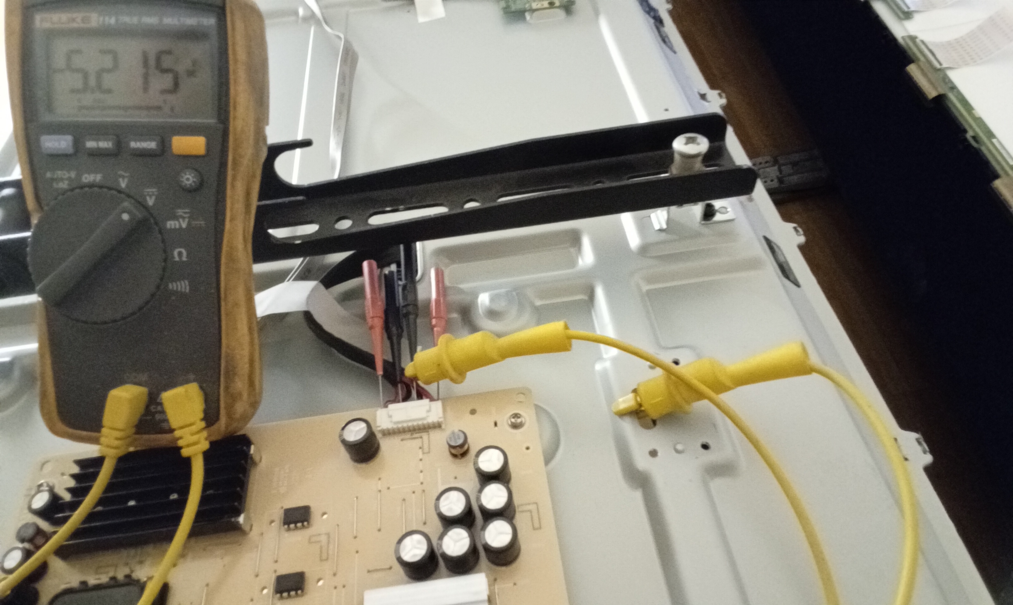

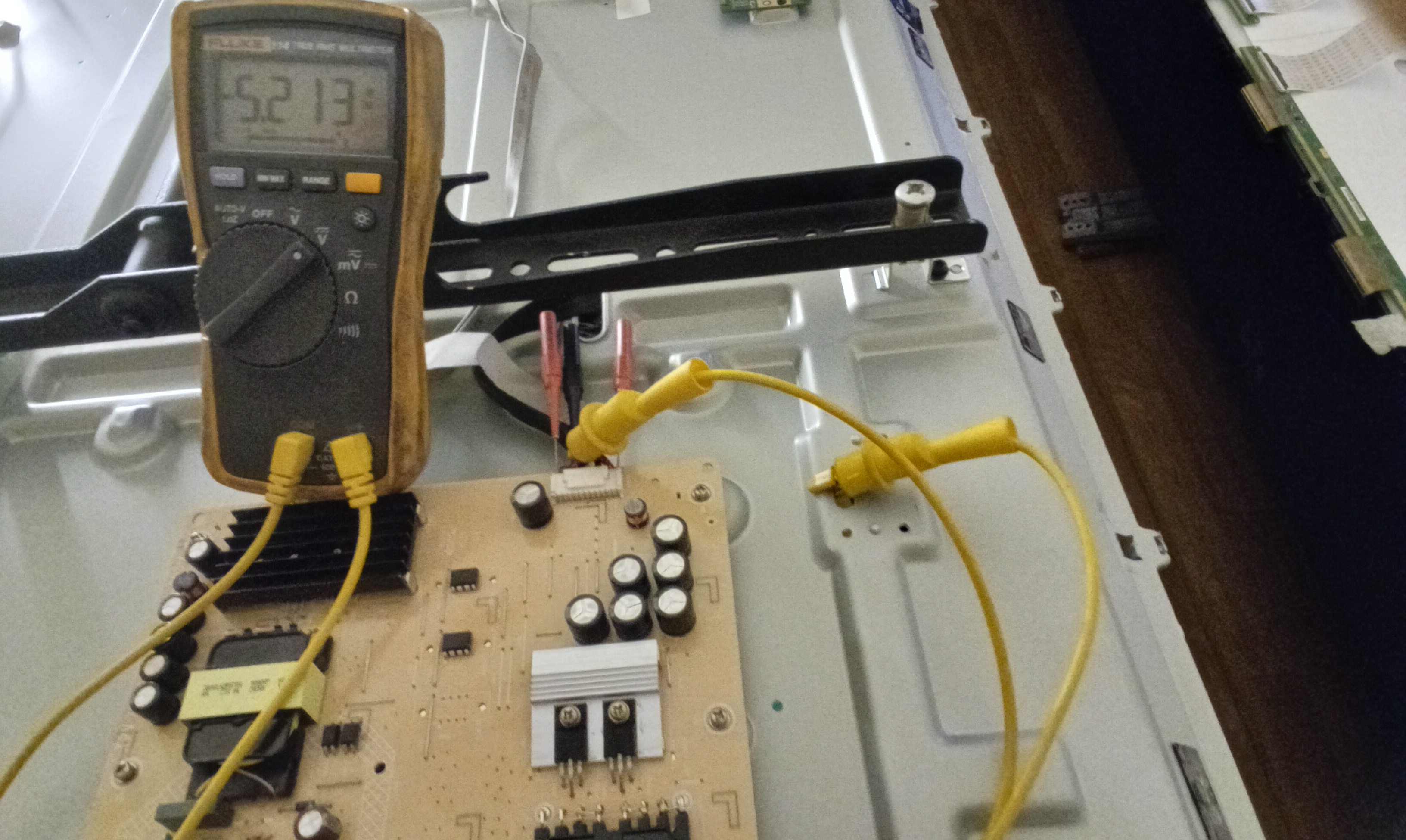

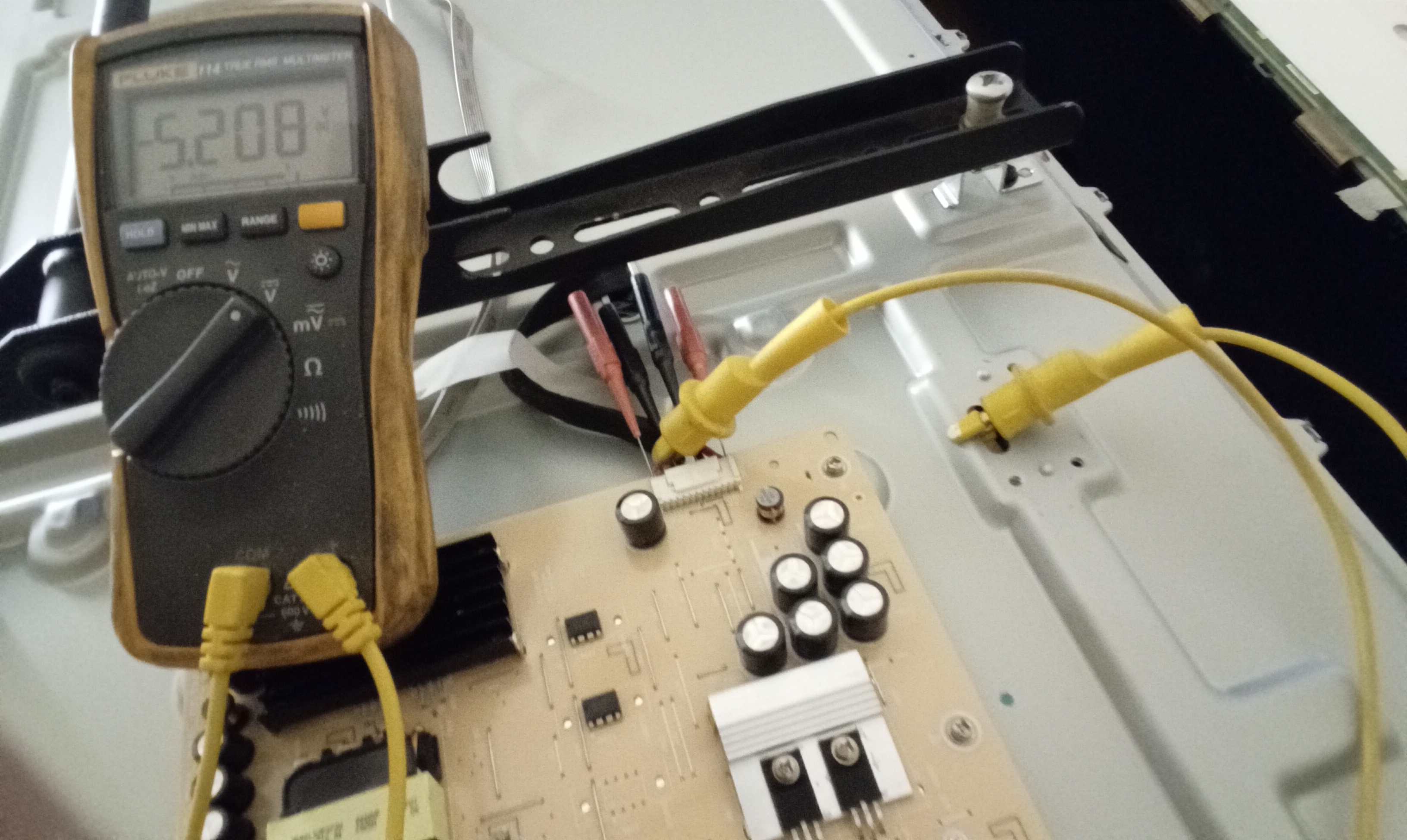

    Originally posted by bohaboha

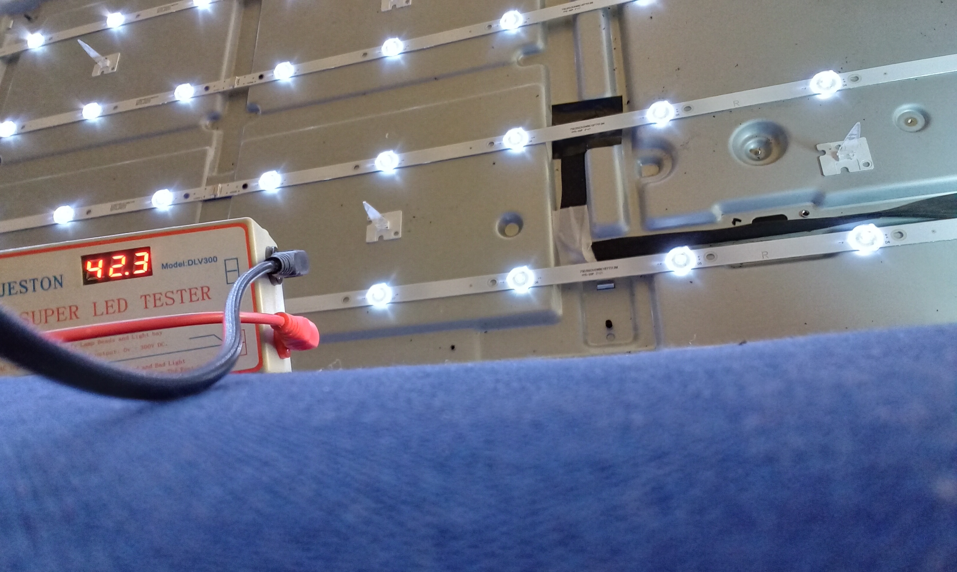

    Hi lotas and thank you so my test procedure was wrong then how should i test it black probe to C8622NC and the red probe to VLED+ if I have understood correctly?

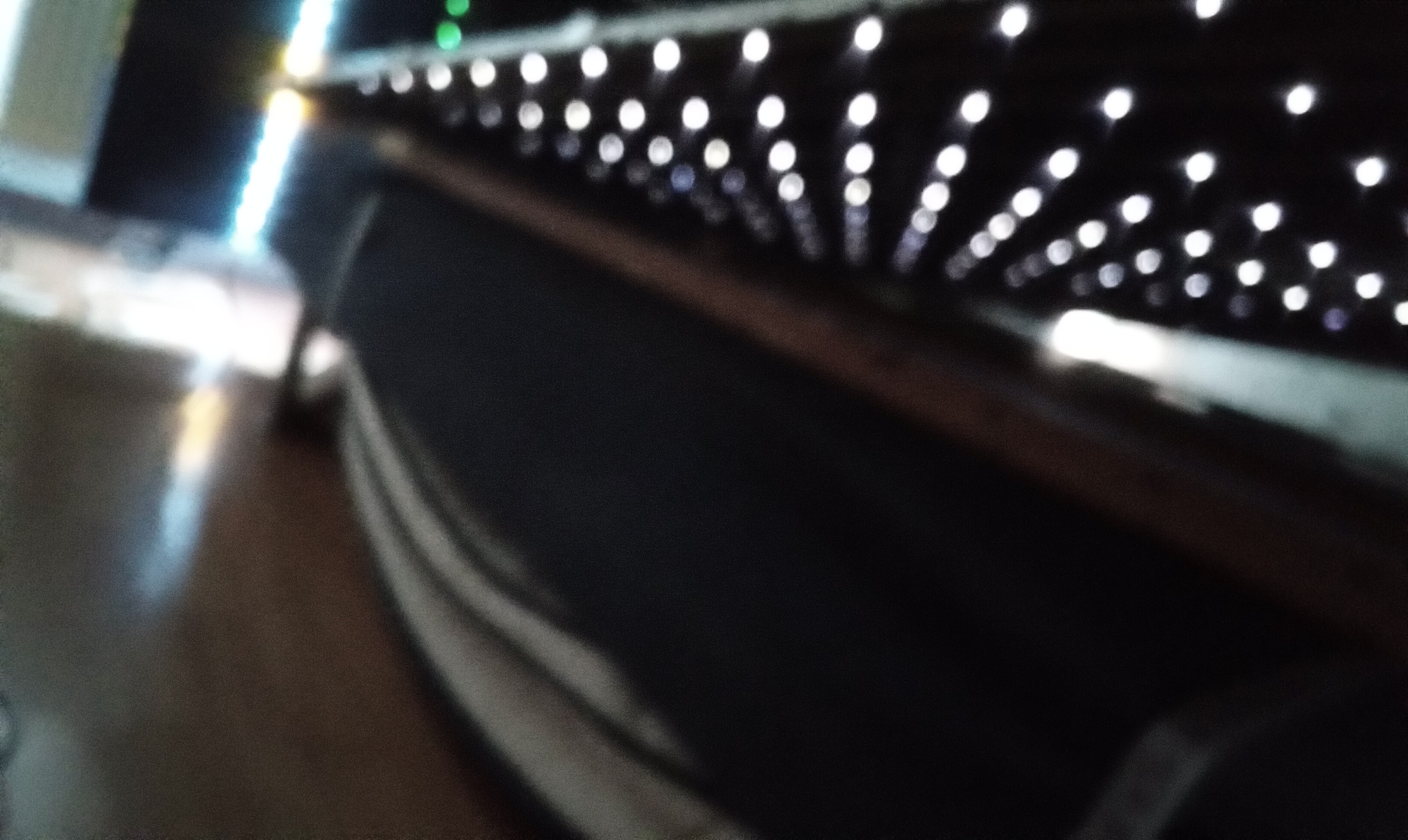

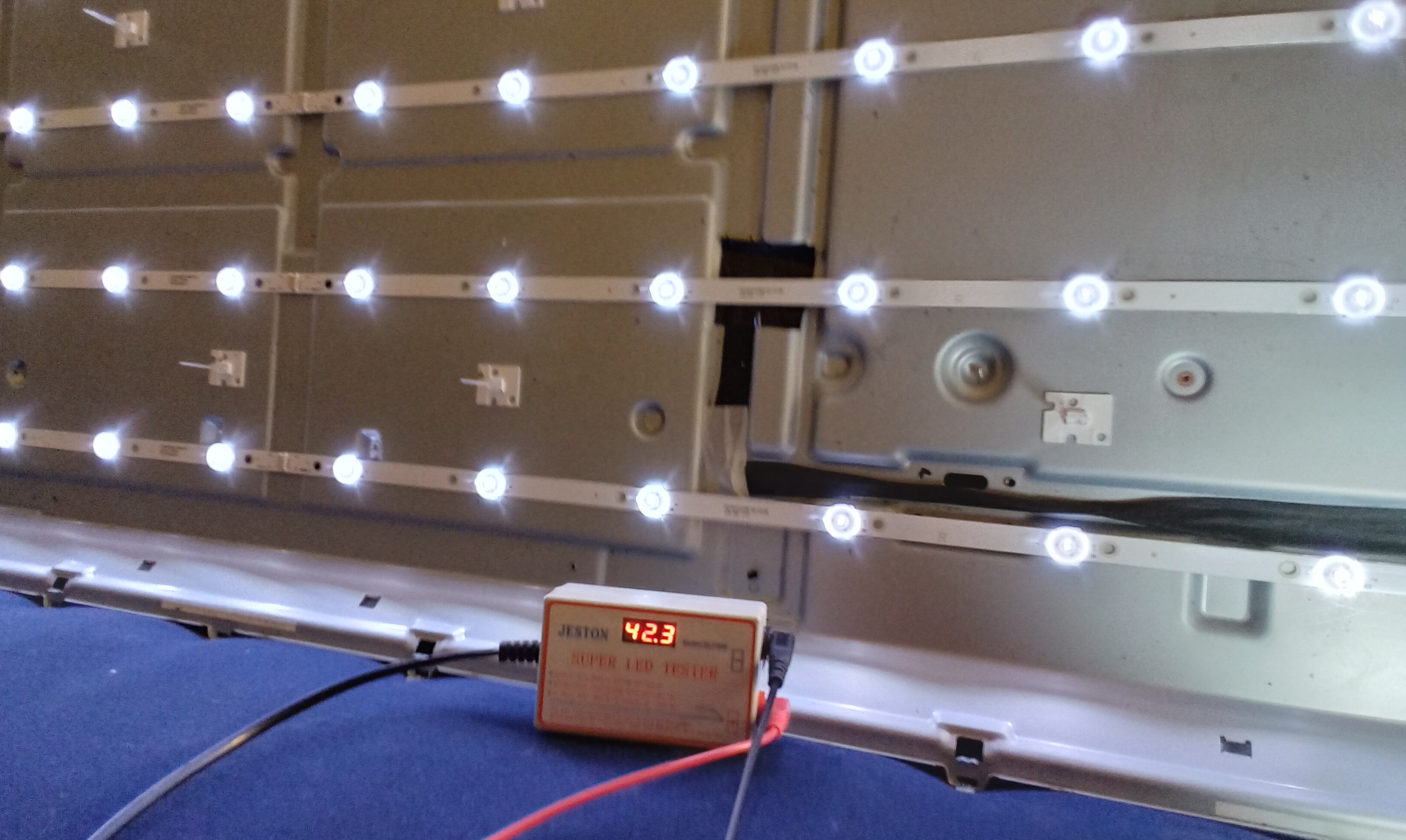

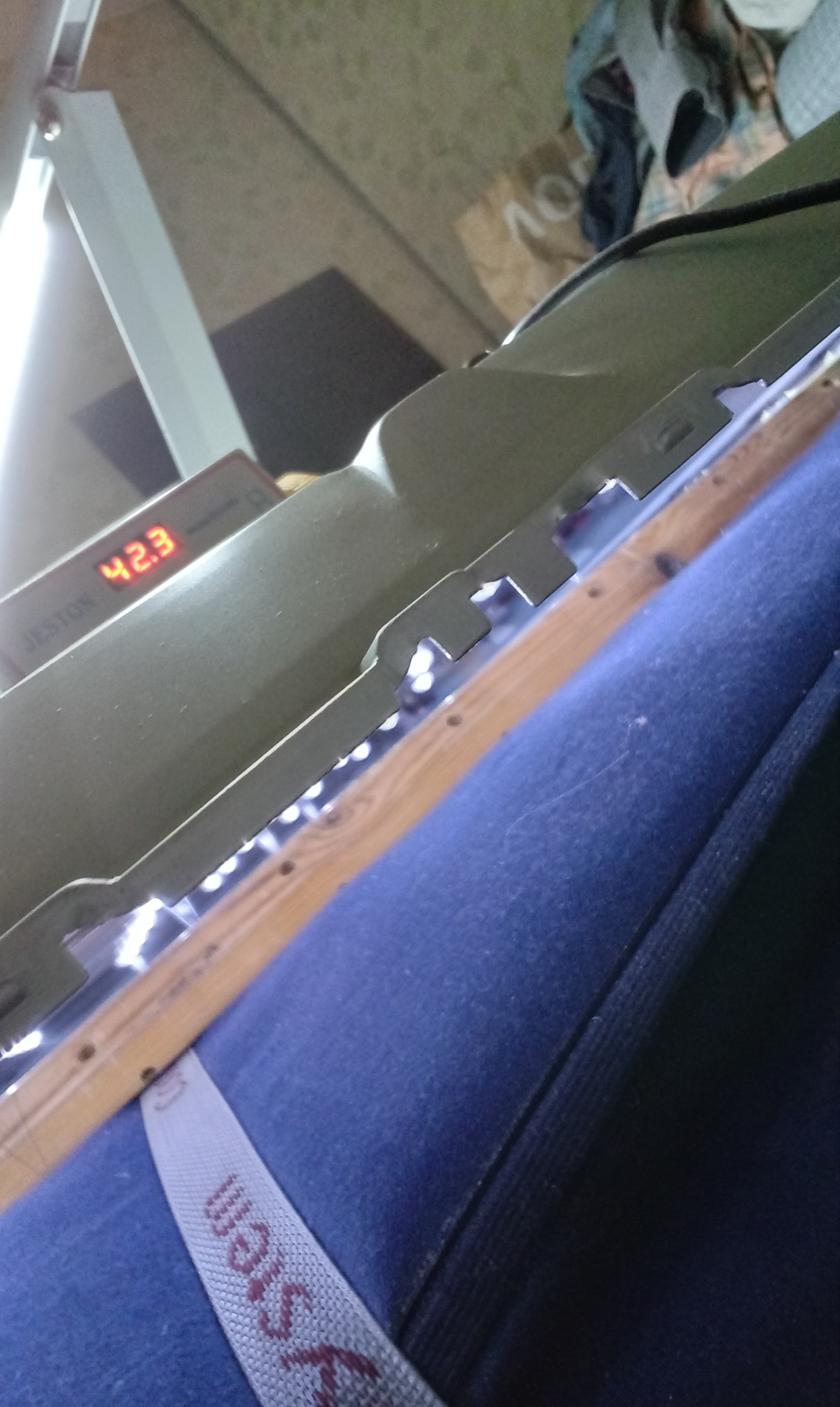

    Hello everyone after a difficult time of illness now I am ready and count on your support. Now I have got the new backlight for this huge TV that is on the bed as you can see.

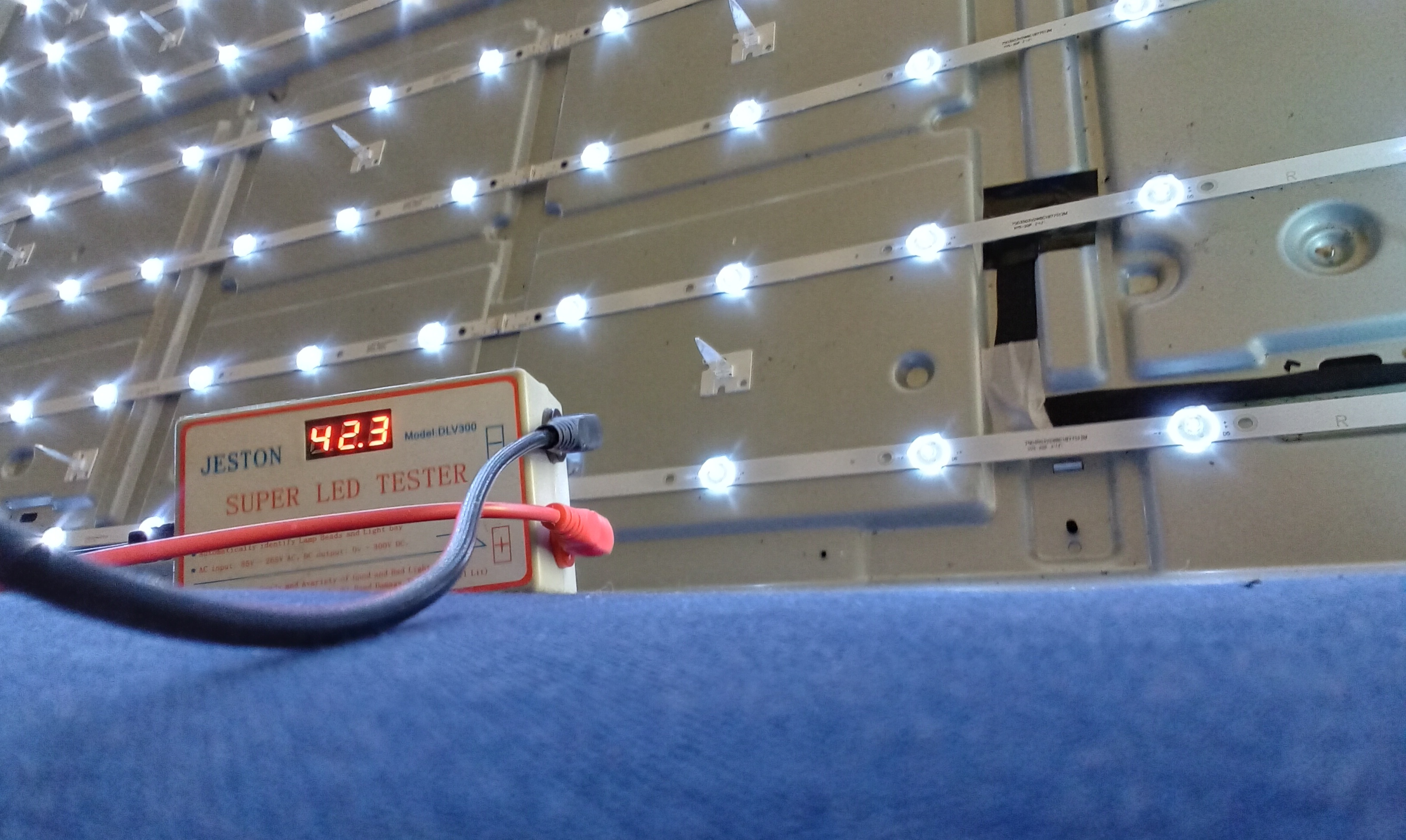

    Is it normal that it should read 42.3V with all the lights on this is when I test with backlight tests regardless of whether it is two rows that are tested or the whole set.
    but when i connect everything together without putting the tv together and turn on all the lights are on but very low light and of course i don't expect that you would see any picture of the low light intensity.
    I get very doubtful is there anyone who can give an explanation
    Thanks in advance
    • bohaboha
      • Nov 2012
      • 1019
      • sweden
      Originally posted by lotas
      The backlight is never connected to the common ground! Power + is constantly supplied to the backlight connector, and - (negative) is disconnected, adjustable, controlled by the backlight drivers via mosfets. Here is your connection diagram...
      Thanks in advance
      • lotas
        • Jan 2016
        • 4862
        • Russia
        Your backlight is connected in series - parallel (several channels are connected in parallel), connect and connect everything without a panel and supply power and see how the diodes will light up from the standard power supply.
