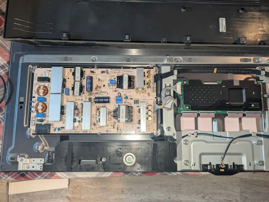

    Hello, my LG OLED55C8PLA TV stopped working, and here's what happened:
    Around noon, it stopped turning on, meaning the screen stayed off, I heard a ticking sound when I tried to power it on, and the red LED light blinked 3 times. Afterward, nothing would happen for about 1 minute, and then the same cycle would repeat. A few days later, there was no more red LED blinking, and whether I tried turning it on with the remote or the power button on the back, it wouldn’t respond. I’ve tried some "quick fixes" I found online, like unplugging the TV and pressing the power button for 30 seconds to discharge any remaining electricity, but nothing worked.
    I would really appreciate your help in first diagnosing what might be causing the issue, and if possible, how I might repair it myself!
    If you have any ideas on what might be wrong, or how I can properly diagnose the device if multiple components could be at fault, that would be great.
    Thank you in advance!

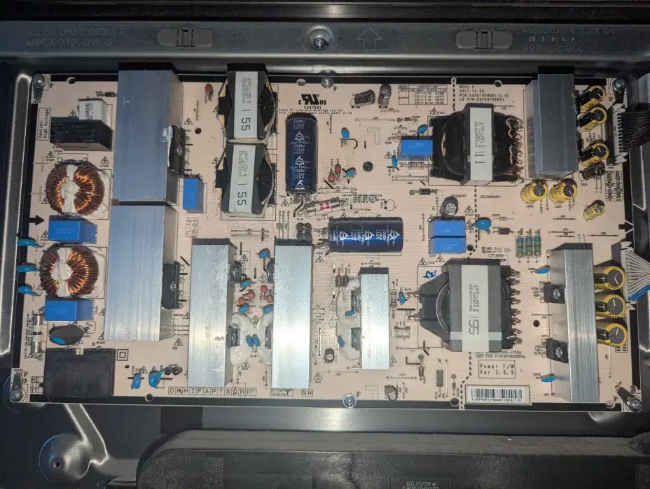

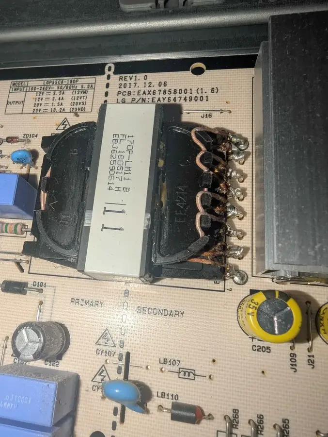

        Great news, I managed to open the TV, and I noticed this: the component looks completely fried, the cables are in bad shape, and there’s some liquid leaking from the component; it doesn’t look good at all. I’m attaching photos of the component in question and the entire power supply board.
        Could this be the only issue? If so, what should I do?
        I tried searching for the specific component but couldn’t find it, and I don’t know how to solder. Plus, could other parts have been damaged along with it? What’s your opinion?
        Alternatively, should I replace the entire power supply board? They’re very expensive on "official" websites, but I found some cheaper ones on AliExpress, though I’m not sure about their reliability. I’d really appreciate your advice. Thank you!

                  Do you think it is a good idea to directly test with a different power board? Some people on another forums telled me that it can be the OLED screen who have defaults and can instantly kill the power board

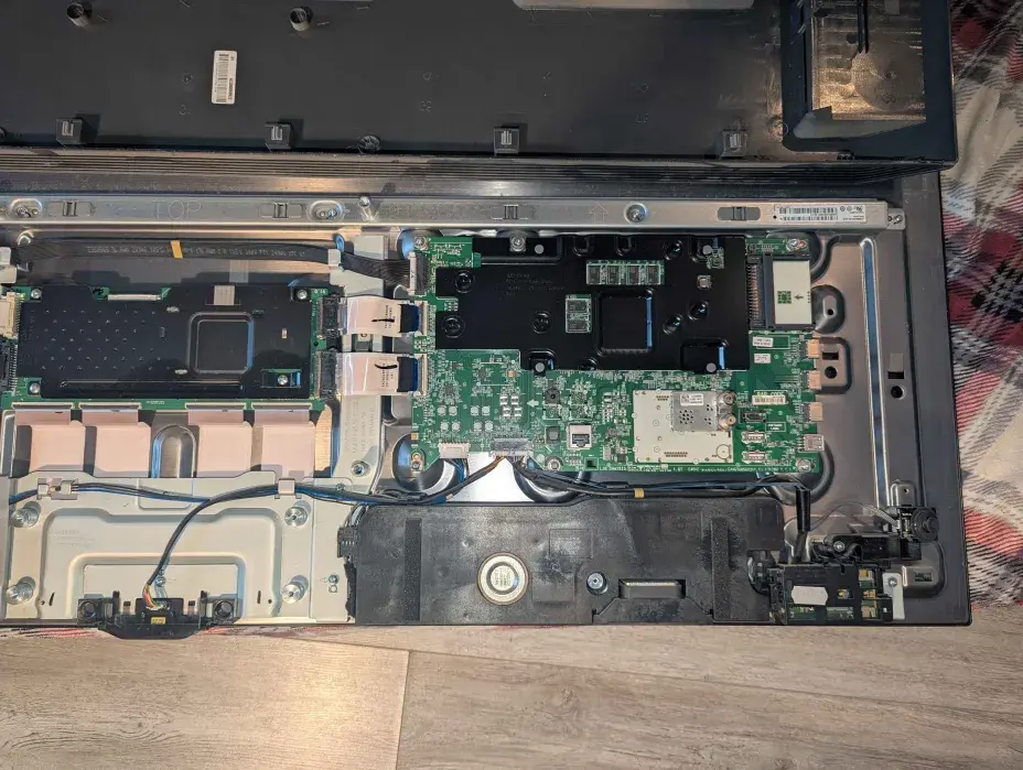

                            • Diah
                              • Feb 2013
                              • 6557
                              Curious Diah, how can you be sure it's OLED shorted?
                              he have 2 LVDS connected between Mainboards and T-CON, if he disconnected only the lower one 51 pins the TV will start and the optic ports will lit red

                                  Sorry I didn't understand, if what you say is true, how can I confirm it with testing (that it is the OLED screen who cause problems)
                                  Because I disconnected cables from power board to the middle circuit board (don't know his name), with only left the black cable between the motherboard and the power board, and I still don't get the red light or any sign of life (if its help)

                                      Post photo on all complete boards to tell you which cable need disconnected in order to confirm the OLED Panel defect

                                        Here a full view of the boards (at least the front side, cause to see the back of the motherboard I need to dismantles all)
