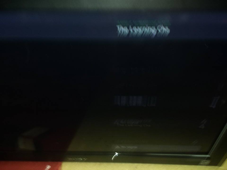

    sony tv image scrolling
    I have a sony tv the image is scrolling across the screen from top to bottom. I suspect that it is the Tcon Board. am i wrong in this assumption ?

    Re: sony tv image scrolling
    Photos my friend you will need to take the back off and snap photos of the insides of your panel! , Also make/model will help too!

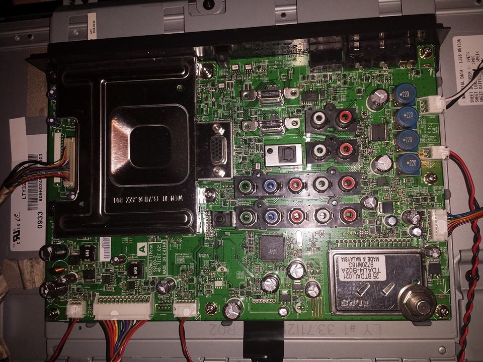

      The Model number KDL-32L504, i will take a image of the backs when i get home, but i didn't see any obvious when i looked. I also replaced the main with another one i have laying around and same issue.

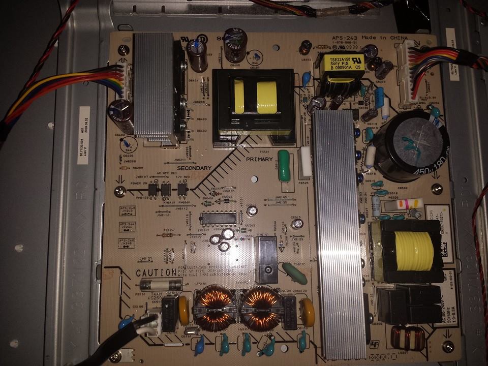

        here is the images of the boards and the screen
          My guess would be bad tab bond or panel failure.
            i thought the same thing bout i couldn't get the panel to react differently by pushing on tabs. i guess i would just put this on hold till last, since i have plenty of other panels to fix.
