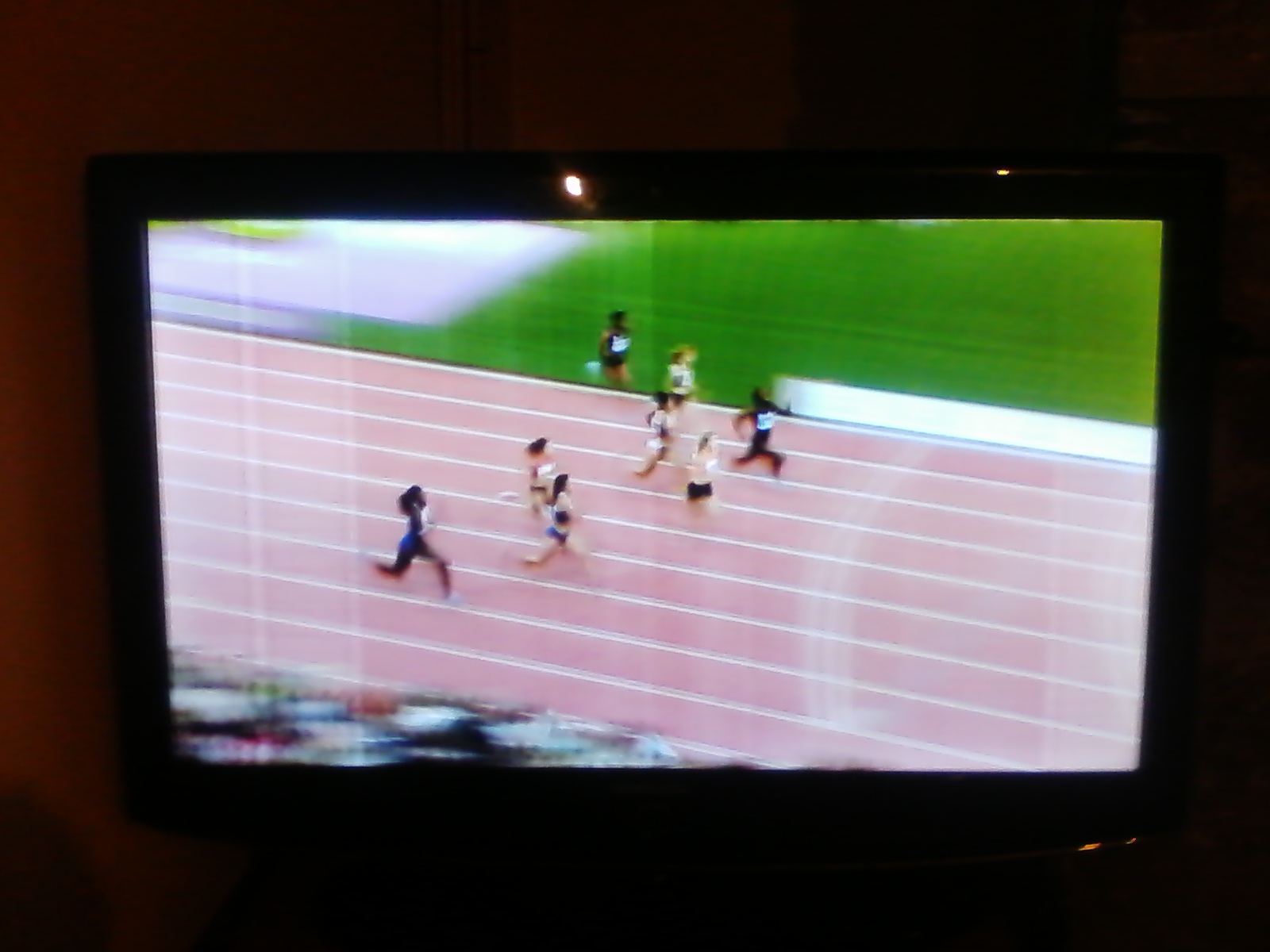

        Changed t-con board, image retention and ghosting gone, but fine vertical lines on display and colour not perfect. Running at present to see if any change. Have double checked tabs to panel and pins to tcon board. Changed caps on PSU cm 860,852 & 870 all bad, all other caps on PSU checked and OK. Wondered if another component may have been affected by caps and tcon faults possibly main board. Attached photo of display at present, showing fine vertical lines.

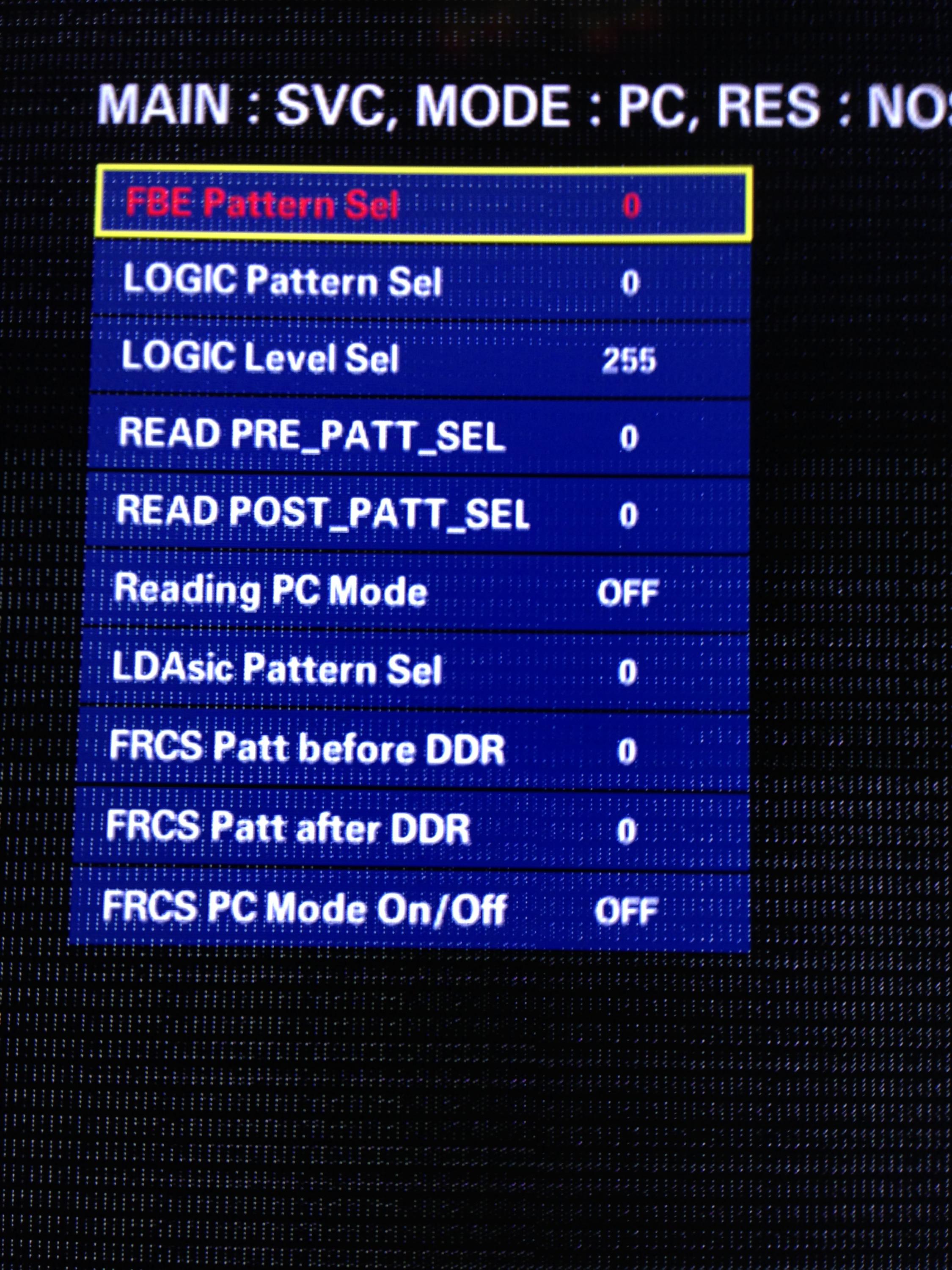

            Re: Samsung LE37R87BD ghosting temporary image retention
            Enter the Service menu and run the test patterns to see if its T-con or Mainboard. Power off the unit, hit Mute 1,8,2 and power on the unit.
            Find the test patterns and run them. If you are unsure take some photos of the menu and someone will help direct you.
            Were the lines there before the replaced t-con?
            • andyturbo
              • Aug 2014
              • 29
              • England
              Thanks for reply, will try test patterns as suggested. Lines were not there before changing tcon board.
              • Shinju
                • Mar 2014
                • 1239
                Cool, the test pattern menu should have 4 or 8 or 10 options depending on your firmware. again if unsure snap a photo and post it.
                for example like this.
                FBE - full t-con/Mainboard processing
                Logic - CPU ( I think)
                READ Post PATT is mainboard only
                READ Pre PATT T-con Only.
                FRCS DDR patterns I am not sure, I could never get them to show up even on a working panel (might be firmware support?)
