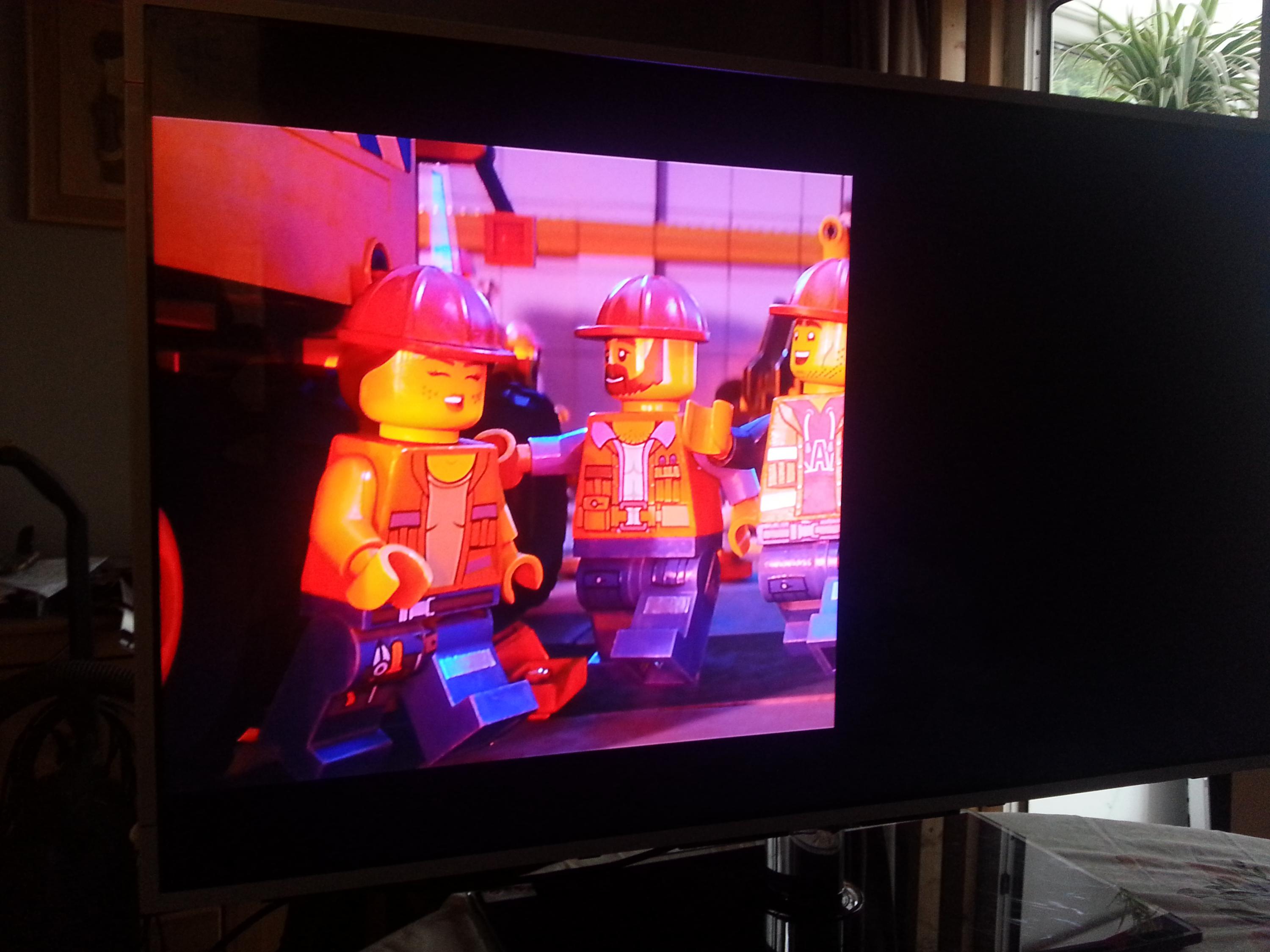

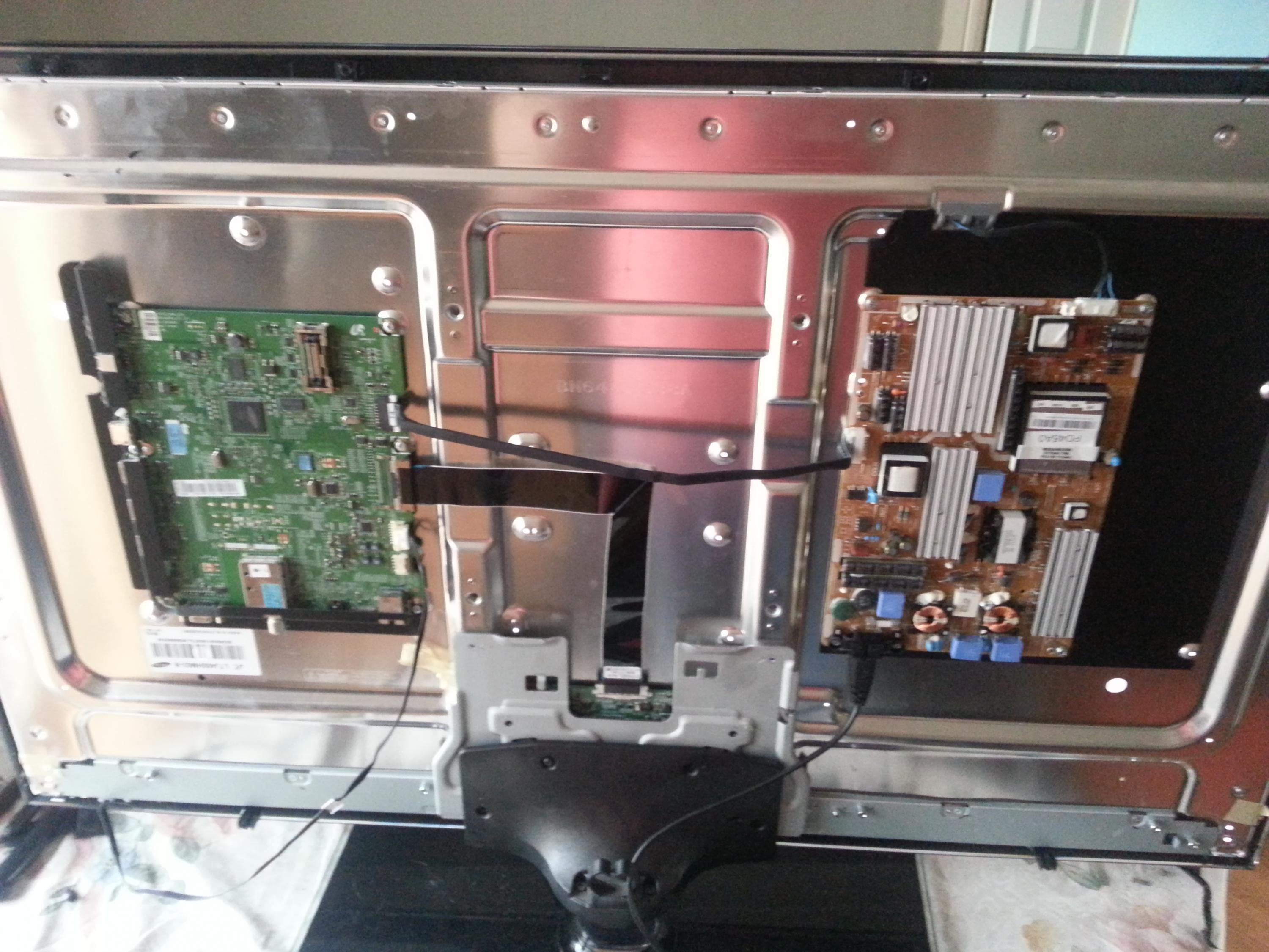

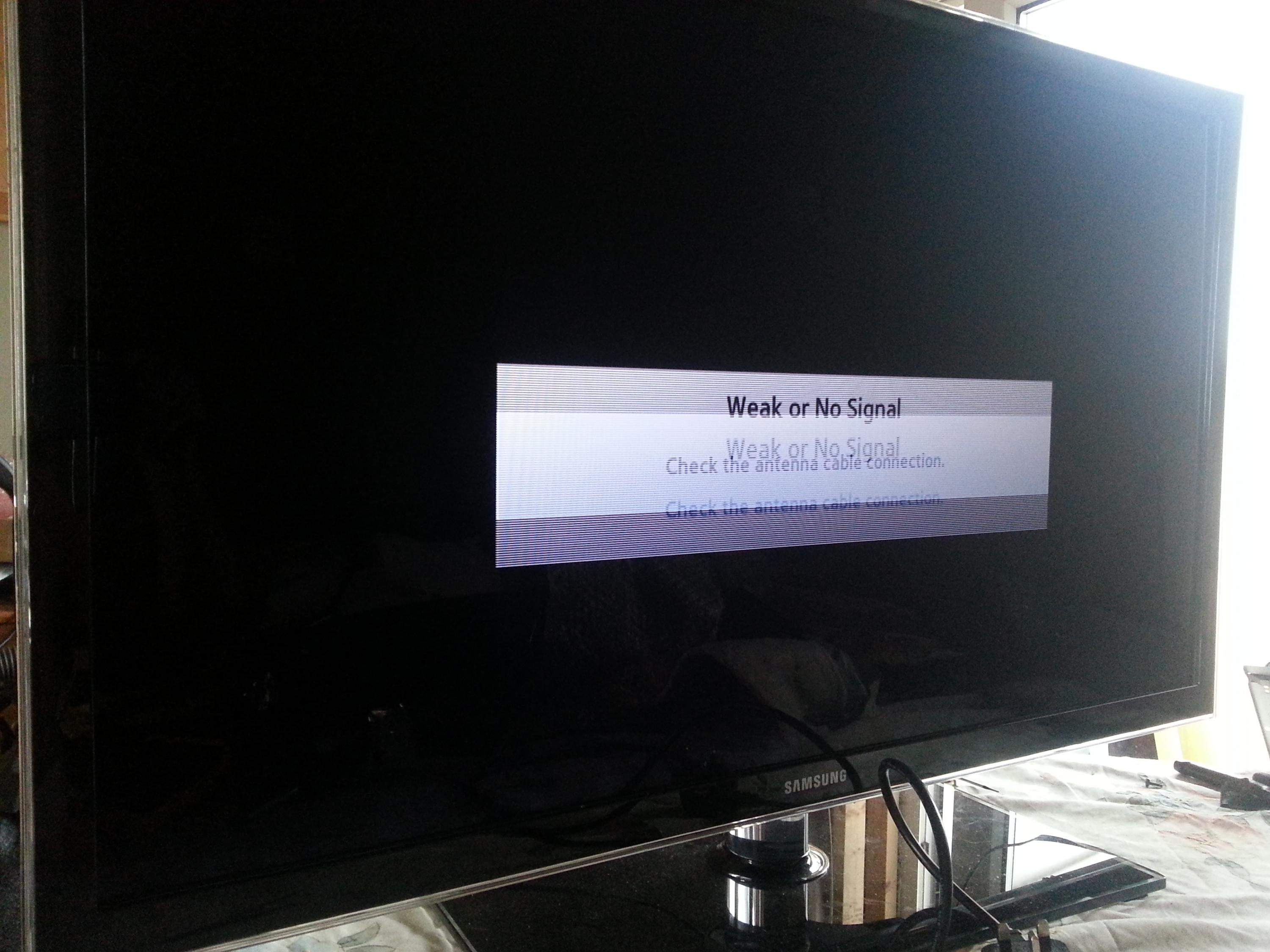

    Anyone know if this is fixable its working just showing a double image as shown I have checked the tab bonds if I take one ribbon out of the t con the image goes fine
    Re: Samsung ue40d500
    Defective LCD panel - generally unrepairable.
    2012 D series Samsung is almost always bad panel. Avoid regardless, will probably die from bad panel a couple months later if it had a different fault.

        Gate tab bond failure.....sry,but panel is toast...

            See now if I take the right tab out of the t con pic goes perfect
              Exactly the symptom expected of a bad panel. As to what on the panel is causing the problem, I do not know.

                I seen something about using a freeze spray in the corners to figue out where its gone ? How much warranty to these tvs have is there a 6 year warranty on a screen?
                  There is no warranty on the screen that is longer than the rest of the TV. (Panasonic used to warranty their plasma panels for 5 years, so you could get one replaced and only pay labour charge out of warranty. Panasonic could afford this because their panel failure rate was sub 1%. Samsung don't do this because they'd be out of business tomorrow!)
                  If you are the original owner and you have a receipt you can try using SoGA (sale of goods act) - this can take a lot of work (weeks & several letters/phonecalls) but it will usually succeed. Note - SoGA applies through the retailer only - not Samsung directly. So if bought from Currys, you have to apply through Currys.
                  You can try using the freeze spray but even if you find a tab failure, it will generally not be fixable. The earlier models usually were fixable, but this has changed with the development of "gate-in-panel" technology, where the panel gate driver is embedded in the LCD glass.
