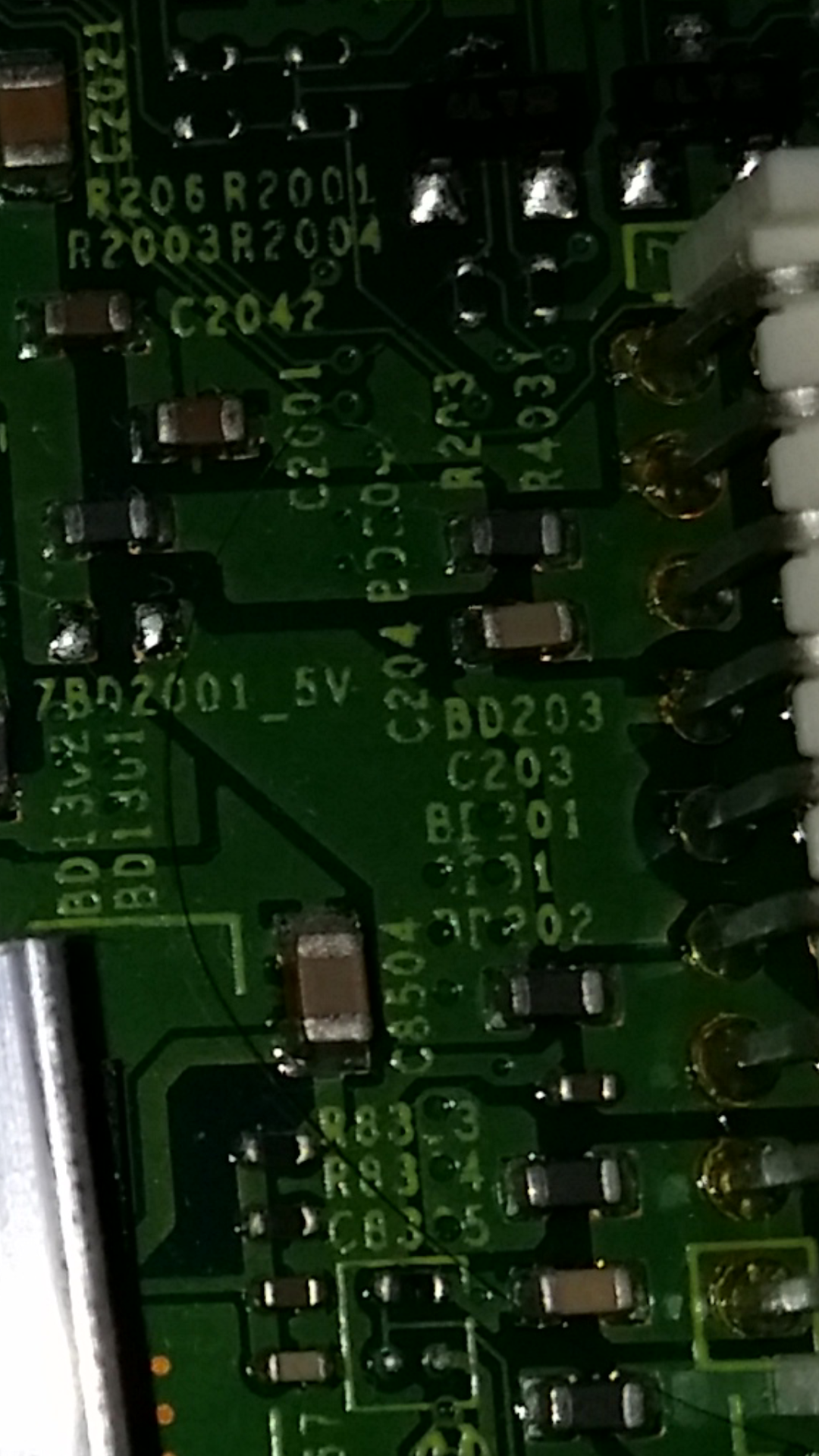

                      • tschneeee
                        • Jul 2014
                        • 30
                        • US
                        Re: Samsung LN32C540 (Blinking Light)
                        Originally posted by Andrew F. Ali
                        Set your DMM on the 20Vdc scale to measure these voltages on the Main Bd. Be careful not to let your red probe tip slip and short cct anything. Black probe attached to metal chassis and red on the BD**** test points. If you found one of them then you would find the rest. These voltage checks are to confirm your fault is in the Main Bd and if any is missing then you would have to get the 'new' Bd or you can just go ahead and acquire the 'new' Bd and slip it in and see what happens. Best wishes.
                        Thank you, but I must have been mistaken when I thought I saw BD209. I can't find any BD 207 or BD209. I used my multimeter and tried testing all the BD_#'s on that section... None of them put more then .3 V or so.
                        Here is a detailed picture of my mainboard. This is on the very top right of the board.

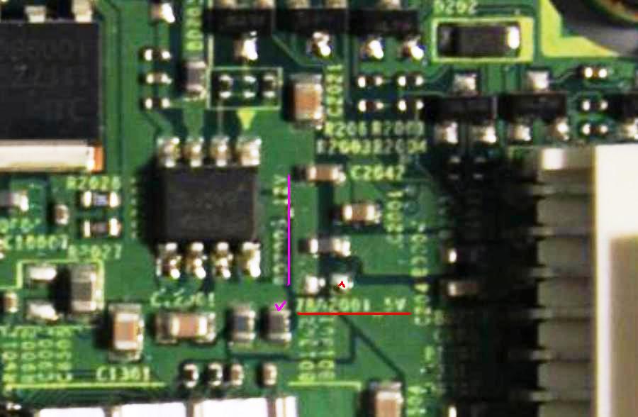

                                • selldoor
                                  Slow Learner
                                  • Dec 2010
                                  • 7870
                                  OK Pics still are not great - not enough light probably.
                                  Anyway I cant see anything obviously burnt and there appear to be 2 similar test points top right - see pic. Only problem is I am unsure exactly where the points are.
                                  I think they are where I have marked ^ BUT they may not be.
                                  Also what is the part number on that 8 leg component.
                                  You also still need to try and find a service manual for your set
