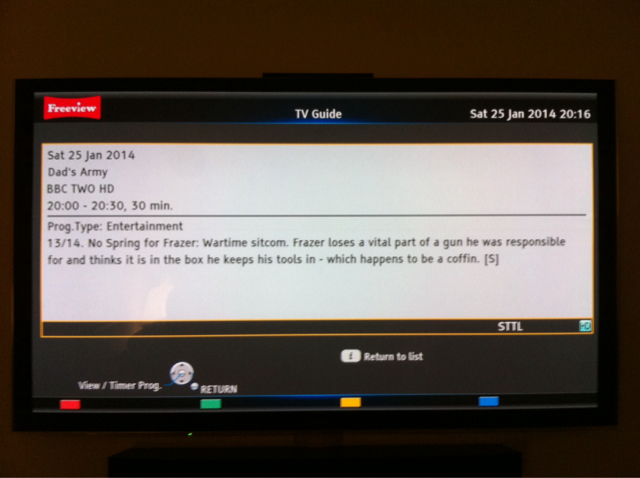

    I am currently having an issue with my Panasonic TX-P55VT65B Plasma TV.
    It currently has 250 hours clocked on it. I have been checking the uniformity of the panel ever since I got this TV and it was fine up until about the 220 hour mark. Using white and grey image slides or even the TVs built in EPG shows the left side of the screen has a cyan tint and the right side has a magenta/pink tint.
    I tried to take a picture of this with my mobile phone camera but the camera on the phone is rubbish and cannot take an accurate image of the problem so I have attached an image of a TV that has the same problem that I found on Google image search but the problem isn't as bad as the image yet.
    Could changing VSUS in the service menu from LOW to HIGH cause green and pink blobs to appear? I'm thinking maybe the blobs on my set may have been caused by VSUS set to HIGH in service menu, panel luminance HIGH and running the built-in white scrolling bar overnight as I needed to get rid of some very stubborn image retention which did disappear but at the cost of the tints appearing
    Is there any way to resolve this without opening the TV up and bumping up the VSUS via the pots? Could it be that a charge has been built up in the phosphors causing the tints?
    What would the solution be? Thanks!

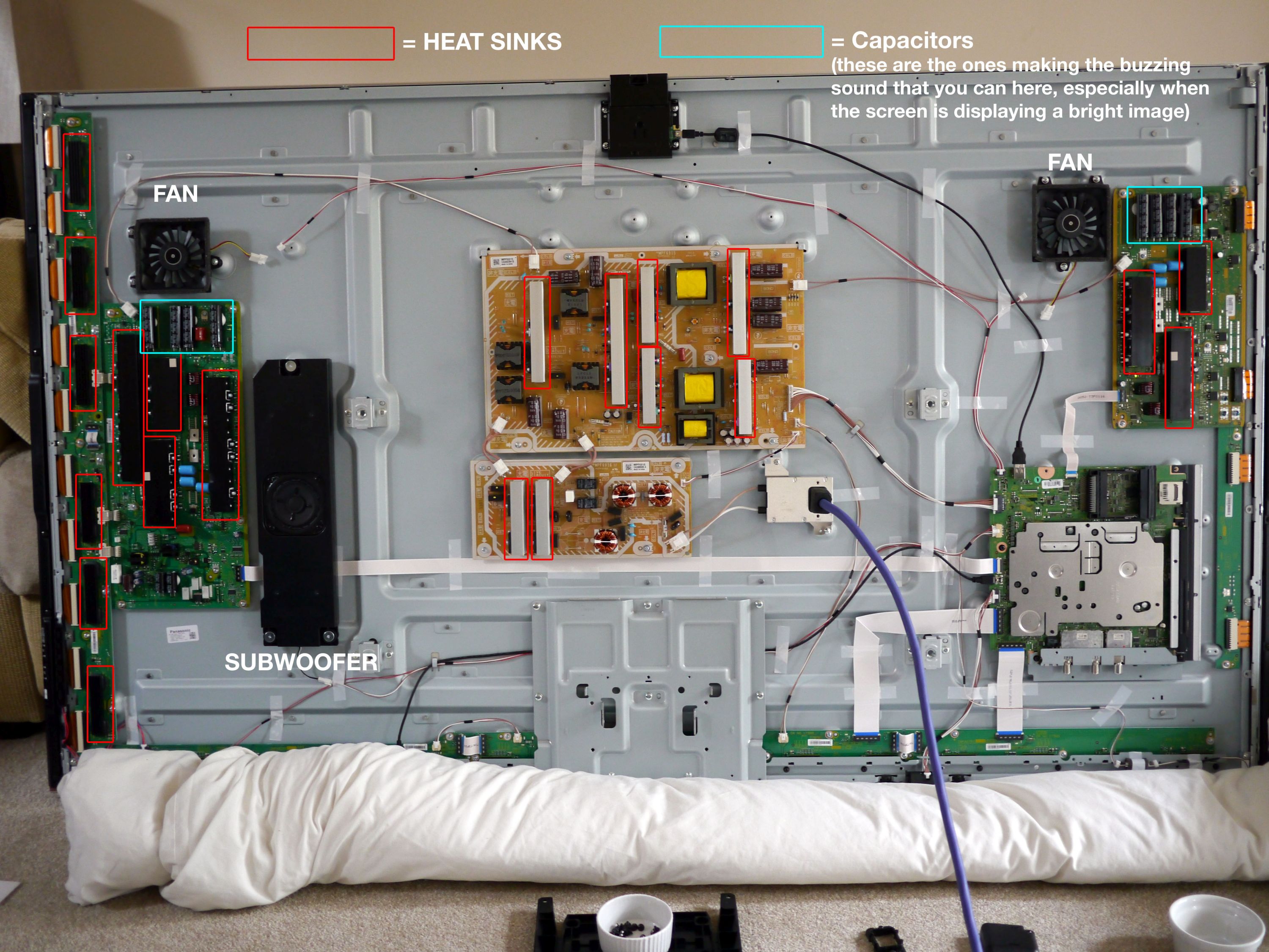

          Re: Panasonic VT60/VT65 Plasma Cyan & Pink Blobs
          Also, which pots need to be adjusted and where are the test points to connect the multimeter?
          I have added an image which isn't of my TV but the same model. It would be great if you could point out where on the image the pots and test points are so that I can be 100% sure.
          Thanks.

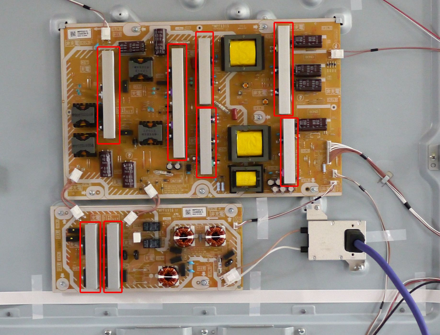

            The pots are on the power supply. I believe they are marked VSUS_L and VSUS_R. Looking at your PSU though I am not sure if your set has two VSUS supplies. Therefore the issue might be different.

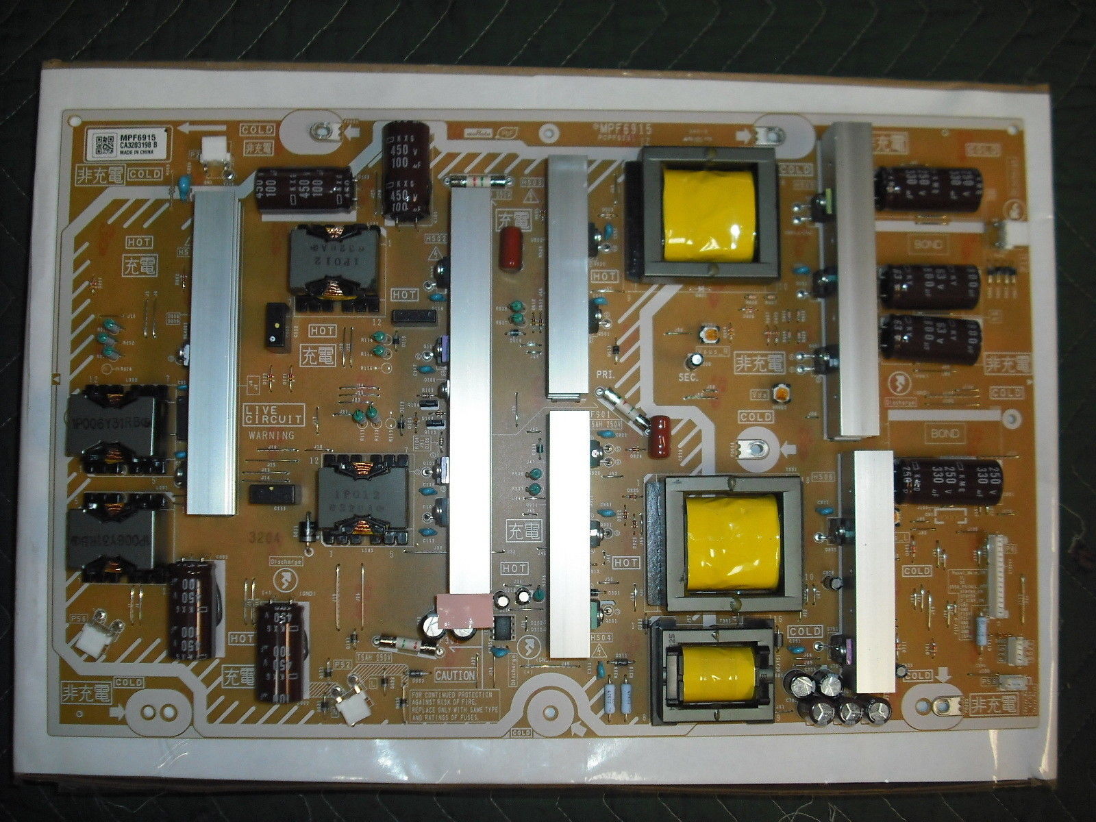

              I have found a clearer picture of the power supply board. It says VSUS_R for one of the orange pots. Would that mean there is a VSUS_L somewhere else? The other orange pot seems to say VDA.
              Would the issue still be fixable with these pots?
              Thanks.
                V_Sus L is in the bottom right of the picture. Mostly hidden in the picture by the heat sink.

                  Now, where would I connect my multimeter to test the voltage for each VSUS pot? I suppose I can use the metal chassis as ground?
                    VSUS_L can be tested across the brown/white connector going to the left hand green board (SC board.) VSUS_R can be tested on the right hand board.
                    You will need to set your multimeter to a range higher than 200V (for example 500V, 600V, 1000V.) If it's autoranging DC volts should be fine. A digital meter is necessary. Make sure the red probe is in VOLT/OHM jack and black is in COM. (Whatever you do, do not put it in the A jack!) Measure across the brown and white connector - caution, high voltage! Careful not to slip. Both boards should be around 200~220V and matching. Test on variable picture content - from a black screen to normal TV.
