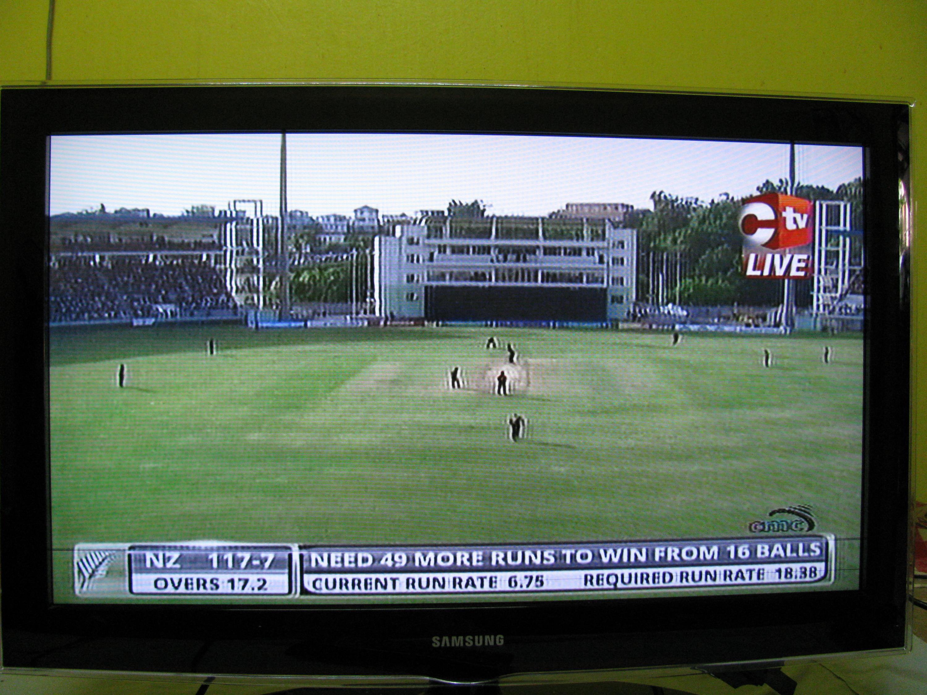

    The screen at initial start up shows good color and picture.

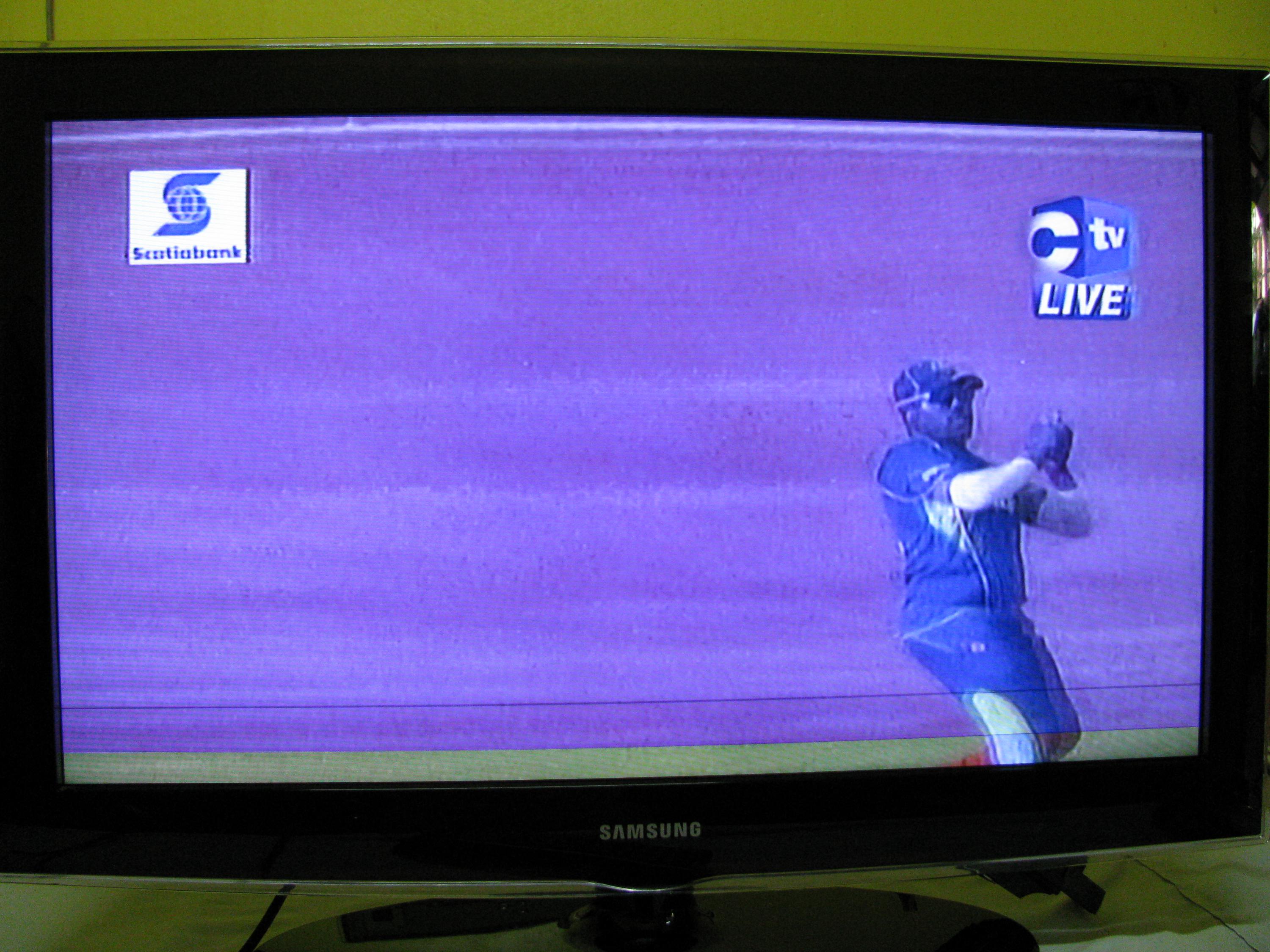

    After a few seconds, there is a horizontal band of 1.5” of the picture showing good colour at the bottom.
    From the top to the band, the colour is showing as if there is no green and the hue (tint) is off.
    Also I noticed a very thin horizontal black line where the good 1.5” band begins.

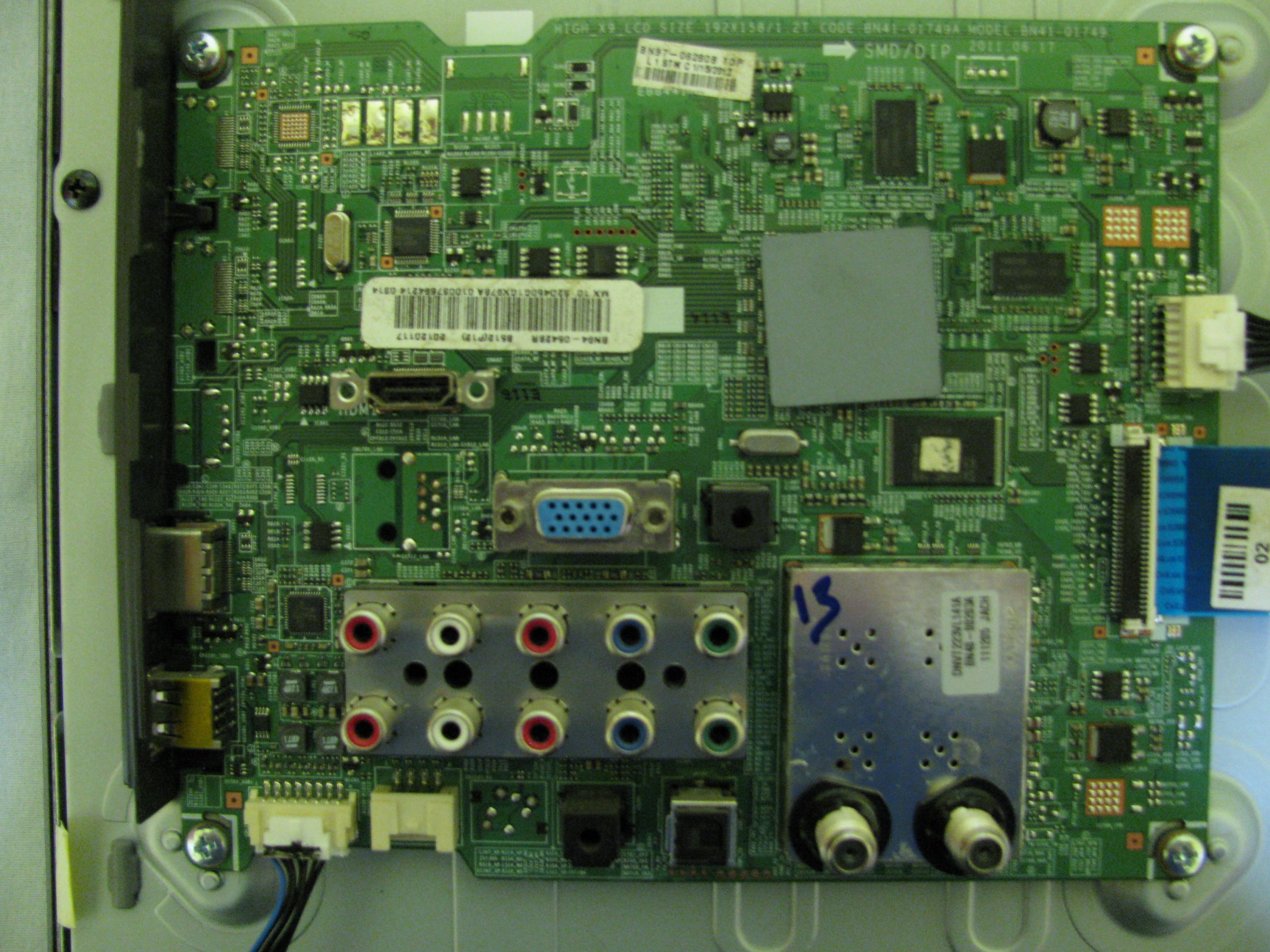

    Reseated the flat ribbon cable from MAIN board to T-CON board and all other connectors.

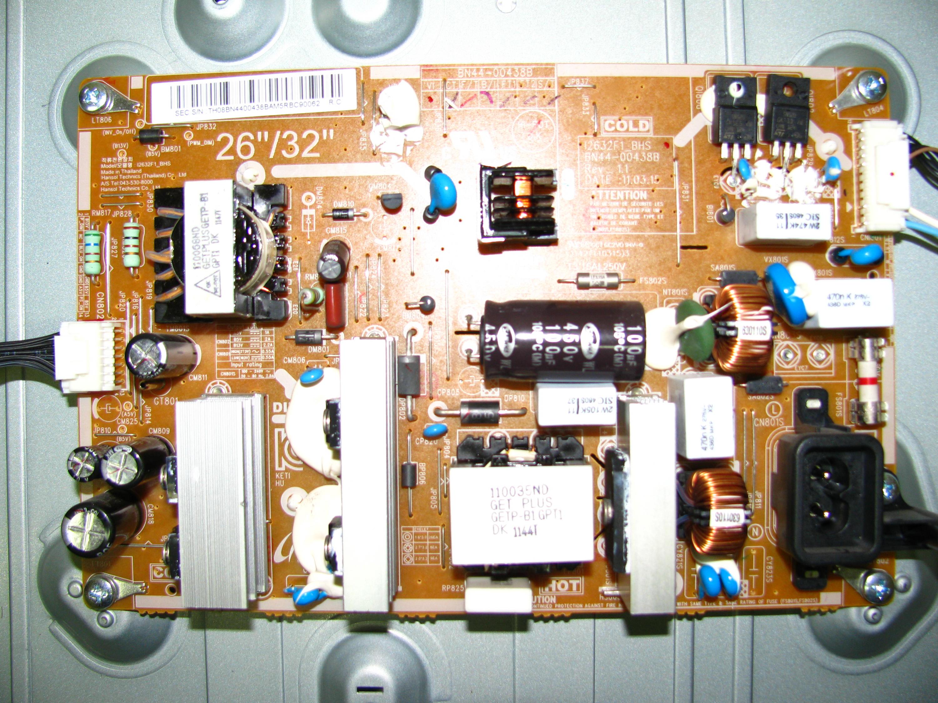

    The POWER and MAIN boards are good.
    The T-CON board is good because the OSD is good and there is 1.5” of good picture at the bottom.

    Re: Samsung LN32D450G1G Picture issue
    Bad panel, IMHO.
