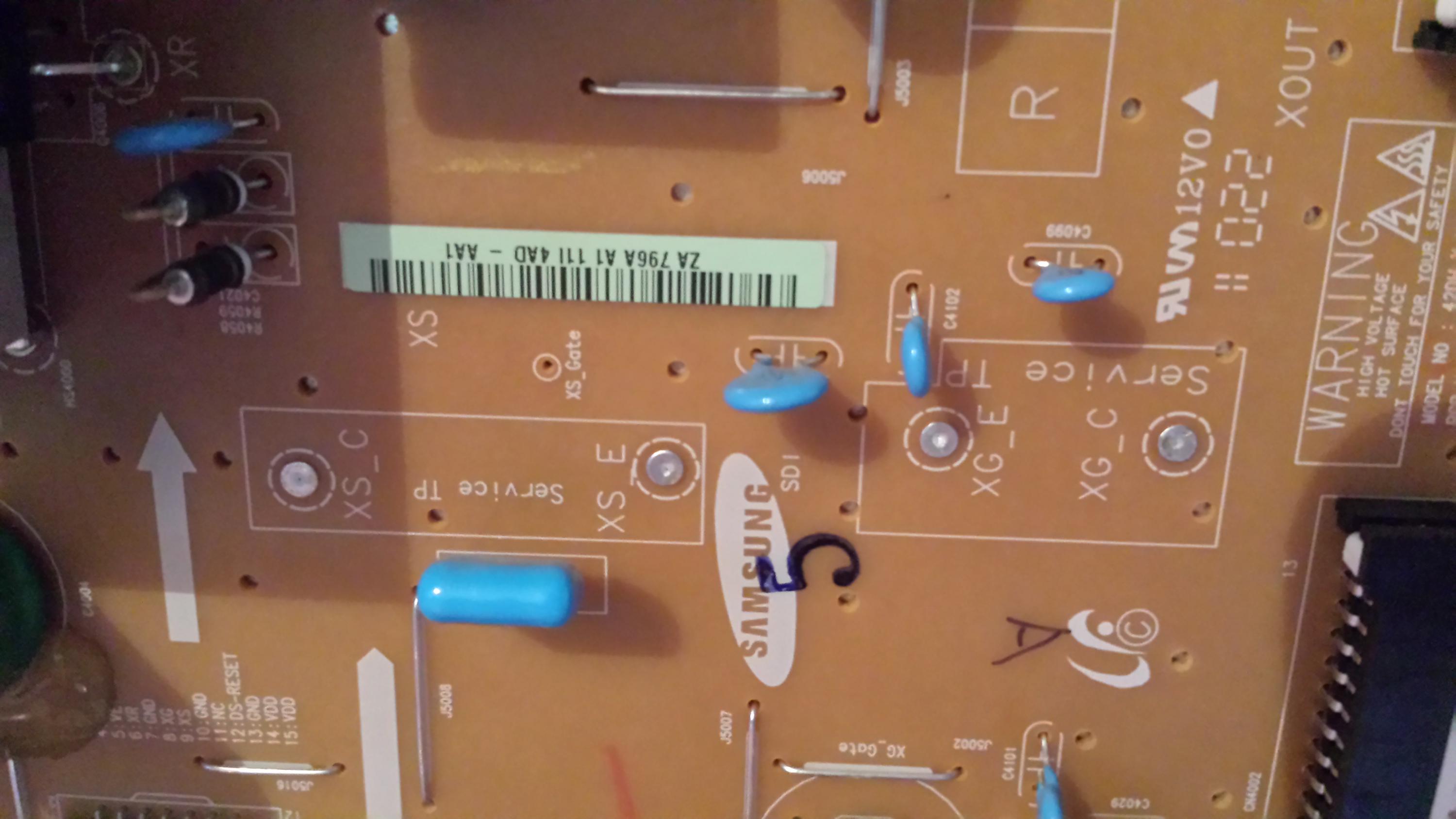

    only Vs and Va on PSU tom.
      Re: Problem with Samsung Plasma PS43D450
      Ve is on X-main.

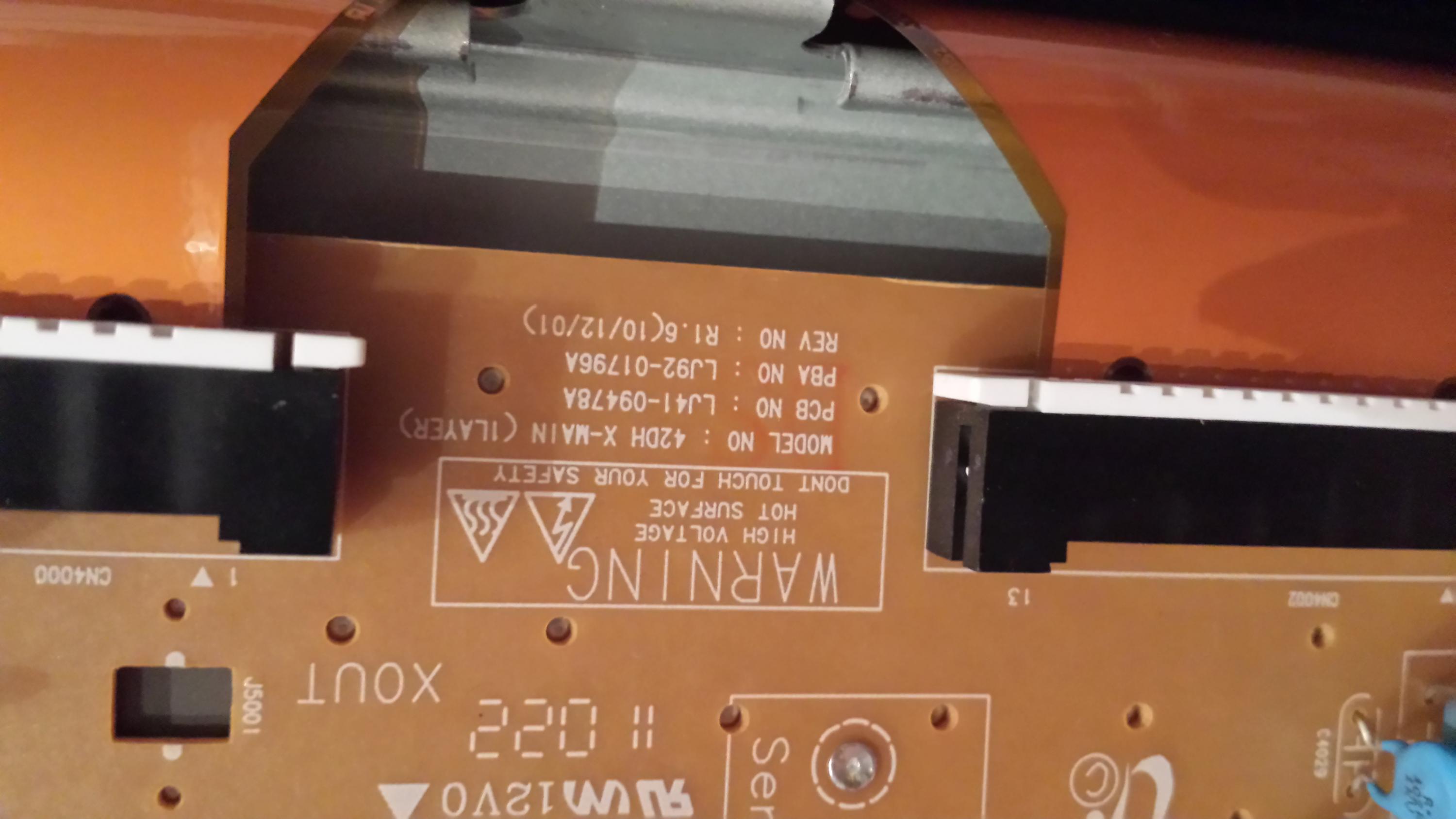

        these are the only ones on the Xmain Tom :

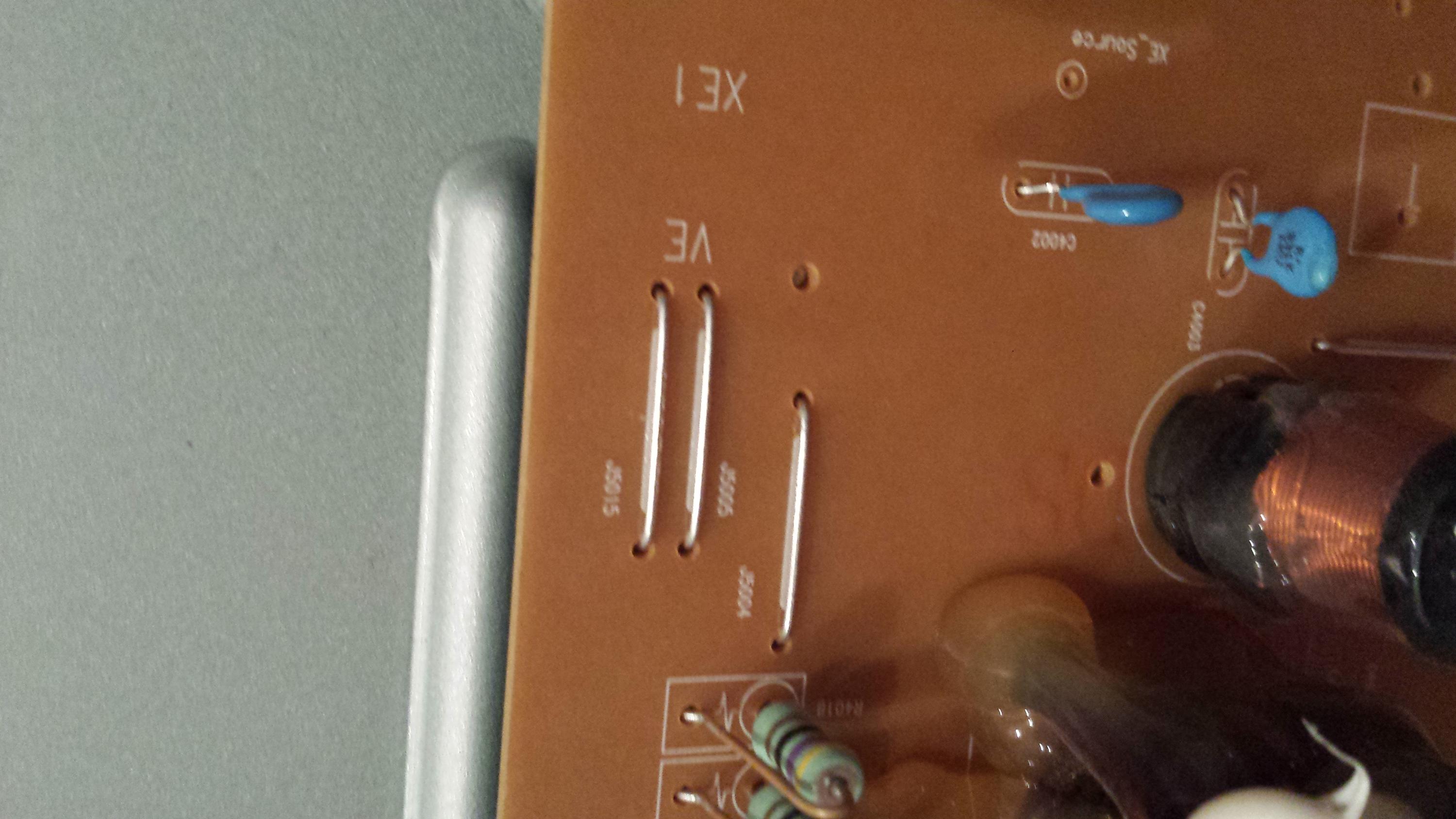

          There are two jumpers marked VE at the top of the X-main board. Test one of those.
            tested both VE jumpers Tom and only returning 94v ?
              That is fine. So, -Vsc, Ve, Vs is OK, what does Va test at? It could be a bad control board or X-/Y-main board. Hard to tell without a scope on the boards.
                deffo VE Tom. took picture of what i was testing and also what board it was on.

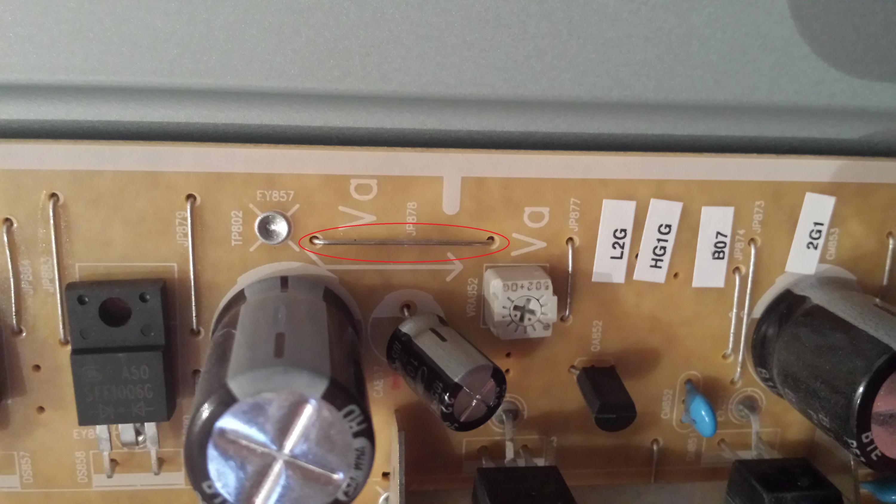

                  I know Ve is fine. 94V is OK for this generation of plasma panel. I want you to test VA.
                    VA on PSU was testing 57v tested jumper with circle.
