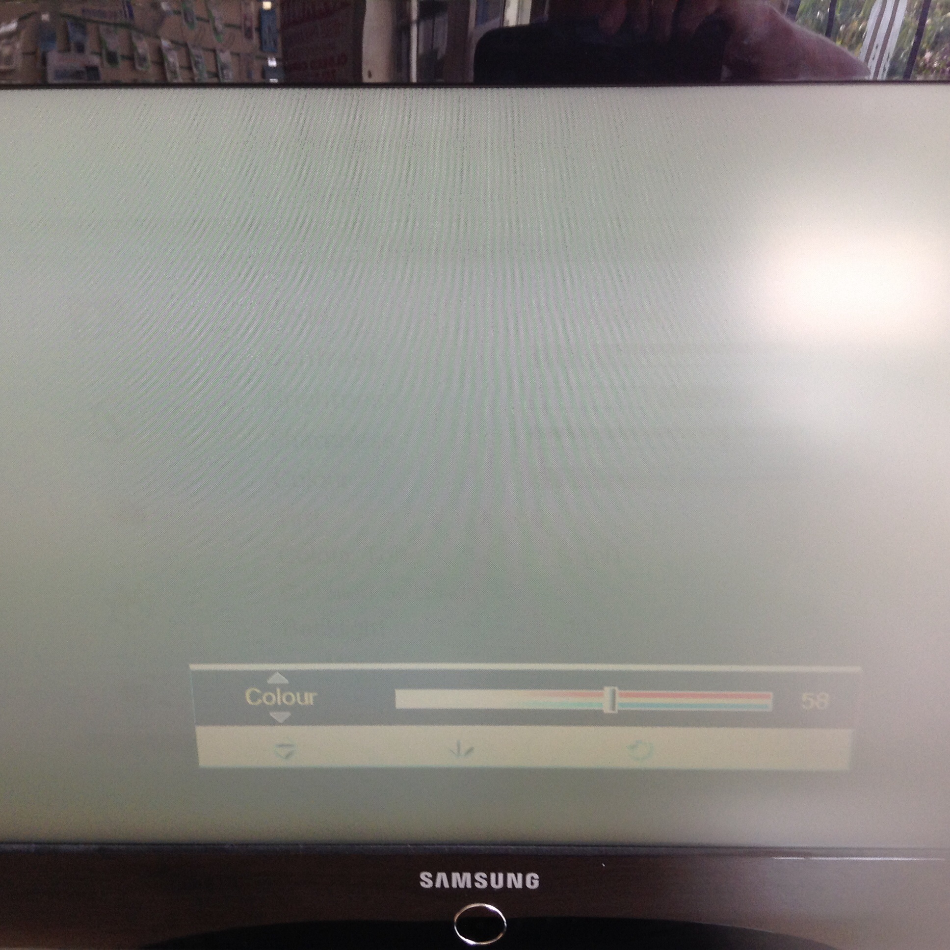

    Hi, I see a lot of this type of tv but never had this fault. Set works but there is no contrast. Menu bars move left to right but no change. Done usual eeprom reset and fitted new eeprom. still the same. Psu caps etc all ok. Any ideas. Im thinking main board ?
    Re: Samsung LE32M87BD No contrast
    post a screen shot so we can see what the picture looks like.
    More likely to have AS15 GAMMA IC (U402) problem in the T-CON board.

      . hi thanks for reply. I hope i have uploaded pics ok as first time in trying. Contrast n brightness controls move but have no effect. bright screen with no depth. When pressing menus the last one can still be seen before fading. t con is. T315XW02 v6. Many thanks in advance
        Looks like a gamma IC fault. Post a picture of the T-con board.

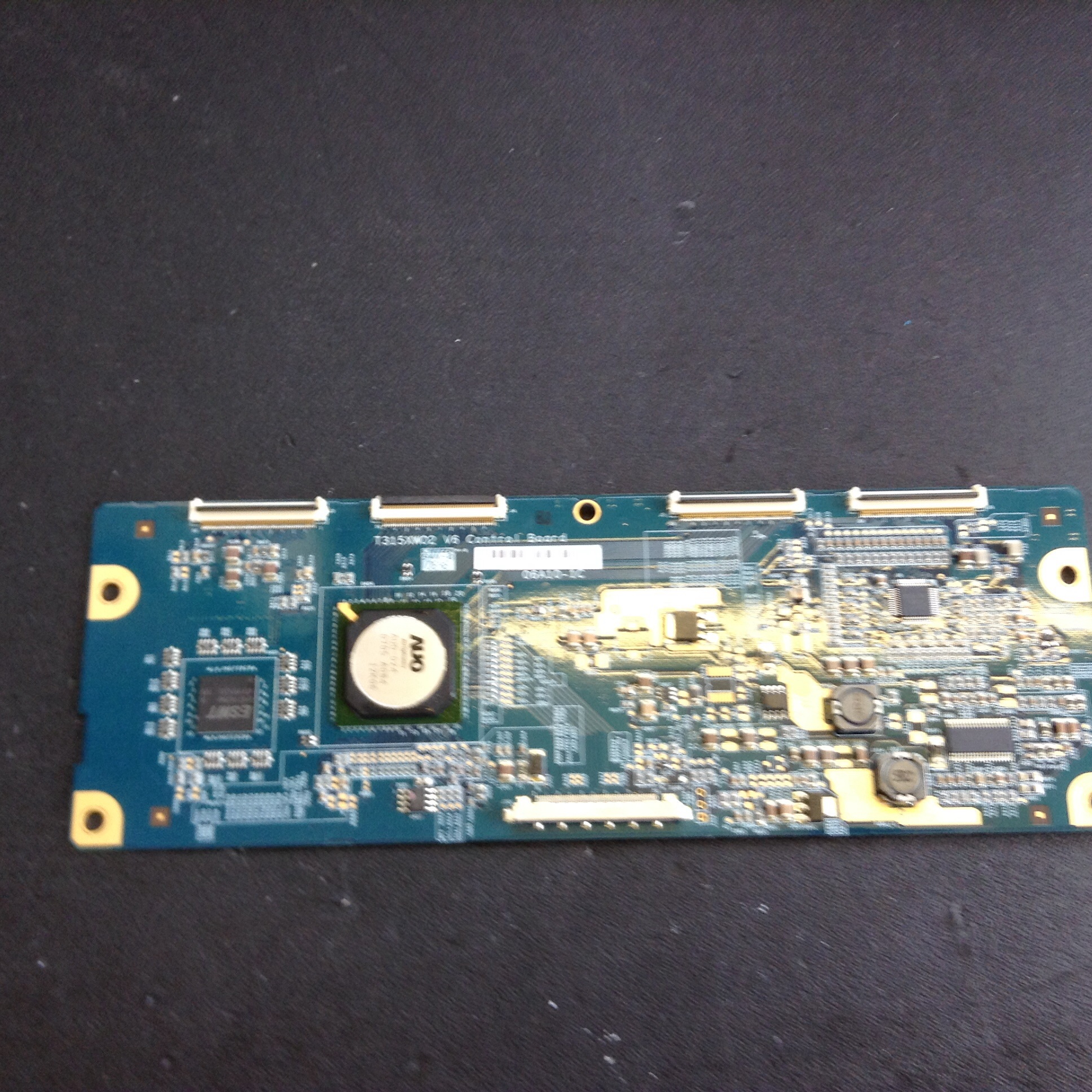

            Please take a picture in focus, we need to see the small text and small components on the board. In particular along the bottom of the board.

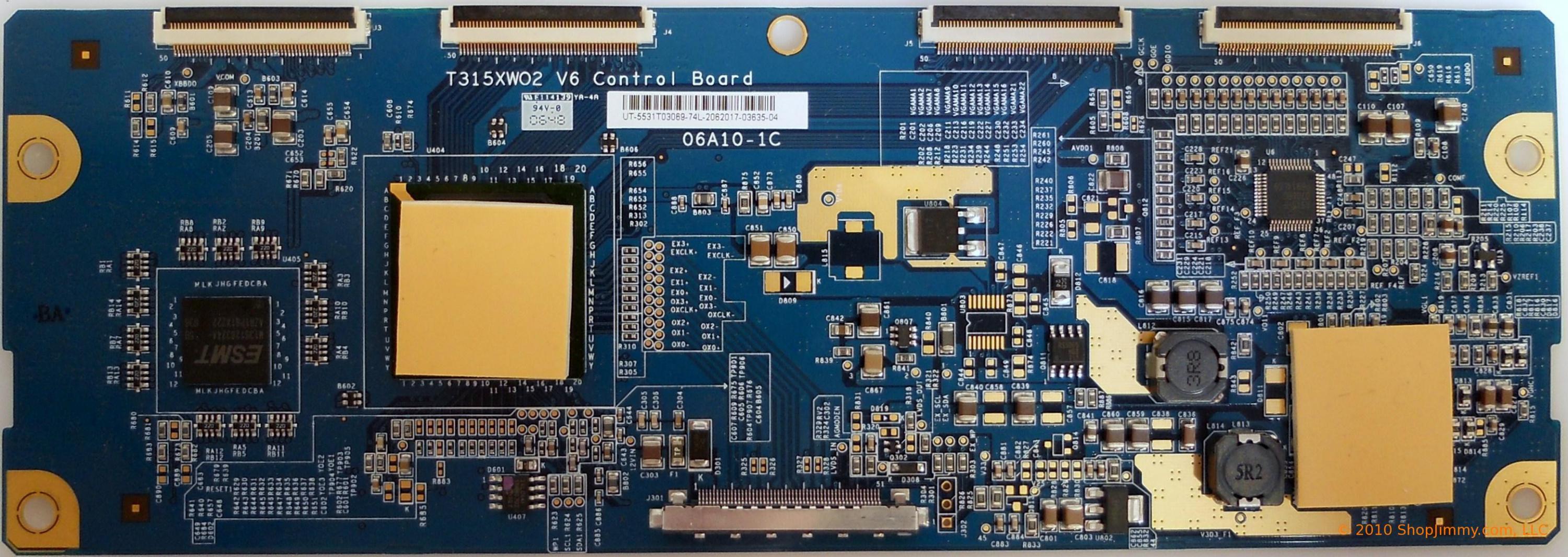

                  Tom, This picture may help. Provided by SJ.
                    Yes so andyanz will need to test the VGAMA points from 1 to 22 (some missing) on the right hand side of the board, just under right most ribbon connector.
