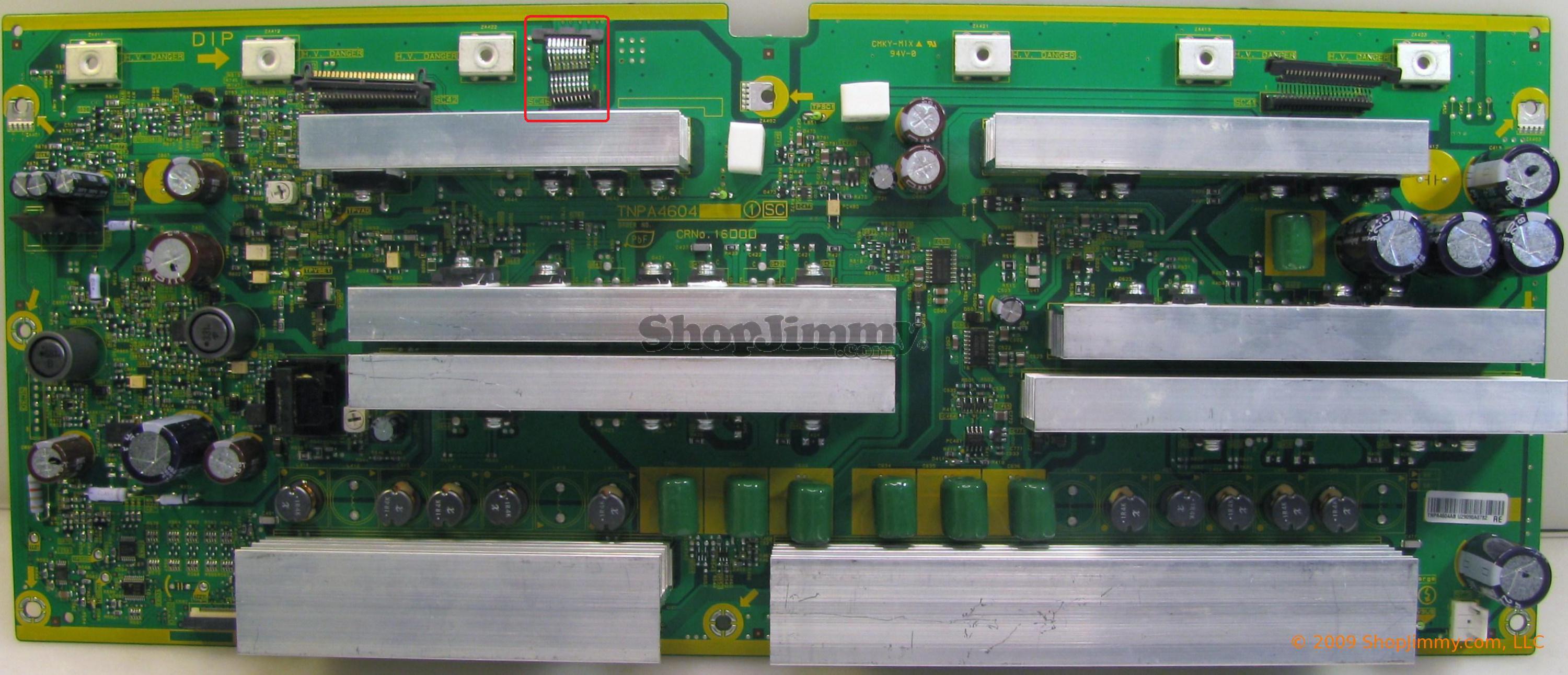

    I've been struggling for 6 months or so with a dead Panasonic 58" TH-58PZ800U. Tried another forum for a while and received a recommendation to come here and see if anyone had some insight. Here's the sordid tale:
    In December it started putting out a 7 blink LED error. I unplugged it and let it sit 24 hours, after which it worked fine. A month later, the screen shut off and put out a 2 blink code (15v SOS). For this model, that indicated the D board (main logic board) as the check point. I ordered a replacement and installed it. At startup it gave a 3-blink error (3.3V SOS), indicating the A Board(Main input/tuner). I sent the A board off for repair & return since I couldn't find a replacement. The shop tested it and said it was fine and sent it back. I put it back in along with the original D board. 2 blinks again.
    Since the power supply boards are typical culprits, I ordered a replacement P board. No change. On the chance the replacement was defective I had a local shop do a diagnostic on the whole set. They said both old and new P boards were fine, but there was a short in the SC (Y-main) and SS boards. OK, fine, that makes sense considering the earlier 7 blinks. They wanted over $600 for the repair but I knew I could get those boards for about $80, so I ordered them and installed. Now I get 5 blinks (5V SOS - D board), and if I hold down the power button it becomes 10 blinks (Sub 5V SOS, Main 3.3V SOS, DTV 5V SOS Tuner Power SOS - A-Board).
    I have dumped a large amount of money into what I hoped would be a quick DIY fix and am still baffled. The only visible possibility I see is a break in the plastic cover of the A11 connection going into the A-Board.
    I'm willing to go through a last-ditch attempt to find the problem by checking test point voltages with a multimeter, but would need some guidance by someone more experienced with this sort of thing. Any other insight or suggestions are welcome. Thanks.

                Re: Panasonic TH-58PZ800U major problems
                Quoted from AVS
                Originally posted by kmenc1111
                Still struggling with a Panasonic TH-58PZ800U I'm desperate to fix. The saga to date:
                Several months ago, this plasma failed mid-viewing and put out a 2-blink error. I checked the manual, which indicated the D-Board. I ordered a replacement and when I installed it, started getting 3 blinks, indicating the A-Board (inputs). I couldn't find a replacement for that so I sent it off to ModusLink for repair/return. They said the A-Board was fine and sent it back. I re-installed it - 3 blinks. I reinstalled the original D-Board as well and was back to 2 blinks. Since the power supplies are problematic on Panasonics, I took a chance on replacing the 2-piece P board (I also tried chilling the MC301 and MC201 with no effect). No change after swapping P-Boards. Frustrated, I took the whole thing to a local repair shop for testing in case I was getting dud replacement parts. They said both the original and new P boards were fine, but there was a short in the SC and SS boards. I replaced those and now get 5 blinks. And when I hold down the power button, it goes to 10 blinks. Also, if I disconnect the cables to the SC board and turn it on, it gives out 10 blinks.
                The only possible visible issue I can see is the connector at the end of a wire cluster leading into the A-Board at the A-11 connection is cracked.
                Any suggestions would be appreciated as well as any guidance on checking voltages to try and pin down the source of the problem.
                I forget what info you have but getting 10 blinks with the SC2 and SC20 removed sounds wrong. Normally I'd expect 6 blink.
                Everytime you change a board your result seems to change too and looks like you've changed everyboard except the C buffers but being all used boards that in itself is an unknown variable.
                have you tried disconnecting A6,A7 (or P6,P7)
                Does the TV turn on by itself with
                Power LED = Off
                SC LED= On
                SS LED = ON
                I'm hoping the 50' model guide is of some help.
                I'm thinking you follow the 10 blink after power on flowchart, you've already isolated the SC so next step is the SS board(pg 28)

                                      Ok, Interesting so far. Since, when I turn the set on I get 5 blinks, but when I hold down the power button I get 10, I followed both the 5 blink flowchart and the 10 blinks after pressing power flowchart. According to the 5 blink chart, I should replace the SD board since no short appears at P25 after disconnecting SC46. According to the 10 blink after power chart, I should replace the P board since voltage is missing at P12 - although I'm not sure about that result. The previous step asks if the LED stays on after power, but the power button is completely unresponsive after disconnecting SS11 SS33 & SS34 and putting the jumper on P25. I read that as a "no."
                                      I take that back on the 10 blink chart. On re-checking, there are no voltages missing, which would mean to replace the A board (the one I already had tested by ModusLink and was sent back as ok).
                                        does it give you a sd/su buffer bypass procedure to run the sc without buffers connected?
                                        If it's a buffer board then isolating it should mean the TV will turn on?
