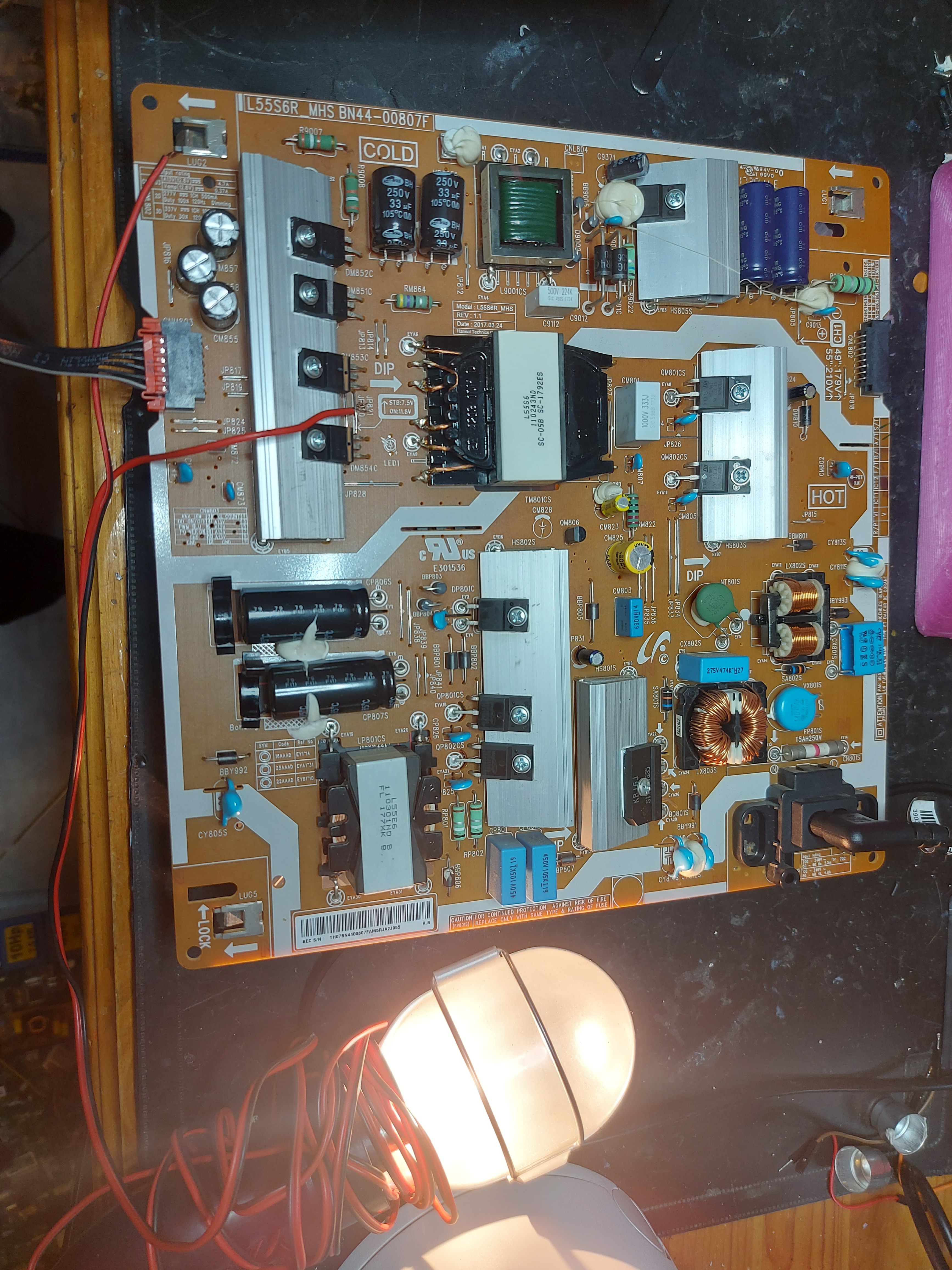

    Have a Samsung ue49mu6120 with no standby light,
    unplugging mainboard cable from the power supply turns backlight on.
    power supply BN44-00807F
    Main board BN41-02568B​
    Some other users suggest that the 25Q40 EEPROM might have become corrupted,
    Could someone more knowledgeable take a look and see if mine is corrupted?
    Thanks in advance:

                Fluctuations in power supply occur because there is no load at the output...Load it (13v) with a car incandescent lamp.
                • Gjackson
                  • Aug 2021
                  • 134
                  • Malta
                  The lamp lights up fine if the mainboard is also connected:
                  Click image for larger version  Name:	20250207_170801.jpg Views:	4 Size:	2.84 MB ID:	3566647
                  but when I disconnect the mainboard it blinks and doesn't remain steady:

                    Diagnosing would be much easier if you had the whole tv.
                    • Gjackson
                      • Aug 2021
                      • 134
                      • Malta
                      Just a quick update, I did exactly that and got the whole set to test with. Plugged everything back in and now it works somehow, I have standby and the tv powers on. I'm a little baffled as to why it's now working. Owner said that it was being intermittent but when I checked it there was no standby at all. There seem to be no cold joints and I tried tapping the boards while in operation and they seem to keep working. The only thing i've done is resolder the eeprom and replace the thermal paste on the CPU. Any clue as to what I should check before reassembly?

                        Intermittent faults are tough ones if it was intermittent, could be what you soldered did it or maybe there was a bad connection that got better just by unhooking and re-hooking cables, guess just test it for a few hours and see.
