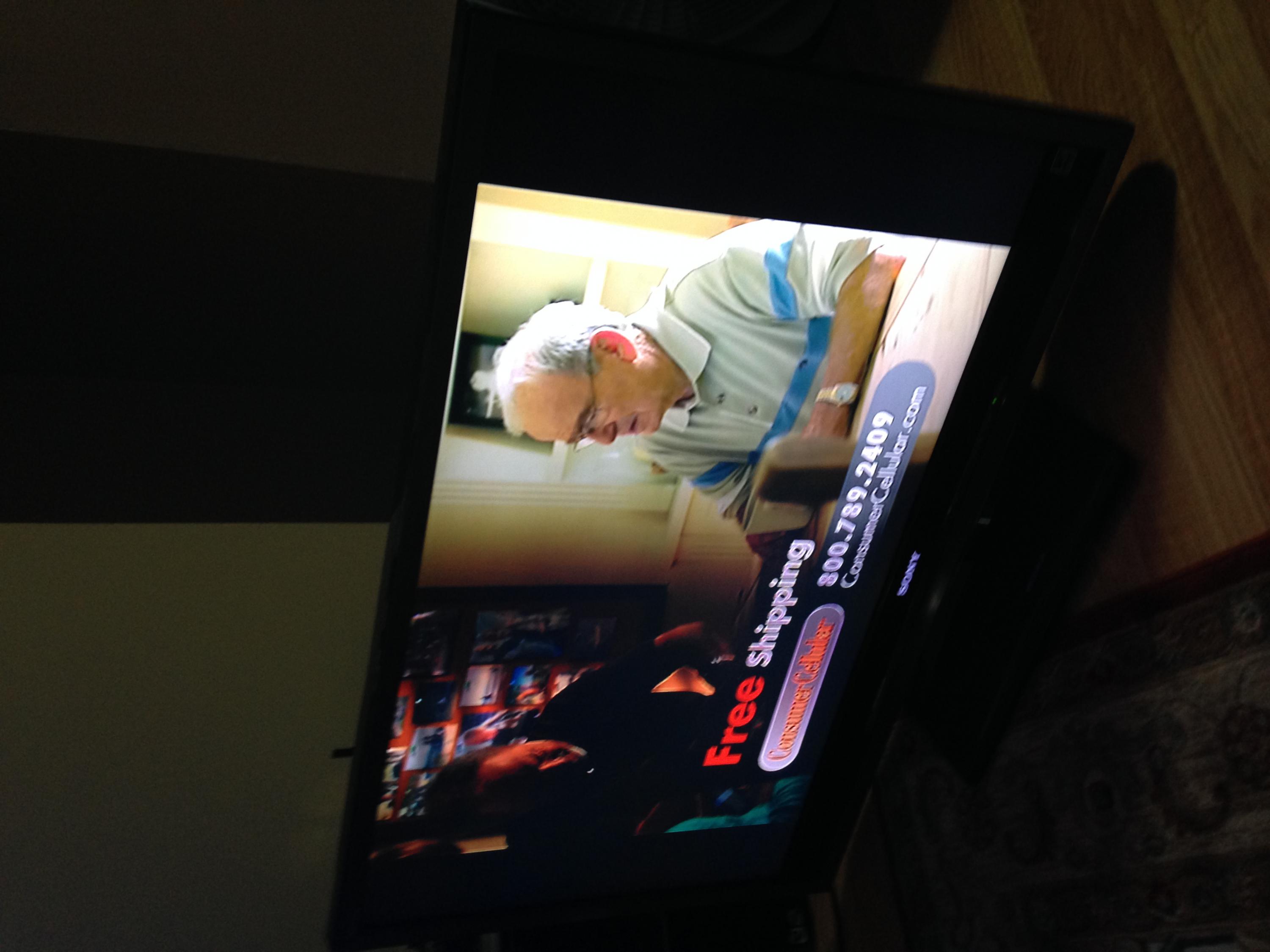

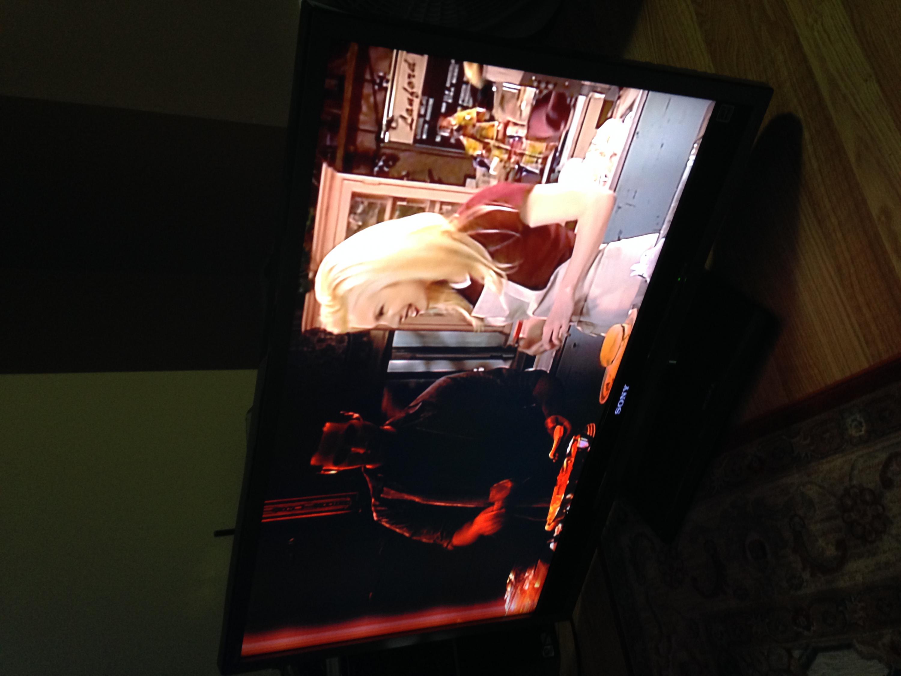

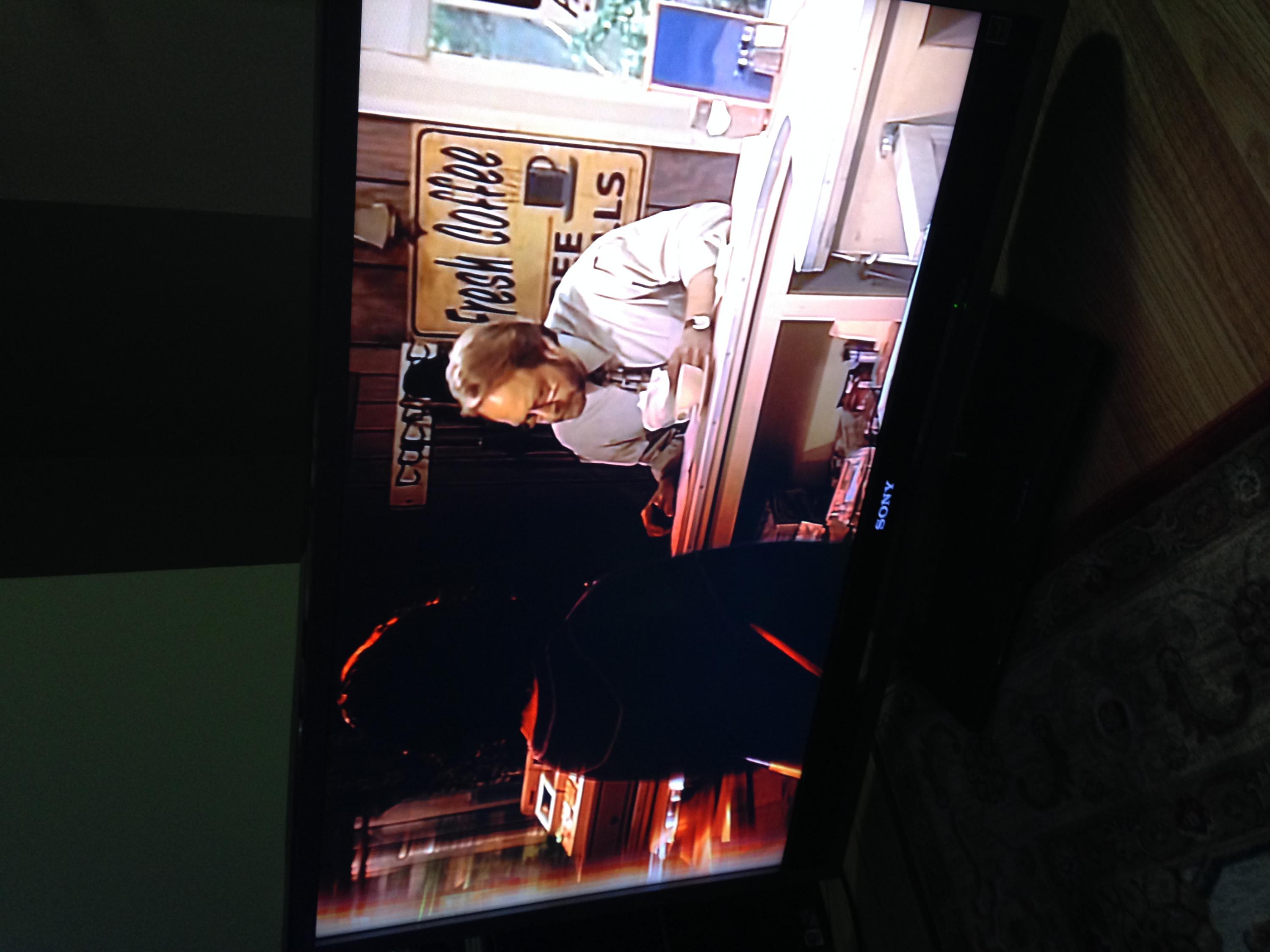

    Hi, I need some help with my Sony TV model KDL-40VL160 on the left side the picture is dark with lines and ghost like images. I include some pictures of

      Re: Sony KDL-40VL160 dark picture on one side
      Typical bad tab bond problem.
        is there any good way to fix that besides putting something in there to apply more pressure and praying?
          What's bad tab bond and how would I go about fixing this problem. Thanks for reply
            TAB - http://en.wikipedia.org/wiki/Tape-automated_bonding
            On an LCD it refers to the driver ICs on the sides of the panel, as they use that technology to attach them. If there are bad connections you can get weird picture problems.
            budm wrote about a fix here: https://www.badcaps.net/forum/showthread.php?t=37885
            Proper fix requires equipment that cost over $20,000 so nothing you could really try except his idea.
