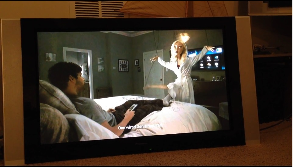

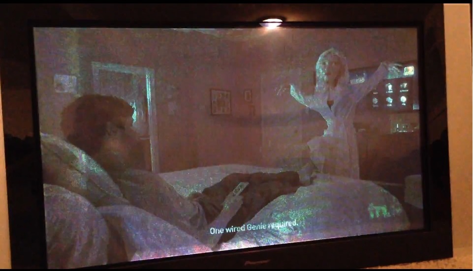

    Hello, I have a Pioneer Plasma PDP-42A3HD TV that experiences video issues after a few minutes of being on. The center of the picture fades in and out and there is a general green tint that comes in and out also.
    I've run the TV with the back off and a few small fans on it, thinking it could be an overheat issue, and it did delay the symptoms significantly.
    Any ideas where to start?

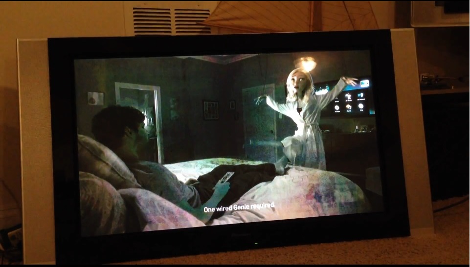

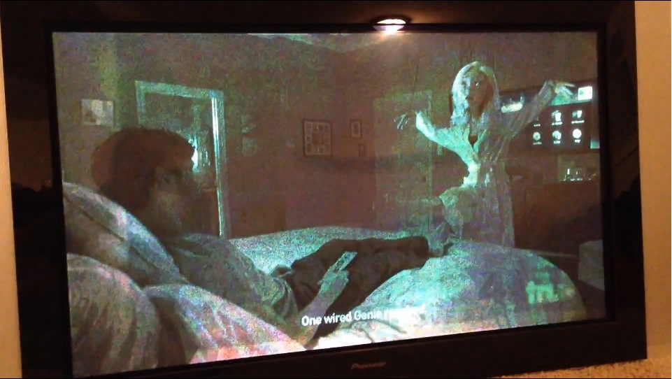

      Pics of the issue

              Thanks dcapper. I allowed the TV to run for a while, and the picture gets bad, and then the TV clicks off and comes back on with a poor picture, fades in and out, and that cycle repeats.
              I did use the compressed air on all the components, but it did not improve the situation. Any thoughts?

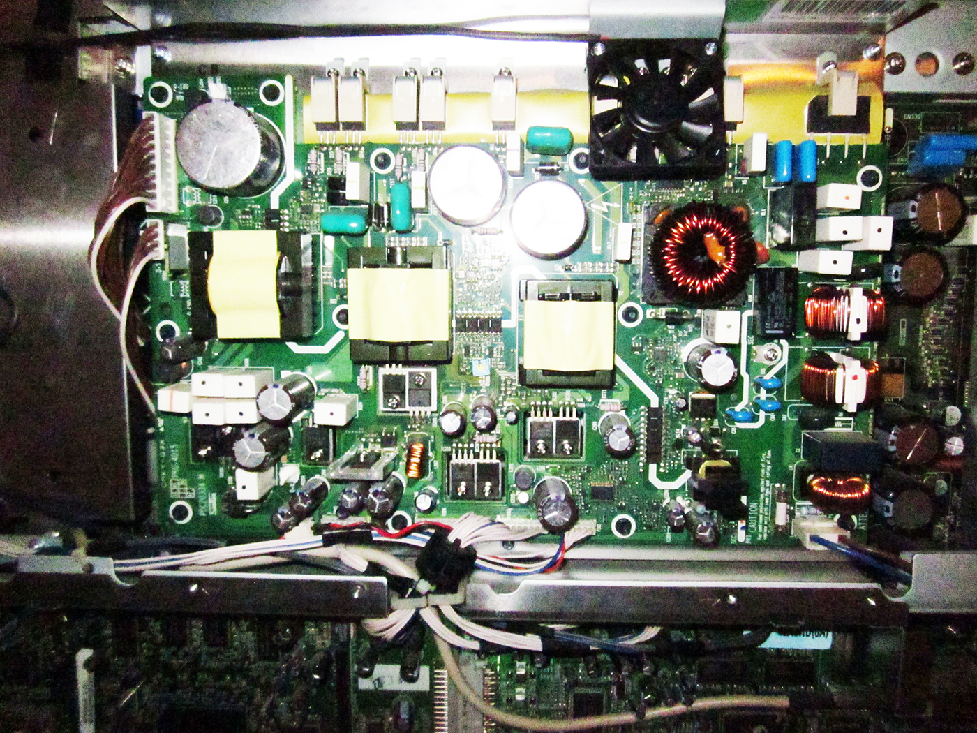

                      This is the board, but which connection do I need to test? I am trying to find what the voltages should be so I can test, but no luck so far.
