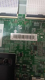

    Hi Lotos could you check my dump file because my samsung tv won't turn on.
    Thanks Click image for larger version  Name:	WhatsApp Image 2025-01-03 at 18.45.46.jpg Views:	25 Size:	103.0 KB ID:	3541109

    Yes, I can check, but I don't see any dump. What you posted. This is a photo of the motherboard, not a dump.

        Strange damage to the dump, what was the behavior with the TV, what didn’t work, was the standby LED on? Try this dump, after recording, do not forget to set and write the status register (0x88, 0x42).

            Well, turn it on and off (reboot), most likely due to a malfunction of the panel, when you disconnect the lvds cable from the motherboard, is it also overloaded? If the dump 25Q40 TV is damaged, it does not turn on at all, and the standby LED does not even light up.

                When the lvds cables are disconnected and the backlight should light up, the question was - did the reboot remain or not?
