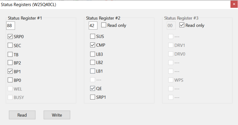

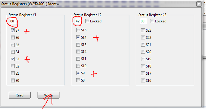

    In the program:
    1. Click "Detect Chip" and select W25Q40CL and "Select IC".
    2. Click "Unprotect".
    3. Click "Clear IC" and "Yes".
    4. Click "Open File" and select your corrected dump.
    5. Press "Program IC" and "Yes".
    6. Click "Verify IC".
    7. Press the down arrow to the right of "Unprotect" and select "SREG Edit", put a check mark on SRP0, BP1, CMP, QE and press "Write" and "Yes"
    7. Close the program. Ready.

              Am I doing it right?

                Like this.
                In the program:

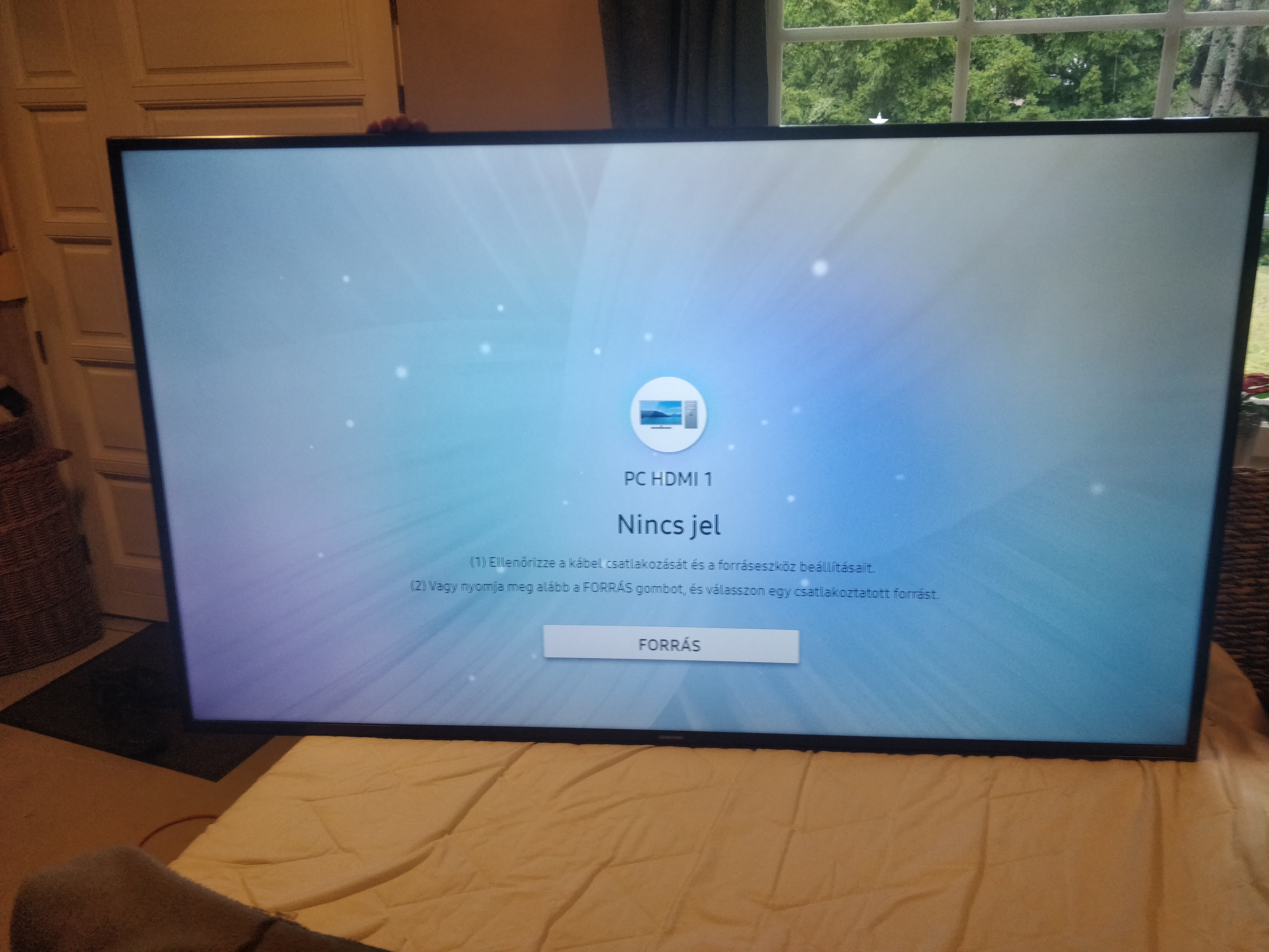

                  Thank you for the detailed steps.
                  The TV turns on now as soon as I plug in the power cord, but it doesn't display anything. Black light on but black screen.

                      I only saved (extract) the content of the two ICs I did not experiment with other bin files other than yours. I always desolder the IC, then solder it to a adapter which connects to the CH341A.

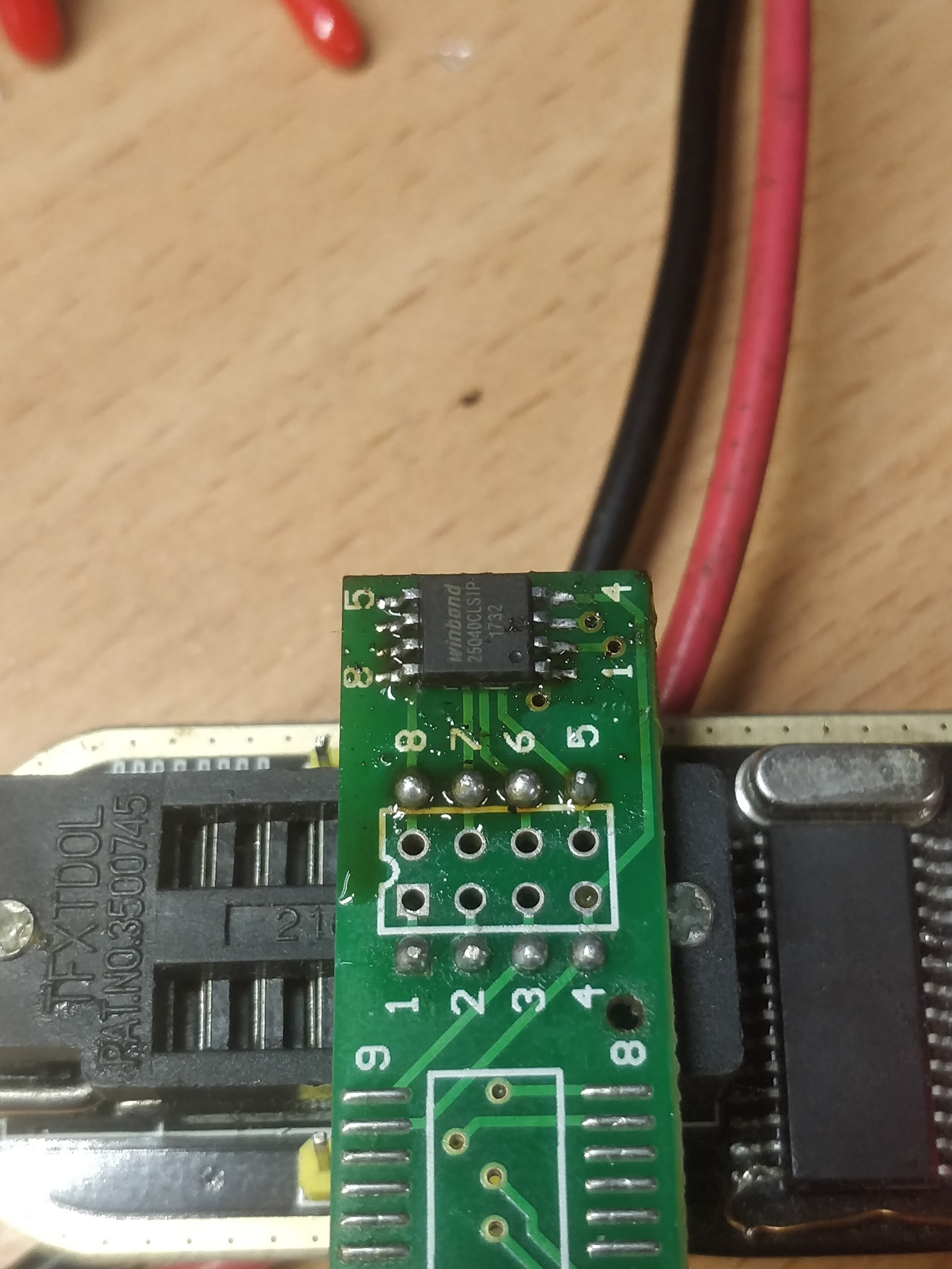

                                  Originally posted by lotas
                                  Yes, it's still the same. And maybe try to write to a new flash.
                                  Success!!
                                  I erased the IC and reflashed it with your fixed bin file in neoprogrammer (instead of asprogrammer) and it worked!
                                  Thank you again! You are the best!
