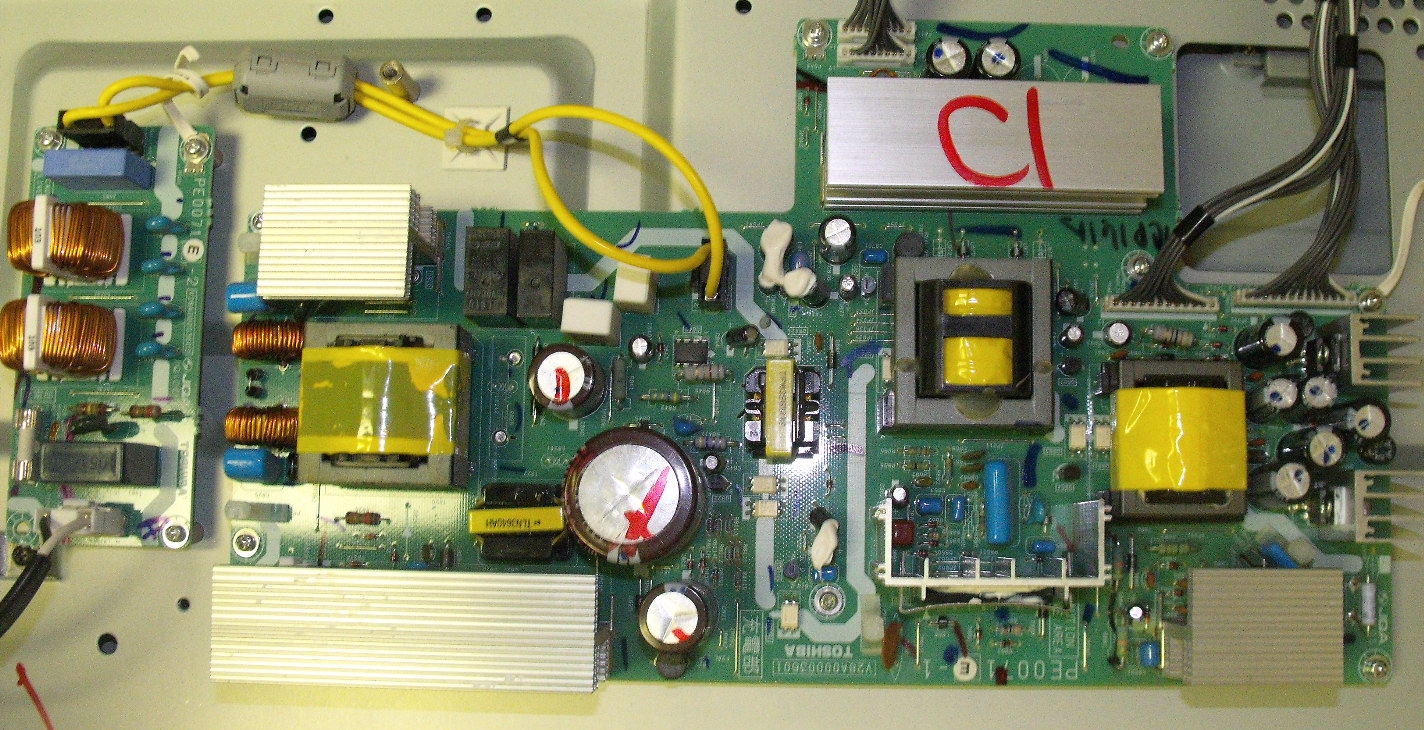

Ok this one has got me ticked off! Toshiba 42HL196 has 3 lights flash over and over. I had read this is a common problem for this set. I ordered a repair kit online that came with Q880, D892,D887,D883,R883,R884put it all in and same thing no help. I read here on the forum to put in 2 others Q820 and Q860 I first put in Q860 and tested No difference. Then put in Q820 and also no help but I rear the relay clicking over and over again. Not sure where to go now as everything I have read on this set replacing those should have worked.

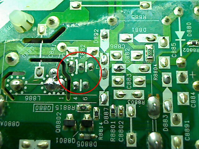

Re: Toshiba 42HL196 3 flashes
Solder joints look good. (see pic) and this is the kit I bought.
http://www.ebay.com/itm/140921155376...84.m1439.l2649Attached Filesif you find these attachements useful please consider making a small donation to the site
Your soldering works looks fine form what I can see.
So what are in the kit? It said the kit contains 6 components.
We will have to check the voltages on all the pin of the IC next.Never stop learning
