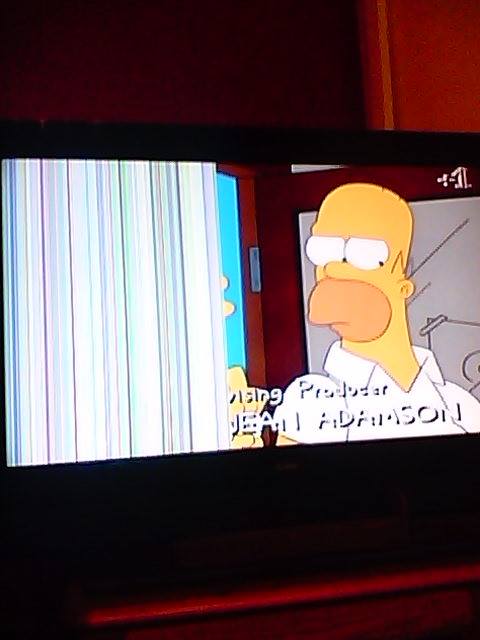

Technika Lcd32-207
  • sordids999
    • May 2013
    • 2161
    • uk
    Technika Lcd32-207
    hello guys got this set is it another panel failure/tab bond ?
    Re: Technika Lcd32-207
    I've not seen a 32" do that before but I would put a fair bet on panel failure. Could be loose ribbon cable from panel to t-con or even a bad t-con (unlikely though.)
